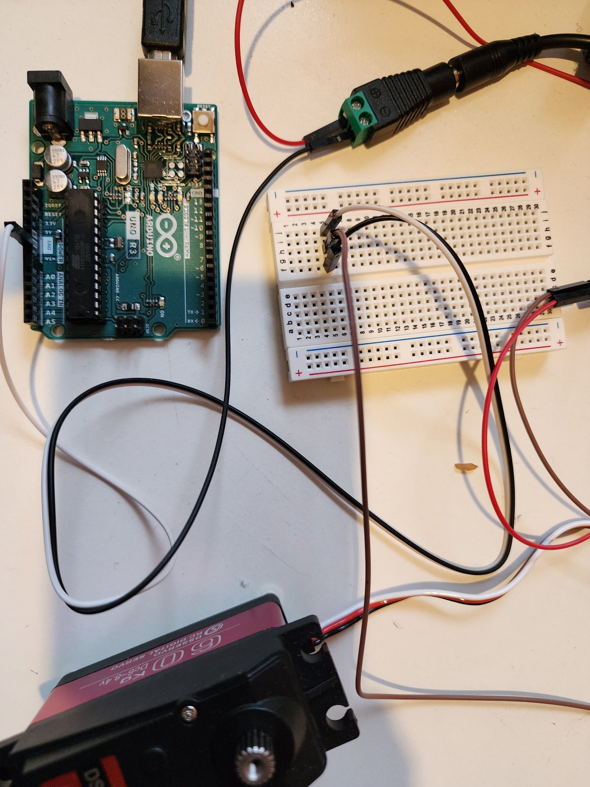

    Each servo needs a ground wire to the arduino right? I only see 3 ground connections, how would I connect over 3 servos?
    Pin Locations - the grounds aren't labels, or am I missing something in the wiring - I attached a photo of my current setup to test the first servo.

    Not sure what you mean by startup or main section. You can just copy the entire code into the Arduino code compiler.
    As for the ground, the Arduino should have 3 GND pin locations. I believe you really only need to connect 1 GND to the breadboard, say on the negative row line (AKA the line of holes near the blue line on the breadboard), and then connect all of the negative power supplies to that 1 negative line on the breadboard. Along that 1 negative line you would also connect a separate wire from the breadboard to each servo.
    Also, the servo has 3 pins:
    White is where you connect the Arduino PWM pin to the servo.
    Red is where you connect the positive power supply to the servo.
    Black is where you'd connect the negative (ground) from the breadboard negative line to the servo.
    When I did this a while ago, I overengineered by using a different column on the breadboard for each servo + power supply, but this is overkill. You can simply place them all along the negative row line.

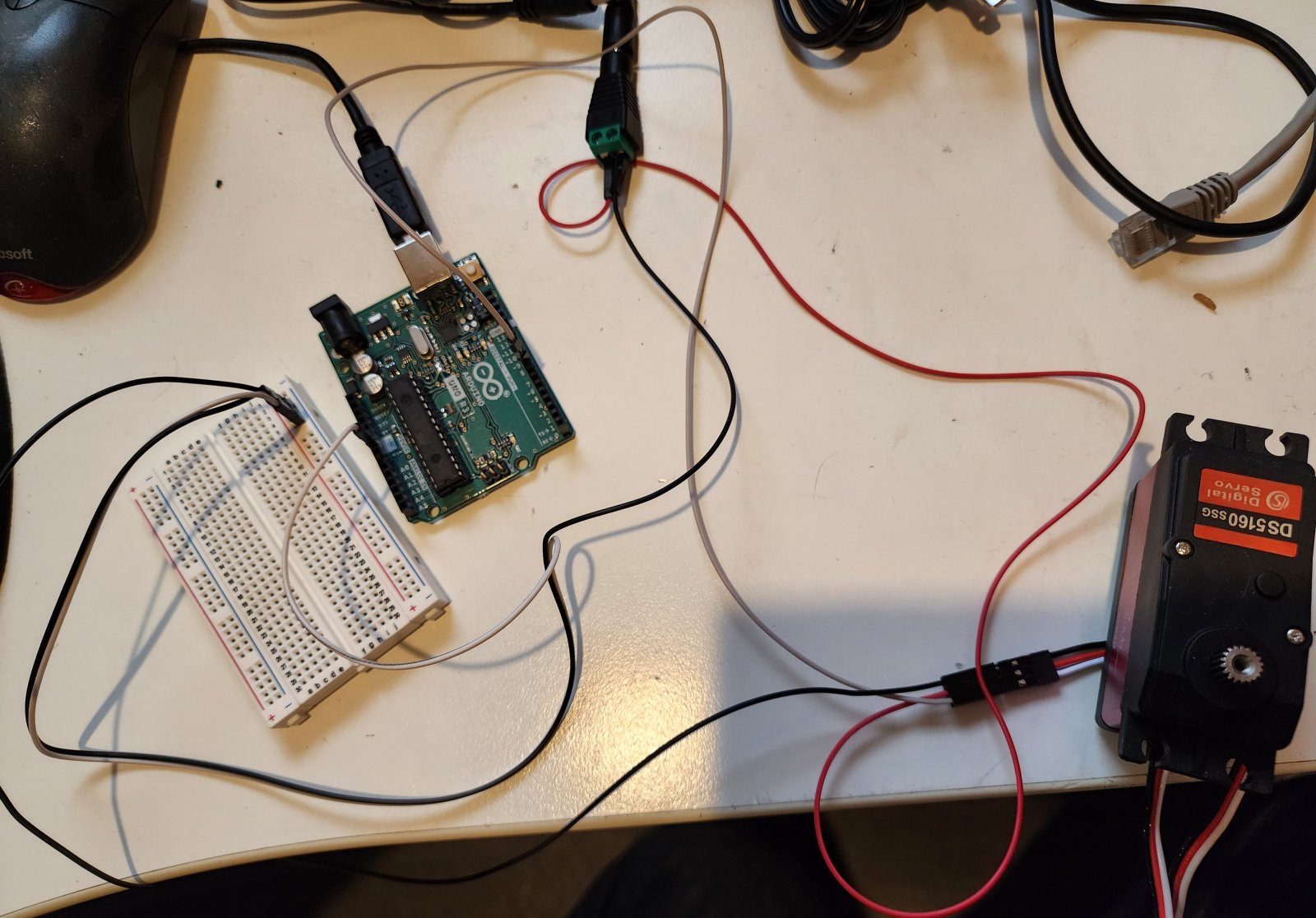

    Is this wiring correct for a single servo?
    I used pin 8, I think that's the PWM pin, but where do additional servo's go?
    The Arduino complier shows 2 sections shown below, should this run repeatedly or just on setup?

    As far as I can tell, the wiring looks good.
    Additional servos would follow the same format; you'd connect the negative wire from the next power supply to the same negative breadboard row, and then run a separate wire from the negative breadboard row to the servo's black input. The positive charge from the power supply is wired directly to the servo's red input, and another pwm pin from the Arduino is wired to the white input.
    As for the code, just copy and paste it over the entire contents of the starter code (bith sections including the setup and the loop will be replaced).

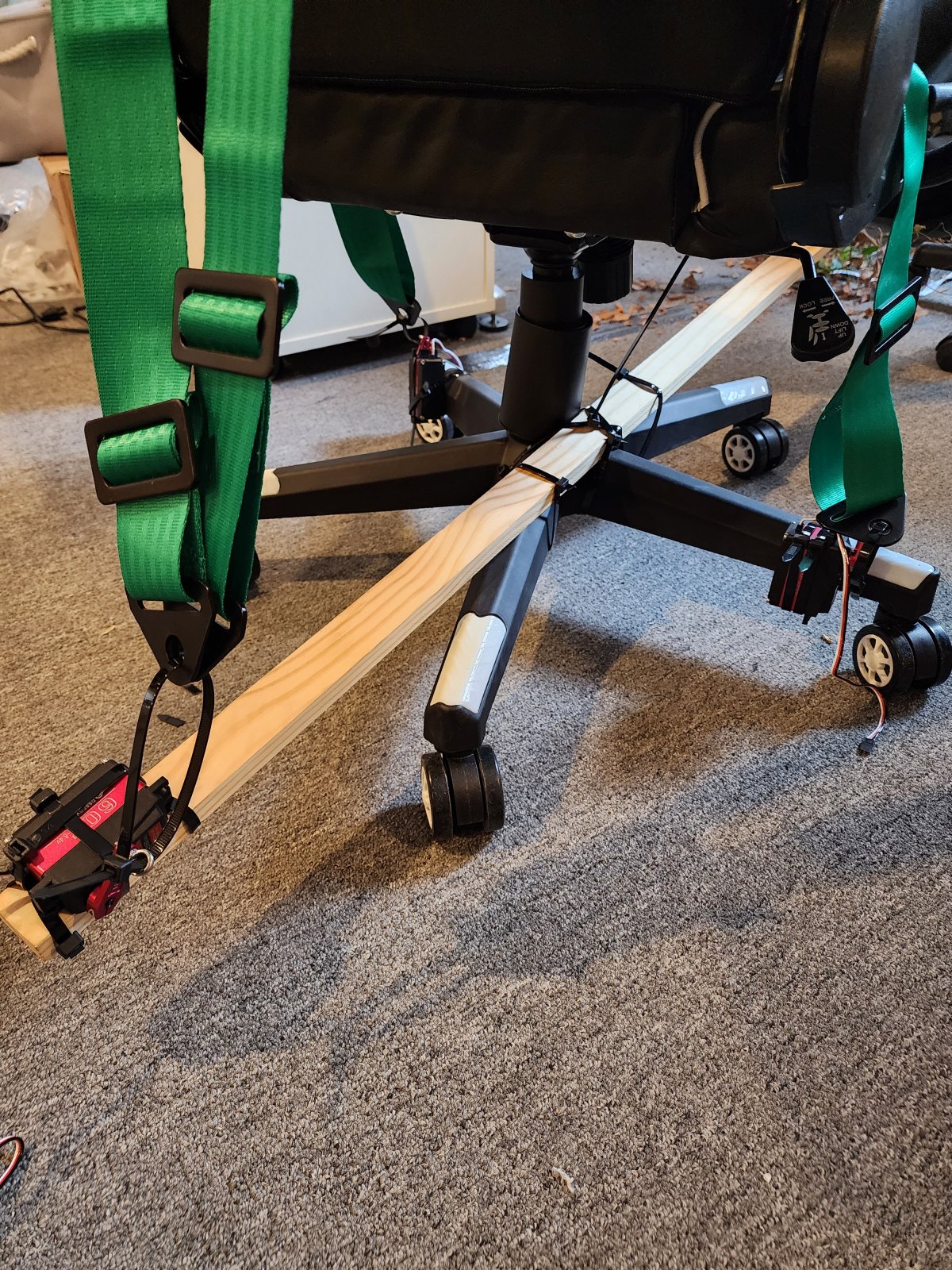

    I have connectivity to the servo's now, thanks. I want to test it with 3 servo's just for the harness, does the attached mounting job look about right?
    I wasn't sure if the servos need to be tight or not, mine move if I pull up on them. I couldn't quite make out the best position to attach the zip ties:
    https://photos.app.goo.gl/1ZvhkEQxrpqRxzB39
    How should I adjust the angles? Should I keep 0,180 in the arduino code and adjust the position of physical the arm?
    I can test the servos in simtools from -100 to 100. Should I set at 0, and that would be aligned parallel to the longer side of the servo?
    What would you recommend for keeping the ardino, power adapters and cabling together? I'll have 3 servos now, but will probably expand to 10 if everything works well. Maybe tie the cables to the legs and along the back piece of wood - going out to a box holding them? Should i get a milk crate like you were originally using?

    Glad to see you're making progress! You'll want to make sure the servos are as fixed and stable as possible, since you'll lose a lot of integrity if they are sliding around. I can't tell you exactly where to place them since each chair and setup are different. You'll need to experiment with the best placement. You may need to improvise to see how to get them to stay in place. I'd recommend a trip to the hardware store to see what might be useful.
    As for adjusting the angles in code, 0 to 180 is correct if you're using 180 degree servos. If using 270 degree servos, 0-180 will actually translate to using all 270 degrees of the servo. For 270 degree servos, I'd change the code to 0-120. Of course, you'll need to test and play around with it to make sure it works as expected. The easiest way to position correctly is to update the code, and then adjust the physical position of the arm to a satisfactory position.
    As for the position of the servos from -100 to 100, there is a line in the code something like this:
    const int kPosAndNeg[kActuatorCount] = {0, 0, 0, 0};
    where each element in the array relates to a servo.
    If the value is zero for a servo, it will only apply positive numbers, so you would only get 0 to 100. This is useful, for example, if you want the servo to respond to acceleration but not braking or if you want the servo to respond to turning left but not turning right. However, if you set this value to 1 for a given servo, it should respond to the entire range of -100 to 100.
    Regarding organizing the components and keeping them tidy, I'm probably not the best person to ask, lol, as my setup is far from neat. You're at the point where you have a working prototype, so just keep doing what you're doing and find what works best for you. Keep up the good work!

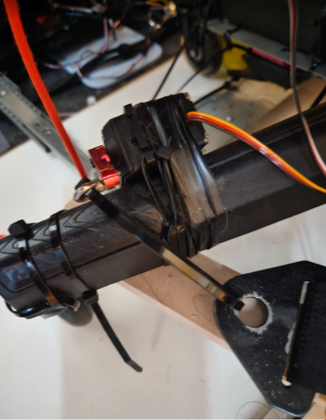

    Do you mind taking a close up pictures of how you strapped one of your servos on securely? I'm pretty sure I have the exact same chair, it looked like you wrapped around the notches but I couldn't quite see the details.

    Here's a quick picture of how I have the servo attached to the pedestal. I also used some electric tape to keep it from sliding, although it is pretty much fixed with very little flex.
