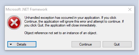

    But it's not good LOL. ARFFF
    Plugin simply compile without changes.
    GameManager does not start anymore, except that I removed plugin.

    I receive this message :
    And the detail:
    I tried with the three examples it's the same.

    I just saw that @vthinsel certify the incompatibility between V1 and V2.0 on another post.
    I will test with V1.3 and it works.
    Would it be possible to see an example for V2.0?

    Hi @Fredymilou
    This means you have old game plugin code.
    Here is a v2 GamePlugin how-too, and new examples.
    https://www.xsimulator.net/communit...ugin-for-simtools-2-0-api-documentation.9107/
    You will need to remove the invalid plugin.
    And you may need to goto:
    C:\Users\admin\AppData\Local\SimTools\GameManager\GameProfiles
    and delete the folders;
    LastUsed
    Profiles
    to get it worken again.
