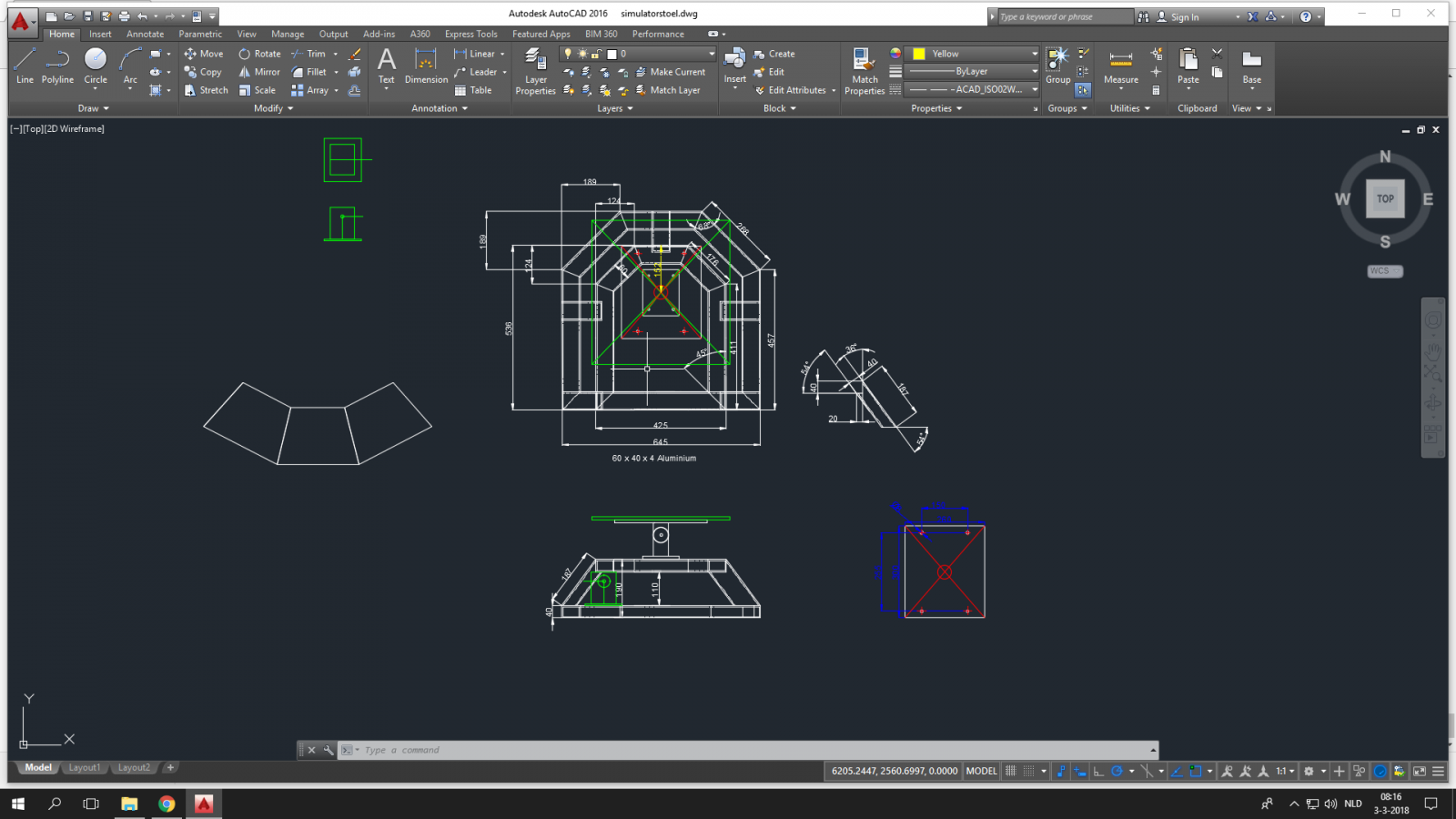

    I bought 2 motormonsters and a arduino uno clone via ebay.

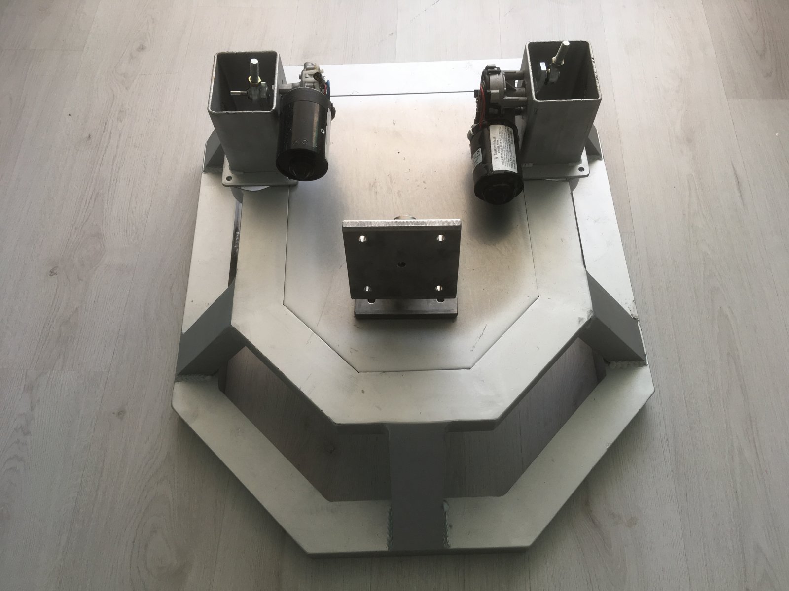

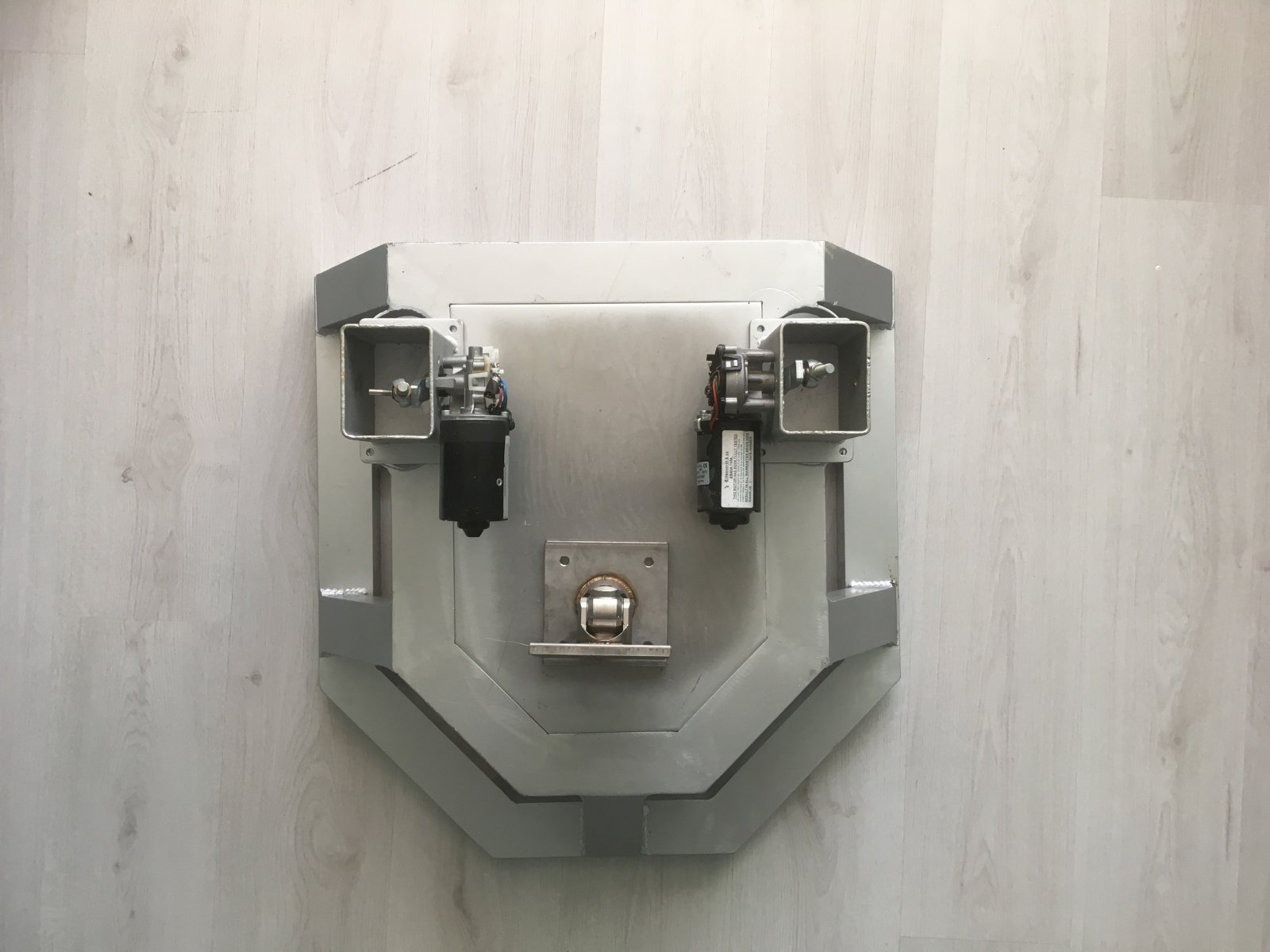

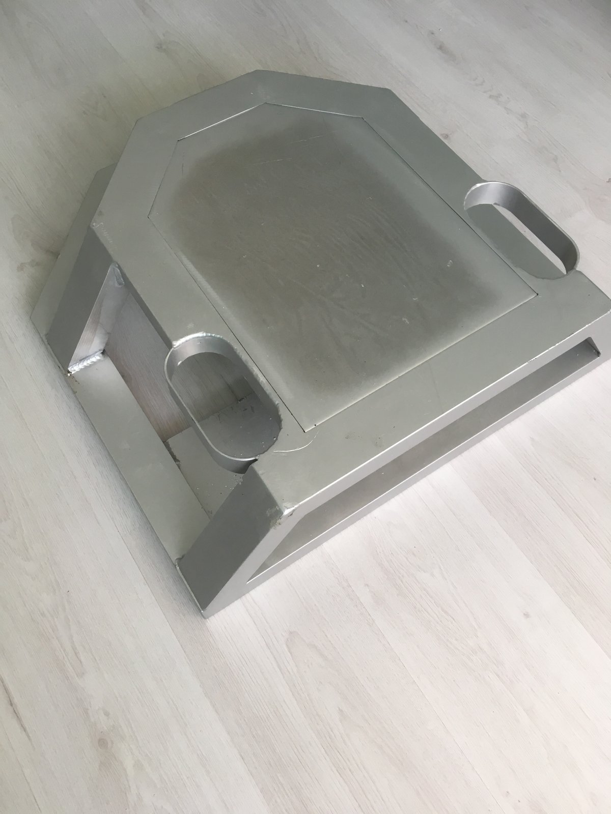

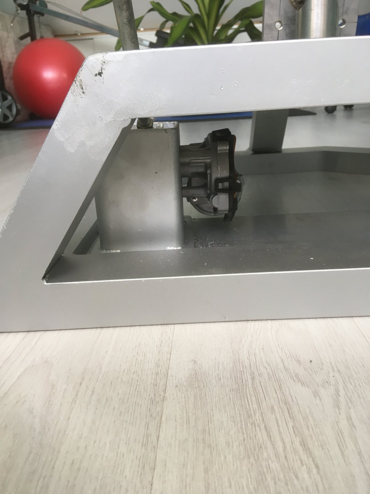

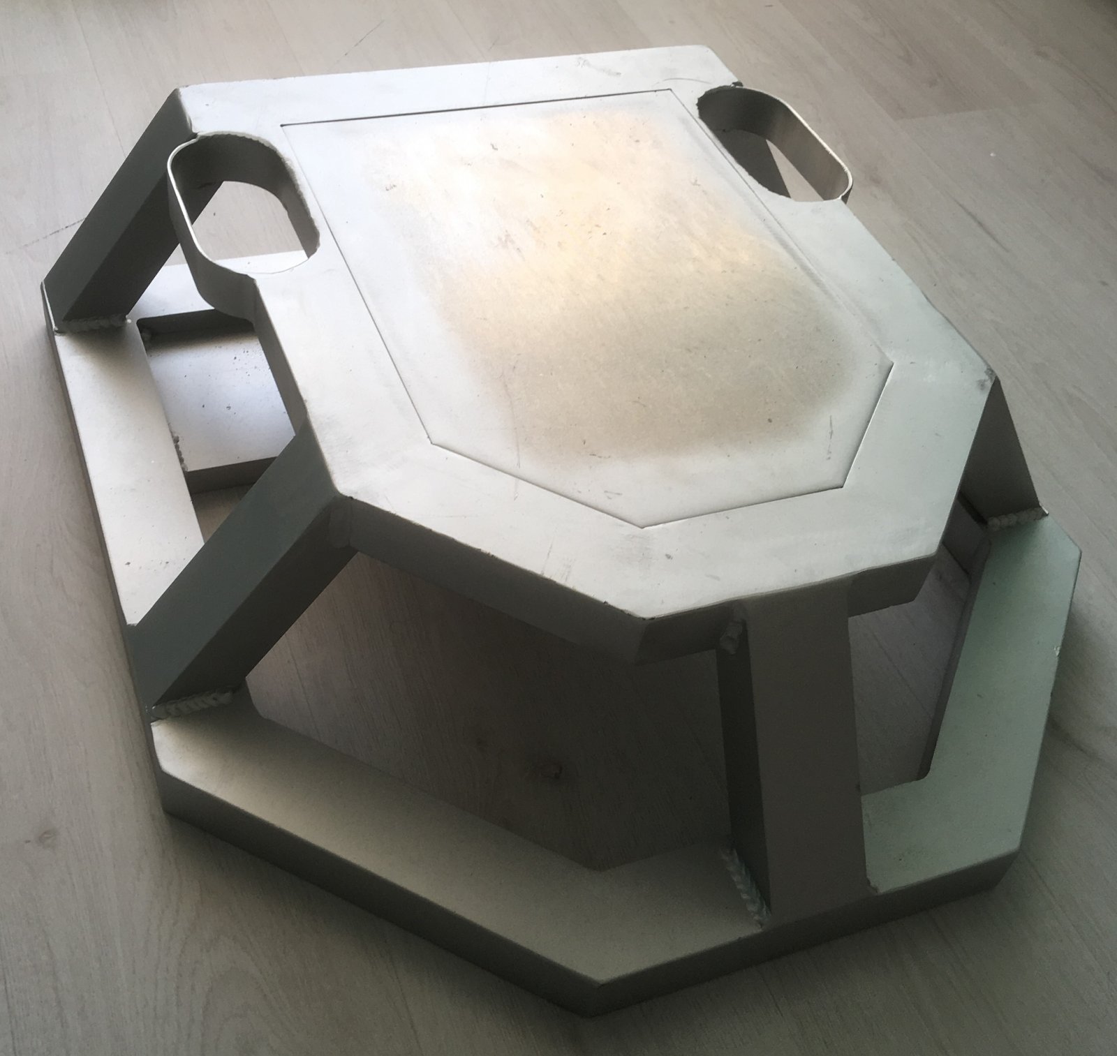

    This is my base...
    sawed from 60x40x4 mm aluminium. top plate is 10mm thick.
    Why the angled front??? Because i can:thumbs and , i think it looks good!

    on the way ! hahaha enjoy.

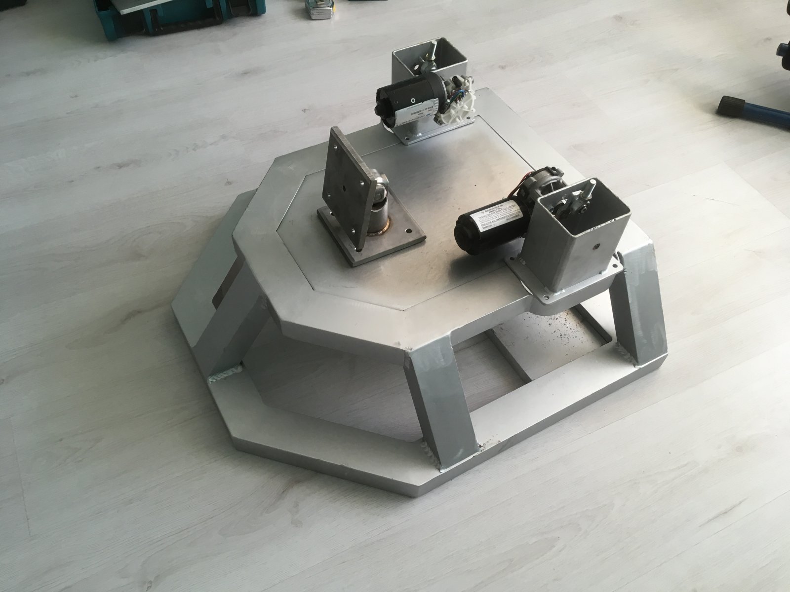

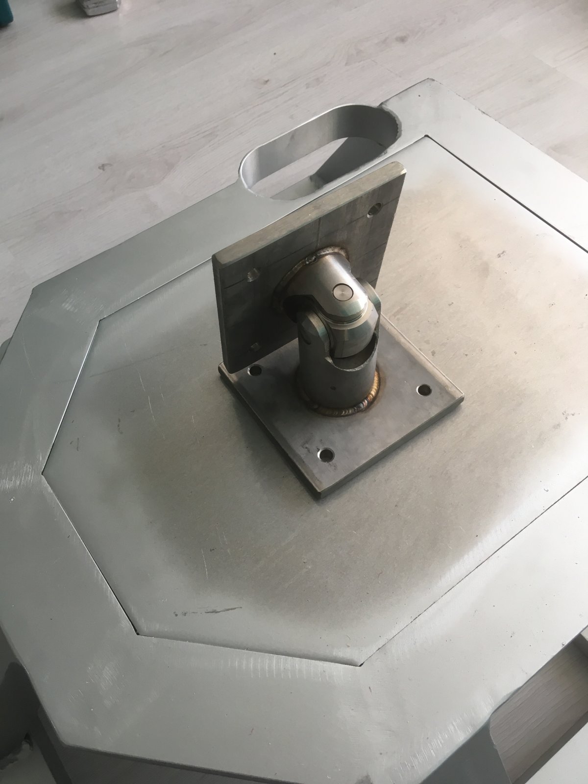

    And then the universal joint...
    Stainless steel tig welded...
    top and bottom plate 10mm thick...
    Made to bold-on...

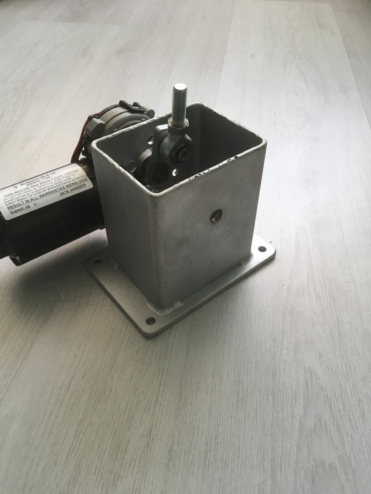

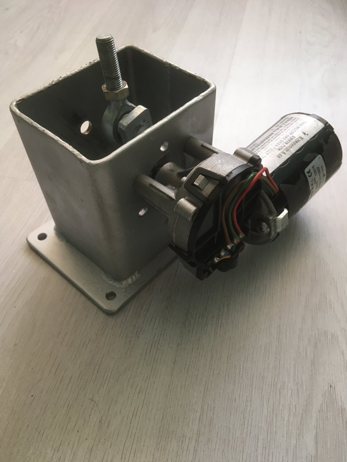

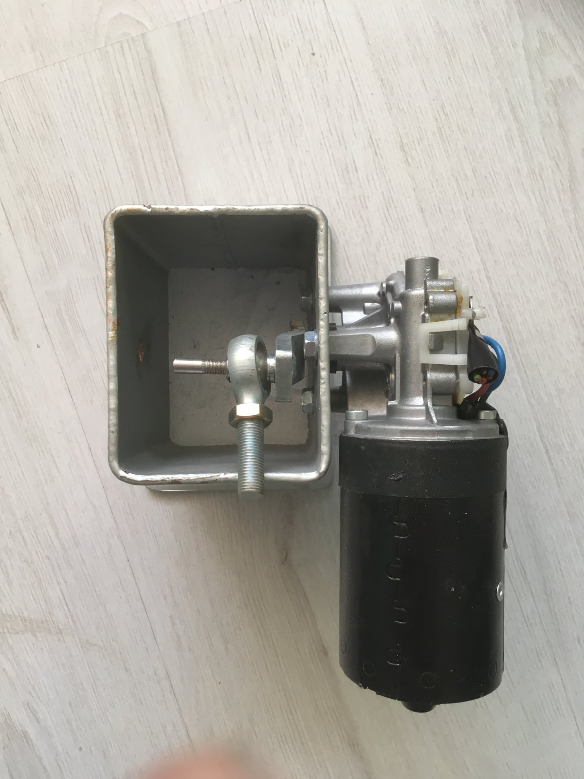

    The 2 "motorboxes" i constructed...
    The boxes are made from 3mm steel tube.
    Also bold-on...

    The "boxes" will be bolted between the top and bottom like this... IMG-1359.JPG IMG-1360.JPG

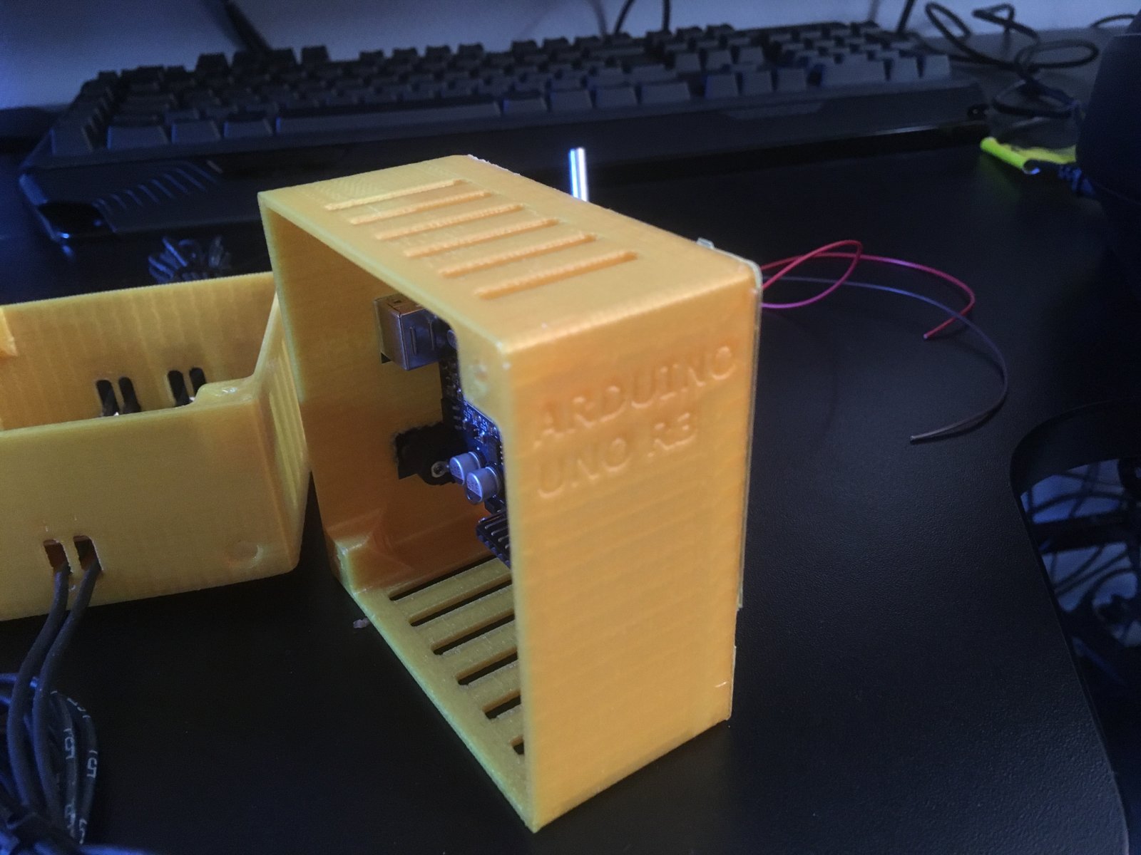

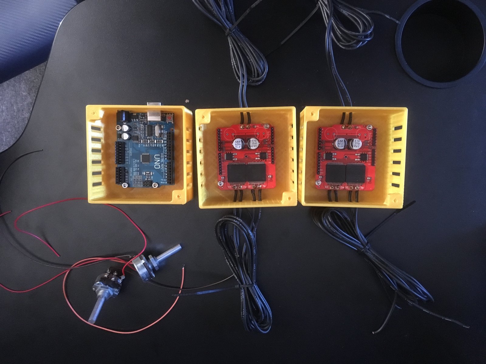

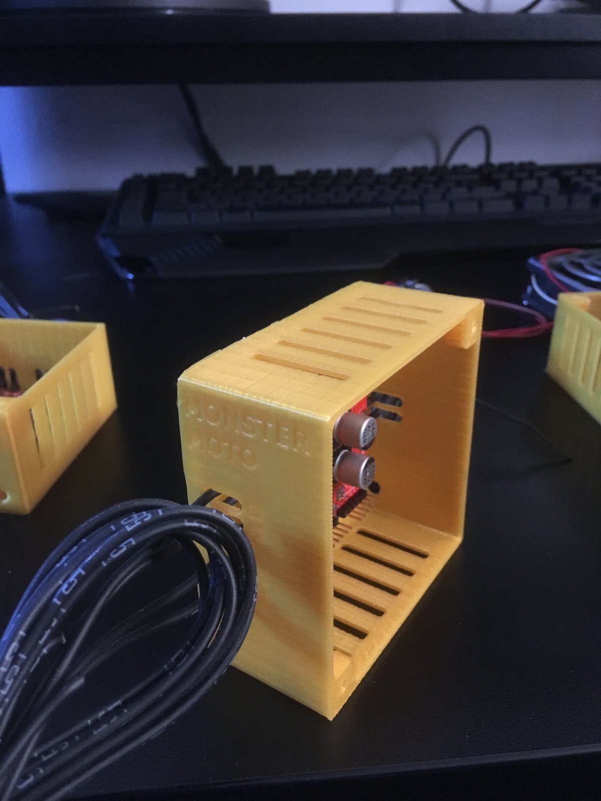

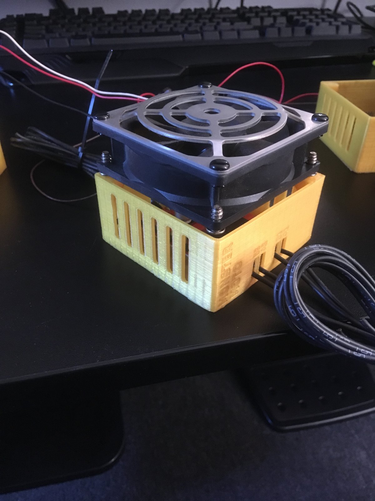

    as for the electronics...
    I printed some housings for the 2 motormonsters and the 1 arduino...
    i designed them to mount a 80mm fan on top for cooling...

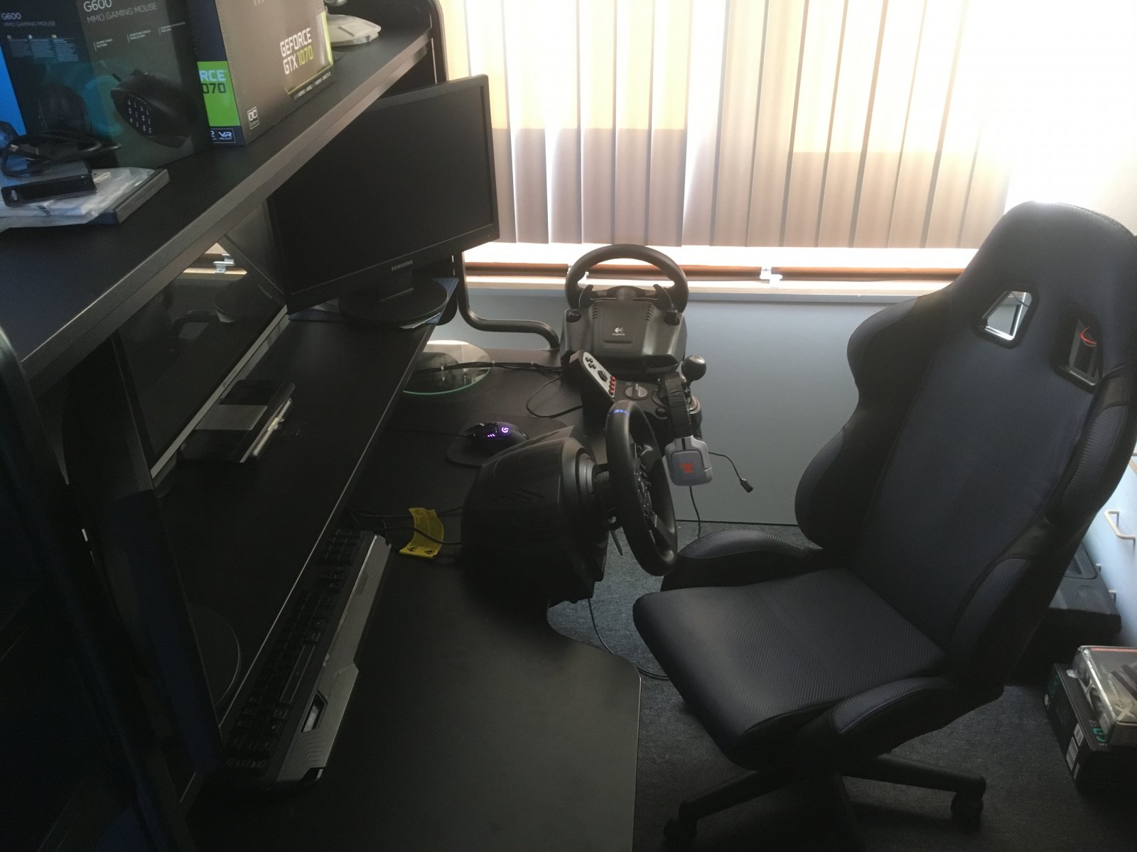

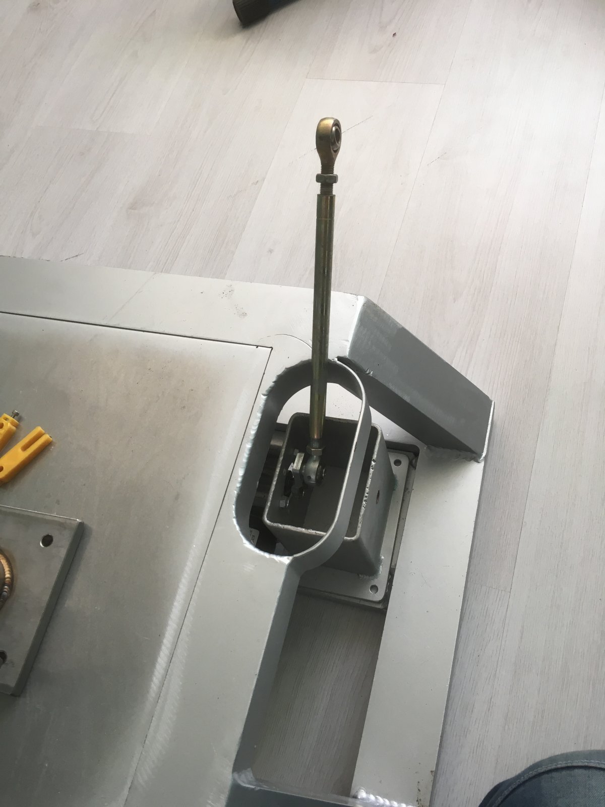

    next up is to measure my gamingseat COG (center of gravity ,i believe)and mount it to the base with the uni-joint...
    then the "motorboxes" fitted with the pots...
    i will update this tread when i did something new..

    Nice looking rig. It reminds me of a stealth fighter. I would suggest heatsinks on those monster motos, I do like the big fan tho.

    I was planning to use heatsinks but i neef to cut them in half

    I really like your base. How did you cut the stock? Plasma or cutoff wheel, something else? This is a very clean build and I like that you're aiming to keep it within such a compact footprint. Great stuff :)
    I'm still getting all of the sim configurations figured out so I gotta ask; what motions are you planning to simulate with this actuator setup? Pitch, maybe some yaw-ish motion?
  17. Michael898
    Michael898 To build or not to build.
    Dec 24, 2013
    25
    Welder
    Holland
    117Coins
    +16 / 0 / -0
    Hi
    I used an anglegrinder for the funky parts an a "stationary circular saw" for the rest. (see picture, i don't know how its called in english).
    As for motion : i am aiming for nice sharp crisp movement. not the big sway's left and right... just enough to feel the lean abit... My lever on the motor is 35 mm center/center so about 70mm up/down.
    But i LOVE the gear changes and curbs alot:thumbs

    You've got a lot of skill, that autoCAD drawing is very nice. I'm hoping to snag a copy of Solidworks for my work, but drafting is always the way to start. I think we're going for the same thing (short sharp motions) so I'll be watching your project closely! I too like the gear changes :D

    For all you 3d printer people...
    Here are the stl file's i made for the monstermoto and arduino uno R3
    There is a "fork thingy" in it...that's how i gonna move my pot.

    I like to sketch up first to prevent me of making it to big/funky/crazyo_O:)!!!
    I learned how to draw myself with autocad first...then i went for solidworks... But then i found Inventor,and sticking with it!!!
    My plan is to leave the pedals and steering wheel where they are... they are not fixed to the sim... (my little man wants to play to;)).
    AND i have no space for a full sim...
    IMG-1364.JPG ps (maybe i am going to fix the pedal/steer/shifter to my sim when i make my Tracktion loss) but i try this one first...:thumbs
