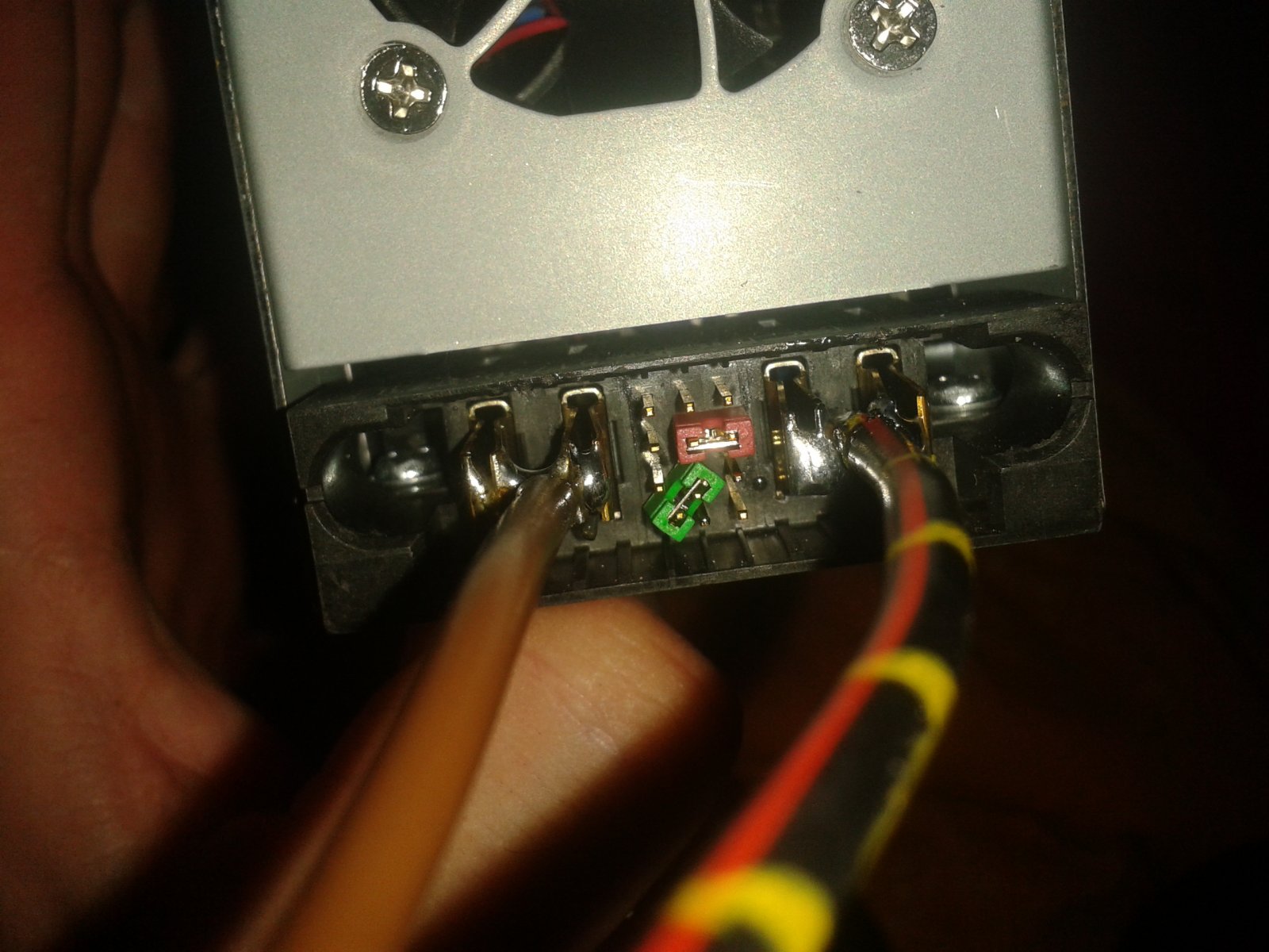

    I've you would like to buy 2 new Psus i would recommend you the HP DSP 600 PB. They are very easy to convert. To bridge it i only stick two jumpers in the front and solder two wires on.
    I use one Of this Psus and one MM per Motor.
    I've added a picture

    Thanks for the details @tombo . I've just ordered two PSU initially made for HP Proliant DL360, 700W and well recommended here (20€ each :) ). I have also ordered the two MM and Arduino. I'll cross my fingers for the MM, the Arduino can always be reused in another project :)
    I'll now wait to receive the first parts (motors mainly) to start building the frame. Will post some photos during the construction :)
    Again, thanks for all the replies and help :)
