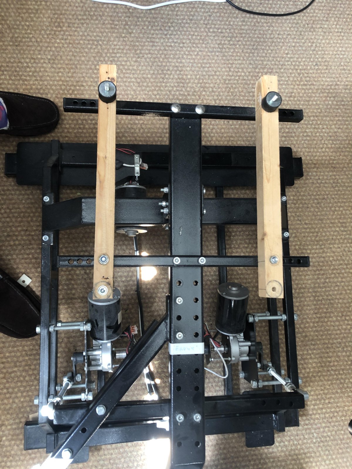

    I have a 3-DOF seat mover which happens to be by DOF Reality but is a design that’s been around on this forum for a good while. I haven’t used it for years because I was really disappointed by the backlash on the windscreen wiper motors due to the poor quality worm gears. Maybe its ok for driving but not for flying which is what I’m after. I’ve decided I would like to get it working again and I’m exploring the option of taking the windscreen wiper motors apart, removing the worm gear and attaching a two stage 3-D printed (polycarbonate) planetary gearbox with 100 to 1 (or so) ratio directly to the main motor shaft. I think 100:1 is the right ballpark. I’m looking around for a strong compact design for a planetary two stage gearbox. Any advice folks? Anyone think I don’t stand a chance with a 3-D printed gearbox here?

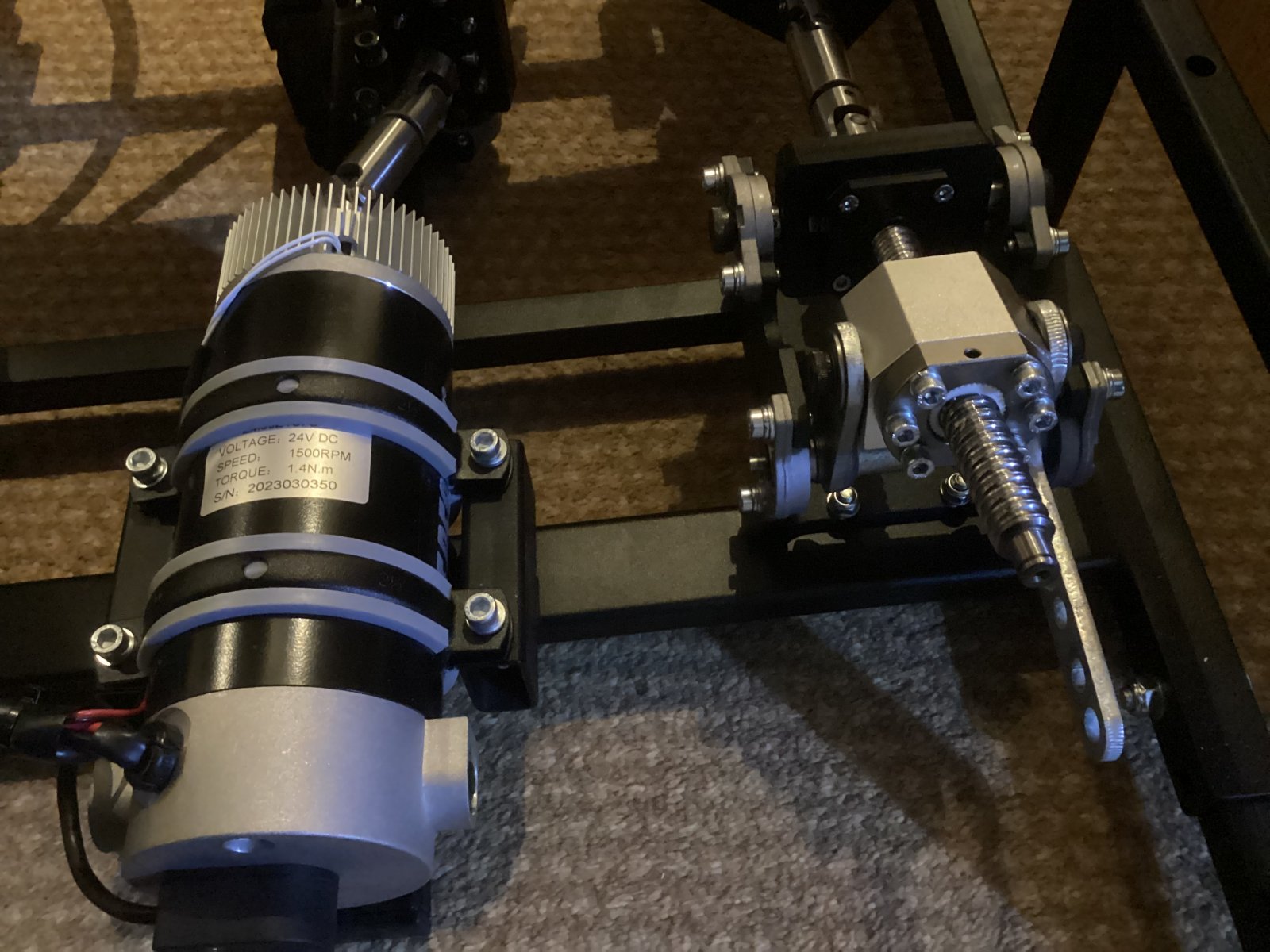

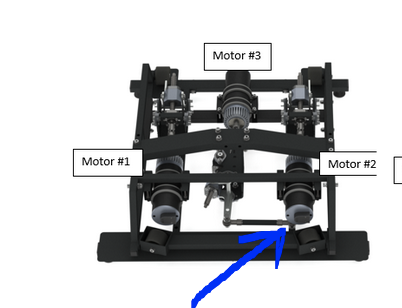

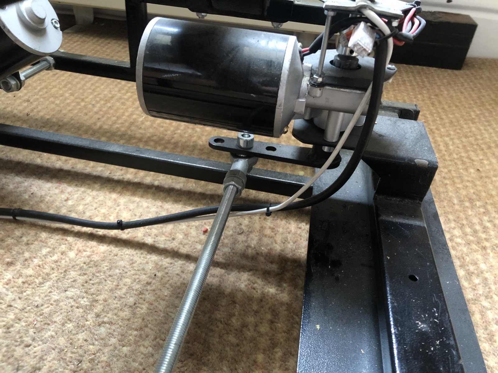

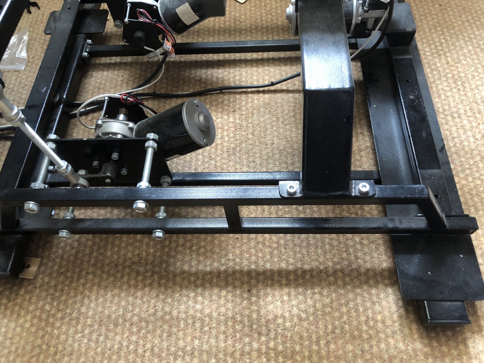

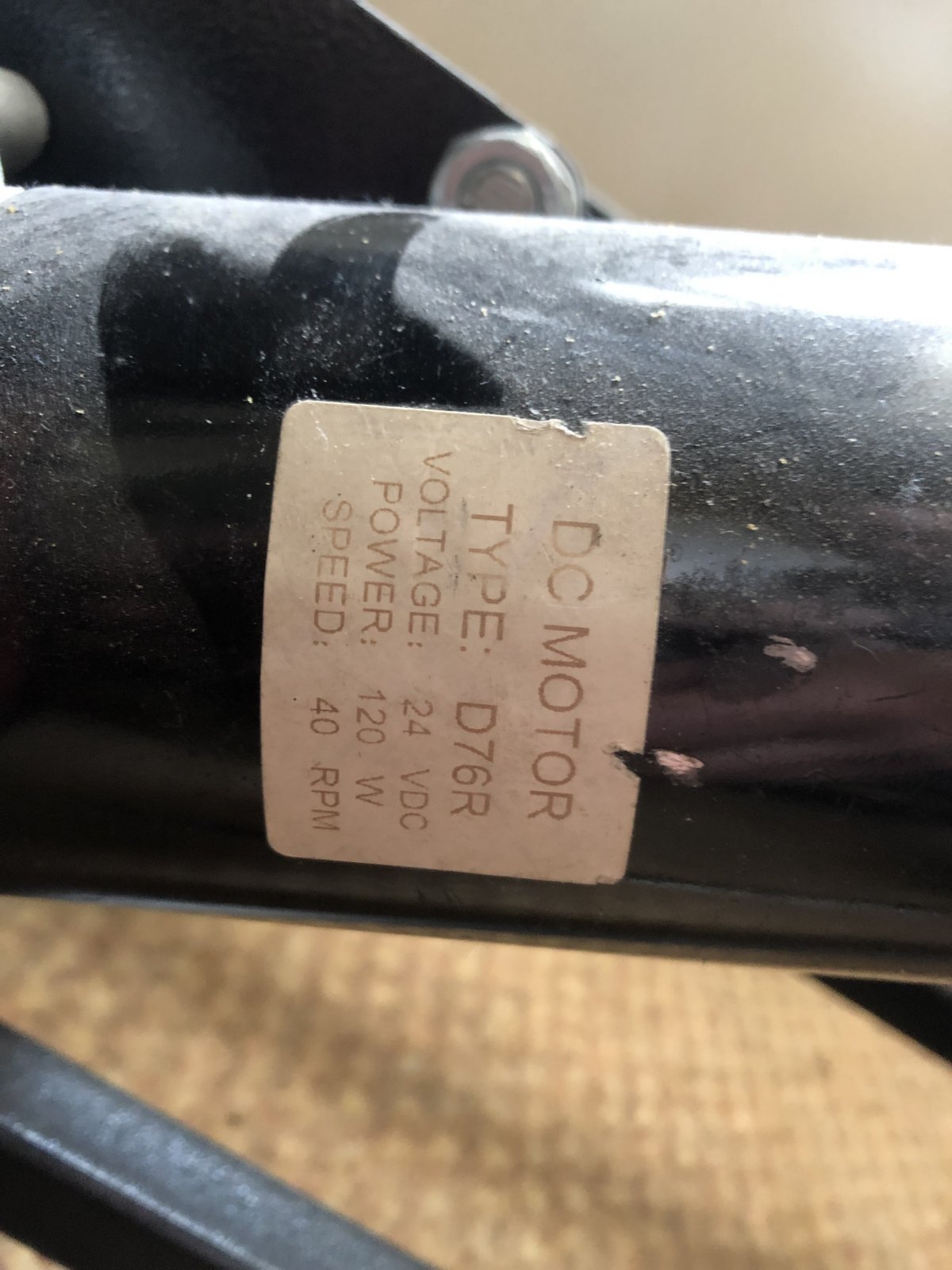

    Can you take a photo of your platform? (motor side)
    Maybe we can come up with something, considering the contribution of the first customers to the possibility of developing DOF REALITY.
  9. Spit40
    Spit40 VR Flyer
    Nov 3, 2016
    346
    United Kingdom
    2,913Coins
    +198 / 3 / -0

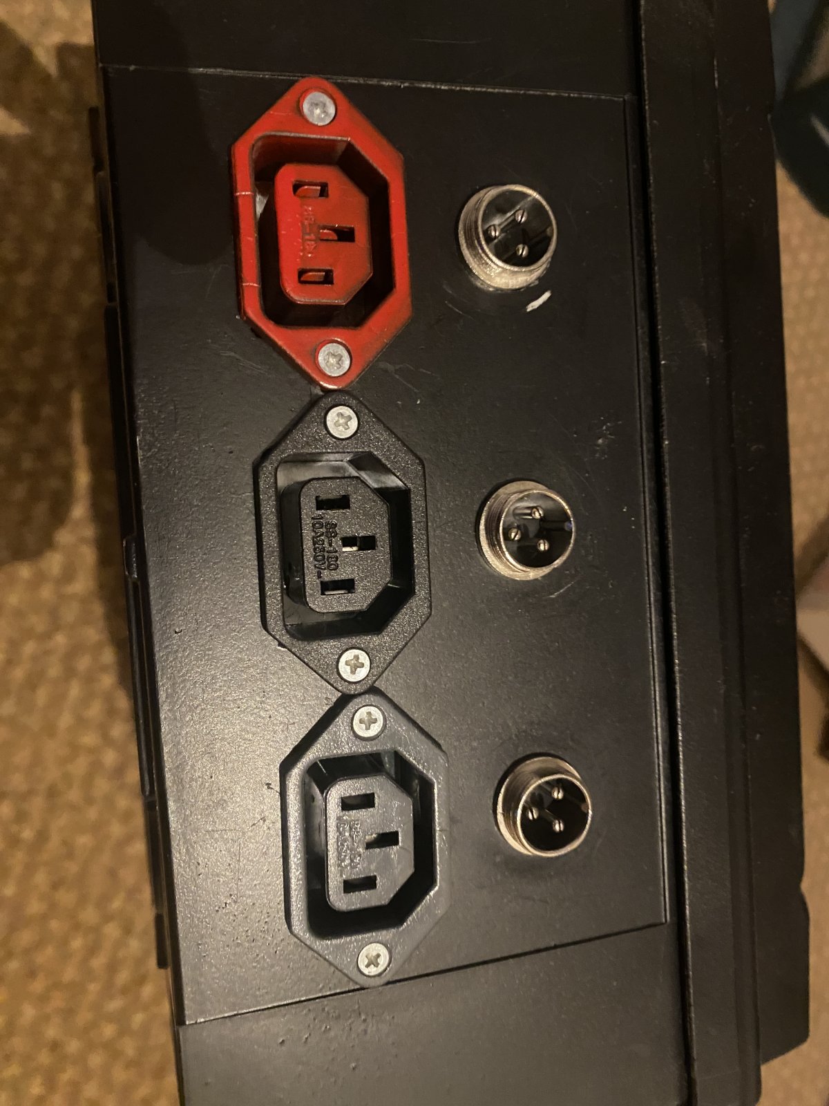

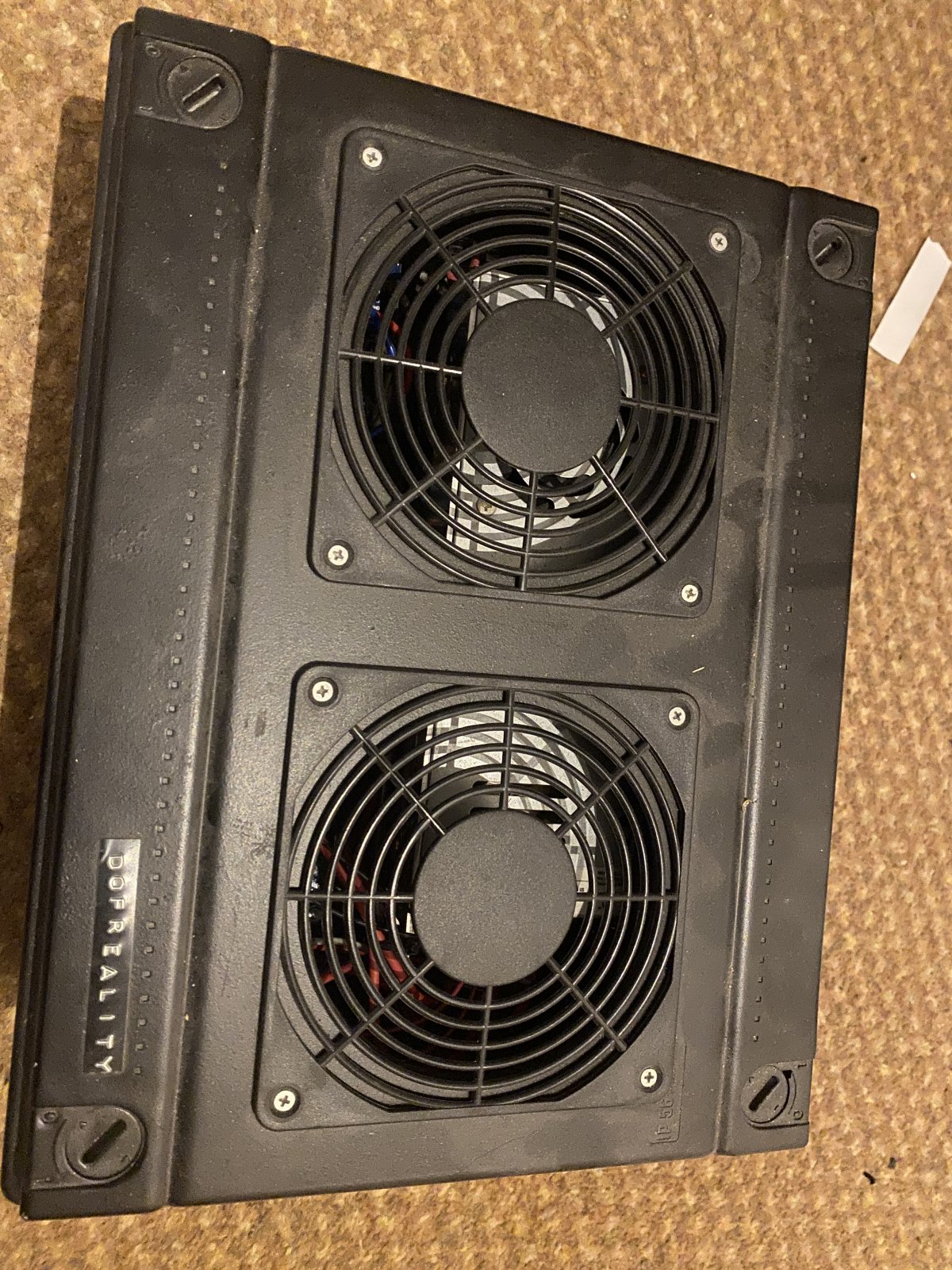

    That would be great. I got this in January 2017 so I always throught I was pretty close to customer #1 :)

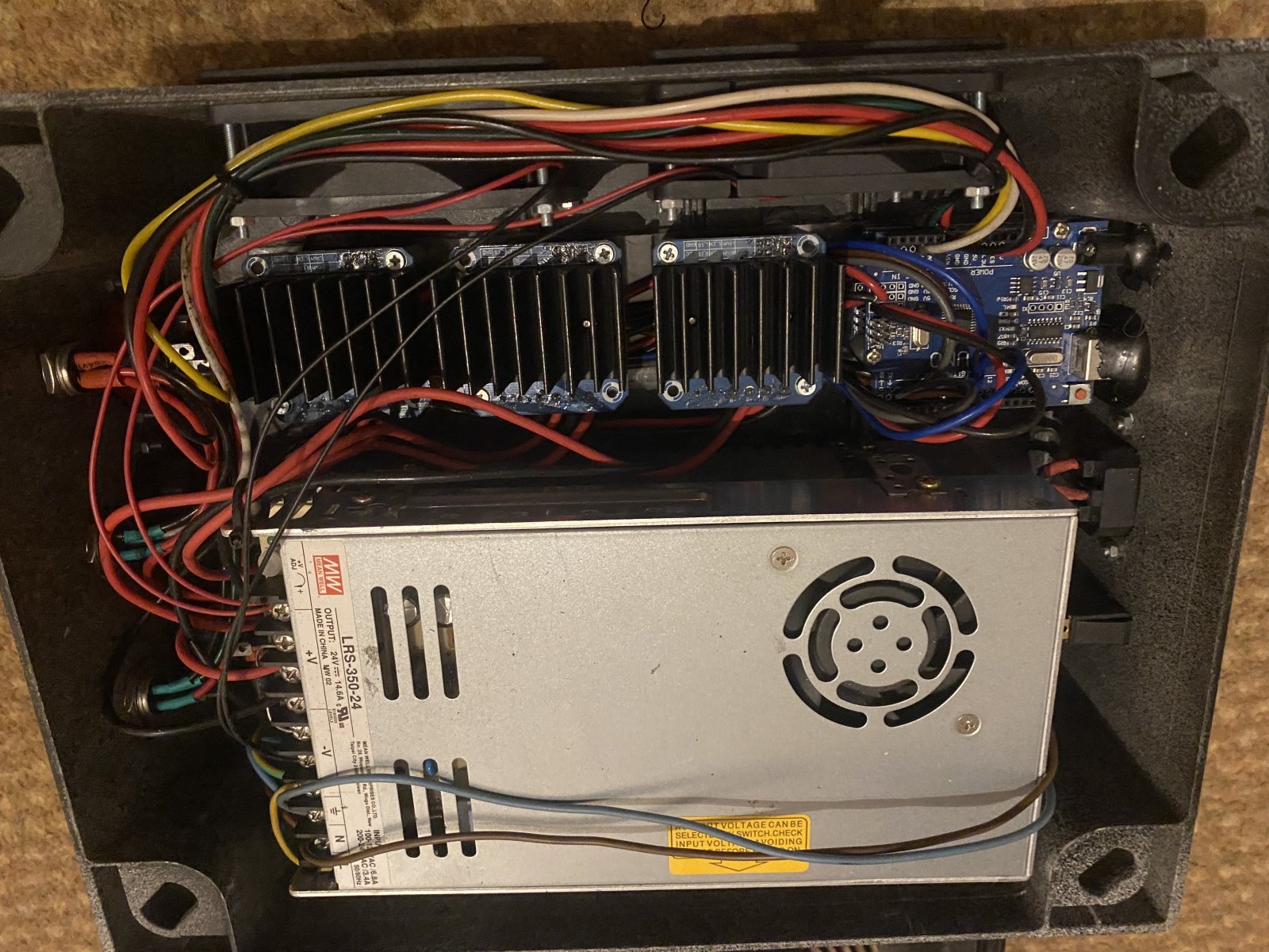

  10. Radioproffi
    May 15, 2014
    126
    Lviv
    1,579Coins
    +84 / 1 / -0
    How long ago was that)
    Can you also make photo inside the control unit, I want know what we can use from old staff.
