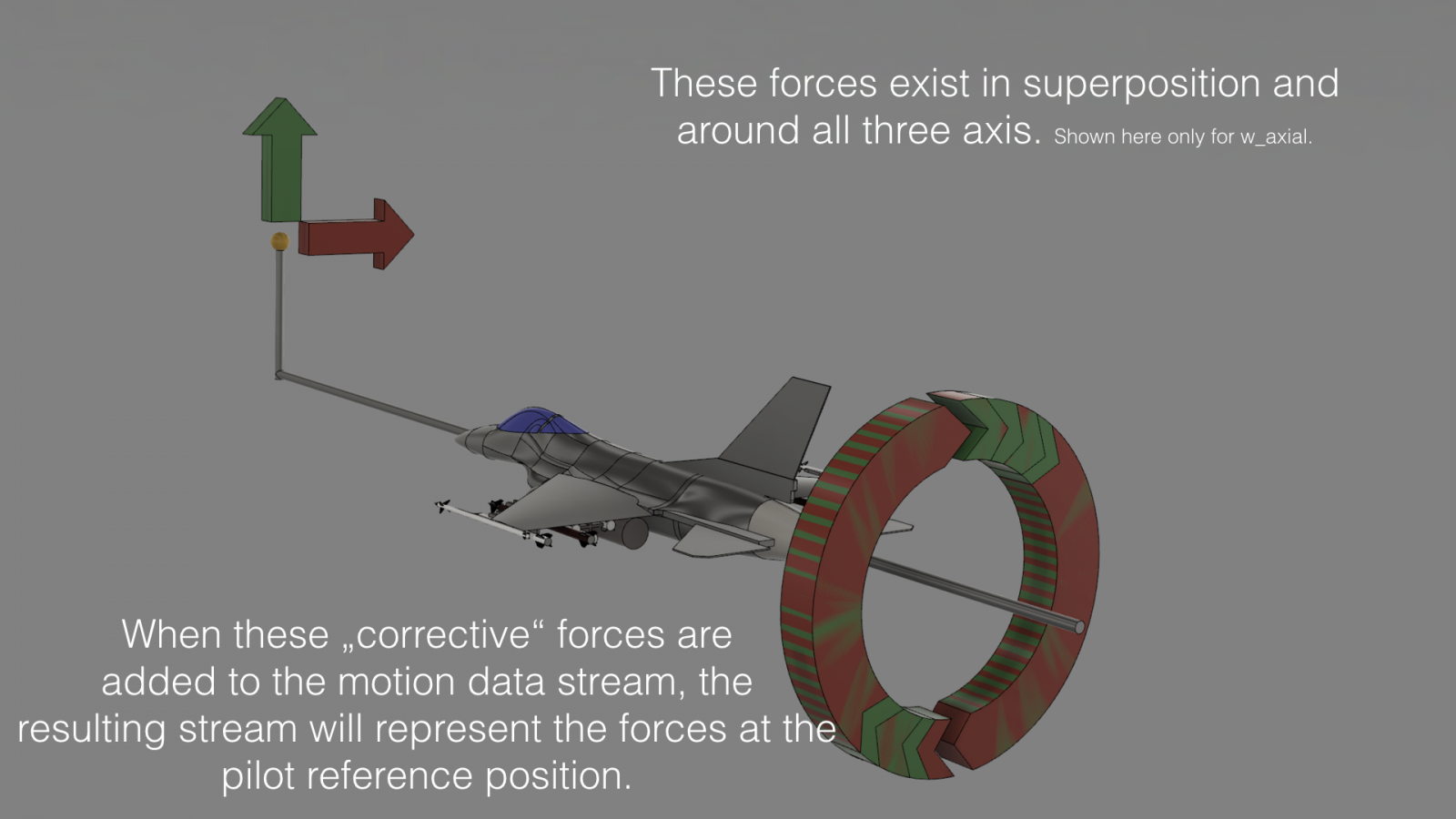

    This is a continuation from another thread. As discussed in the thread on my software, I want to correct the motion data stream coming from the simulator for the offset between the driver/pilot and the center of gravity (CG). I wanted to give this topic its own thread to be able to have a more in-depth discussion. I think this is worth being considered in motion cueing software. Especially for larger vehicles.
    The problem is this:
    The motion data the sim exports describe the motion of the vehicle as measured in the CG (best case scenario) or another fixed reference point. The driver/pilot however does not sit perfectly in the CG and thus feels different forces. I mean, he does feel ALL of the forces and moments present in the CG, but he feels some forces ON TOP that result from the angular velocities and angular accelerations of the vehicle around the CG.

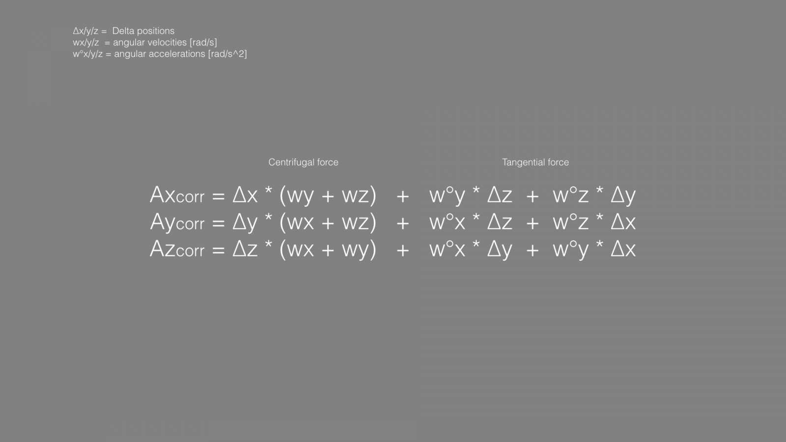

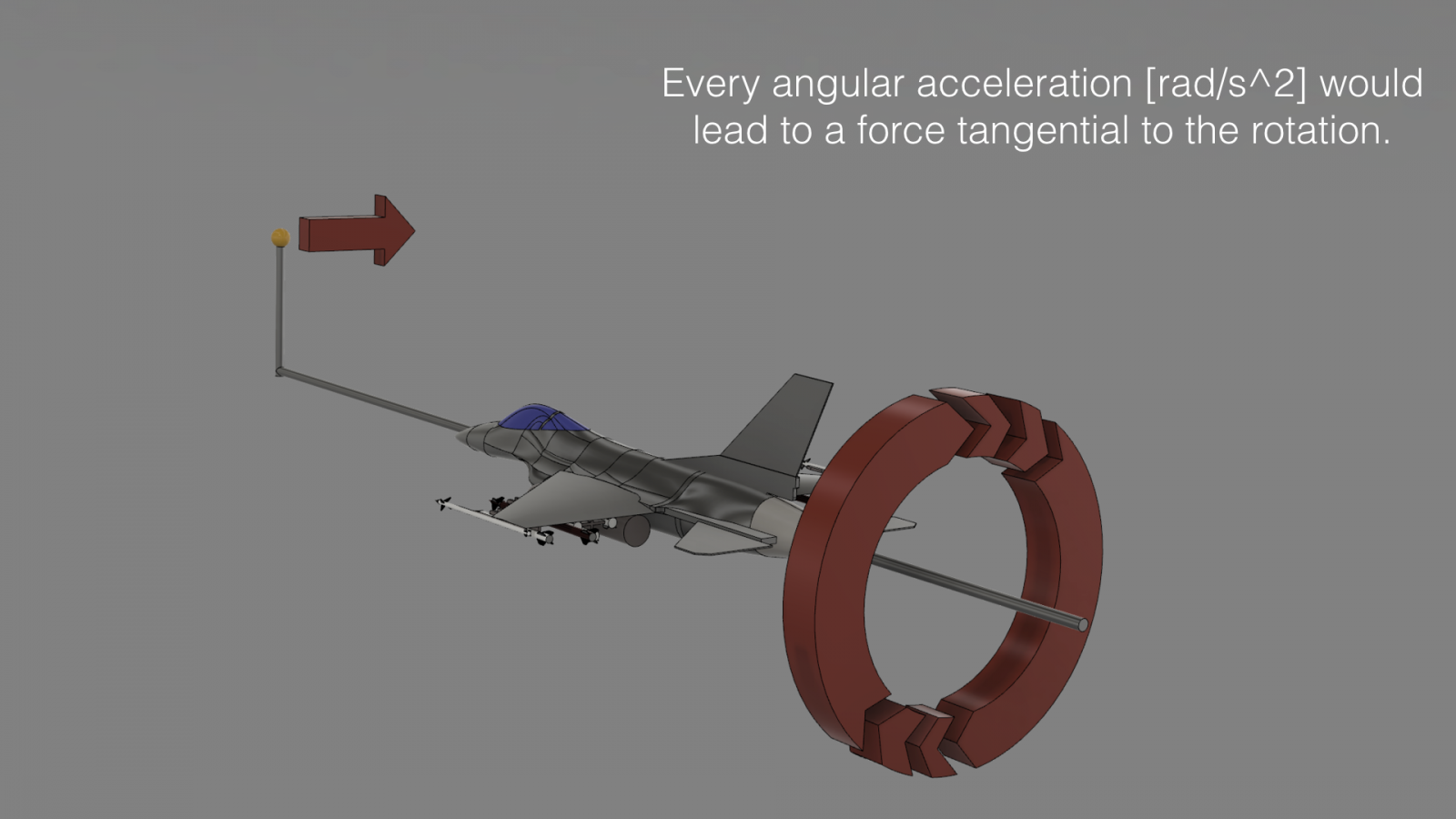

    If you want a motion data stream that represents the accelerations in the driver/pilot position, you will have to calculate those forces and add them to the accelerations in the exported stream.
    These forces are proportional to the distance between the driver and the CG (∆x, ∆y, ∆z). If your vehicle is a car, you might be so close to the CG already that you will barely be able to notice any change. However, as the distance to the CG increases, this effect becomes easily noticeable.

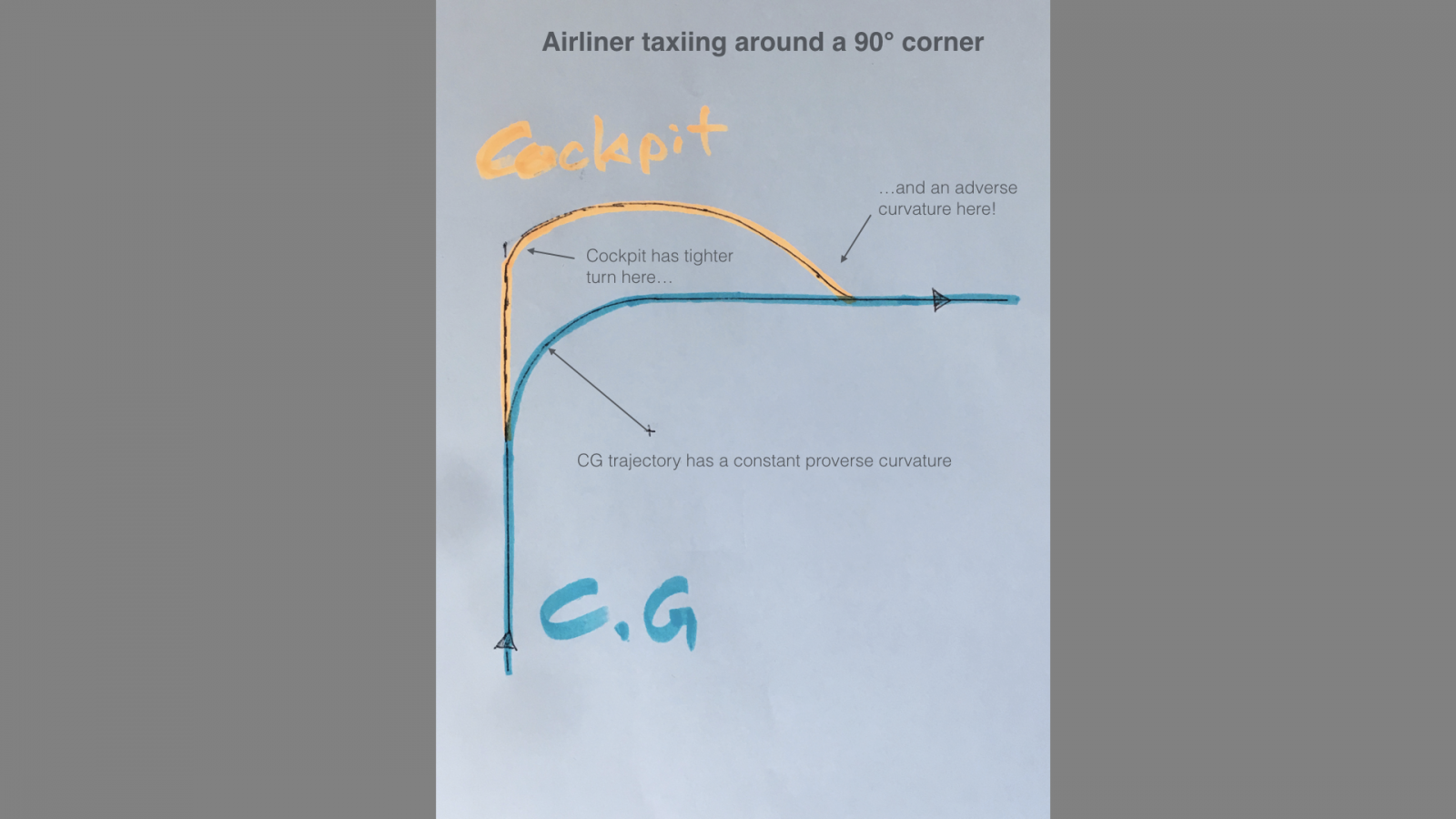

    When taxiing an airliner for example I’d even go as far as saying: These effects can become bigger than the „actual“ accelerations that result from curved CG trajectories:

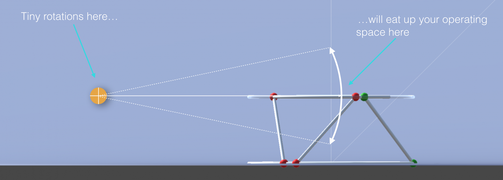

    Yes, it will indeed autocorrect :) But the further we go, even small rotations will eat up your precious operating space. This "just scaling the rig" is effectively shrinking your DOFs.
    Oh yes :) Correcting the stream at the source would circumvent that problem. We can utilise our full DOF ranges to cue motion to the user. It is just motion from a different location on the vehicle.
    - Offsetting the CoR (rig) will give you the sensation as if you were in another position on the rig!
    - Correcting the data stream at source will give you the sensation of being in another position on the vehicle!
    These two claims are important! Please tell me we're on the same page for both. Or tell me where I am wrong. I know it is hard following someone elses thoughts, but this is a distinction that will make a huge difference in the result.

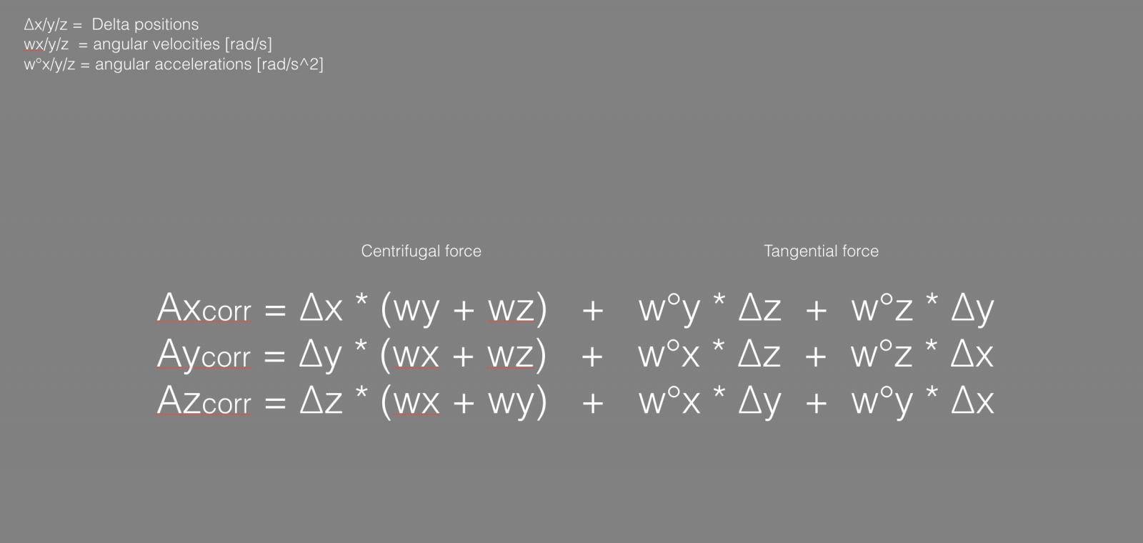

    So, here's something on topic:
    I'm gonna put a few claims out there and they are open for anyone to bust, confirm, doubt, support...
    1. The motion data we get from simulators is from some point on the vehicle.
    2. The data stream from different positions on the vehicle can differ substantially. Quantitatively and qualitatively. I argue for this point here:
    during taxi
    in flight
    3. The differences stem from centrifugal and tangential forces which result from angular rates and angular accelerations.
    4. You can correct those differences for other points on the vehicle with those formulae:
    5. You can apply these corrections to the motion of the vehicle.
    6. You can apply these corrections to the motion of the rig.
    7. The resulting motion from 5. and 6. are not identical.
    I put those out there for others to find elegant proofs or disproofs. Both will be equally interesting to read. I will not feel offended, I am not personally attached to any of them, because they are just that: Claims!
