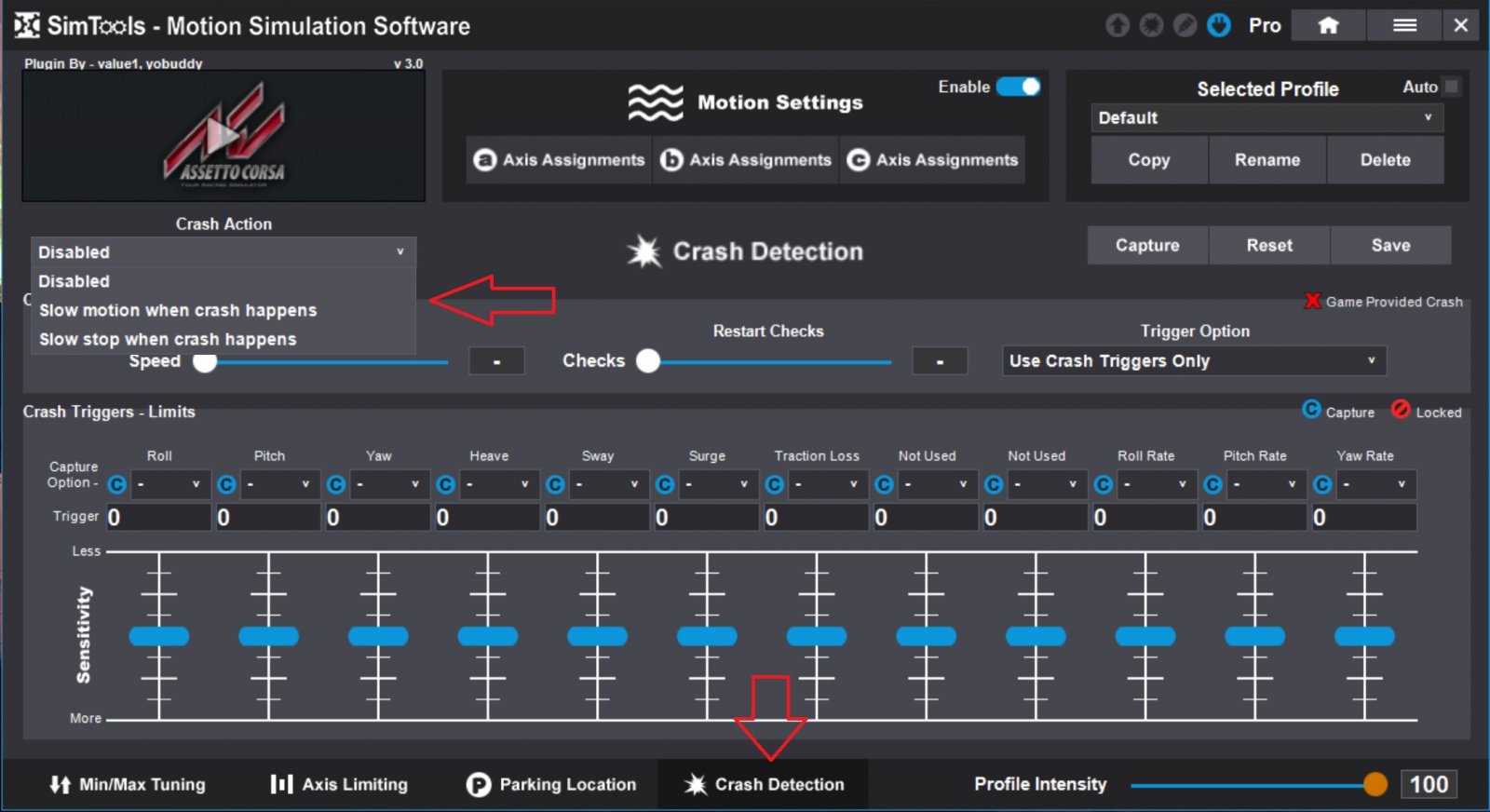

    Is there any way to stop movement when crashing In Richard burns rally?
    I dont like that crazy shaking when I go off road.
    I did ready simtools manual but cant figure out is it possible to stop movement.

    You can in SimTools v3:
