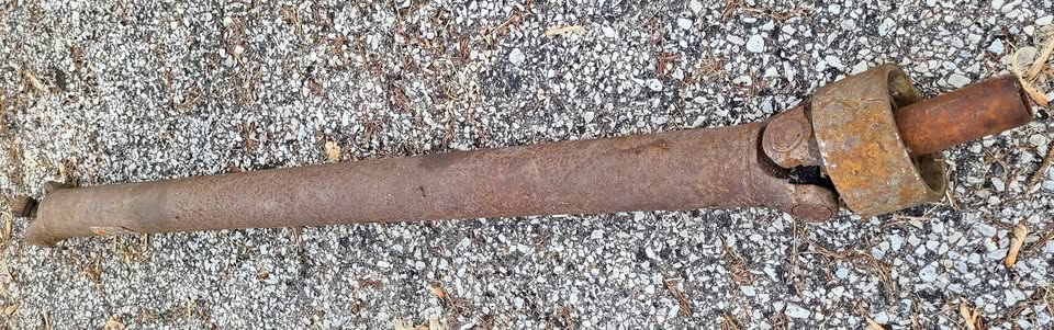

    hmmm, how about something like that?

    Yes an old tailshaft like that works well and is very robust.

    Thanks, I'll check if it's available and I'll put an offer.

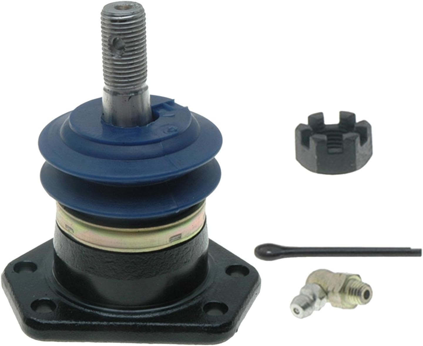

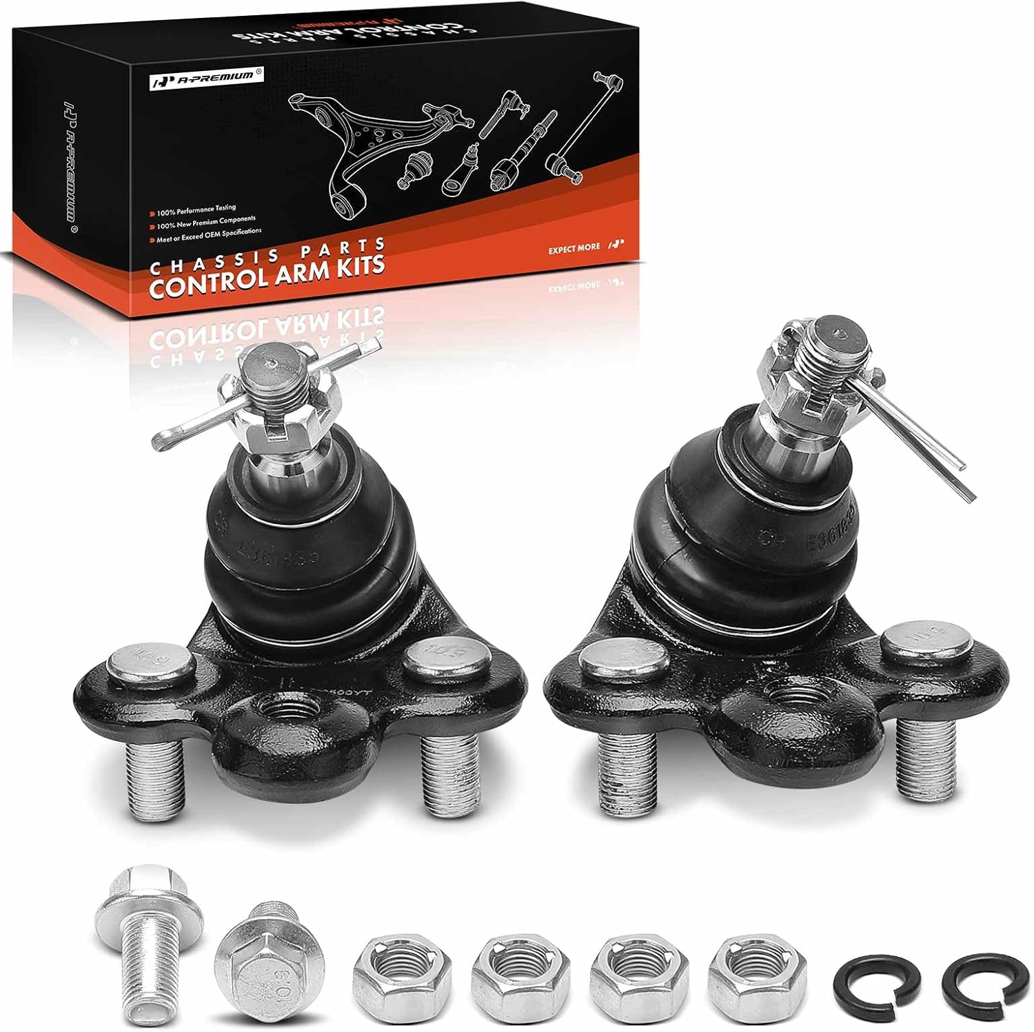

    How about a ball joint? They are cheap $10 - $20 and new. Easy to find. What's your experience?

    A poor choice in my view, as you have to then control for lateral rotation with the likes of panhard rods, unlike a U-Joint which prevents that in a way more compact and robust form, if suitably sized.
