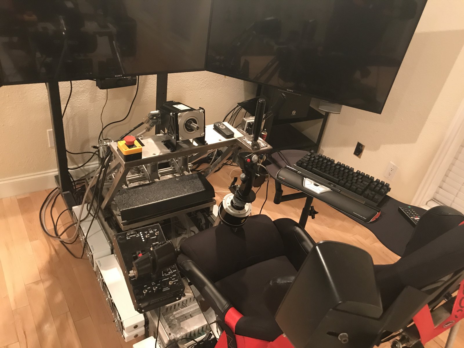

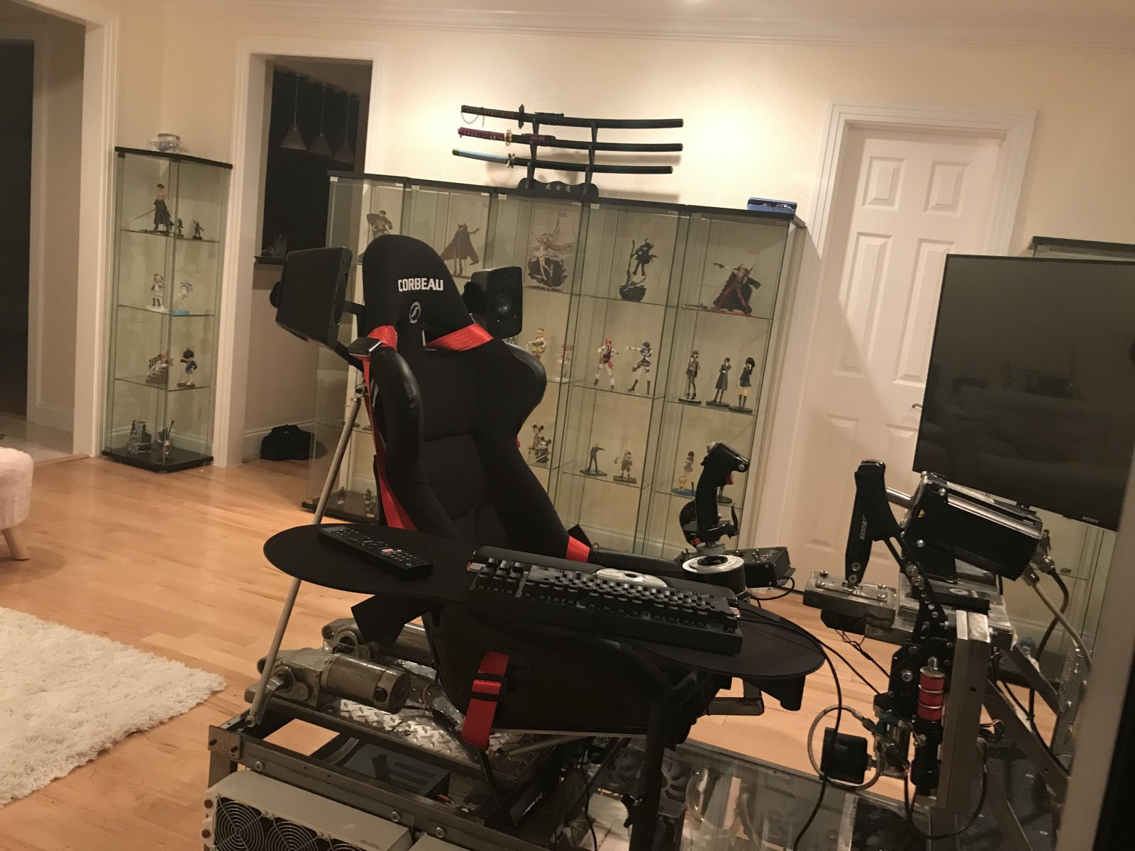

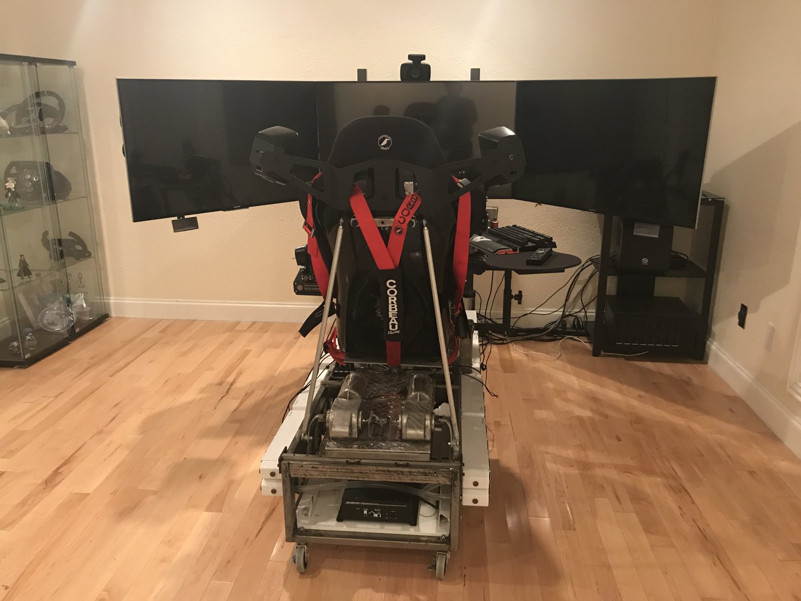

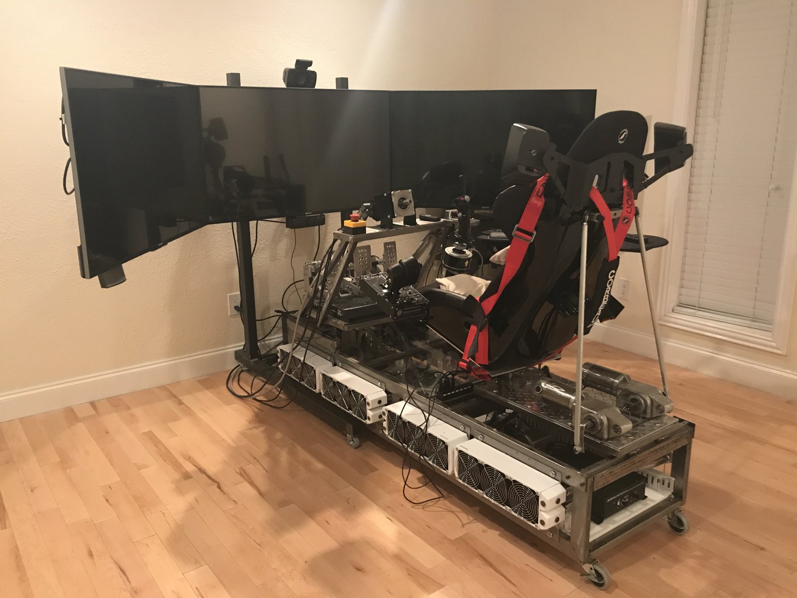

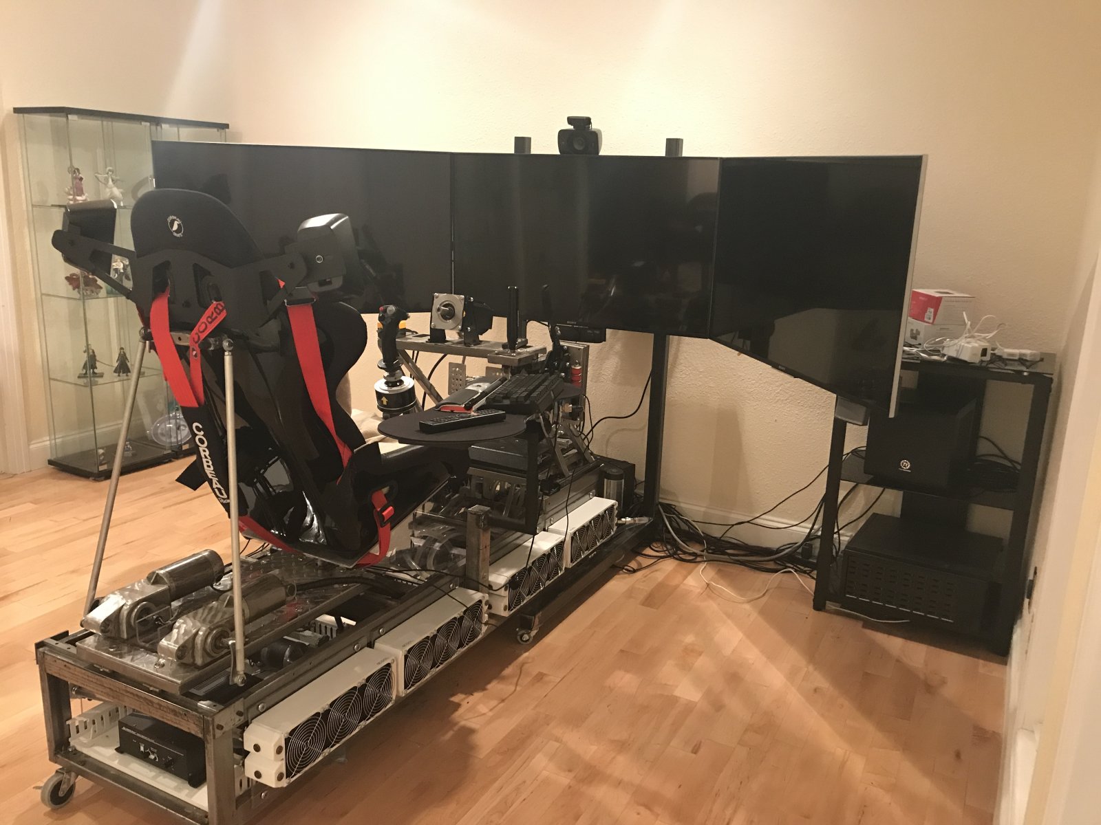

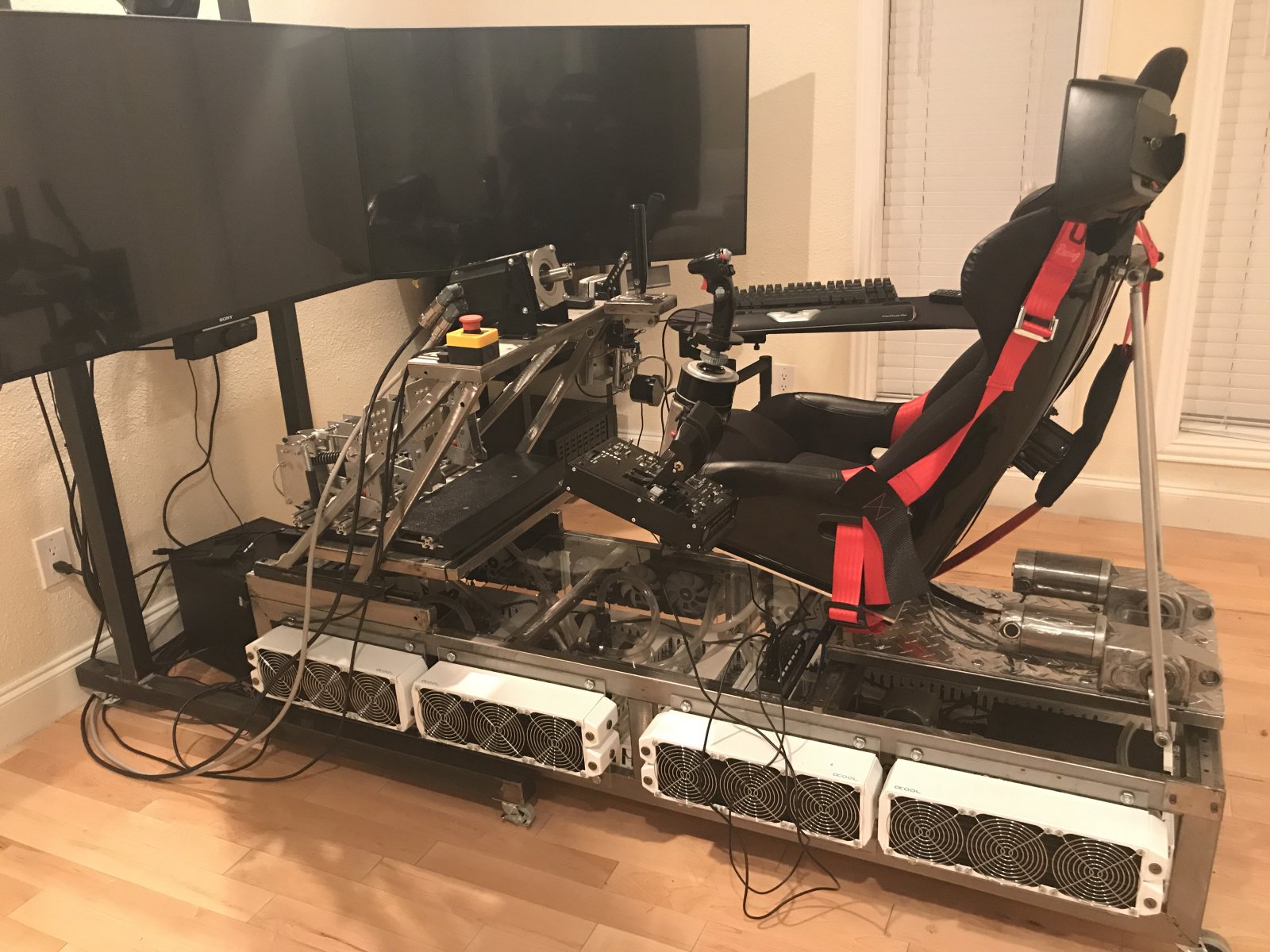

    Here is a picture of the original Rig i will post more of my progress on how i built my CXC Racer Replica Rig...
    CXC Motion Sim
    This is my Motion Simulator

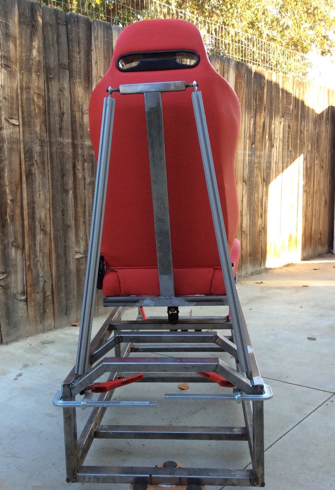

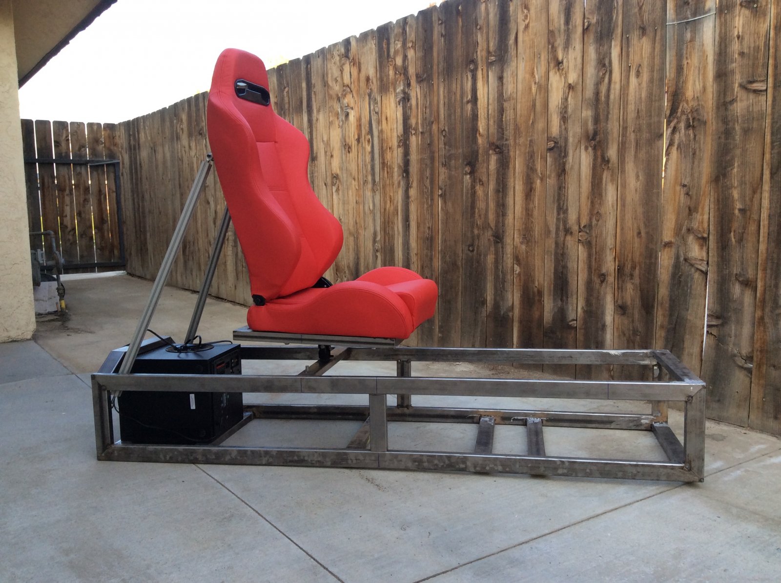

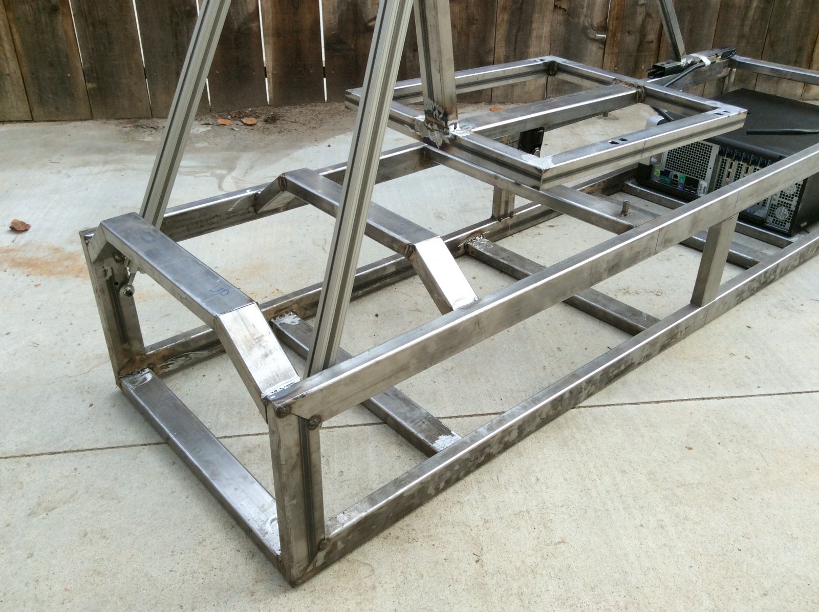

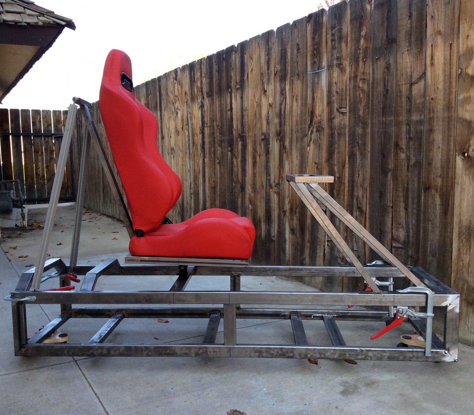

    Here is an update the frame is almost done, tomorrow i will do the dash.

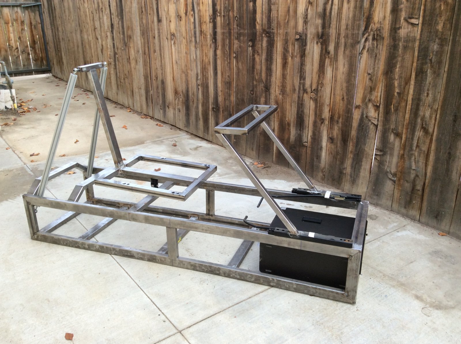

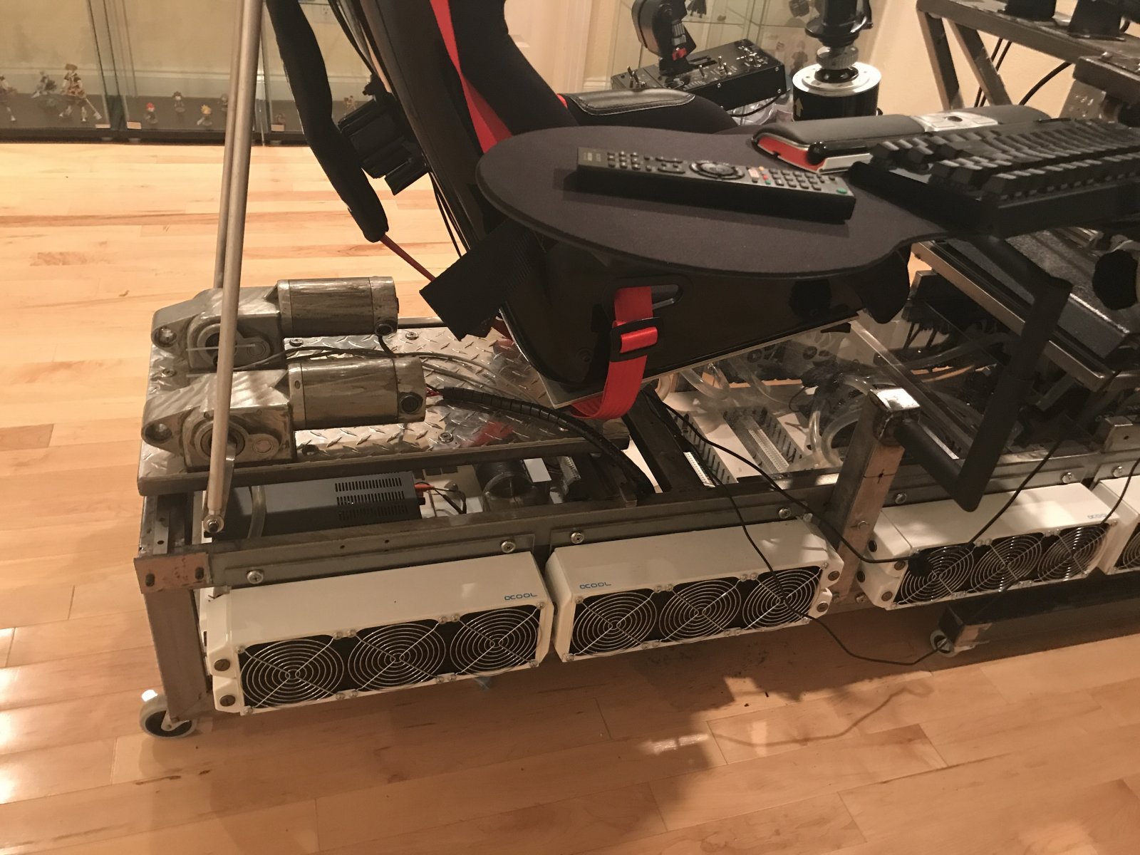

    image.jpeg More pictures...

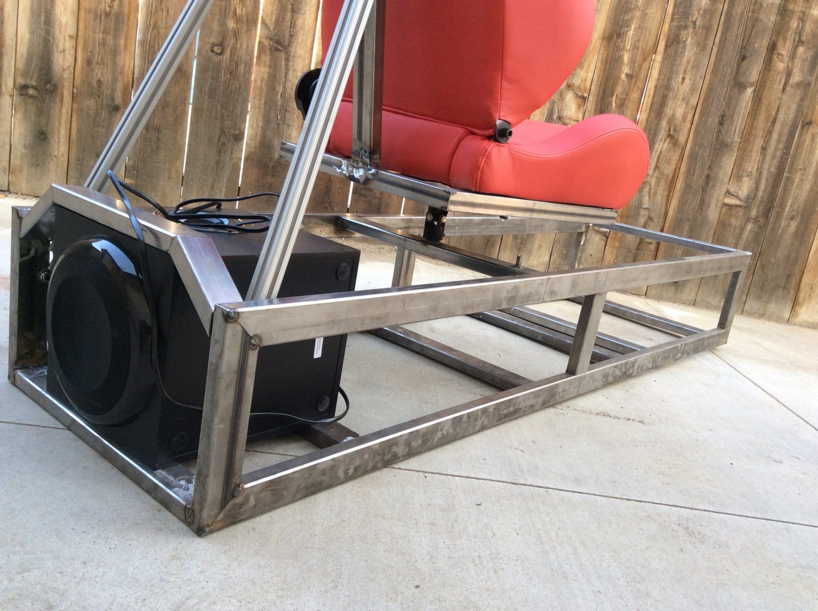

    3DOF, JRK

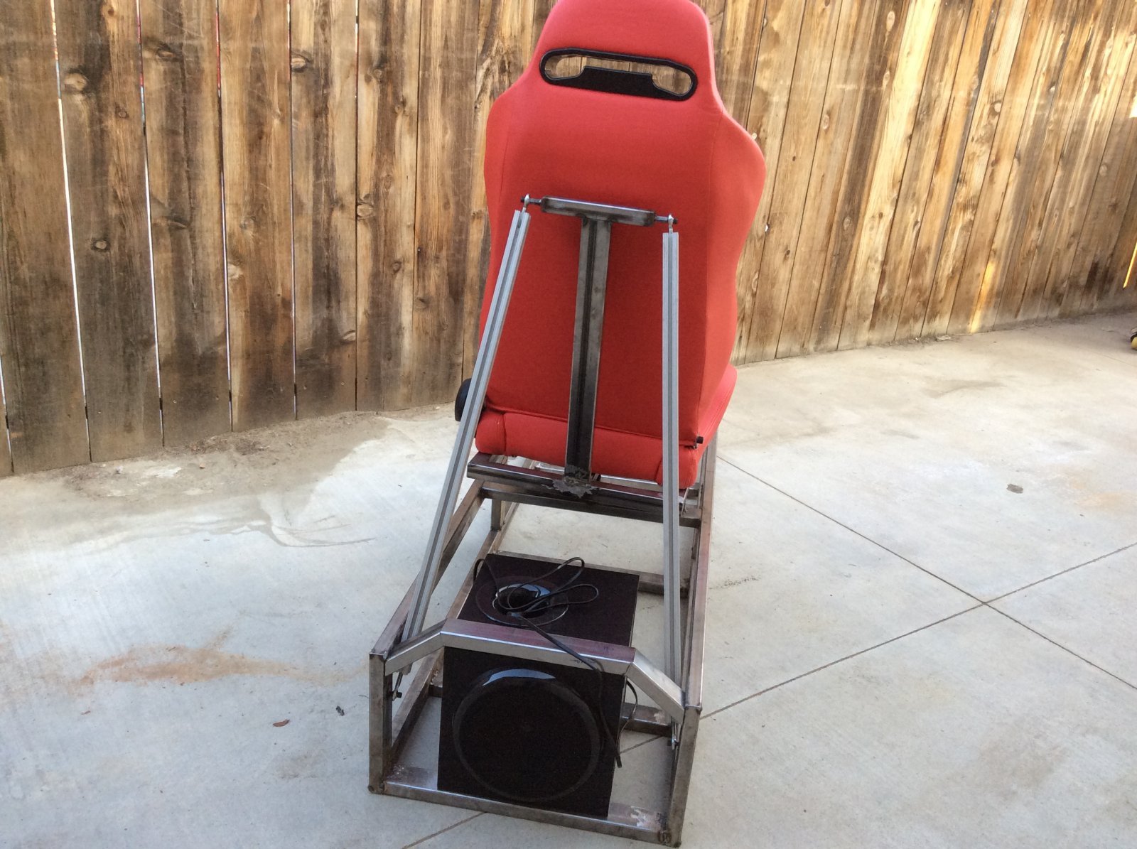

    Speaker is in!

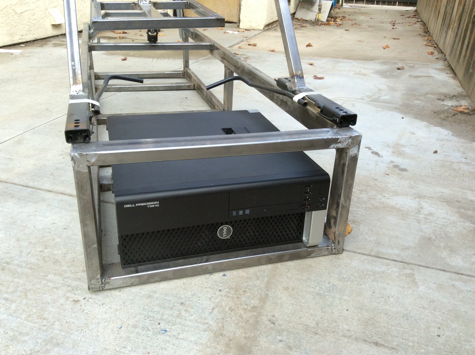

  7. bsft
    Nice job, did you allow enough room for the computer to slide inside the frame?

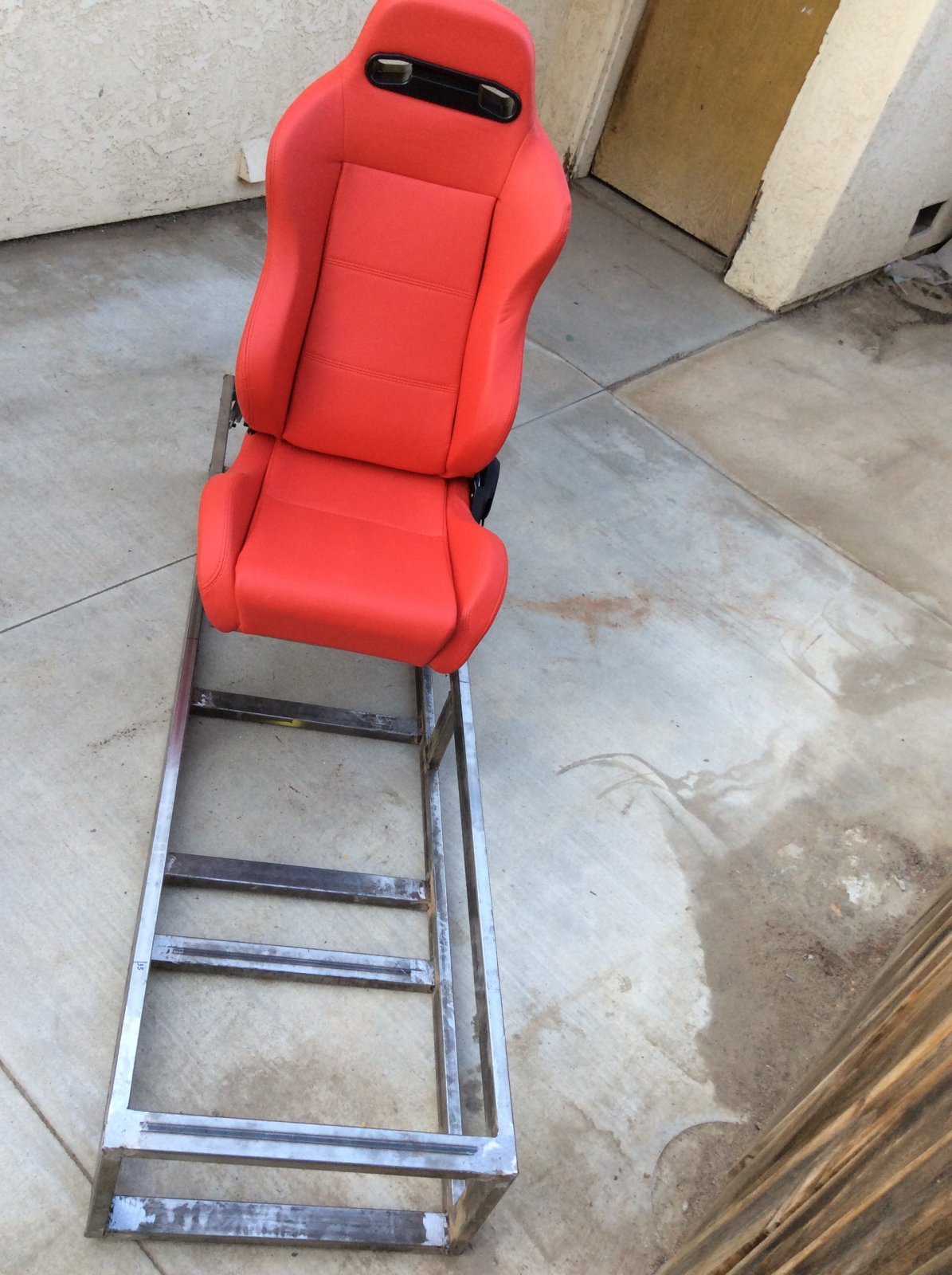

  8. cgodwin
    cgodwin Active Member
    Sep 18, 2015
    225
    Engineer
    Eugene, Oregon
    2,478Coins
    +278 / 2 / -0
    That is great progress for 1 day! Did you draw up your design first, or just start building?
  9. Nick Moxley
    17,055Coins
    +2,505 / 30 / -2
    Can i Suggest some Triangle corner Gussets on the rear of the seat frame. Last thing you want is any torsional Twist on that part. Also the Higher up you have your Rod end mounts the More leverage you have. Lifting from below the shoulder's isn't exactly ideal as far as the mechanical leverage is concerned. Granted Its a seat mover so Its not like the motor's are lifting a Great deal of weight, But every wee bit of leverage counts.
  10. Milton
    Nov 11, 2015
    345
    Dallas Texas
    1,989Coins
    +320 / 4 / -0
    3DOF, JRK
    Thanks! Also i just notice thank you so much for the gift!...
    I check and the computer fix and it has plany of stay.

    I will take your recomendation and rise the bar.. Thanks for your absorbation, i do realy appriciate.

  15. bsft
    Nice stuff, is that a gaming pc? or is the case just for measuring up.

    3DOF, JRK
    Thanks! The computer is a Dell T3610
    Here is the spec
    3.7 GHz Intel Xeon E5-1620 v2 Six-Core
    16GB of 1866 MHz DDR3 ECC Unbuffered RAM
    With 2 NVIDIA Quadro K2000 Graphics Card (2GB)
    1TB 7200 rpm SATA Hard Drive

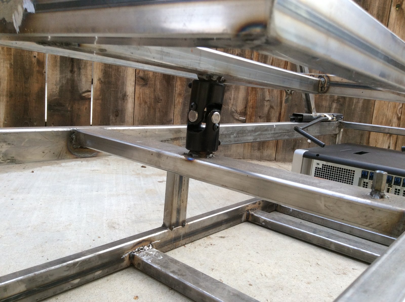

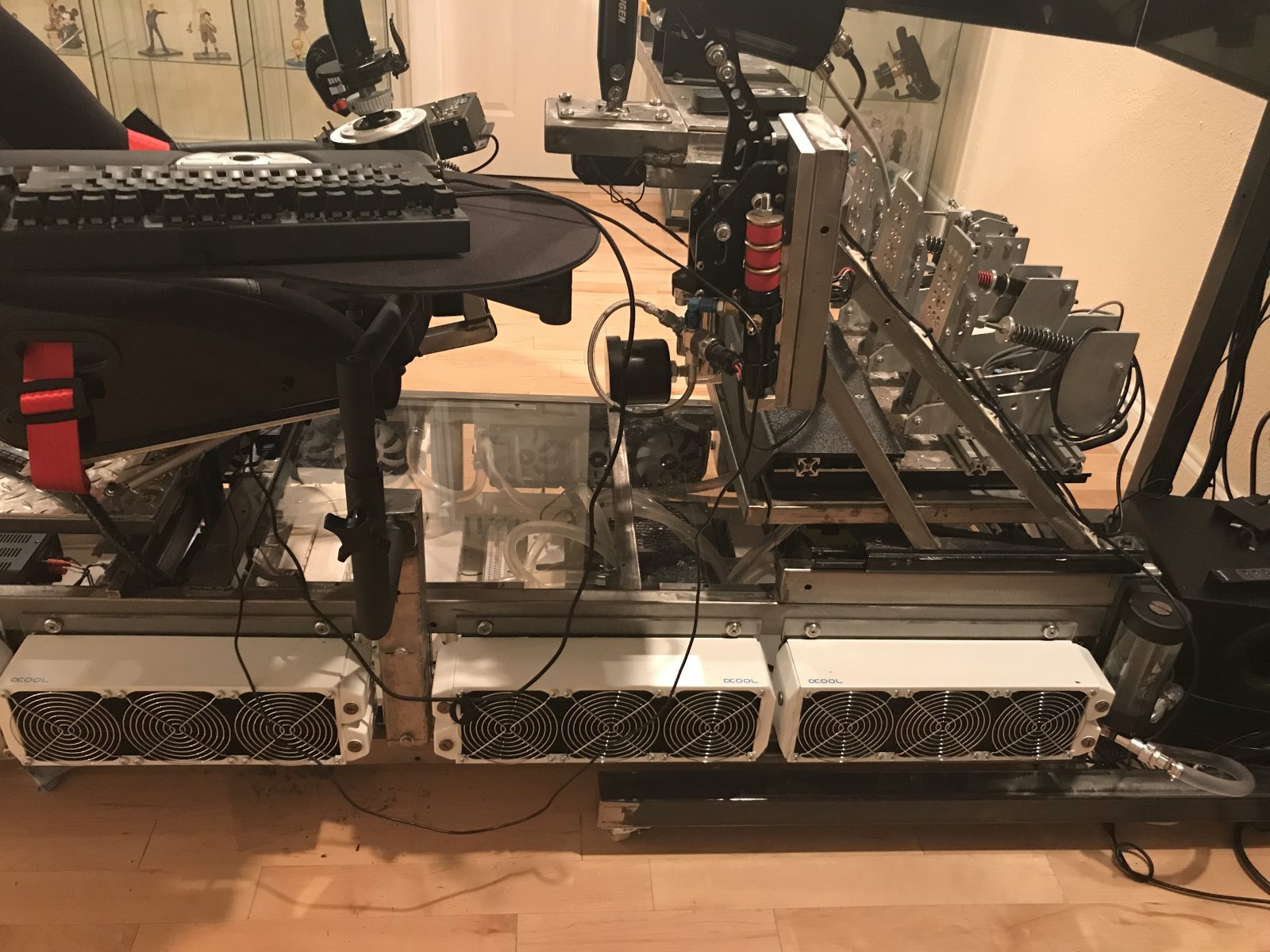

    Here it ie an update on the frame, i rise the sit bar about 5 inches, and and got the dash frame almost done.
    Here it is some pictures of the work so far.

  20. bsft
    OK cool, the graphics card is a bit slow, so it may struggle with games, mind you, wind down the resolution and you should be ok.
