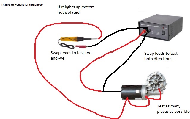

    Motors, wipers can be a start , but you need to earth isolate them. Find the earth point using this diagram
    hopefully you do not have to pull apart the motors. Try to find as cheap as possible and from a large passenger car will do nicely. Use 12v for 12v. DO NOT use 24v on 12v, half the speed , half the torque. ergh.
    I ran $10 wipers on my first builds. If one was too hard to earth isolate, I tossed it out and bought another.

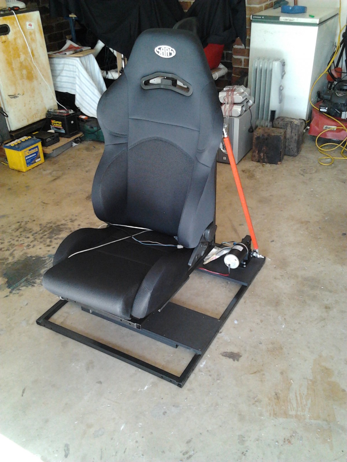

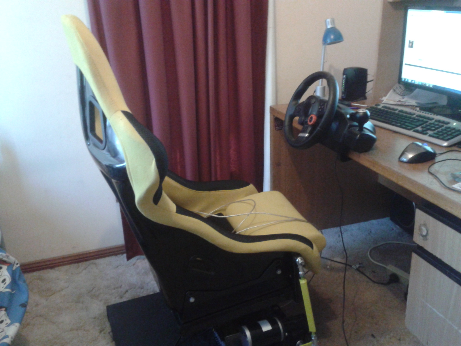

    this is my existing static setup. the stainless panels you see between the seat and the base are not standard the person I purchased it off put those in so I was thinking, remove them. put in CV joint. and extend the bottom rear of the actual frame (not the seat) to house all the motors and wizardry. maybe make a new frame to house a better seat. as the guy who owned this one was possibly the scruffiest, smelliest C*** iv ever met.
  5. bsft
    http://www.pololu.com/catalog/product/1393 one per motor. 7 wires, one usb cable, hook up a pot on the motor shaft for feedback.
    The graphics on the laptop would probably not run it. But you could use the laptop as motor control, then a half decent dual core, 4 gig ram and decent graphics card for main game use would do the job. 2 PCS. Or if you want to splash put a quad core pc. Use windows 7 though. I have 2 sims, one has main sim pc for games and talks to laptop for motor control, the other uses a quad core pc for all in one.
    I know what its like to have no money, dont panic, you will get there in time, a bit at a time.
  6. bsft

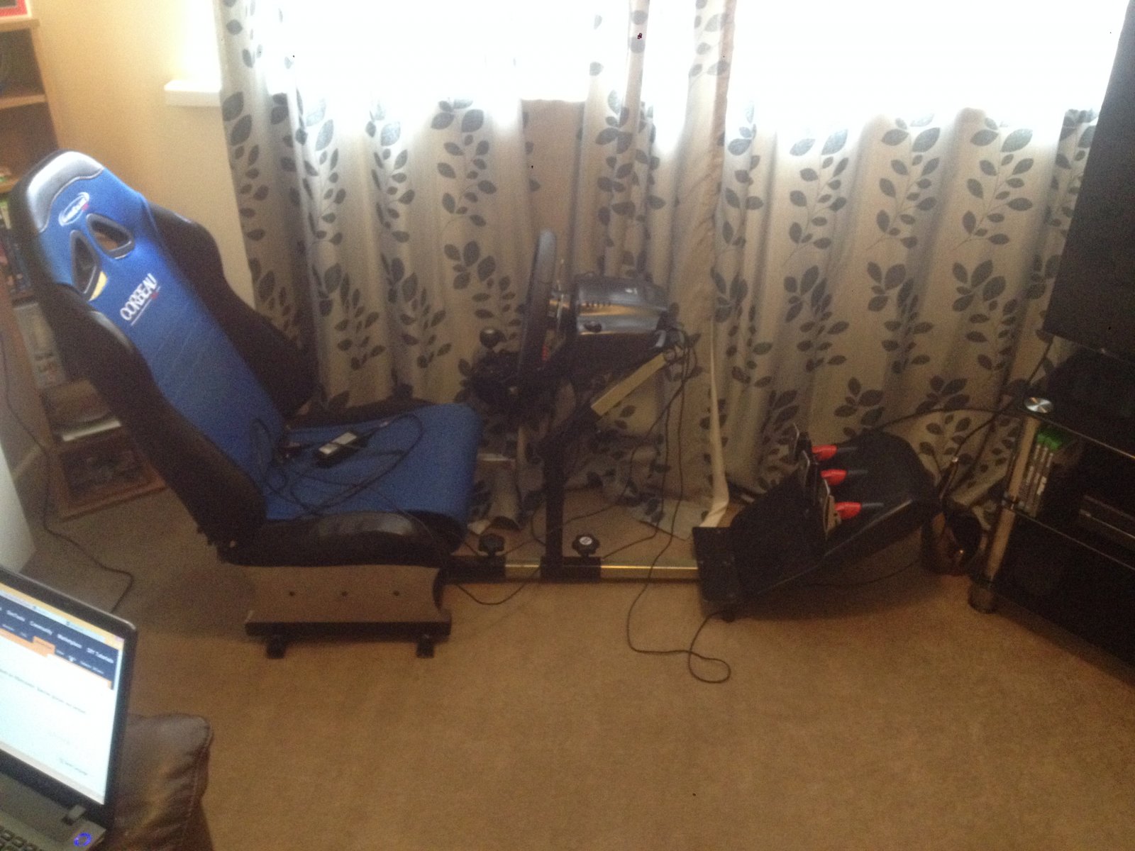

    thats convert possible, with a frame like this
    or like this
    Cheers, David.

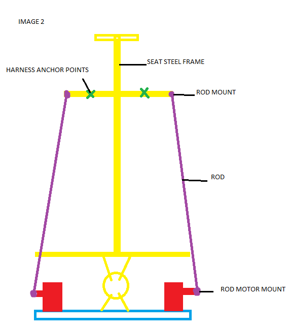

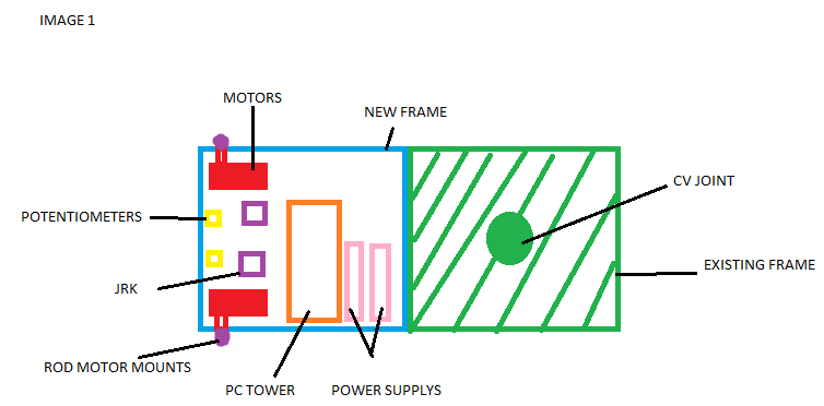

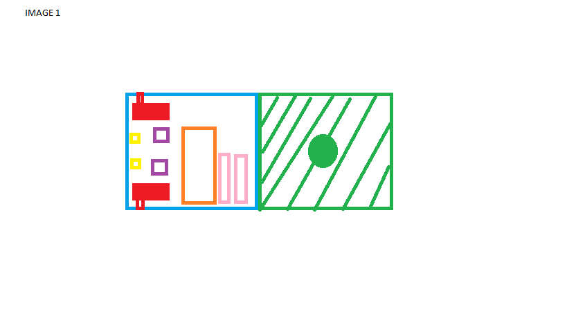

    before we go any further, the images here are not an overall example of my creative ability LOL. they are shocking I know but if the get the job done that's what counts.
    this first diagrm is for the locations of the electrical components I think this is a pretty generic design and very similar to many peoples versions of this.
    this second image is my interpretation of a shoulder mounted device. the very top bar of the yellow being the headrest support. the only thing that I cant show is the arms that are going to attach the rods to the motors. a few that I have seen have varied in length, but I think im going to go with between 50 and 80mm between the centres to give me a (what I believe) larger throw and therefore a bigger movement on the chair.
    im here for you help so if iv overlooked something I would really be greatful as it would save me sorting out an error made now when it comes to welding it all up.
    thanks again

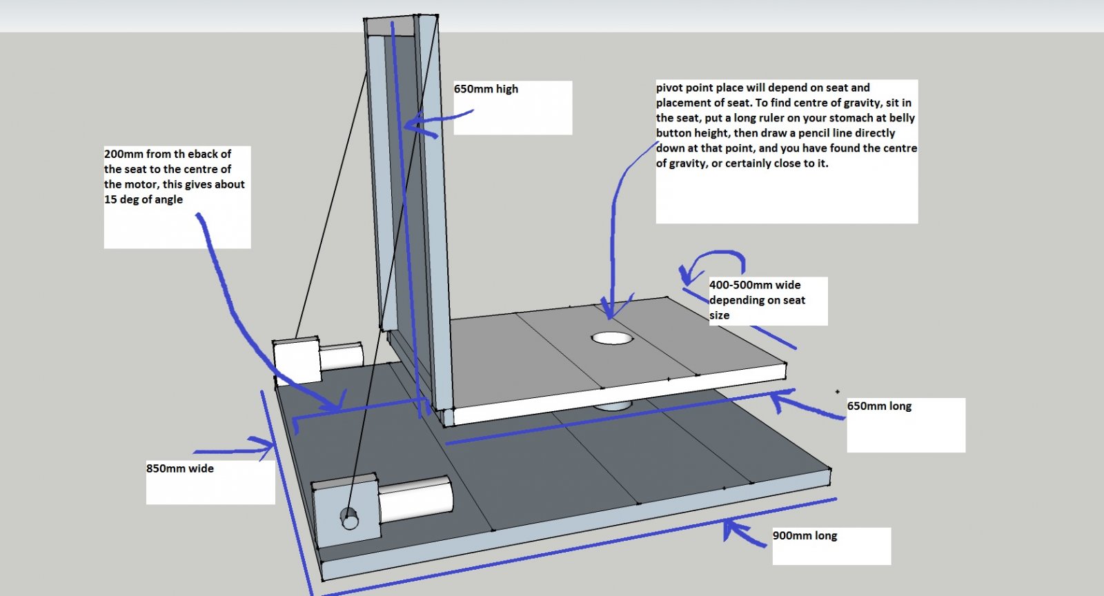

  13. bsft
    does something like this help?
    otherwise, you look to be on track
  14. MattAKAbez
    MattAKAbez New Member
    Apr 10, 2014
    8
    341Coins
    yeah that is a very good diagram and shows me that I don't actually need to extend the rear of the frame by as much as I had thought. ill get together all the components and pack them as tightly as possible and see what sort of size frame im going to need.
    welding rods have been dispatched, scrao yard visit tomorrow for motors and joint. should be fabricating by Monday :)

    Back on the diagram I posted, I built my now sold dc motor seat mover more or less off those dimensions. Base was 750mm wide from memory on mine, but it move a 130 kg bloke easy.
