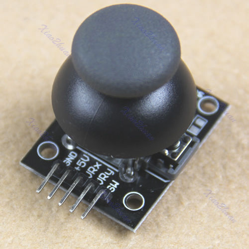

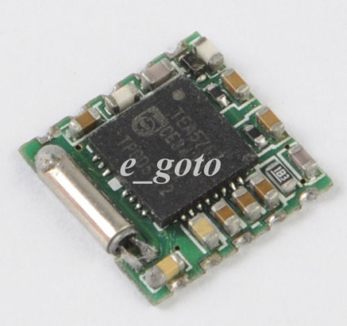

    last night i can't sleep so i dra scheme of dash :)
    On LCD will be menu where i can: tune radio, temperature monitoring (PC and sim tempeature) and other information from game.
    In menu I can move with joystick.
    the radio modul is TEA5765FM with antena from old wifi router
    The gauge wil be control ULN2803 there is where is 8 channels and I use only 3 (fuel, fuel light, temp) for now. But sometime in the future there may be more gauges.
