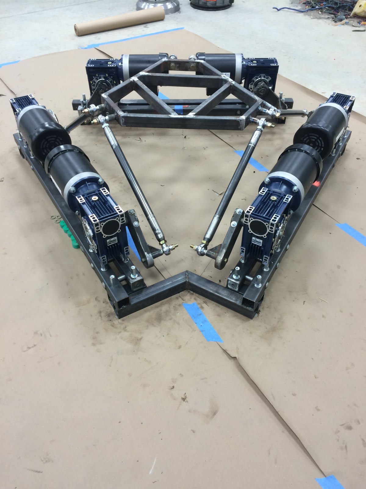

    Hi All,
    Well I decided to jump right into the deep end of the pool. I am building a 6 DOF AC motor driven platform. Not sure how much interest there is so here is where I am right now. Let me know what you think. 24980266246_1aa136711c_o.jpg
    -GA Dawg

    What are the actual dimensions and what motors are you using?

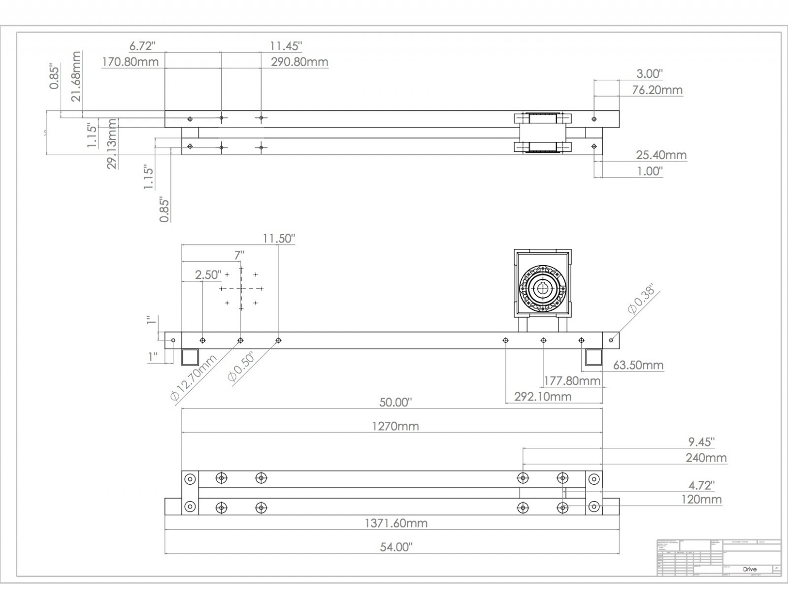

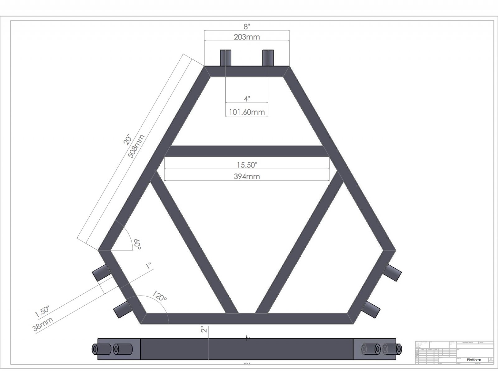

    Here the dimension I did in Soildworks.
    The levers are 160mm center to center and the rods are 630mm center to center. I am using 3/4hp with 80:1 gearboxes

    There AC 3/4hp 220v 15amp each

    Here is another view. The ends are bolted to the drive rails. That way I can move it should I have to. Not sure of the total weight but it's not light

    Here is the high dollar items in my build (I am sure some are thinking what the F$@# was he thinking spending that much money but it's cheaper than my spec car)
    All prices are in US dollars
    Motors = $700
    http://www.automationdirect.com/adc...-Phase_Motors,_56C_(0.33_-_2HP)/MTR-P75-3BD18
    Gear 80:1 = $1100
    http://www.automationdirect.com/adc...orm_Gearboxes_(Speed_Reducers)/WGA-50M-080-H1
    VFD = $1300
    https://www.driveswarehouse.com/p-2525-wj200-007sf.aspx
    Brake Resistors= $ 1100
    https://www.driveswarehouse.com/p-1089-srb300-1.aspx
