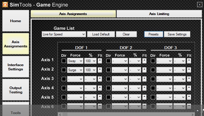

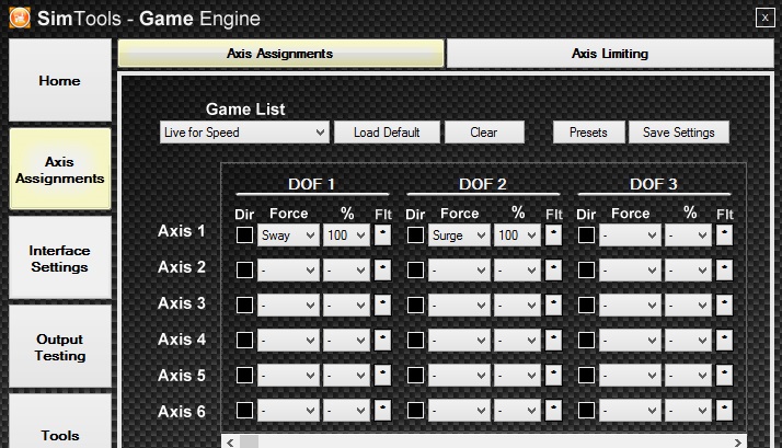

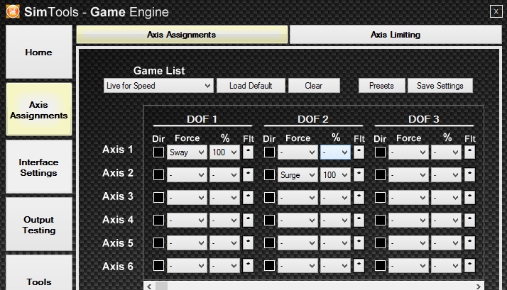

    From the Axis Assigments Tab
    No 1. DOF1 DOF2
    Axis 1 Sway 100% ----
    Axis 2 Surge 100% ----
    No 2. DOF1 DOF2
    Axis 1 Sway 100% Surge 100%
    Axis 2 ---- ----
    No 3. DOF1 DOF2
    Axis 2 ---- Surge 100%
    What is difference among three set ups above? (pictures added below because of tab problem)
    2. In addition to this, which one represent the movement of actuator1, Axis1 of DOF1

    pic 1 and 3 are the same, two motors (axis 1 has sway and axis 2 surge)
    pic 2 one motor with sway and surge

    In picture 2, sway and surge combined ? I mean that. Does these values send to io card seperately or a single calculated data send to io card ?
    Which one?

    Hi @yeniuser ,
    In pic 2, the output would be the combination of Sway and Surge.
    For it to work right, both values of sway and surge should be 50%.
    As the total of the 2 DOF's output should be around 100%.
    Basically, each axis output can have up to 6DOF mixed to crate an axis output.

    We often tend to use axis loosely as shorthand for all axis, angles and forces: http://www.xsimulator.net/community/faq/dof-angles-forces.215/
    The total of the DOF allocations should be around 100%, though in practice you can go slightly higher: http://www.xsimulator.net/community/faq/axis-assignment-percentage-totals.120/
    In theory if you had just 1 DOF you could allocate 100% to it, if you use 2 DOF then you could allocate 50% to each, 3DOF 33% to each and so on. In practice you start with about 20% allocated to a DOF, tweak and test it in game including with the Tuning Center, adjust the percentage allocation up or down as needed until it feels right then, turn it off and do the next DOF the same way. When all are tested you turn them all back on together and do the final tweaking. You then have the option to create specific car/track profiles in the SimTools GameManager. SimTools also has filters that are particularly useful for flight motion profiles, but can also be used with a good racing profile.
    Generally things like heave often use much less the a 20% allocation, while sway and surge tend to have more than 20%, but it does depend on the game and the design of the simulator.
    Setting up a good motion profile take time and patients, but the results are worth it.
