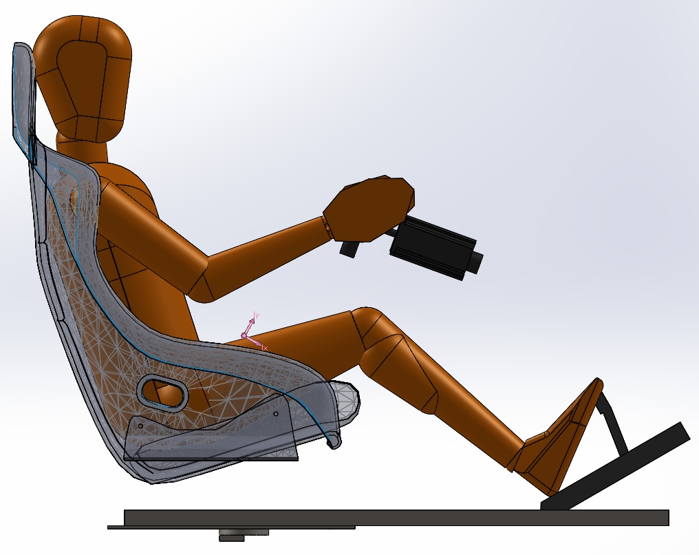

    All this is dependent on knowing the mass moment of inertias in the pitch and roll directions so I made this.
    Clearly it's missing a lot of parts but the person's right about my size and I set all the mass properties so I could get initial estimated inertias. I'm encouraged that it shows the center of mass (the pink coordinate thing) above about where many pivots seem to be mounted.
    I'd been thinking for a while that I'd want symmetric torques between pitch and roll but my model's showing noticeably more pitch inertia (116881 pounds * square inches) than roll inertia (85852 pounds * square inches) which makes sense, so now I'm thinking that I'll shoot for asymmetric torque and ranges of motion so that I can have symmetric accelerations.

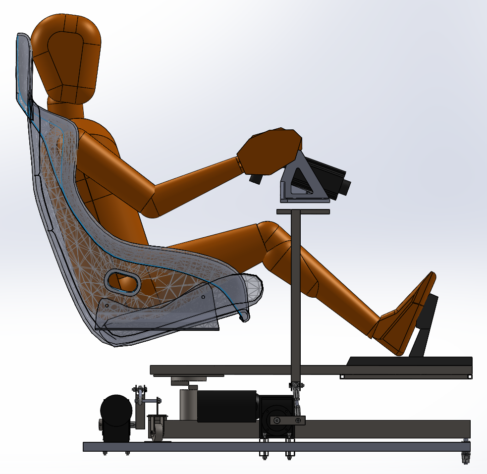

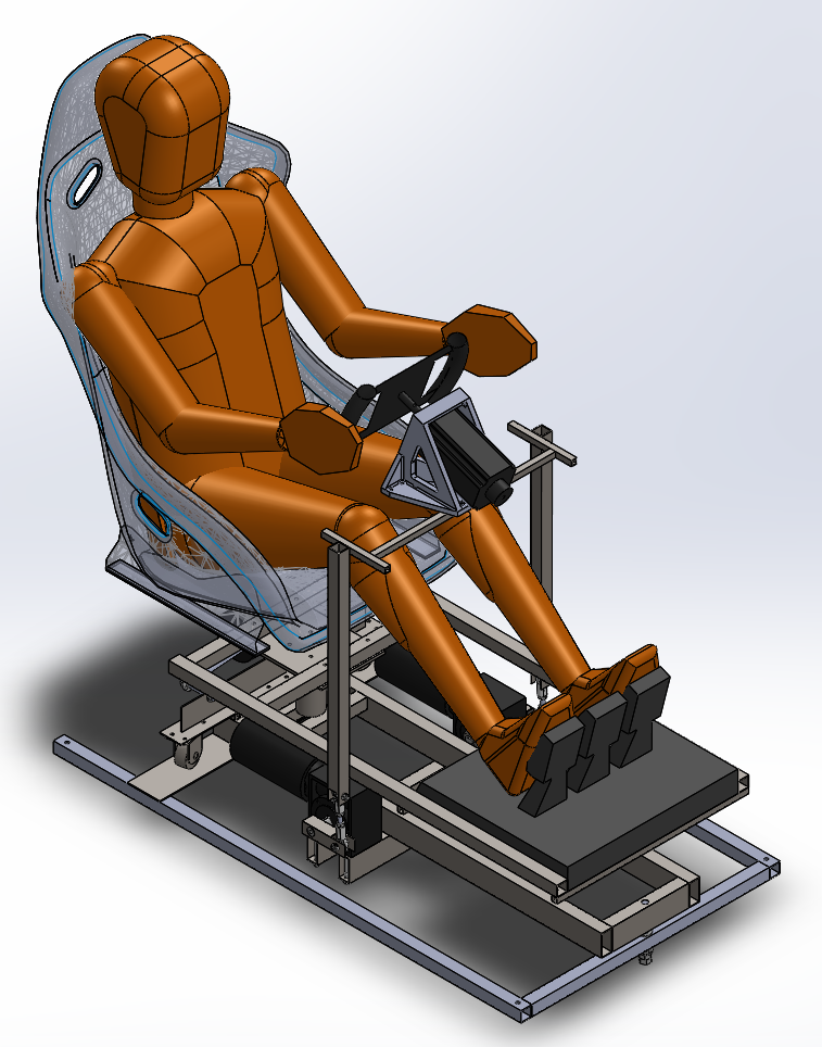

    Initially I was considering DIY linear actuators but quickly realized that getting the gearing right was going to be more complicated than it'd be worth, so I decided that gear motors were better for me. I then played around with some layouts using them but realized that my initial design philosophy was giving less movement than I wanted so I did a bunch of reading here about degrees of movement, cast aside my previous approach, aimed for about +-8 degrees of pitch and +-10 degrees of roll, and figured I'd worry about torque later.
    Those larger angles will require torquier motors than I was initially expecting to need so I'm expecting to get some 350W motors from aliexpress. With shipping, they're about the cost of pgsaw motors. They do operate at 24V which'll drive up the power supply cost, but at least according to the spec sheet for the main chip on IBT-2s, they should be able to handle the voltage and current. I expect the IBT-2s to be flakey, but I get the impression that they either work as expected or are DOA so I'm assuming that troubleshooting will be a moderate but not major chore.
    It clearly still needs some work and polishing, but I'm not seeing any major shortcomings or open potentially show-stopping questions.
    And as a nice validation, to several decimal places, the program I wrote matches the CAD model results as I adjust the CTC angles!
