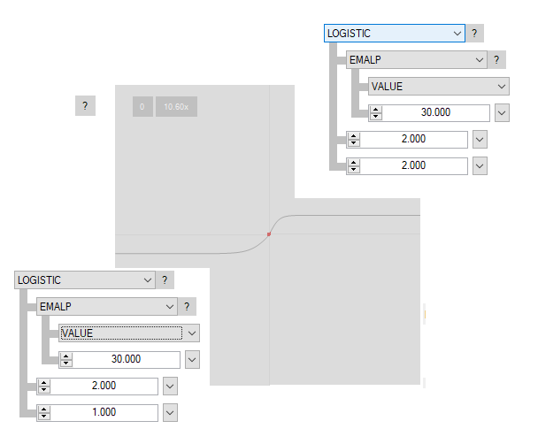

    Hi, I would like to achieve two different characteristics of logistic filter for plus and for minus half of the value range in surge. Does anybody know how to achieve something like that or is it even possible in FlyPT Mover? I want to achieve something like on the picture below:

    Hi Peter,
    I've done this myself. You just need to crop the positive values, crop the negative values, and add the crops together.
