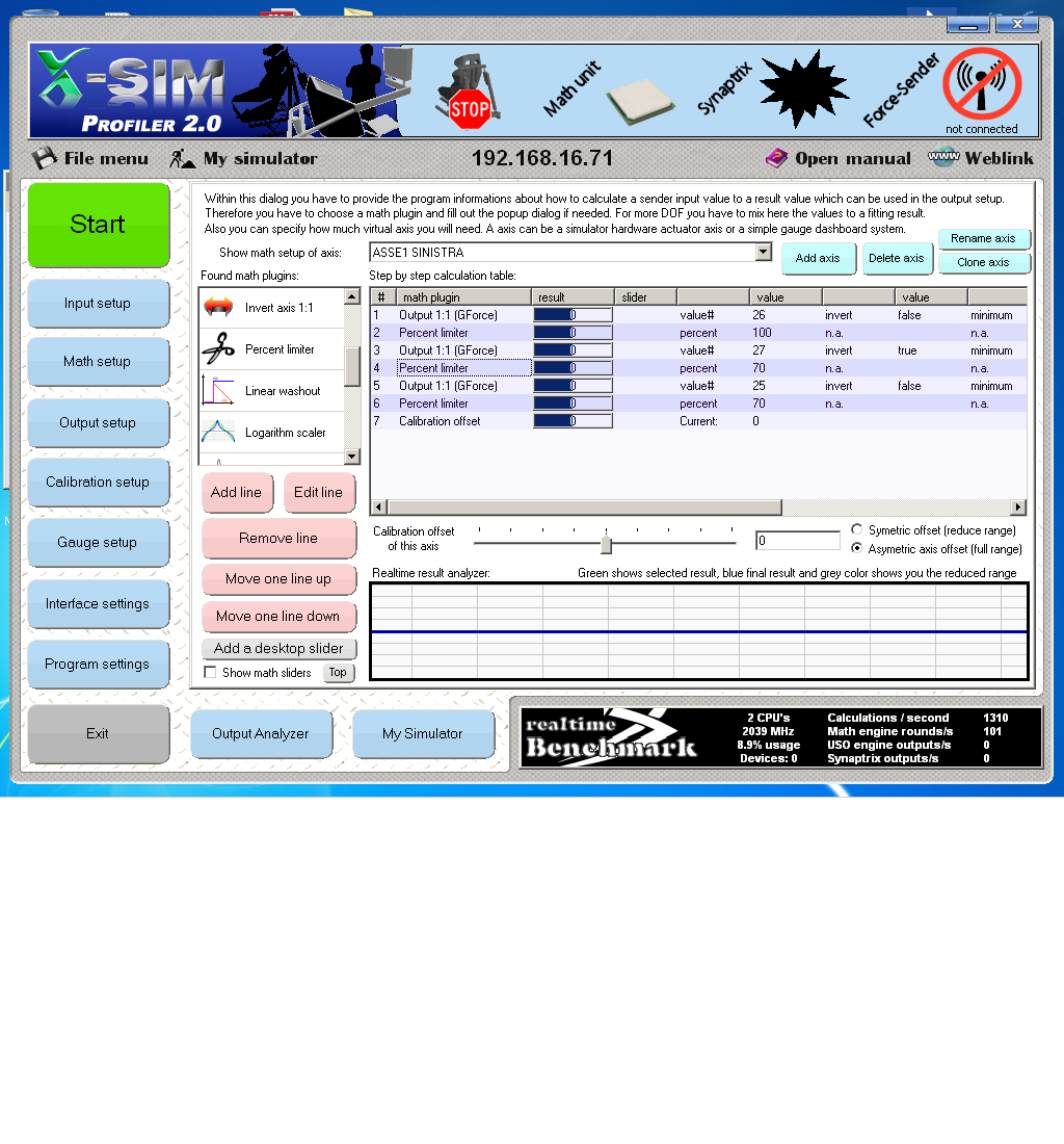

    Hi all, I need help! Here my situation:
    35cm of vertical mechanical travel available.
    20cm of lateral mechanical travel available.
    20cm of longitudinal mechanical travel available.
    Ok, you can see my motion system can do 35cm of vertical up and down movement but only 20cm of lateral and longitudinal.
    If I set my profiler using all 35cm travel as standard for all dof (vertical, lateral and longitudinal) so I can obtain my motor trying to overtake the lateral or longitudinal mechanical limits and I can obtain a bad mechanical damage then!
    I would all three my dof to be handled by x-sim with their precise limits.
    I would that x-sim know that the max travel of the lateral and longitudinal dofs is 20cm and that the max travel of the vertical is 35cm. I hope you can understand what I mean!
    So I am trying to make some profiler theory tests(I have the platform dismounted for now so I need just to make some theory experiment with the profiler).
    Please look at the attached pic:
    This is my trick to overtake this problem!, I am trying to make the profiler handling both the 3 dof using 3 different mechanical travel limitations.
    You can see that the value26 (vertical) have a 100% percent limiter then the available mechanical travel is all the 35cm available.
    You can see that the value27 (longitudinal) and value 25 (lateral) have their own limitations (both to 70% percent limiter) so both will be limited to 20cm of mechanical travel.
    If I don't use these individual limitations so I will obtain my motor trying to going over the maximum longitudinal and lateral mechanical travel so I will obtain a bad crash and damages.. :eek:
    So, please, tell me If my trick is right and if not please, give me some help!
    Thank you all!

    Test it. Assign joystick sender inputs instead of the lateral/whatever forces and you can use controlled inputs to see what happens.

    Hi value1, I may not have explained the situation well.
    My motion system is a 3dof so all 3 motors have to handle the vertical, lateral and longitudinal axis.
    So when the game is running my 3 motors working to make a mix of the vertical,lateral and longitudinal behaviour.
    Inside this MIX x-sim should to know when my motors have to use all 35cm maximum travel or just the 20cm maximum travel, this depending of what of the three dof is handled in a precision moment.
    In other words I would have a situation like this:
    My platform reproduces the verical bumpings of the road and I feel all 35cm of vertical shake! In the simulator
    In the same moment in the game (rFactor) come a bad corner and I am really fast with my virtual car! and I have to face the corner.. the lateral g-force is very high and my platform must tilt lateral at his mechanical limit (20cm and NOT 35!!).
    I hope you can understand what I am writing :(
    you can see this pic to understand well what I mean for mechanical travel:
    I would to use all these 35cm of mechanical travel just for the vertical value. For longitudinal and lateral values I would to use just a 70% of these 35cm (example just 20cm, not precise but just for the example) becuase my cylinder/piston can make a 35cm mechanical travel but my universal joint can do just a 20cm mechanical travel (so the lateral and longitudinal both have 20cm of mechanical movement of my motor stirrup!

    Hi bsft, I don't change my motor position! plese see the attached pic here:
    You can see from this pic that if I use my all 3 motors with a 35cm max travel so I will obtain my motor stirrup trying to put my lateral inclination over the central universal joint mechanical inclination limits!!
    And as you told, if I use the jrk config utility to make a travel limitation so I will get the travel limitation for all 3 axis that the motor will handle.
    The limitation of 70% of max travel must to be applied just for the lateral and longitudinal movement!

    Hi sirnoname!, so you are confirming that my trick to limit just the lateral and longitudinal values (using percent limiter) can't work?
    here the pic:
    If you confirm that so, please can you teach me fast how can I use spider plugin to do that? :blush:
