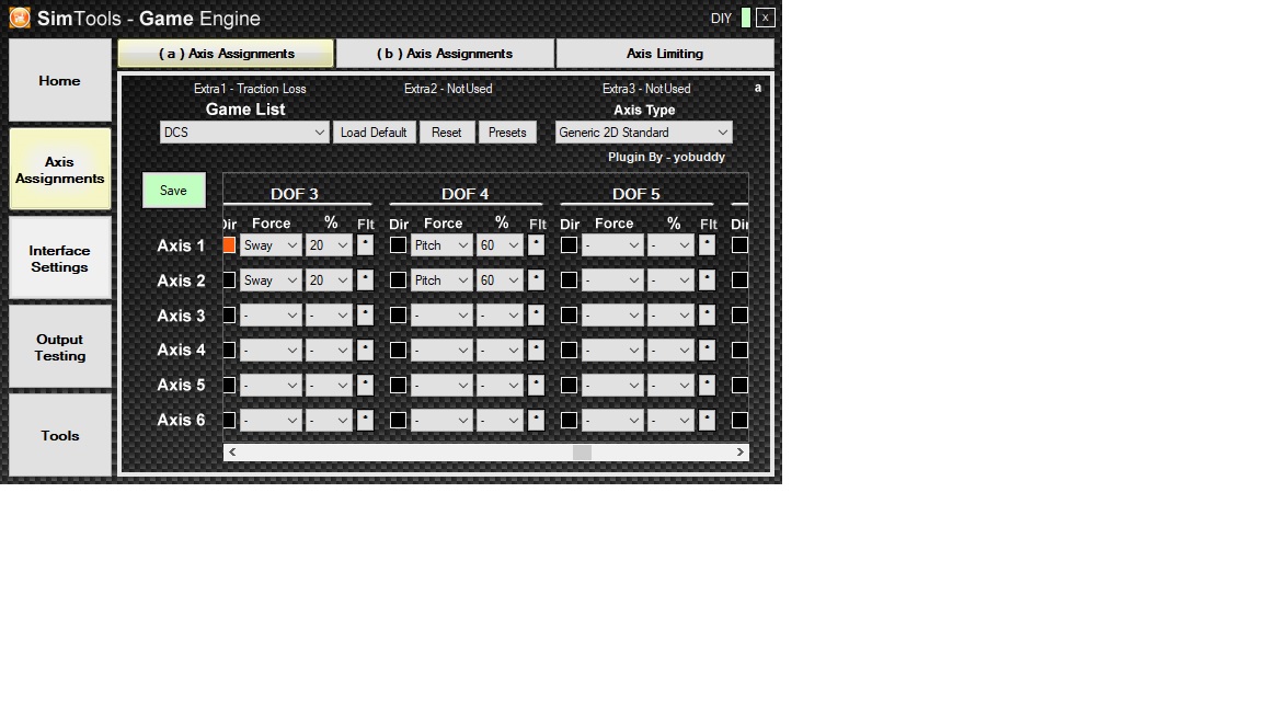

    I read the post noorbeast about the filtering but I am having trouble using the washout and return filters to stop the snapping across axis when rolling over 180 degrees but not having much luck. I have tried everything from 0 to 100%, combinations of etc with not much luck. Could someone please post their settings? I have a 2dof shoulder mount jrk 200w 12v motors. My base setting attached with no filtering. Or from what I have read yobuddy is working on a fix and best just to wait? Thanks.

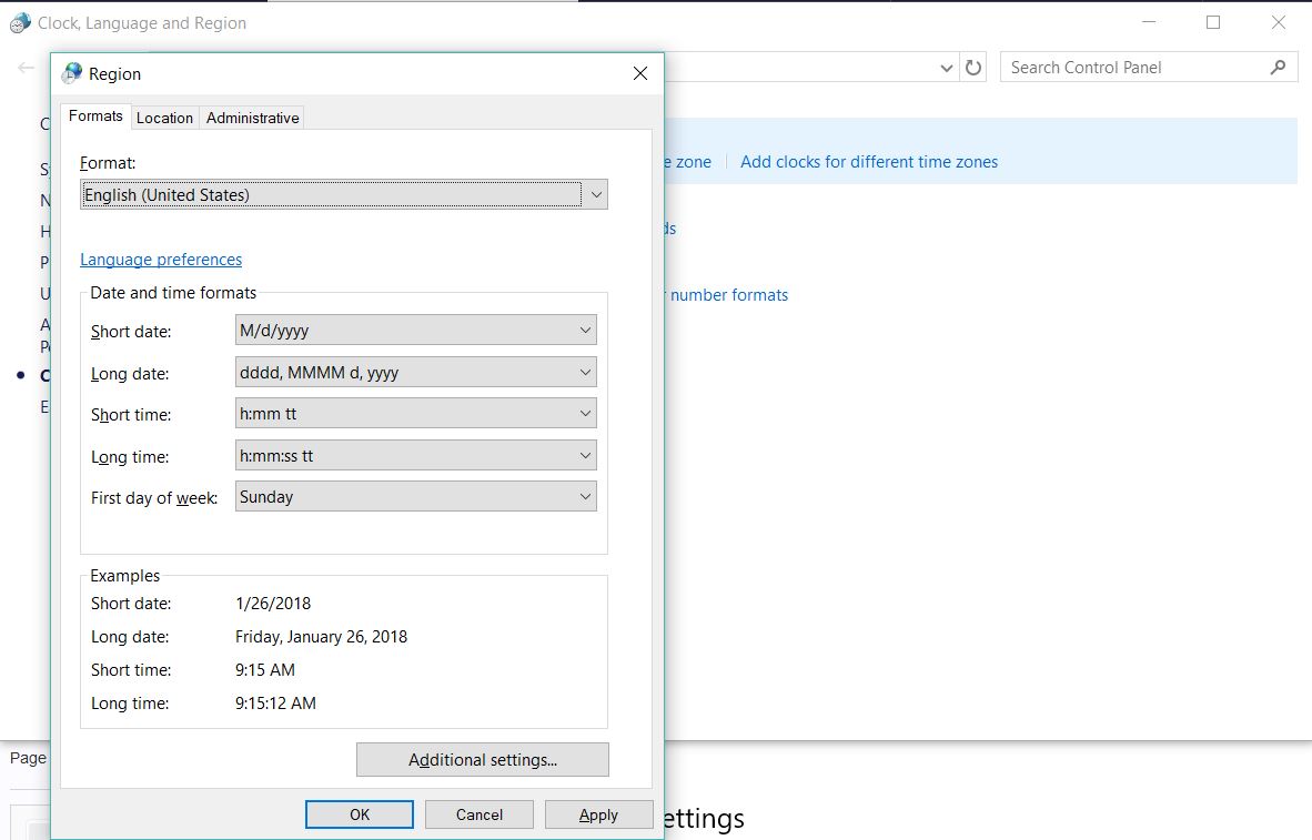

    Hello Guys,
    Just installed DCS from steam, 1.5.8.
    Patched the game, as usual. (other games works well)
    There are no any telemetry data, (game data - output) in the Tuning center, therefore no any motion on my 2dof sim.
    Is there any trick what I missed? Firewall is off.
    I using the two plane, provided in the free version of the game. Nothing special.
    Any help would be awesome!
    Thank you very much, in advance.
  20. Csaba
    Csaba New Member
    Nov 28, 2017
    14
    Hungary
    - 6Coins
    Well, the solution is, that in the Region Settings you must set not only the Location but the Formats to English (US) as well.
    I think the reason is something related to the Numbers format. (decimal, list separators etc.)
    I hope this would help others who are facing the same problem in the future.
