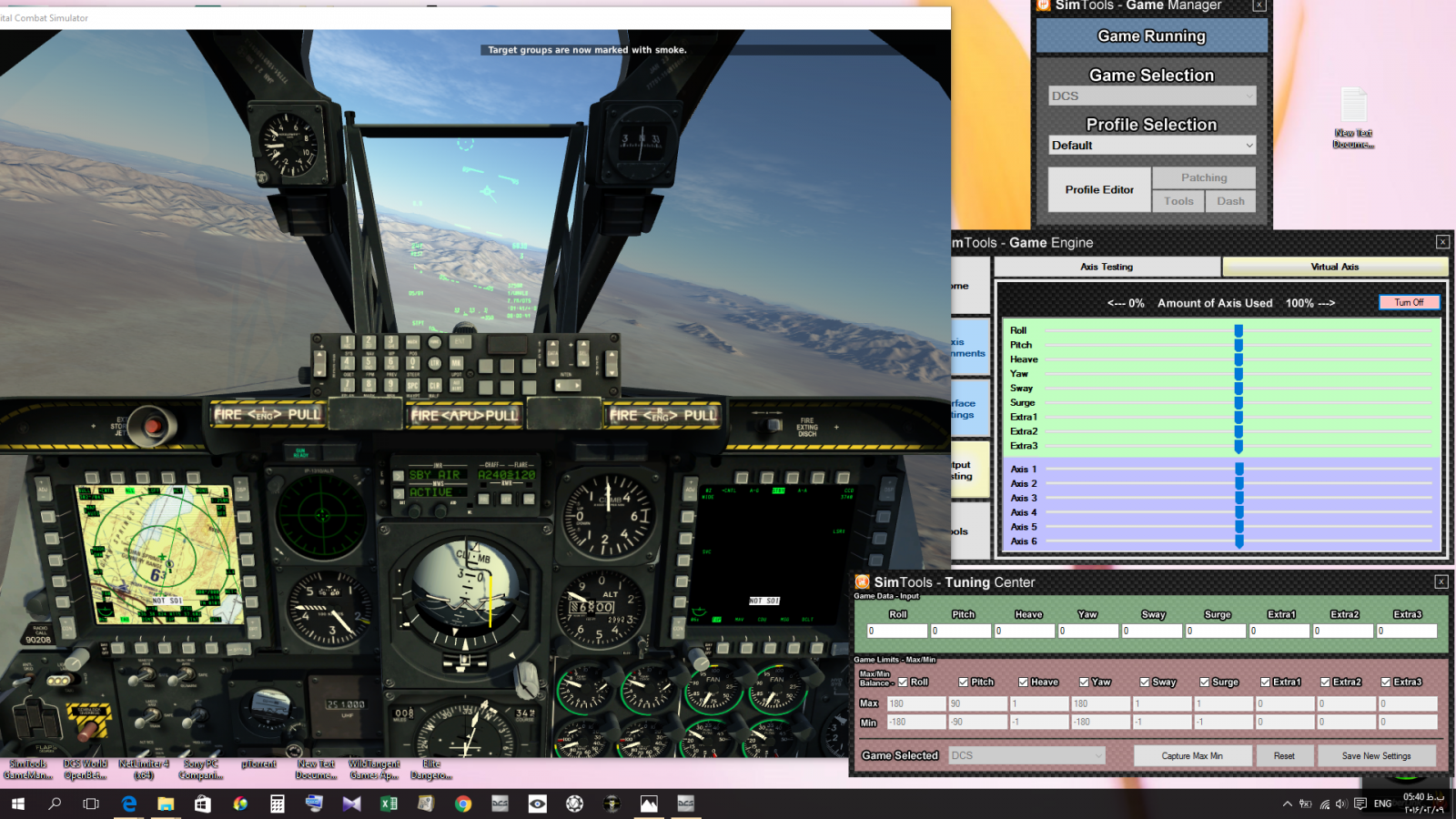

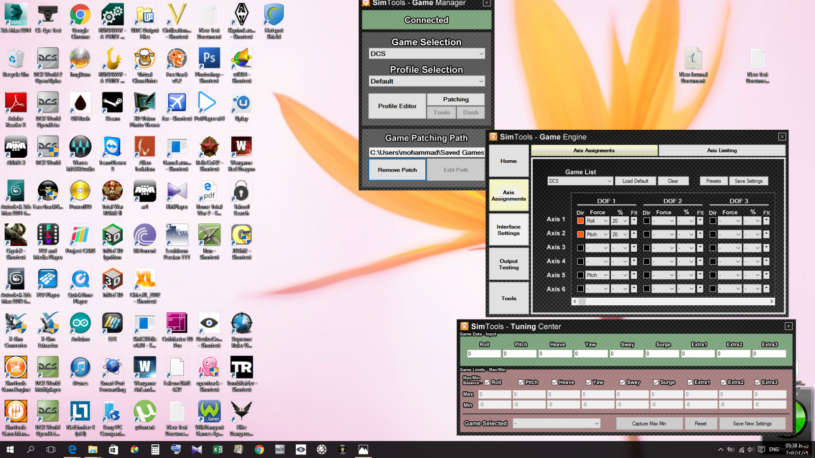

    Hi friends
    I install the dcs patch, but in the game can not data to the tuninig center why?

    The problem was solved
    The problem was-region
    change to us is ok;)

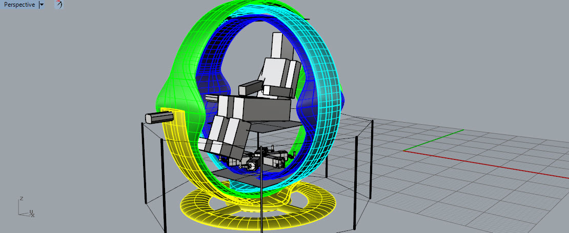

    @value1 I have a special request for the DCS plugin. Would you be available for a skype session. I am willing to pay you for it if you like. I am designing a flight 2 DOF gimbal similar to a a gyro with a 6 DOF chair at its centre. (I have attached an image for it ). This means that there are two additional motors that rotate the Gimbal rings for pitch and roll. I take it this will need some special attention so that the pitch and roll is not sent to the 6 DOF chair. I can work this out myself but it will be quicker with your help. Either way I completely appreciate the work that you have done on this plugin so far. Thank you.

    Your question is really one about design and configuration and is not specific to the DCS plugin, hence you should put it in your own build thread.
    SimTools 2.0 is in closed beta testing and can handle 12 simultaneous axis calculations, so configuring 8 will not be a problem: http://www.xsimulator.net/community/threads/simtools-2-0-question-and-answer.8175/

    I will start my own Build thread but I felt that this question relates more to this plugin than anything else only because it is about isolating the pitch and roll out of the 6 DOF chair, yet still getting the heave, sway, yaw, and surge out of the central chair. Its not really about getting additional axis as it only exercises 6DOF in total. Its more in how the inputs from the game are interpreted by the SimTools software.
    21,466
    150,435Coins
    +11,005 / 55 / -2
    Actually you define what force you allocate to an axis and tune it to suit, so with SimTools 2 you can allocate the 6DOF to the chair plus additional roll and and pitch axis, as there will be 12 axis supported.
    With such a complex and potentially costly project I would recommend you create your own build thread and make either a SketchUp or RC powered model to test your ideas, before you invest a lot of time or resources:
    http://www.xsimulator.net/community/faq/how-to-animate-sketchup-3d-model-with-simtools.209/
    http://www.xsimulator.net/community/faq/build-a-working-model-to-test-your-design-ideas.216/
