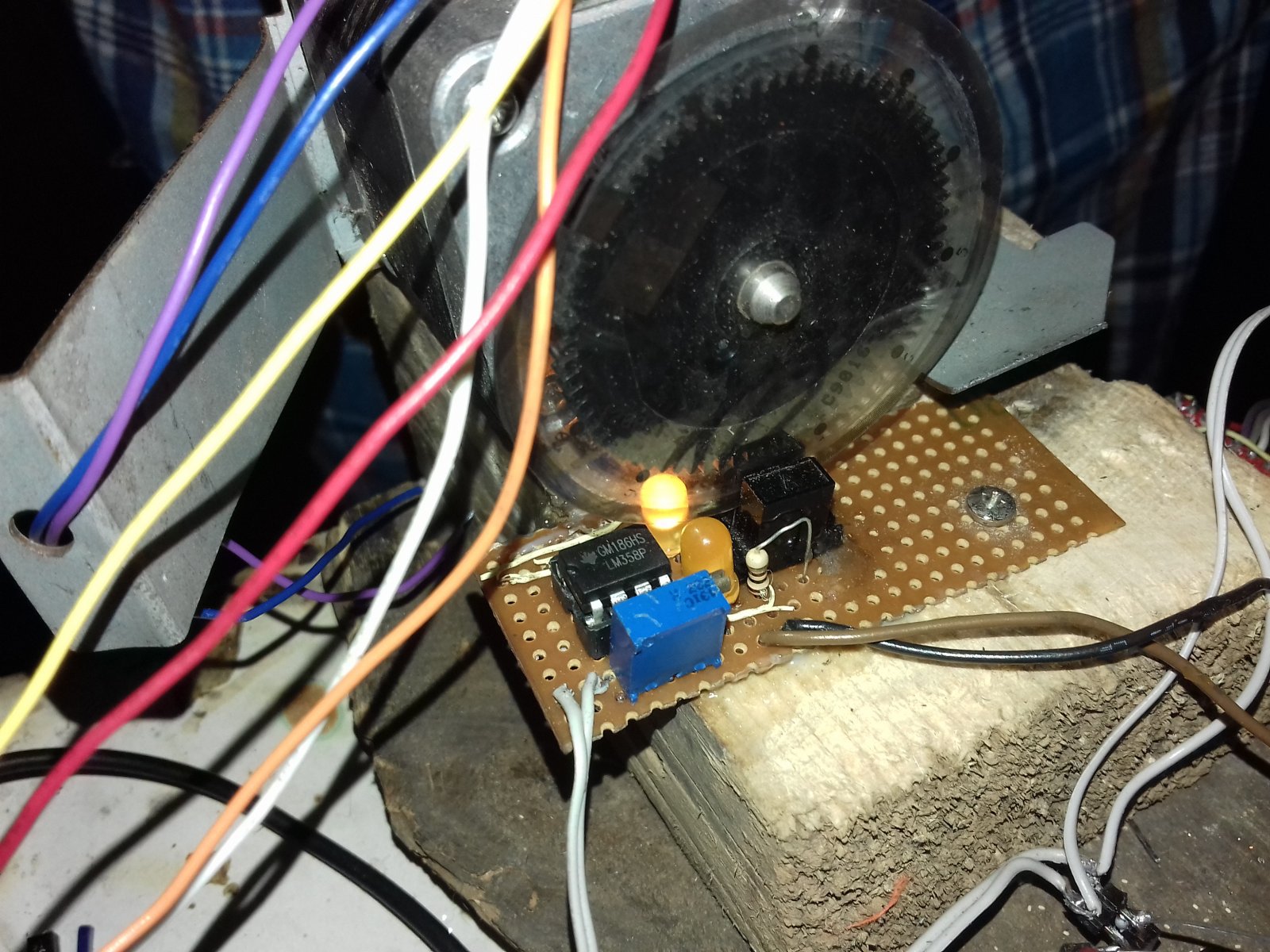

    Encoder
    at least a 2000 ppr(points per revolution) encoder . I'm using a scrapped optical encoder from a printer .

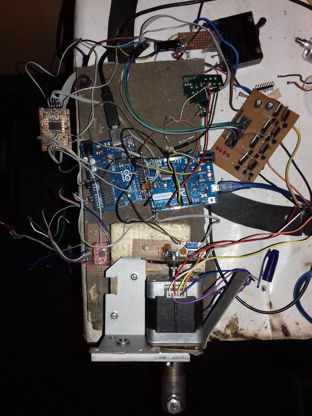

    The prototype (the red driver is an a4988 driver(my first try) and it was't used in the project)
    on left end is the L6506 set in fast decay mode
    on right end is the dual H bridge for driving the stepper.
    Arduino leonardo is for the RacingFr's AiWave firmware and uno for the handling pwm and controlling the stepper

    192Coins
    No complete unit is taken from a printer

  8. llluis
    Mar 30, 2017
    164
    Quebec
    1,630Coins
    +103 / 1 / -0
    Your H bridge is rated for how much current?
    My Nema34 is rated at 5A (13Nm).
    Nema42 can be 6A (22Nm) or 8A (30Nm).
    If the bridge can handle that it would be very interesting.

    It uses mosfets rated at 12Amps continuous .Since we are switching to control the current they will do more than 20Amps .But the issue is the motor ,I'm trying to find a nema34 at least let's see.
