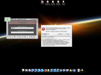

    Hello... I installed Dirt 4 Plugin 2.1.1.0, but when I select this plugin in SimTools Game Manager an error window opens up... "Exception not managed in the application. Click Continue to ignore the error and attempt to continue".
    But anyway SimTools Game Manager crashes!
    P.S.: with the installed previous version of the plugin Dirt4_2.0.1.5 of value1, yobuddy instead no problem.
    How could I solve?

    Could you please post a picture of the full error.
    Did you run a race in Dirt 4 before patching, as that is required for all Codemaster games.
    The patch path for Codemaster games is also different for Win 32 and 64bit systems, which do you have and what path have you used?

    OK... I depatched DiRT 4 plugin (2.0.1.5) and closed SimTools GameManager.
    I launched the game and run one race... then I closed the game.
    After this, I launched SimTools PluginUpdater and repatch DiRT 4 with new plugin 2.1.1.0 (C:/User/COste/Documents/My Games/DiRT 4).
    Finally I launched SimTools Game Engine and immediately after SimTools GameManager, but as I try to select the DiRT 4 game through the window the same problem appears again...
    If I do the same procedure reinserting the "old" plugin (2.0.1.5) the SimTools GameManager reworks without any problem.
    So, how can I resolve to be able to use the plugin 2.1.1.0?
    Below I inserted you requested screen...

    Same here but I've only noticed this since I've got a fresh install of Windows 10 to the new build 1809 was wondering if you are on the same new windows 10 build? In the previous 1803 the older 2.0.1.5 plug-in worked but now it's effectively stopped working, and the newer plug-in here is giving me the same error you another is getting so I'm wondering whether it's the updated version of Windows.
    It's only this particular plug-in I'm having the problem with has the Forza motorsport 7, project cars 2 and the F1 2018 plug-in seems to be working fine for me so I'm not so sure as to why dirt4 plug-in is giving us a problem.
