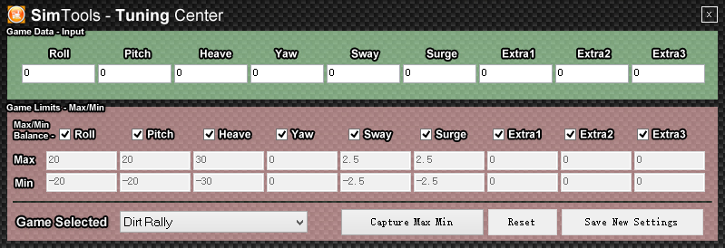

    Hi all is there anyone that could kindly share the motion settings for dirt rally please.
    I run seat mover 2 x scn5.
    Im trying to mess about but seems quite hard to get it right with soo much going on.
    If i can try setting i will know what to feel n look for.
    Atm i still can not stop the vibration with the car sat still at the line its not engine vibration or owt like that its jittery.
    I have had tunning centre set at max 3 n min 150 to ween it down abit even had the max at 10 but then it just not doing much in the seat.
    As its rally i like it to move around a fair bit not loads but just that throw you anout feeling you should have in rally i guess.
    I want to learn but struggling to undersatnd as so many varibles.
    It might easyer to set up assetto or somthing as it not so bumpy n so much going on so i could be doing it right but ive not got to assetto yet im still working 1 game at a time to get right then move to the next.
    Dirt i can just switch on and play n with all the graphics options i have been doing too im getting there but issues with the motion part.
    Thank you all

    Watch your Live Axis, then you'll see which force is the "twitchy" ones. PS its surge and a bit of heave pending your tuning center number...>Sway is also Super lame too. :(
    IMO overall Dirt Telemetry Sucks the big one. Compared to other titles its Super sketchy and requires a Lot of tweaking.

    Hi mate yes it defo helpped.

    On my 2dof for the sway in dirt rally ,,,,i set my sway up and wrote the setting down ,,then i set the extra1 up even though i dont have traction loss on my rig ,,,then i halved the axis settings on both and run them both together and the sway feels great...
