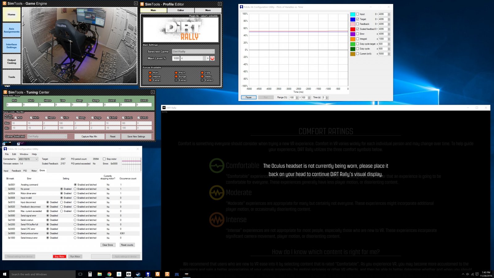

    Morning guys!
    Trying to get Dirt Rally going on my new rig....
    Patched fine, and Sim Tools sees the game running, but no live telemetry to Tuning center.
    What am I doing wrong?

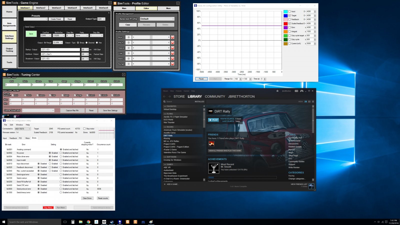

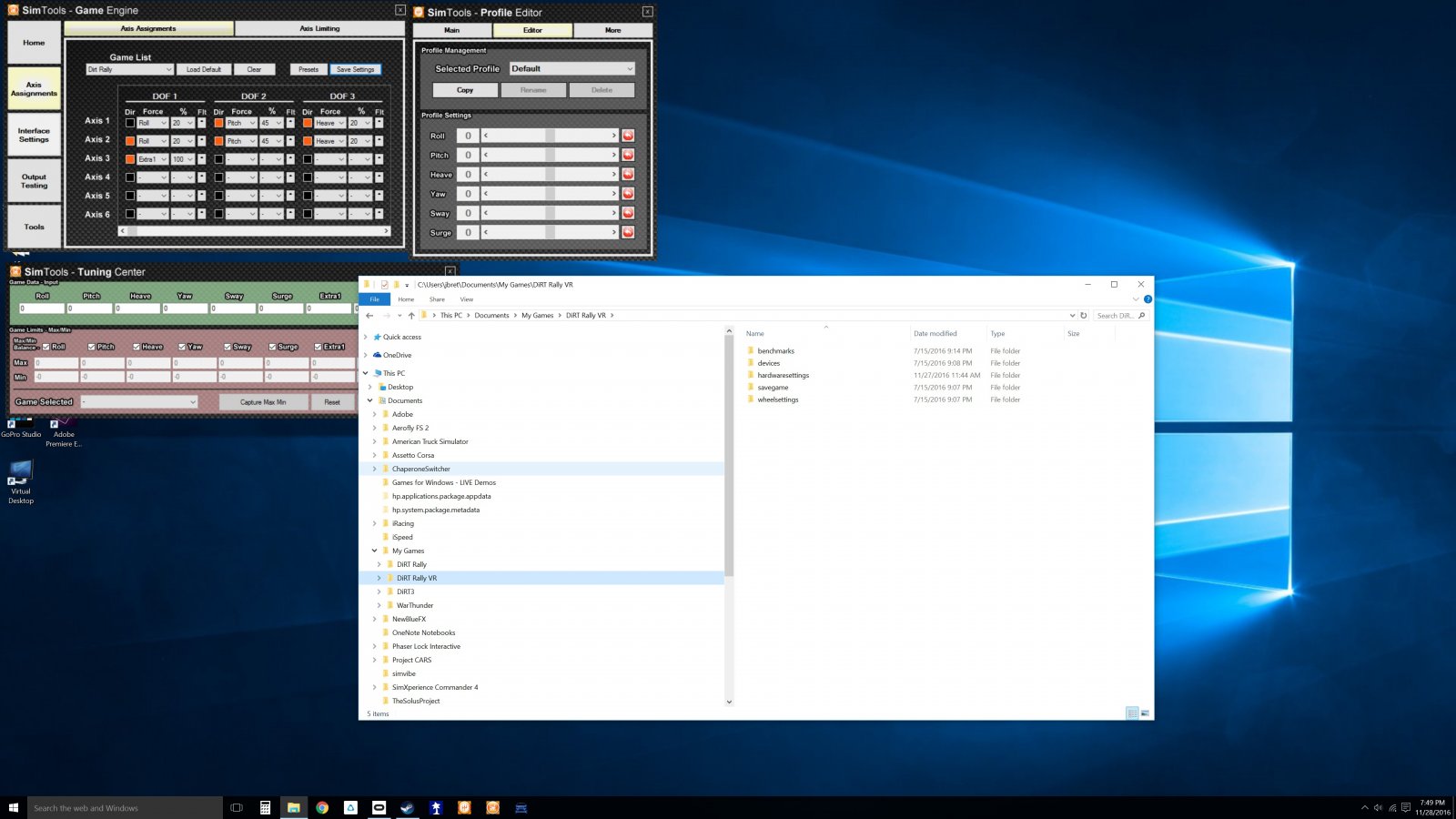

    Alrighty.... So.... I am a dumb ass.... but still not working lol
    I DID NOT have the axis assignments setup for Dirt rally specifically... I fixed that KNOWING that would be the issue. Still no joy.
    See below a couple screen shots, when the game is running you can clearly see sim tools sees it and populates the tuning center with game limits but no live input. I have tried capturing limits, but did not make a difference. Dirt 1.jpg Dirt 2.jpg Dirt 3.jpg

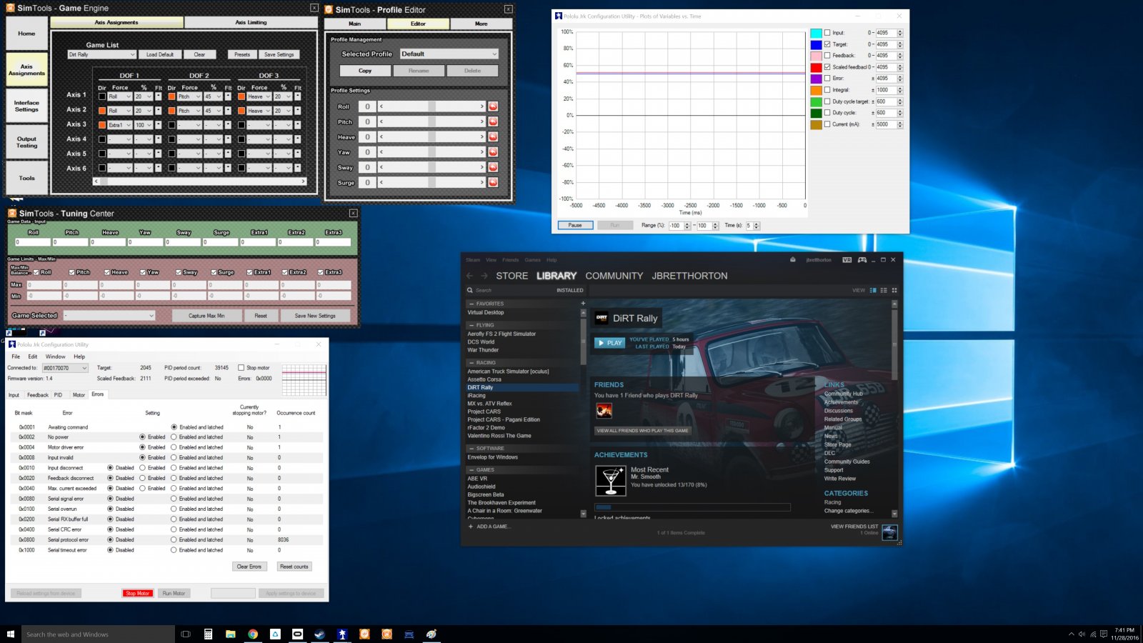

    Here is the save path

    Nope, it's surely not seeing the game, the correct folder is (in my case) C:\Documents\My Games\DiRT Rally
    not DiRT Rally VR
    Remove the patch and patch it again

    yep that got it going! My first problem was I did not have the axis setup specifically for Dirt, then was patching to the VR folder. Thanks for your help!
