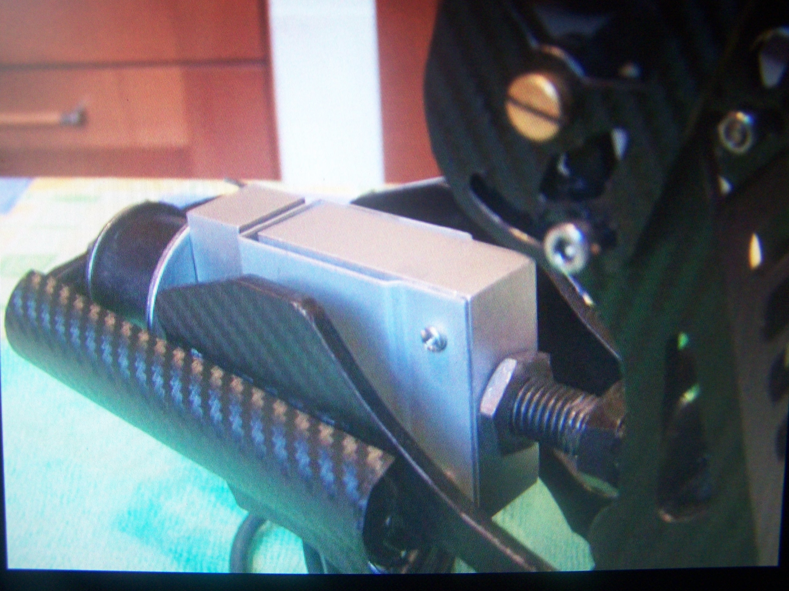

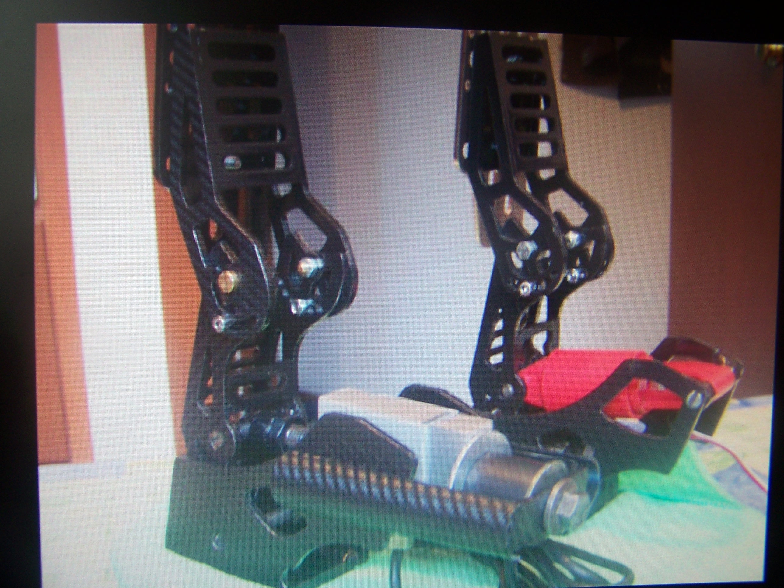

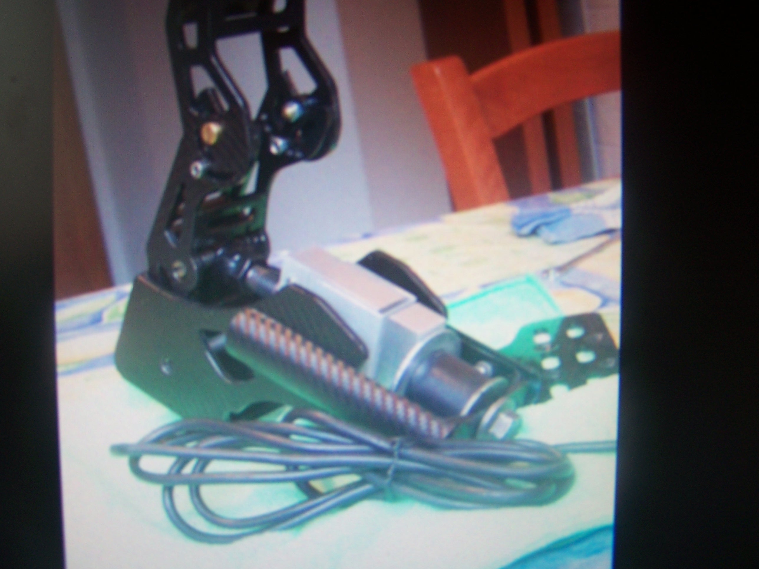

    Hi guys i use a type s load cell and it work for 0 to 100kg ,my brake pedal is equipped with adjusting screw to adjust the hardness, but I can not determine exactly how many kg. for this I thought to display them on a display.
    now to run my pedals use the buo836lc, it would be possible to use arduino (or other card that gives me the ability to view kg or on a display or directly in the settings-gaming of windows) to interface my pedal board to the PC? in order to be seen by rfactor thganks for the help

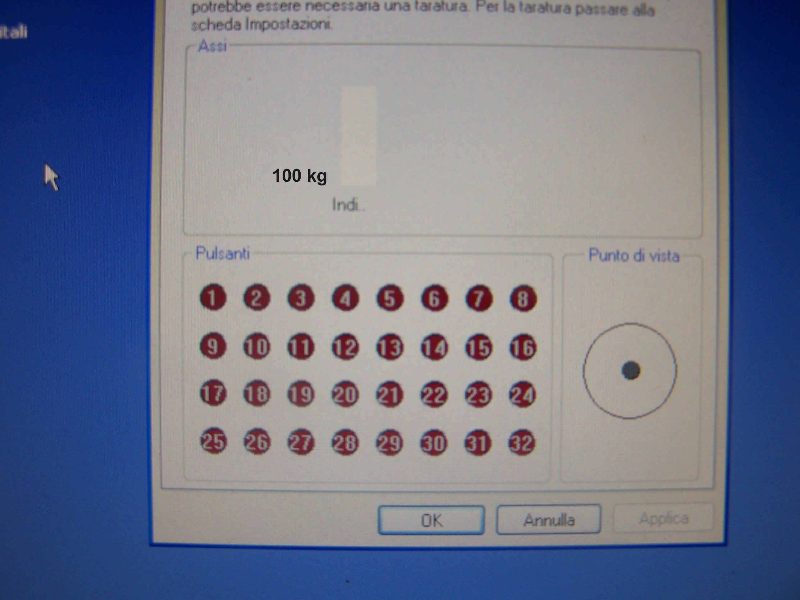

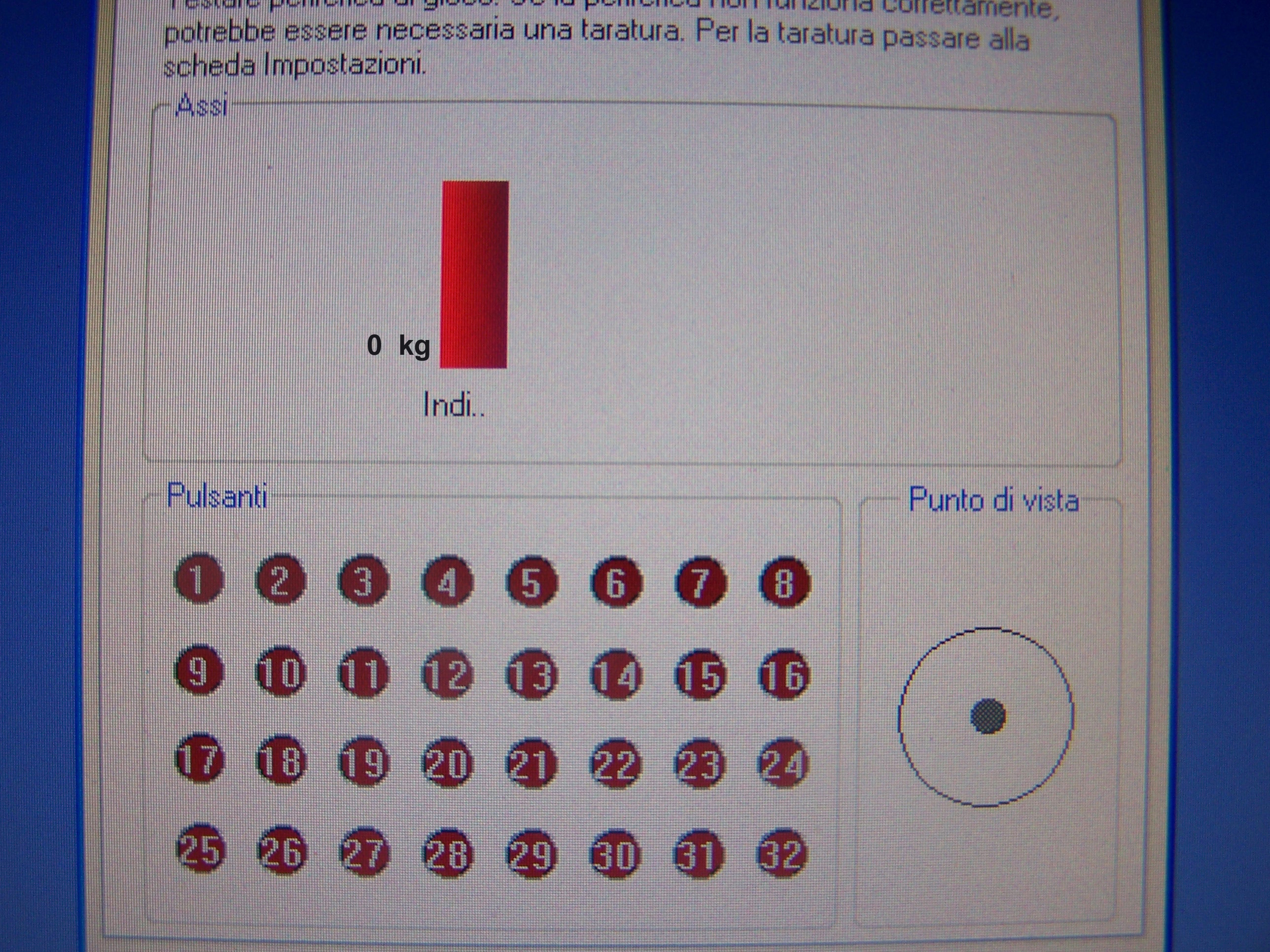

    in this moment i use a buo836lc but my idea is:display reading kg in the configuration screen gaming of windows( see the photo for one example) this is a optimal work for an calibration of the brake pedals ,but I do not know what it takes to make this work thanks

    A custom app could be written in Visual Basic, not sure if a base code is available. Need to Google that one.
