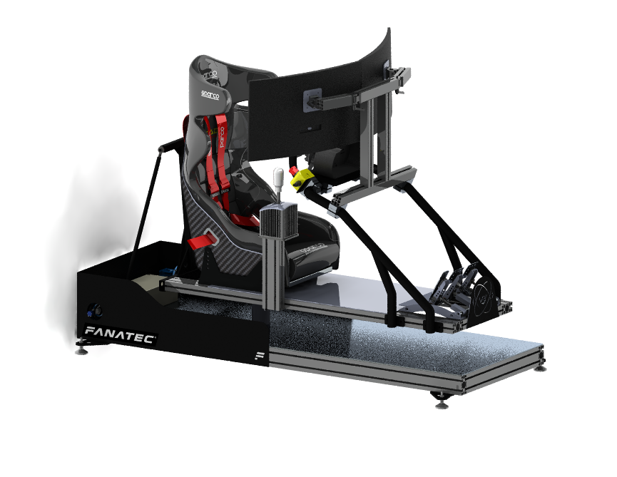

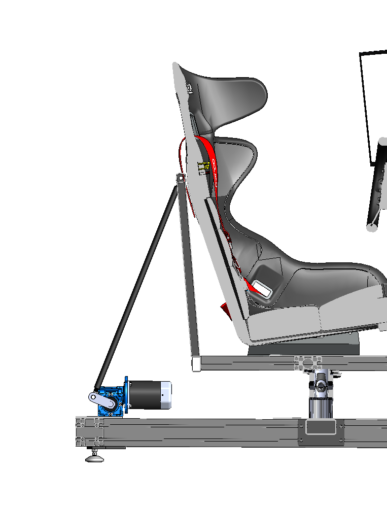

    I have an on going project where i'm building an 2DOF simulator.
    The simulator was designed in CAD before ordering parts.

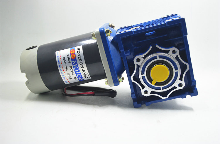

    Motors:
    Model: 5D120GN-RV40
    Number of poles: 8
    Rated power: 120W
    Rated voltage: 24 (V)
    : 1800rpm
    Current: 7A
    Wormgear ratio 1:30
    Torque: 12,5 Nm

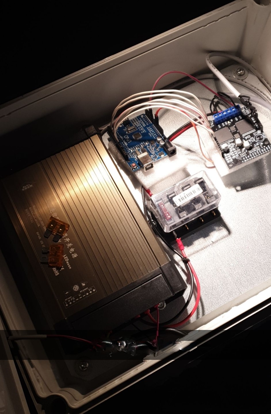

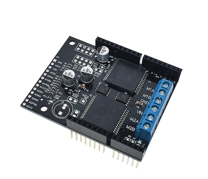

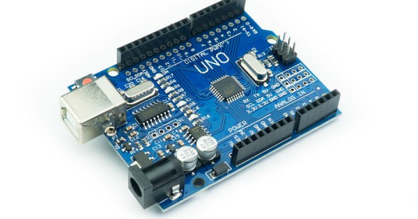

    Electrical components:
    Arduino UNO running SMC3
    VNH5019 2 channel 30A motor driver board.
    Power supply 24V 16.5A 400W
    5K Ohm potentiometers
    The electronics were connected and the motors were tested in SMC3.

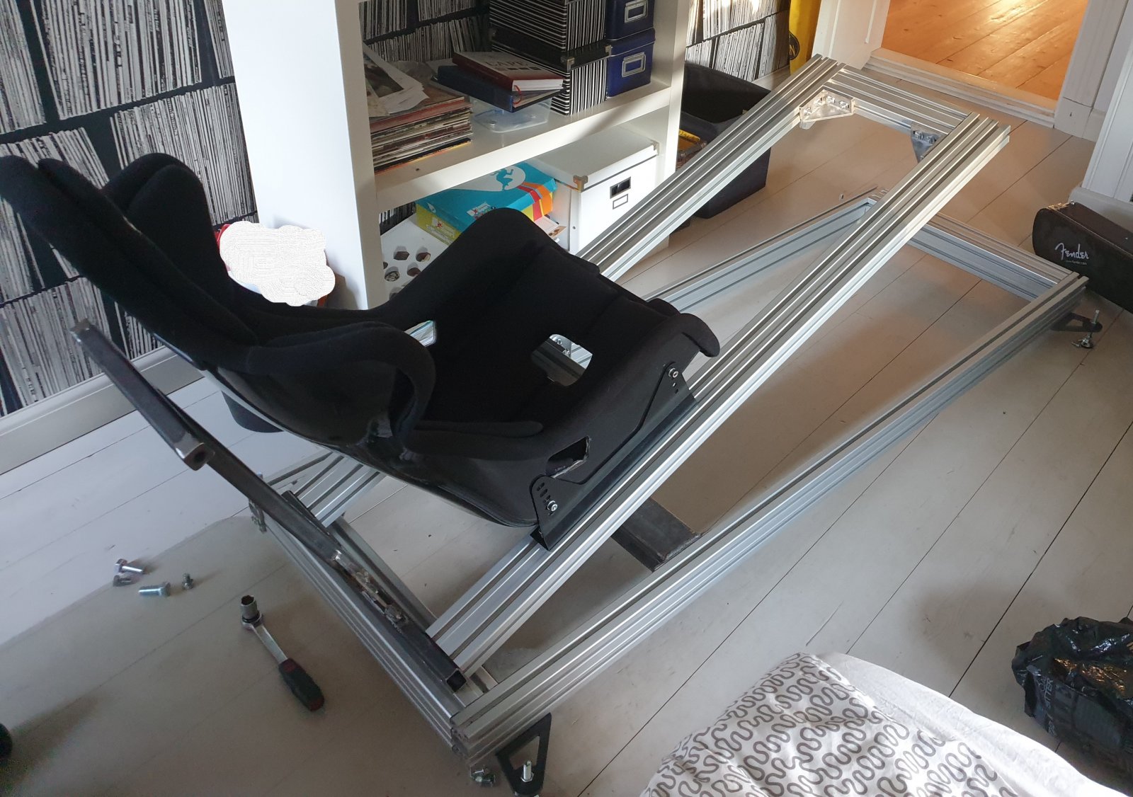

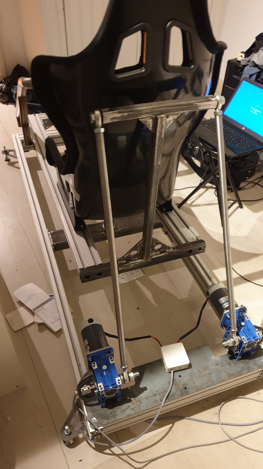

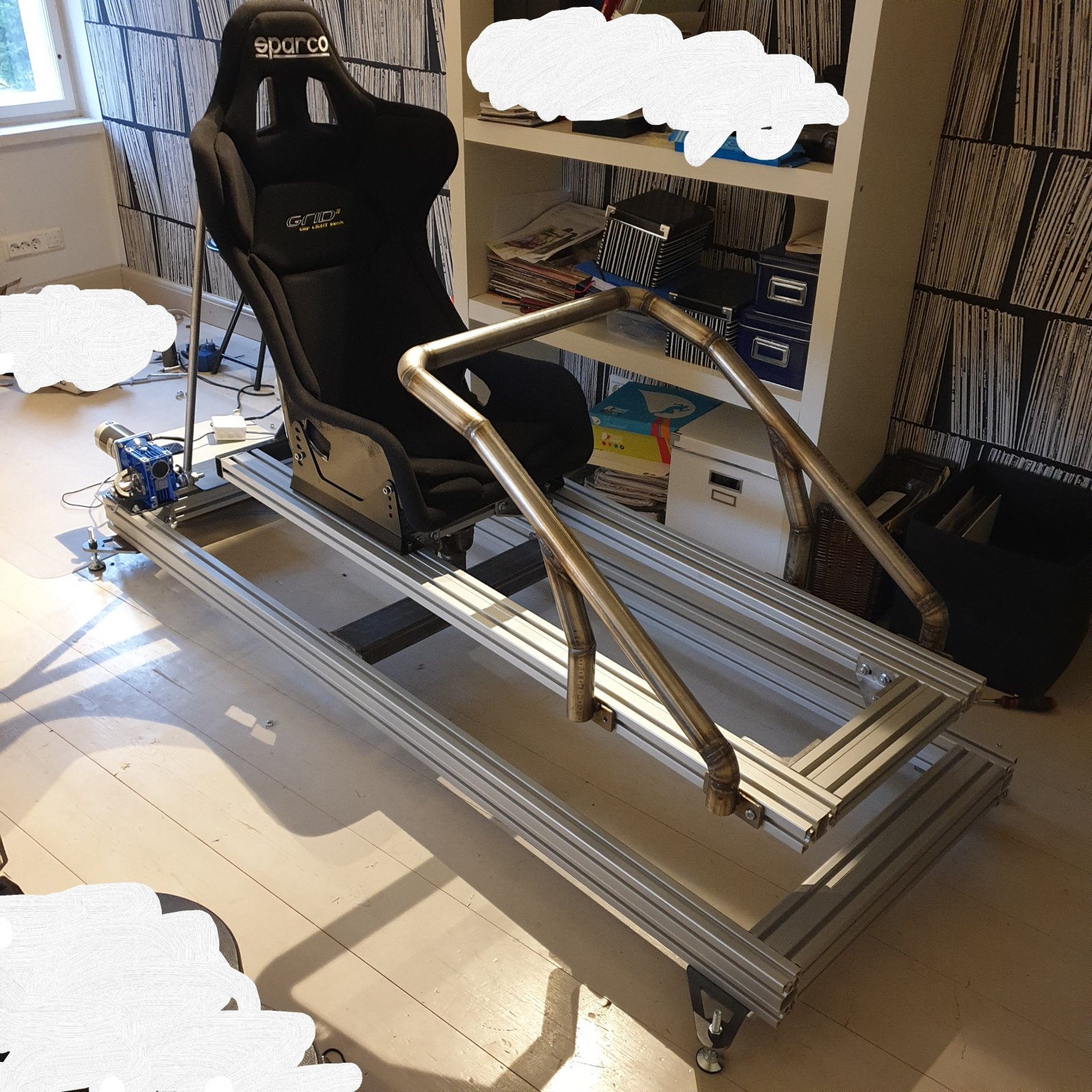

    Parts for the frame was ordered/manufactured and partially assembled.
    This is the current state of the project
    I have tested the simulator with simtools and the axis/DOF seem to be correct.
    The problem I'm having is that the motors are jerking/juming a lot.
    I'm suspecting that the motors are not powerful enough or not mounted in the optimal position.
    If you have any suggestions/tips please help me.

    I think my rig is pretty well balanced, but I will try to balance it again.
    Resting angle is 90 deg.

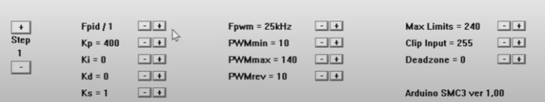

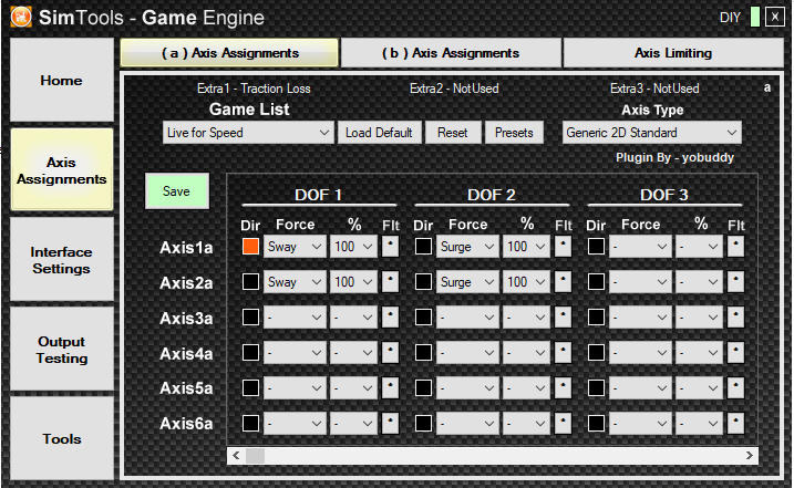

    Simtools settings:
    SMC3 settings:
    I've tried different values for PWMmax and PWMrev.

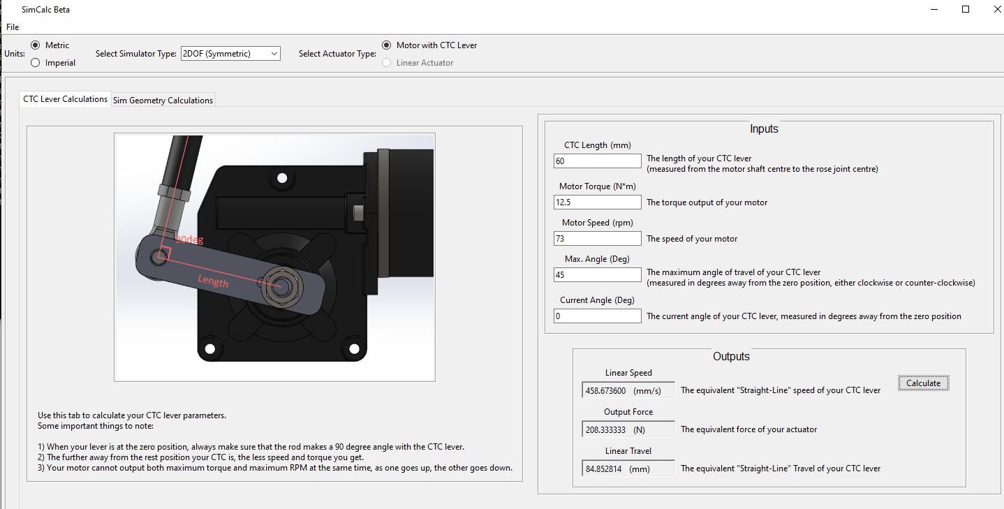

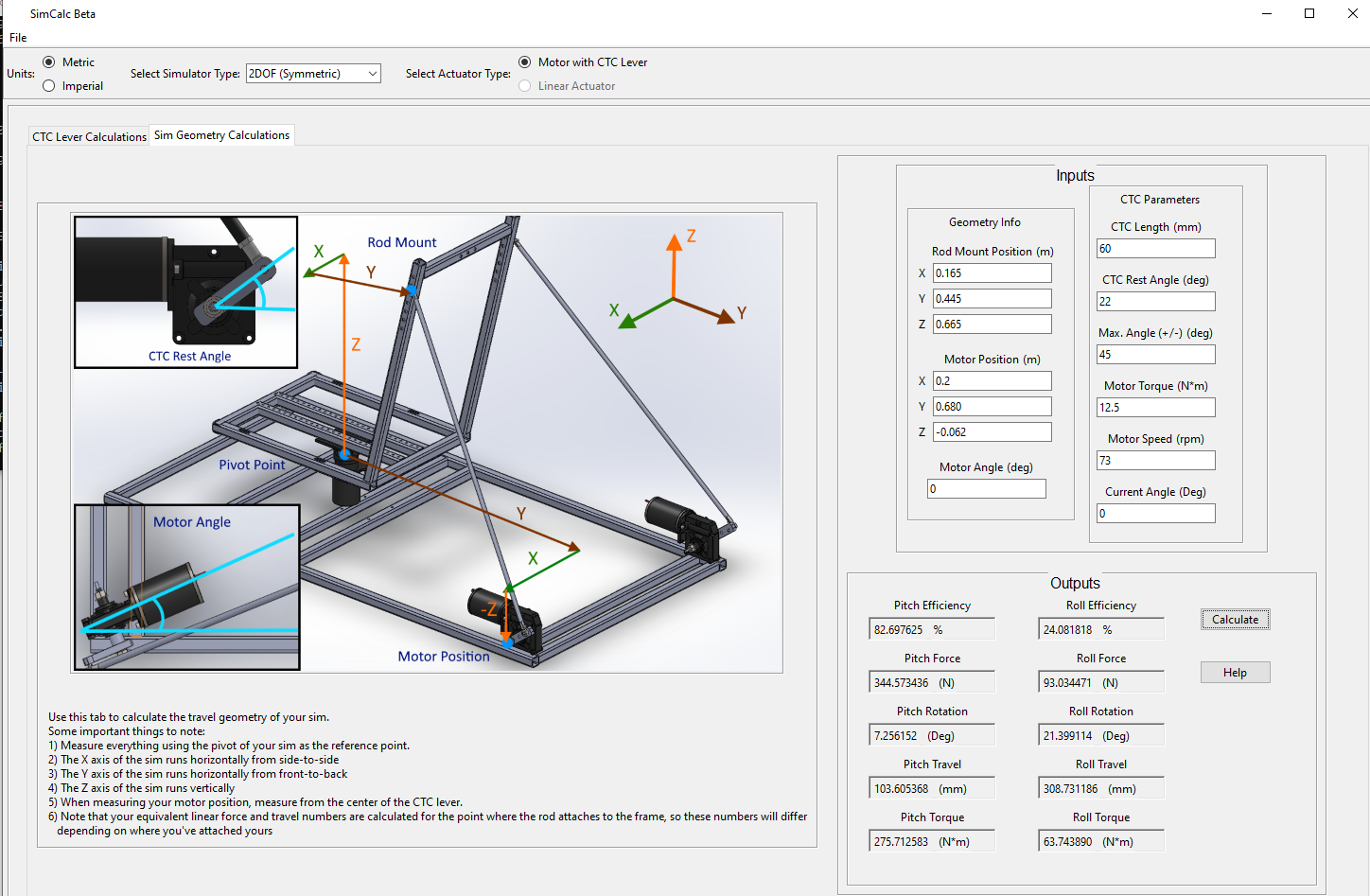

    I also downloaded SimCalc and entered my values, the forces seem pretty low right?

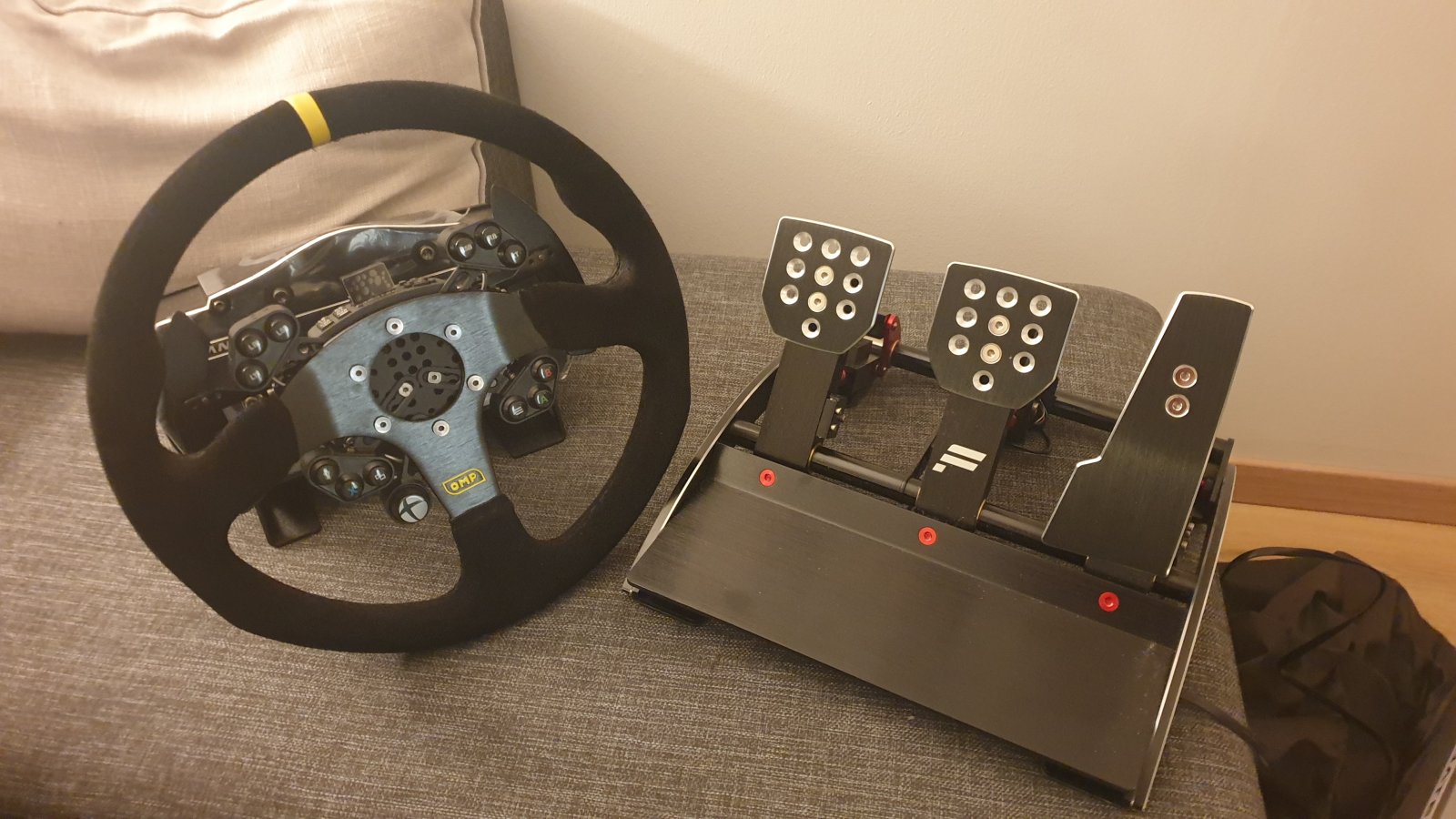

    Also bought myself a Christmas present, can't wait to try it with the sim. :grin

    Enjoy that wheelbase! I have the same one and it is really fun to use.

    Like noorbeast said, you should refine the motion profile when you want to test the motors. For example I have my axis allocation at 25%.

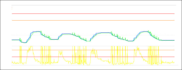

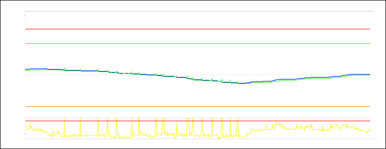

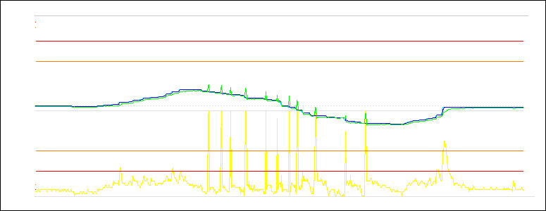

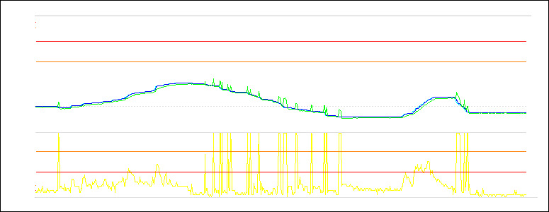

    Did some testing today. It seems that the problem is not in the Simtools settings, I have the same problem when testing the motors in SMC3.
    I took some screenshots in SMC3 and a video to show you what's going on.
    This is the curve on PWMmax 90 and i slowly manually moved up and down:
    This is the curve on PWMmax 120 and i slowly manually moved up and down:
    I tried disconnecting the rods from the motor and still saw the same kind of pattern.
    PWMmax80, not connected to rig:
    PWMmax40, not connected to rig:
    Here is a video from the tests:
    As you can see from the curves/video when the motor moves down the PWM curve spikes/jumps up and down and the motor shakes, same problem can be seen even with the rods disconnected. This happens for both motors.
  9. Sam Neall
    Sam Neall Member
    May 14, 2019
    56
    84Coins
    +15 / 0 / -0
    Ah, I have had this same exact problem with my simulator. The solution for me was to use the Ziegler Nichols method.
    You tune one parameter at a time and it will ensure smooth movement.
    Let me know how it goes.
