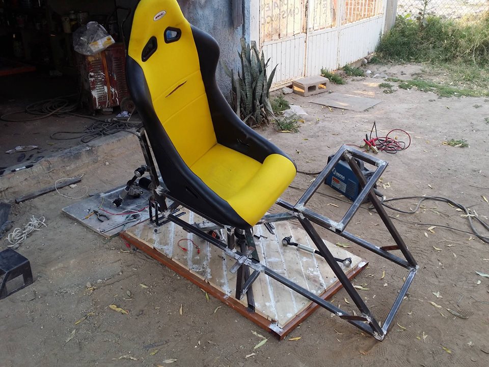

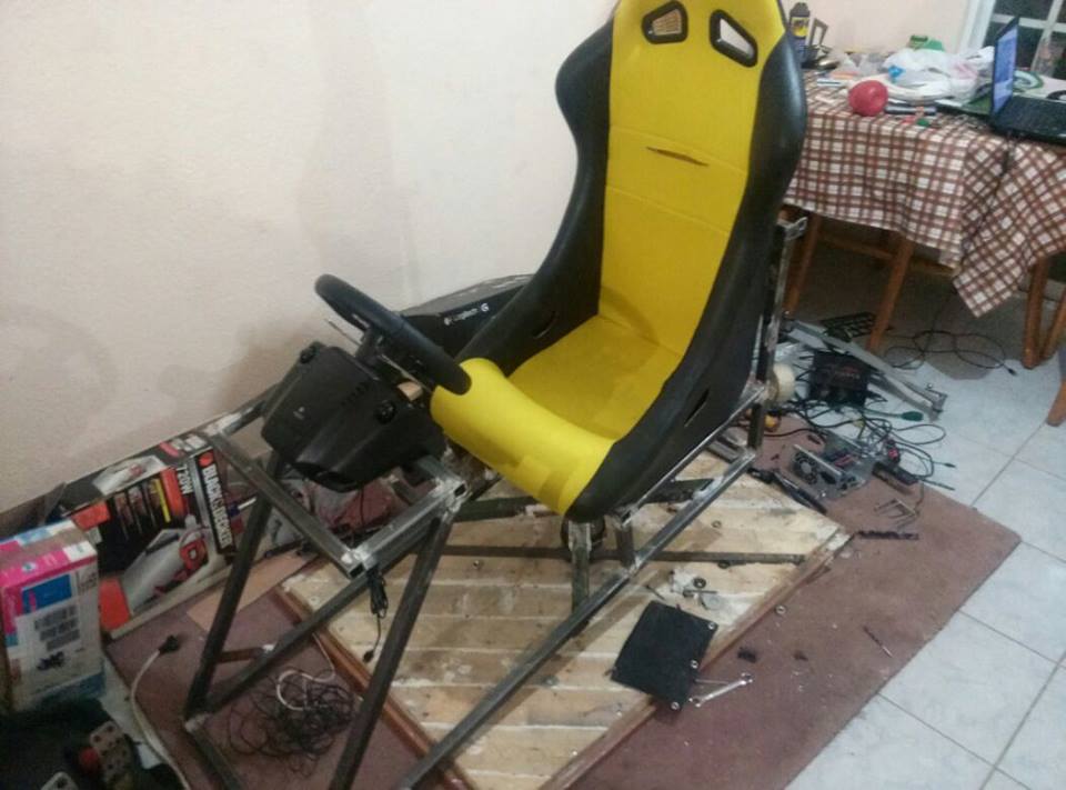

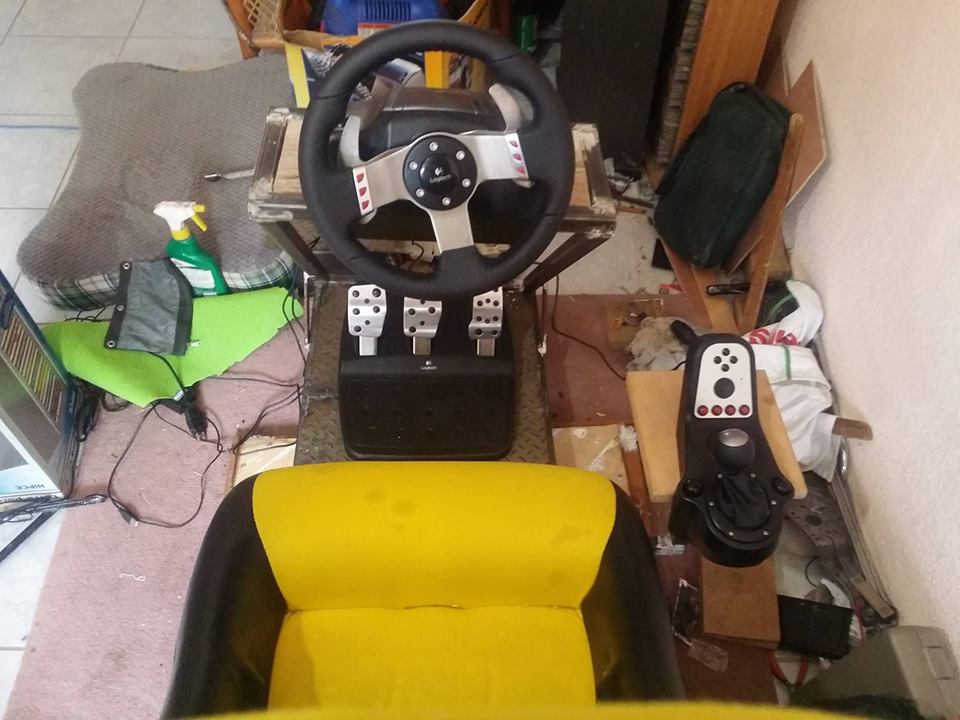

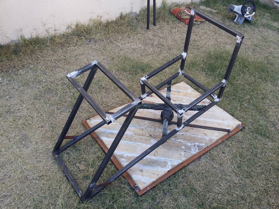

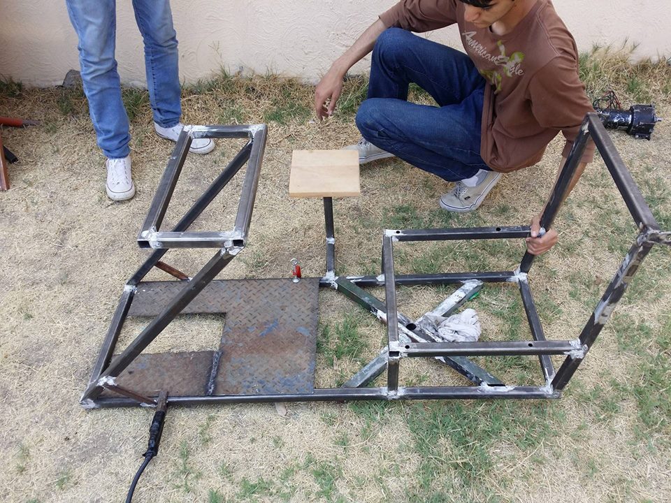

    I start this simulator for my highschool graduation project.
    thanks to the great amount of information in this forum and the internet, I dare to make my own simulator of driving.

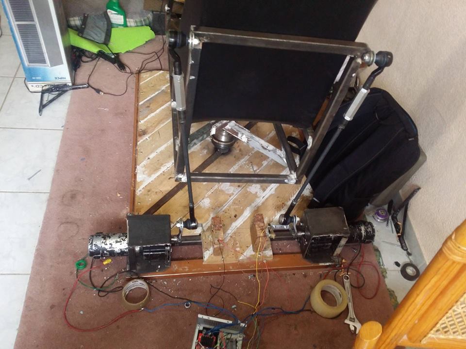

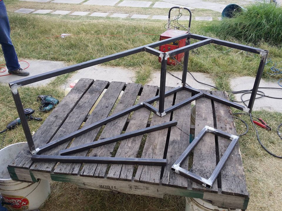

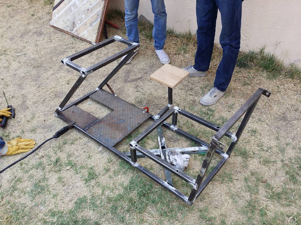

    I started with the structure , I decided to make it robust because I need to load a lot of weight, but not to overdo it to avoid problems with engines. However I had problems with wiper motors, so I had to replace them with gear motors.
    estructura 1.jpg estructura 2.jpg rota.jpg 13246062_1073852756021811_623383002_n.jpg 13231194_1073852672688486_1530342502_n.jpg

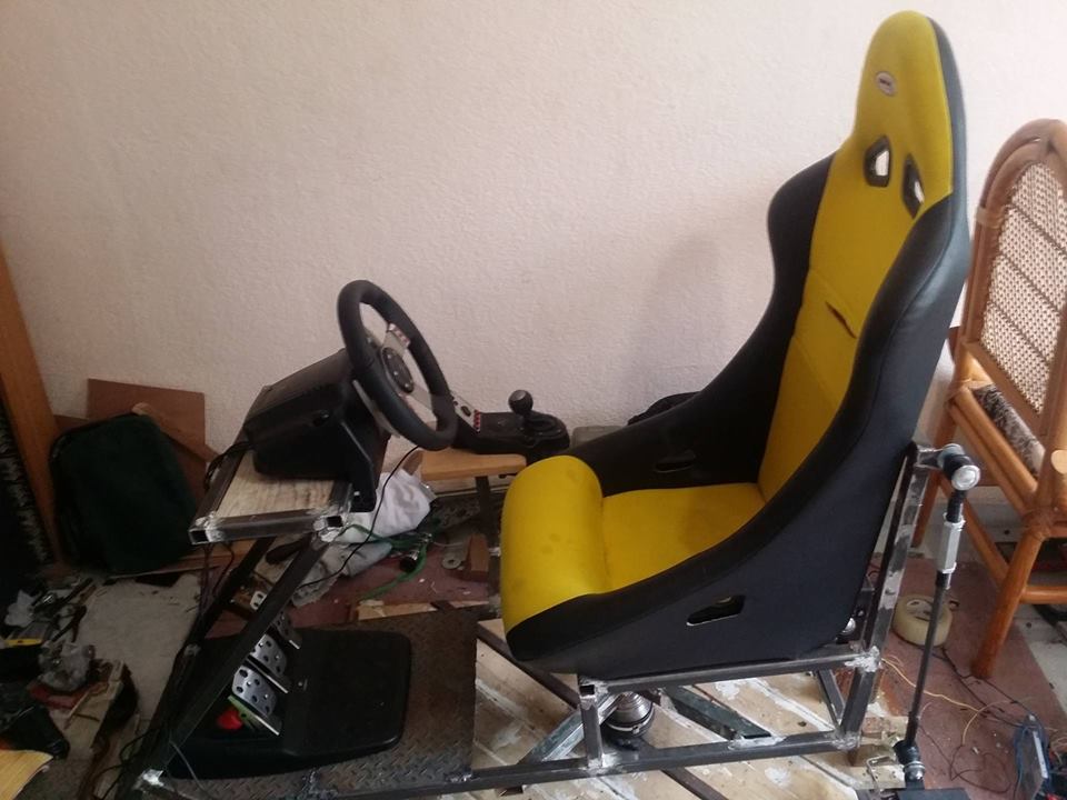

    I had problems with the Monster Shield 2 times, guess they were defective, because the third one works perfect. Still make some tests to calibrate the simulator.

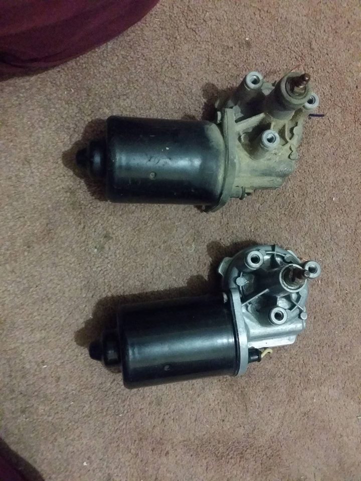

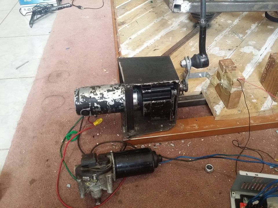

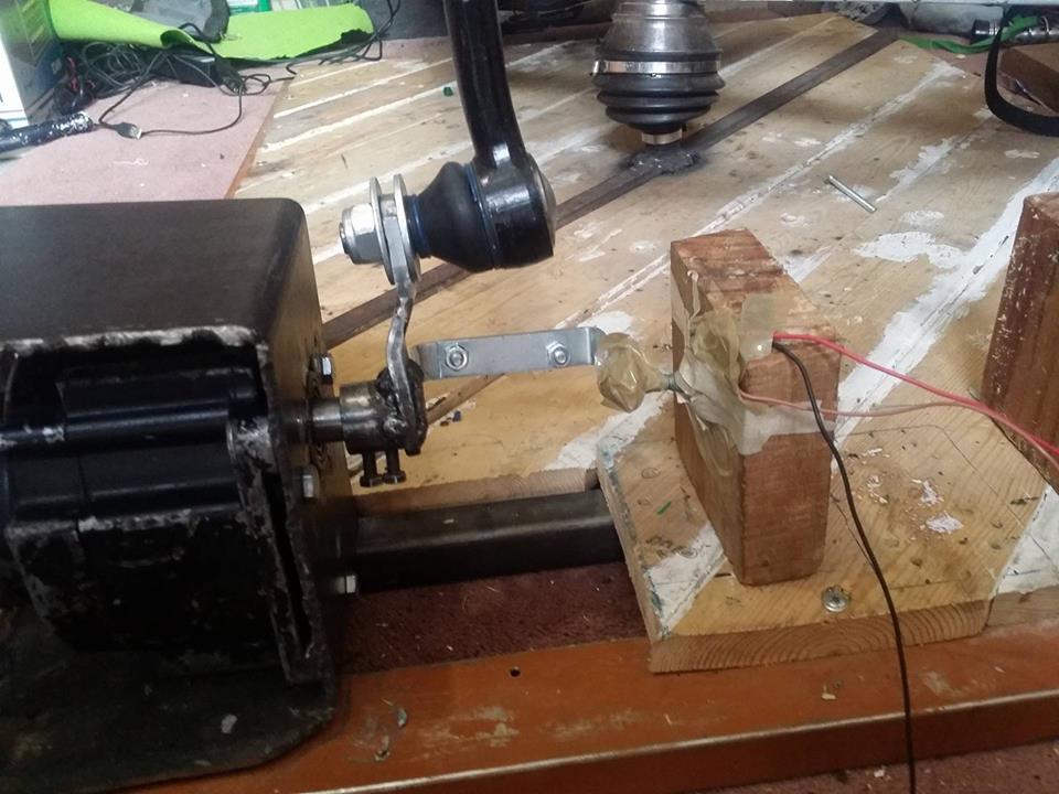

    Here is the wiper motor and gear motor, the shaft is connected to a squad that is directed to the sensor (potentiometer)

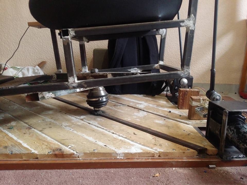

    A huge amount of progress already :thumbs

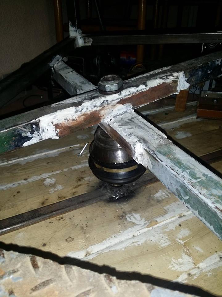

    it looks like your are using a CV instead of universal joint. You may need a panhard style control rod from the top seat frame running across the sim to the base on the other side to prevent torsional twist, which seems to be evident here:
  3. Dronx
    Dronx New Member
    Feb 18, 2016
    Student
    México
    125Coins
    The seat can be adjusted with the nut of the CV, I did some tests and do not present problems
    , in case of any problem with movement, I'll follow your advice :)
    Thanks! :grin
    21,159
    148,640Coins
    +10,909 / 54 / -2
    It will be OK as long as it can't twist sideways in the direction indicated by the red arrow.
    If it can rotate in that direction around the CV joint then it will need a panhard style rod to prevent that.

    At the moment there is no movement from side to side in the seat. :o:
    HELLO! Mariana that looks great , yeah, I also found the balance point in my simulator, the problem is that due to the weight of the structure for be very robust, the wiper motors didn't serve me, motors gear were the answer to my problems :grin

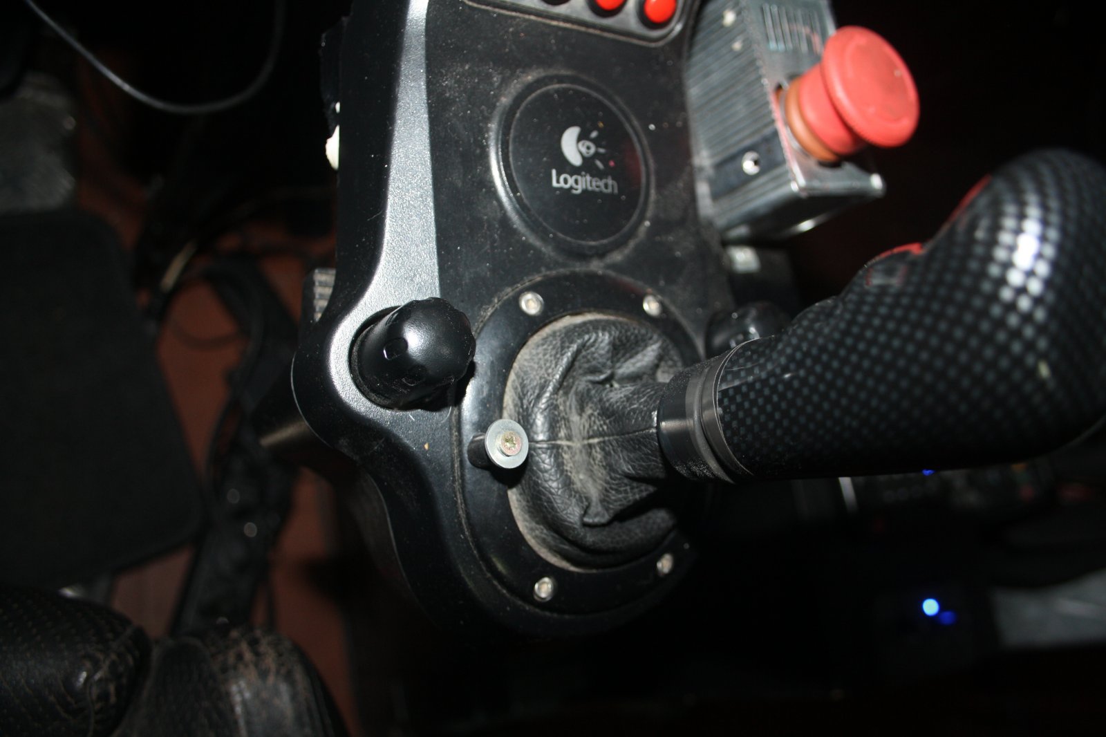

  8. mariana fino
    mariana fino

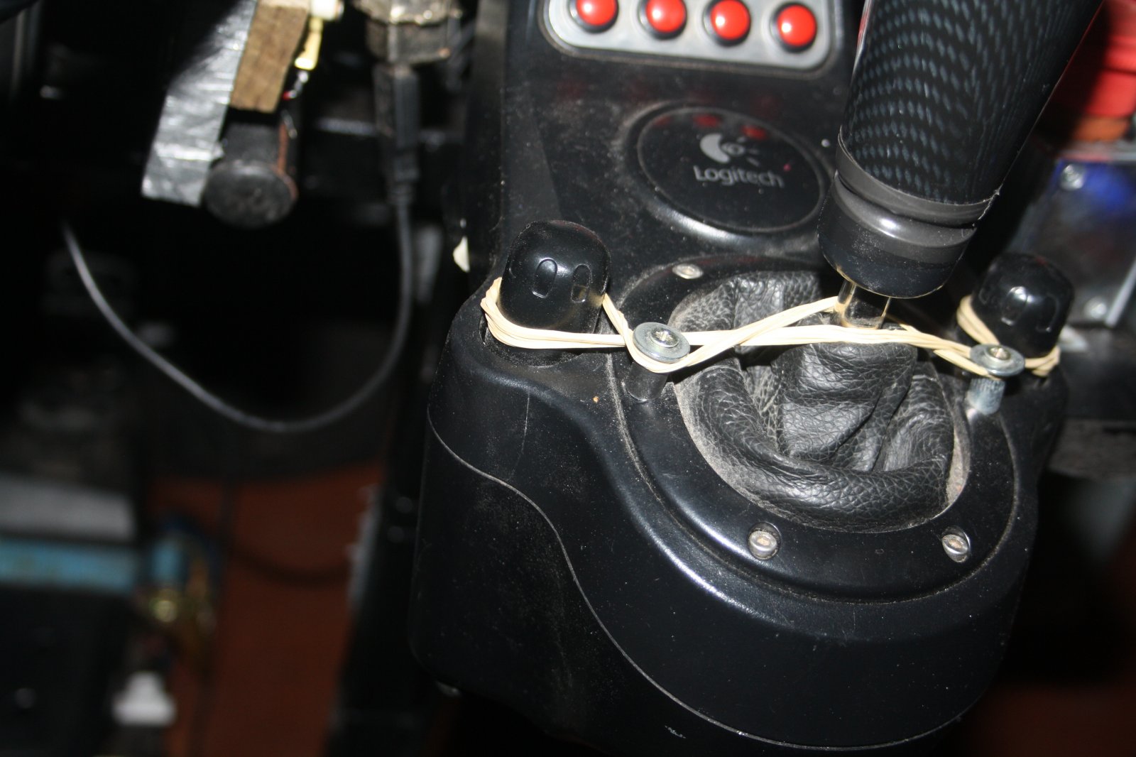

    Hi, it as dificult to chose the place because before i use two gearbox ,1 sequential another one H,but the both stay at the same place,because g27 gearbox only can do h mode,so i found a nice tip on youtube and solve the problem!!same gearbox 2 modes !!!
  9. mariana fino
    mariana fino
    Rigth side of the Whell stays handbrake,:thumbs

    Oh thats really cool! I play more AC than Dirt, so I just use the paddles when I need sequential :p Do you have a link to the youtube vid? I'd like to see it in action!
