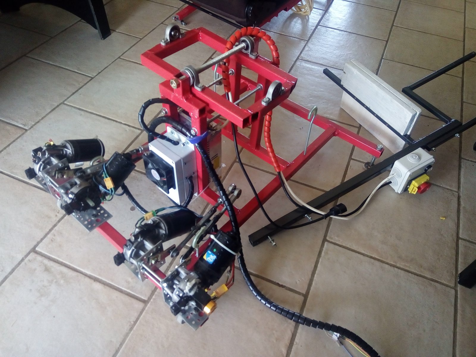

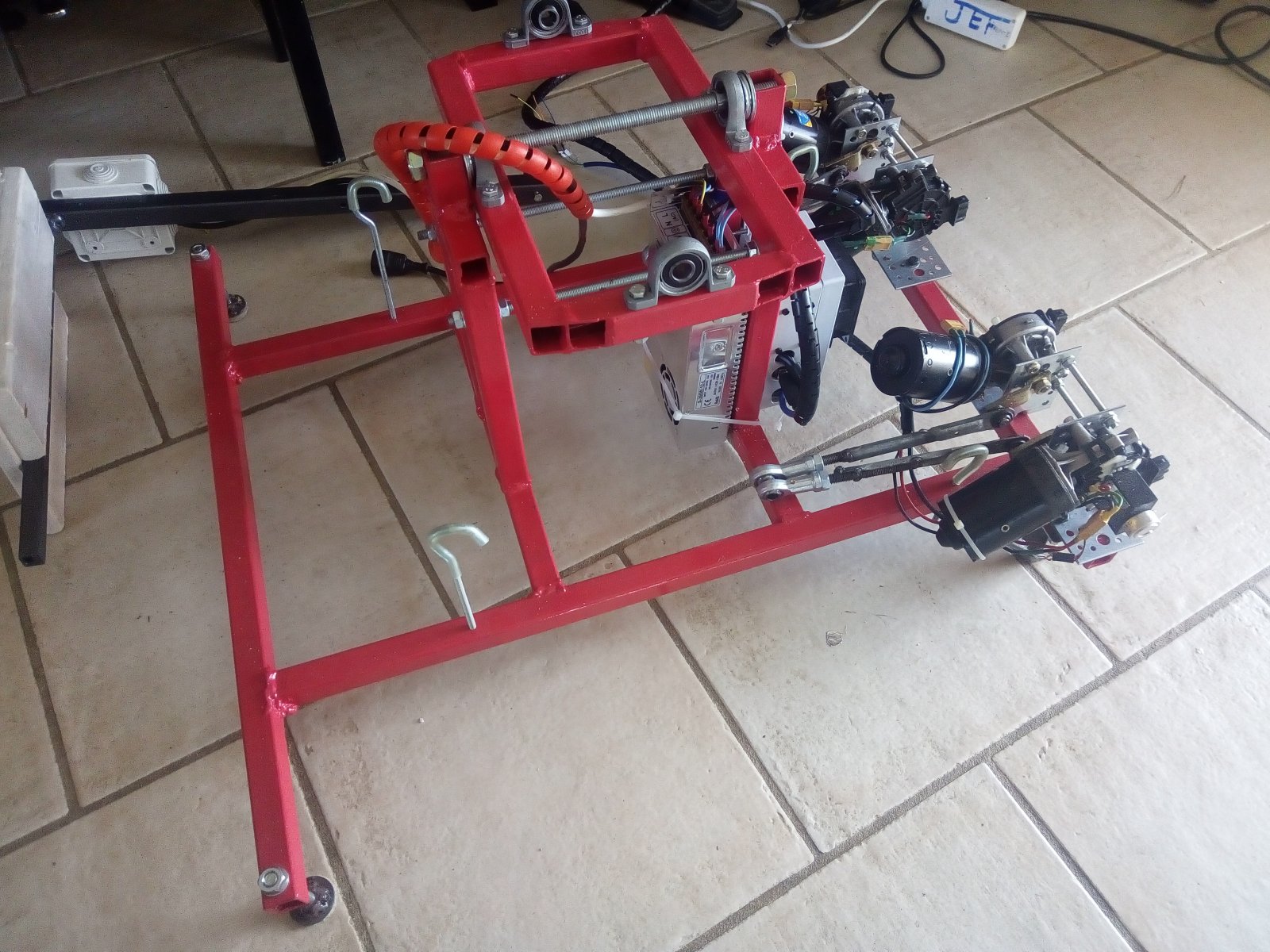

    Frame: welded steel tube
    Motors: 12V wiper motors

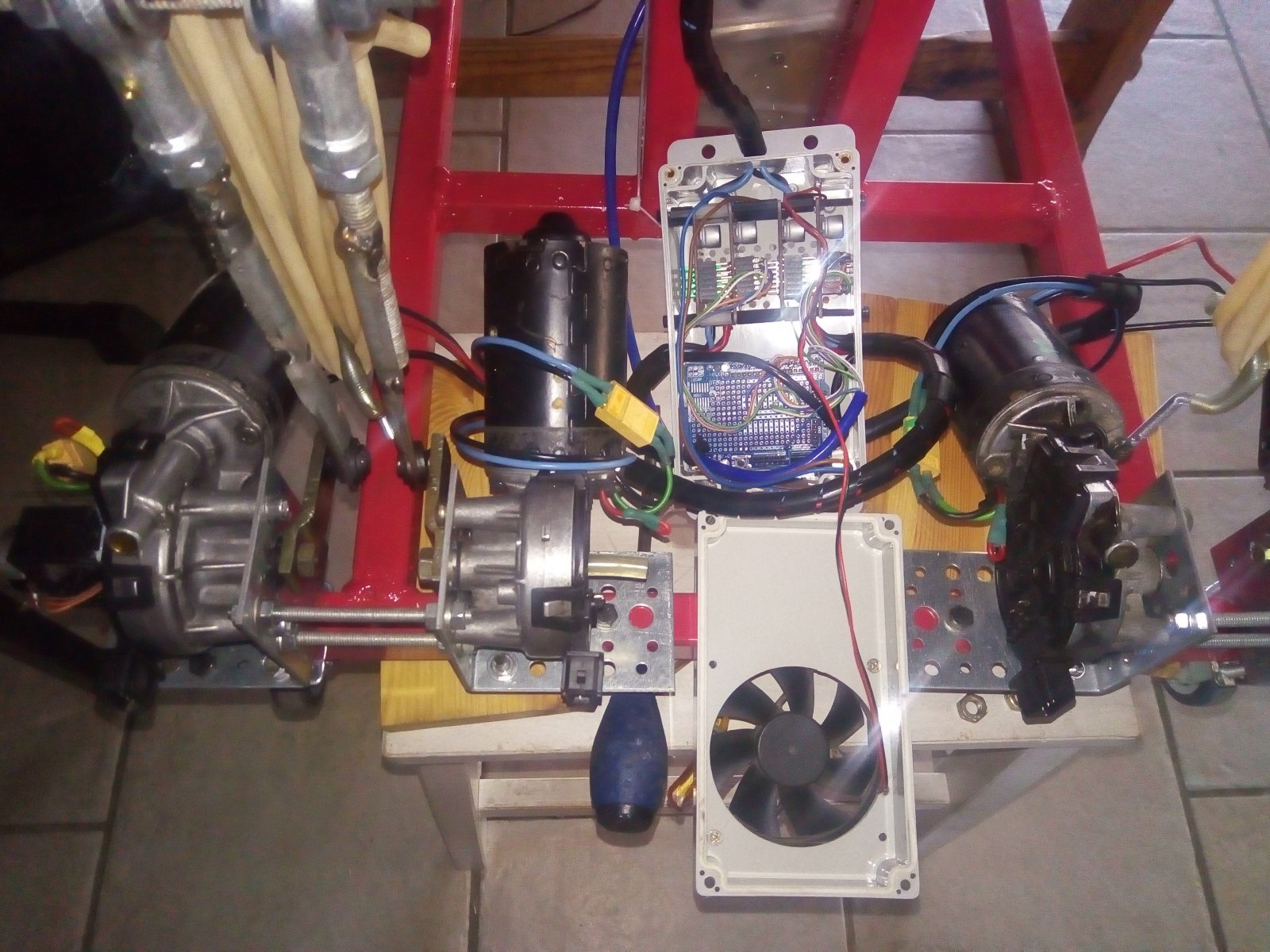

    Electronic: VNH2SP30 (monster moto clone) + Arduino
    Power supply: 12V 30A (less should be OK)
    The motors: car wiper motors.
    I bought used Peugeot 206 motor and frame because I the axis of these motors is special (grooved and conical end). I I re-used some of the linkage.
    In a first time I thought that one motor per axis should be enough but finally I did put two motors per axis.
    Caution!: the negative is earthed in these motors. You have to open, cut the wire connected to the frame and output a wire connected to the negative.
    Caution (again): these are two speed motors choose the good one. I don't know wich I used but one works better than the other.
    The electronics:
    I used one VNH2SP30 driver per motor drived by an arduino UNO (any type of Arduino should work).
    The code:
    I wrote my own PID control and comunication protocol.
    ... To be continued

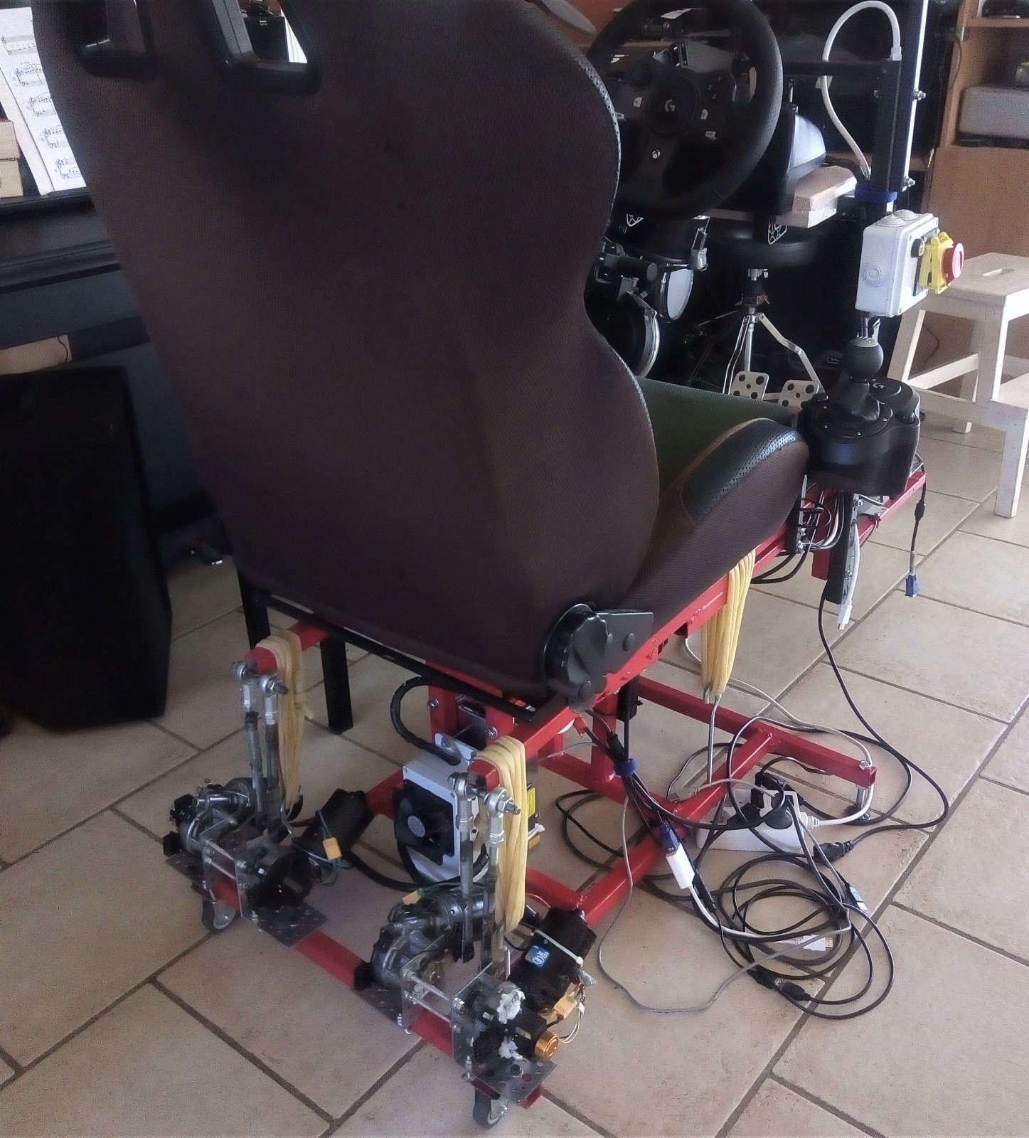

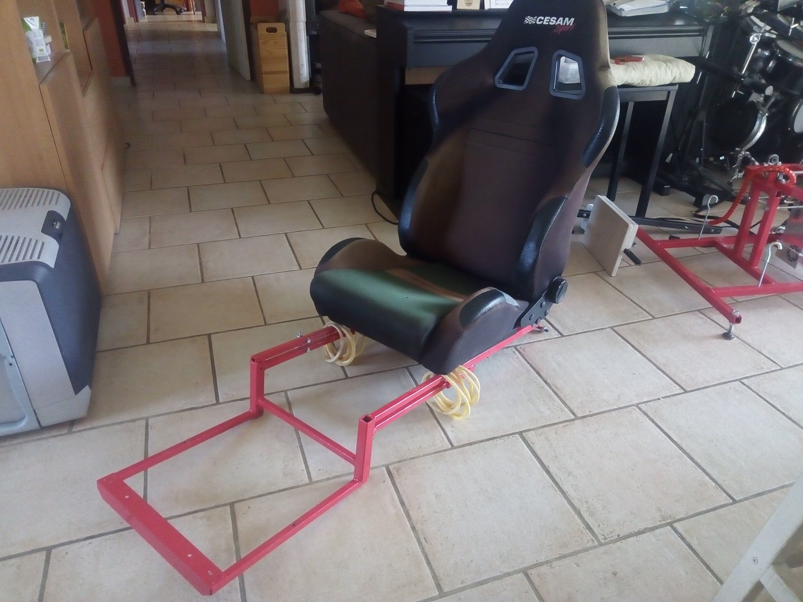

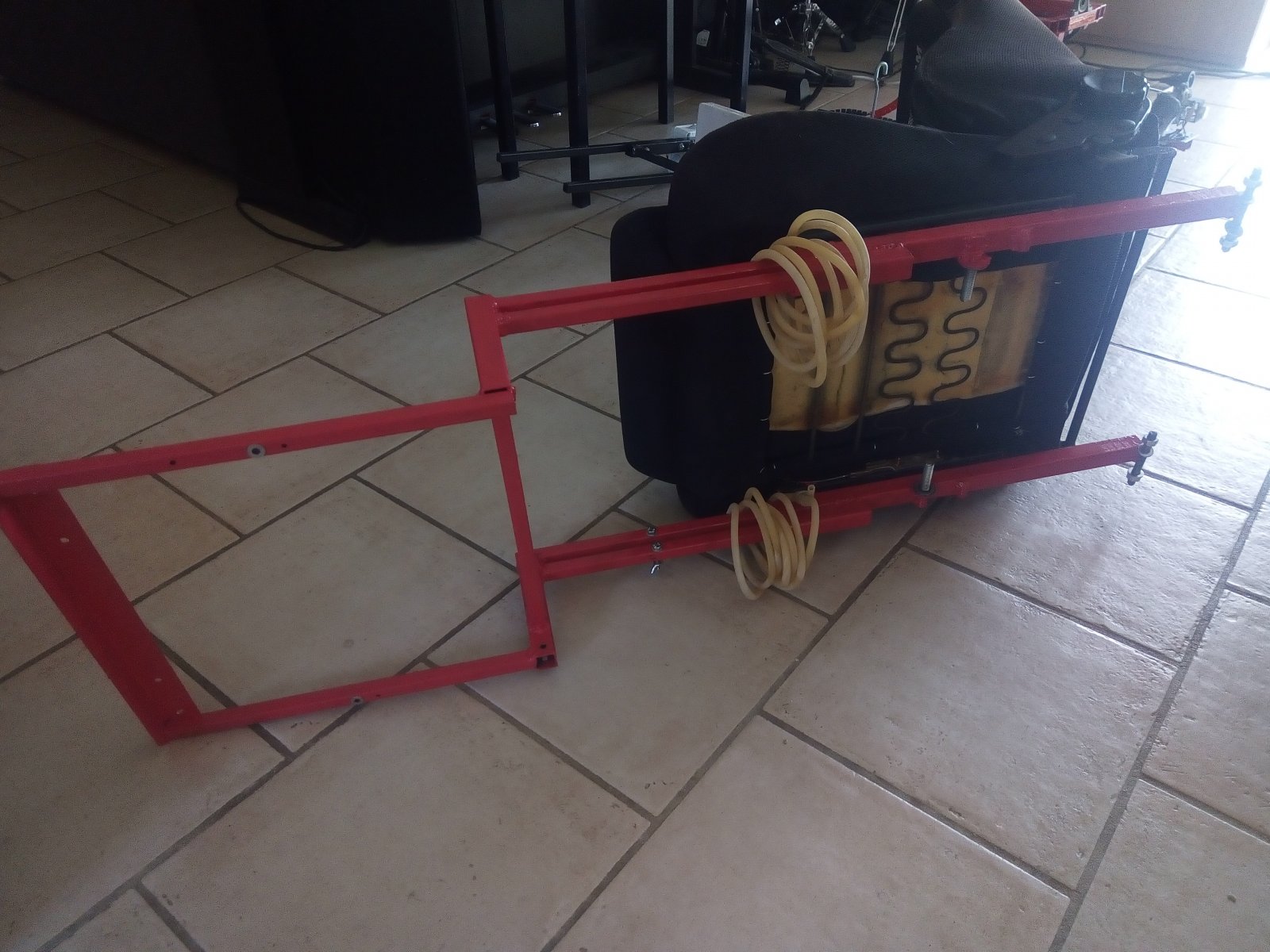

    Some pictures and the code:
    P_20180901_195343.jpg P_20180902_120843.jpg P_20180902_120915.jpg P_20180902_120952.jpg P_20180902_121037.jpg

    Formula One at Azure Coast in Project Cars by Rookie driver.
  5. FoxHound.92
    FoxHound.92 2DOF seat mover
    Jan 11, 2018
    73
    62Coins
    +30 / 0 / -0
    Wow that is some heavy movement right there! :eek:
    If there were no seatbealt he would be thrown around easily!
  6. jfbegot
    jfbegot New Member
    Jan 14, 2018
    Sete, France
    198Coins
    Yes, the guy on the seat hits the curbs, guardrails and other cars. It is more realistic when you can stay on the track.
