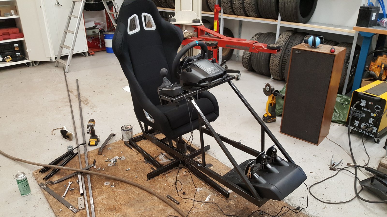

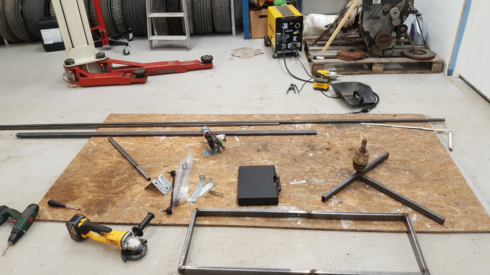

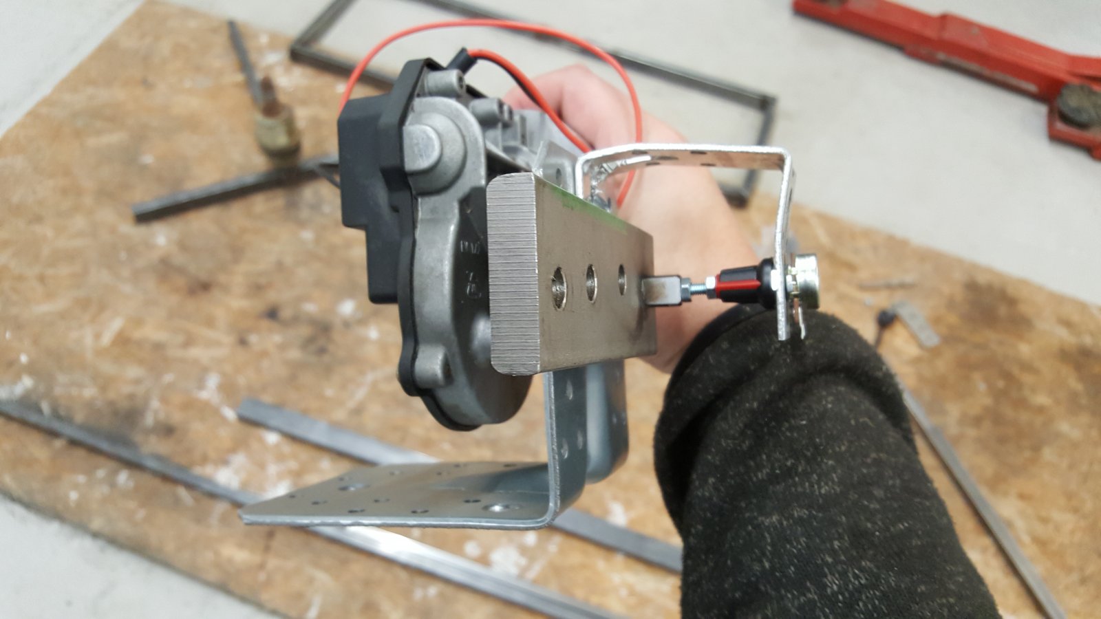

    Started up my 2DOF project a couple of weeks ago. Planning to use worm drive motors 24v. Arduino with motomonster shield.
    Welding went fine, We will see about the electronics. Made the total length adjustable to make it fit also my nine year old son.

  6. ferslash
    ferslash Active Member
    Feb 8, 2011
    495
    4,798Coins
    +181 / 2 / -0
    i think that motomonster do not handle more than 12v, check that stuff maybe you need another different driver
    best regards
