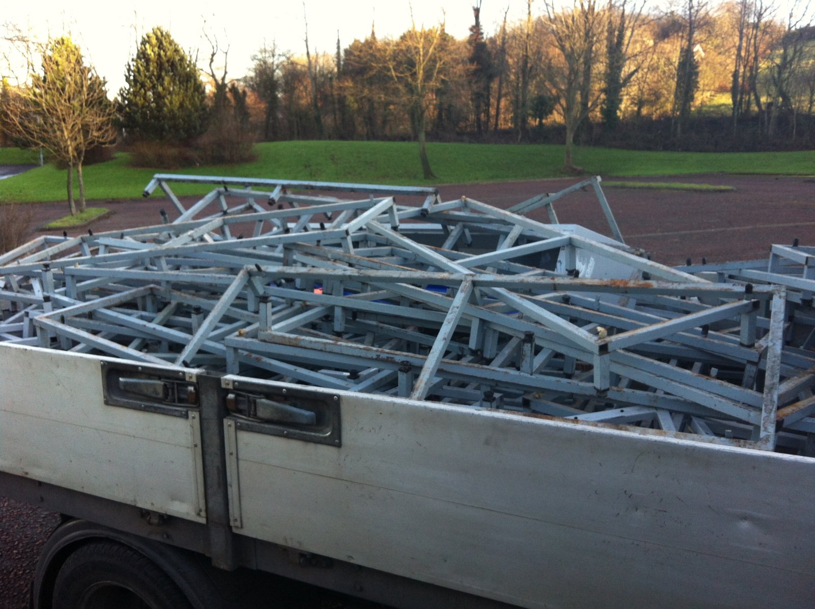

    Quick update been crazy busy last few weeks only had time to order some bits and surf this site some more :thumbs did however have a nice bonus where I work we had to scrap a load of box section frames so got me some free steel:grin

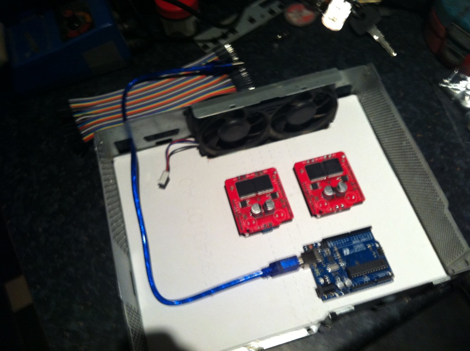

    Was thinking of putting the MM and Arduino in an old xbox 360 case I have spare its large enough plus its got a twin fan and I can always add more cooling if needed;)
