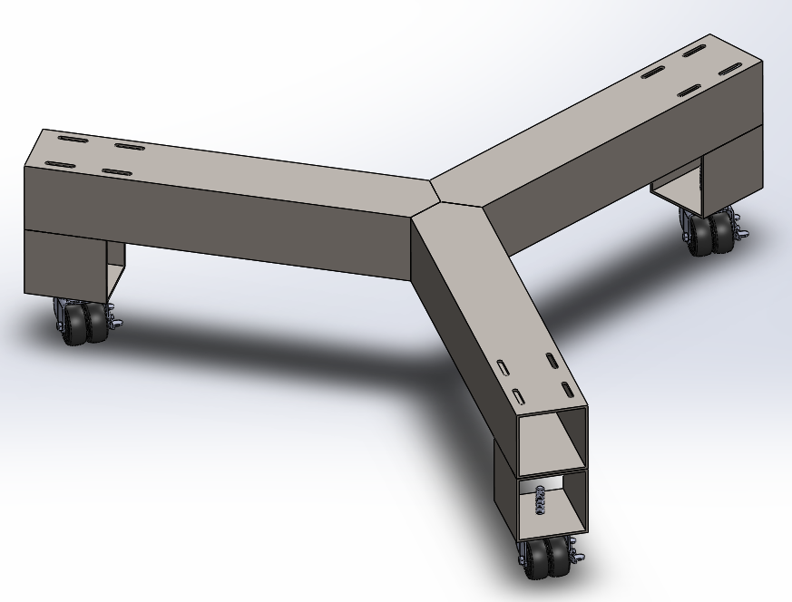

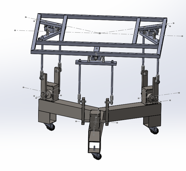

    I'm building a 3Dof simulator for research (seriously :)). I guess the amplitude and tilt angle are probably larger than most gaming simulator. Amplitude is 6 in (12 in displacement). I've finished the mechanical designing part. Here are some figure showing the CAD model. Most parts are made of steel.
    Base:

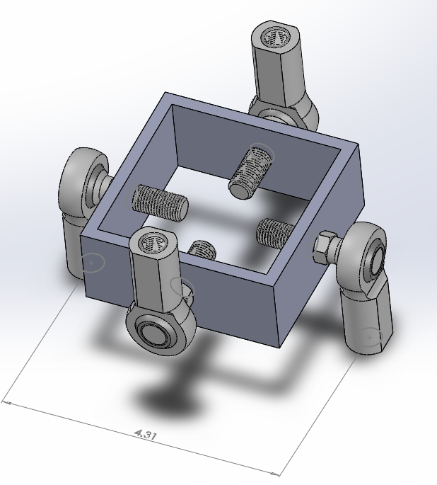

    U-joint (better for large angle than a single ball joint):

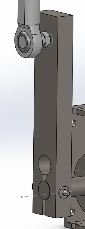

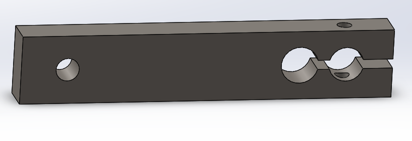

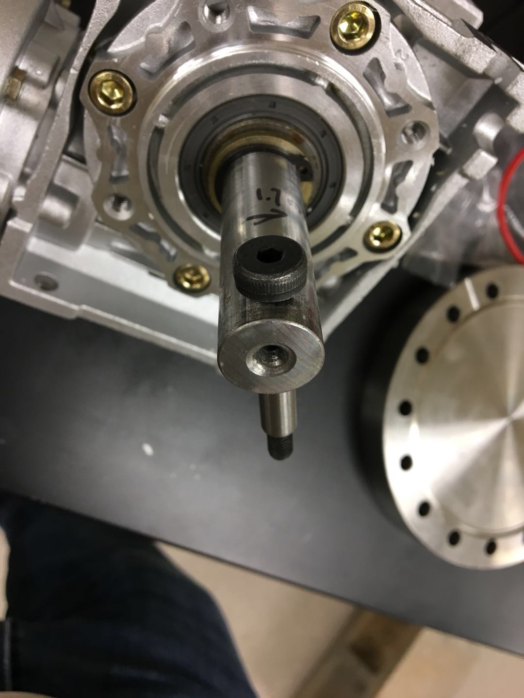

    One thing I'm not fully confident is the crank:

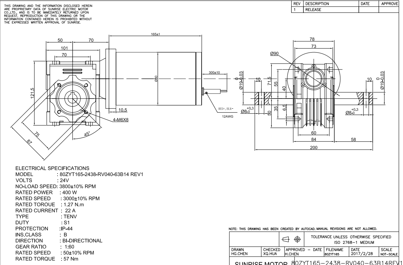

    I'm not sure the connection between the crank and shaft is good for long term use. The motor I'd like to use is this.
    upload_2018-1-4_11-53-5.png Anyone have any idea regarding my crank?

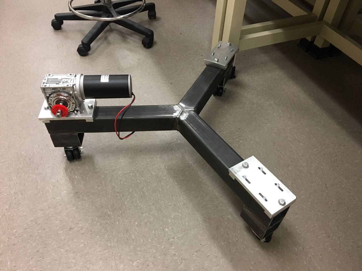

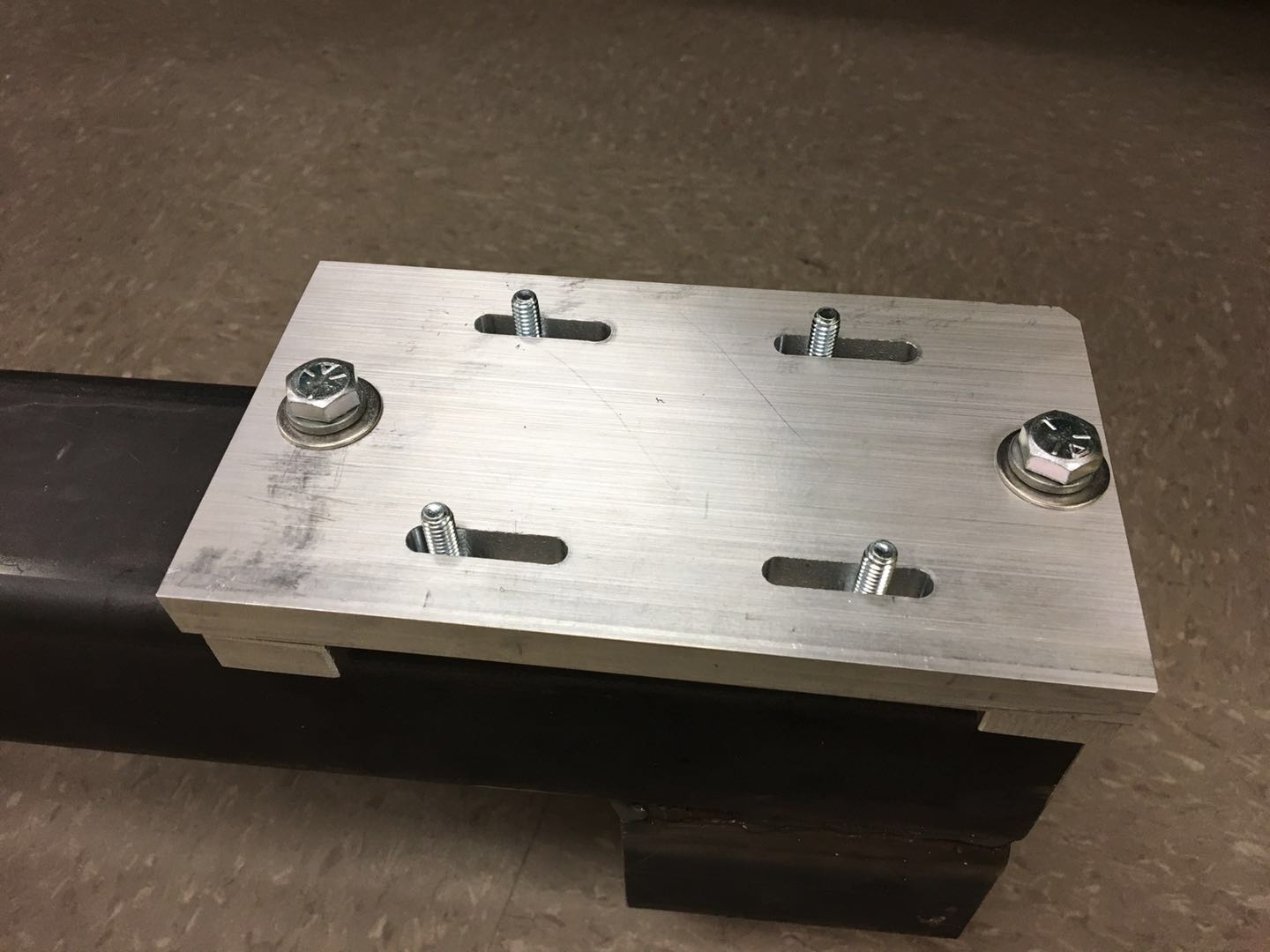

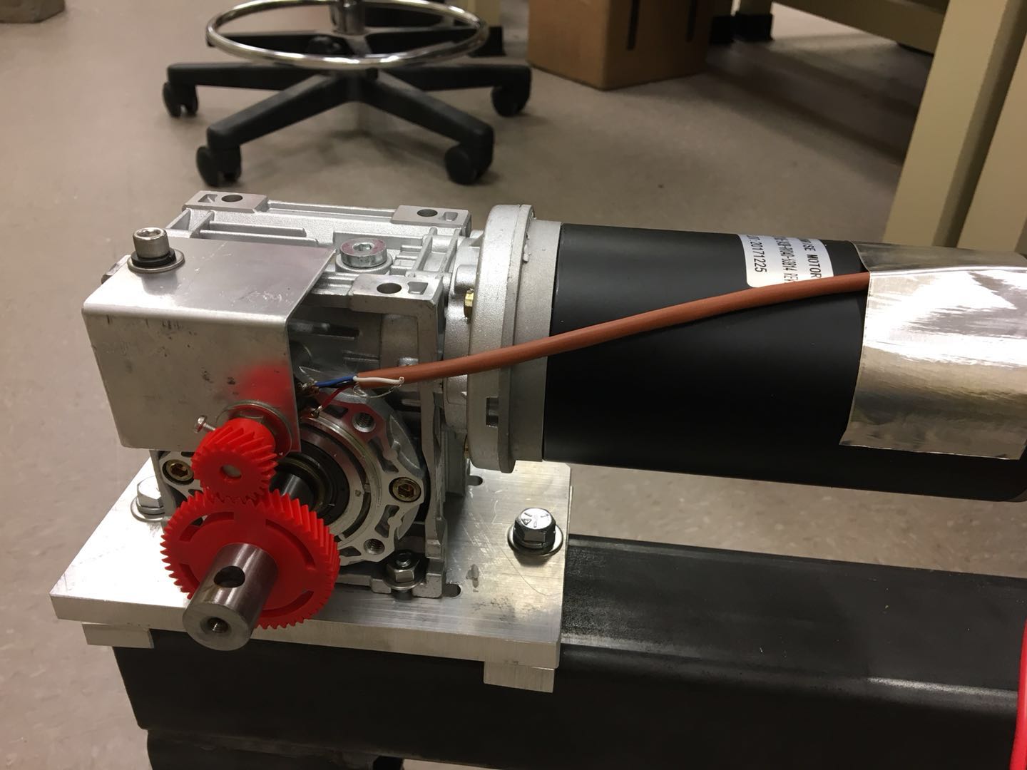

    I have to modify my design a little bit and finally made some progress on the machine. Square tube has round corners. There is not enough room for me to mount the motors. I've made three motor bases.[​IMG][​IMG]
    I used angle aluminium to make the mounts of potentiometers.
    Two out of the six through holes in the motor shafts are off-centered. Luckily, I only made three cranks before noticing this.

    looks good !
    what made you choose 3dof over 6dof
    when do you start building ?

    Cost is one reason. And 6dof is actually not necessary for my project.
    I'm gonna order materials next week. Hopefully I can start the week after next week.

    I have to modify my design a little bit and finally made some progress on the machine. Square tube has round corners. There is not enough room for me to mount the motors. I've made three motor bases. WeChat Image_20180513222825.jpg WeChat Image_20180513222835.jpg
