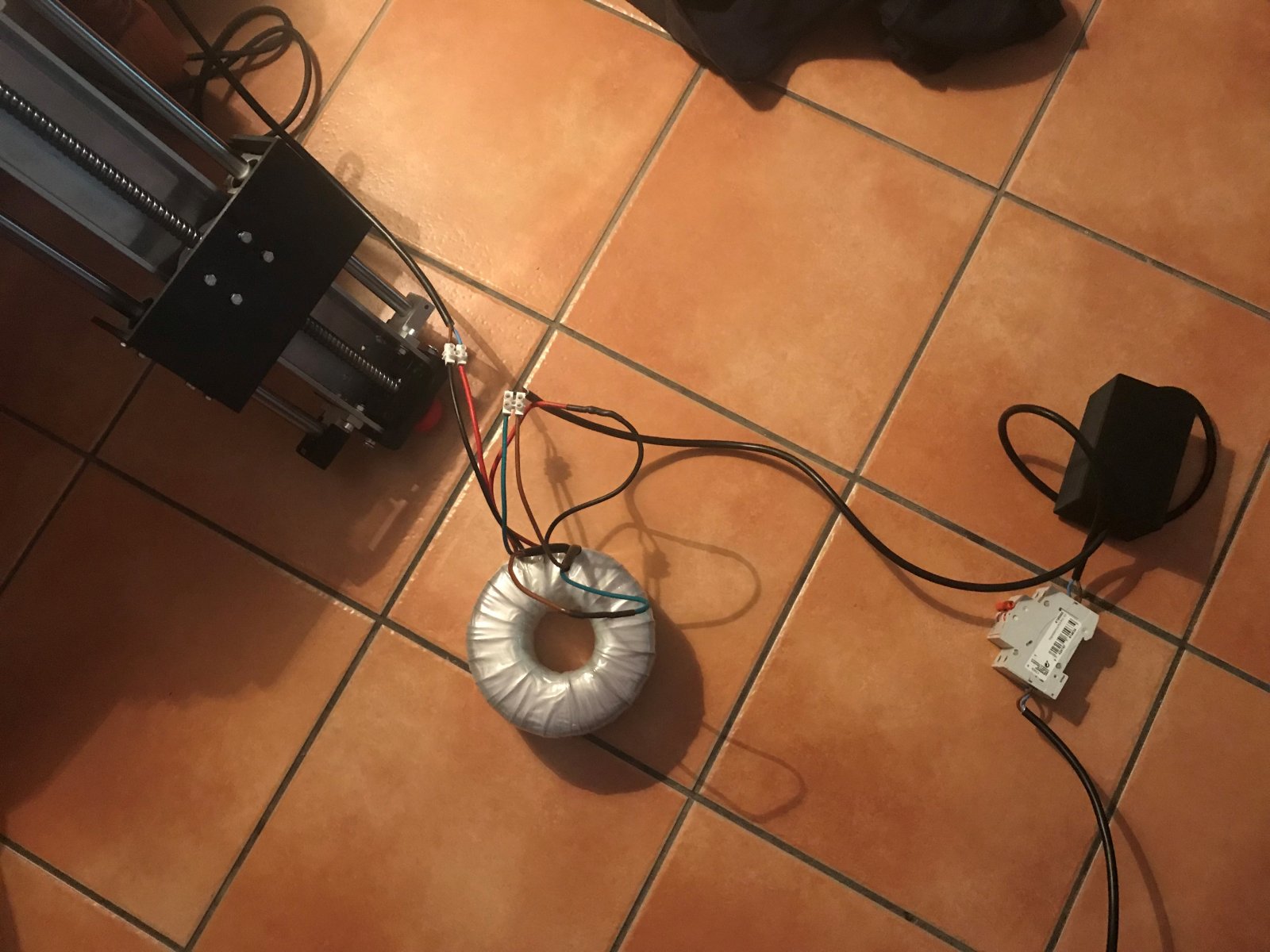

    So the first parts are slowly coming in.. I have my 8Nm Nema3 motor and some sliders, but waiting for a few essentials parts.. Hefty, heavy little beast.
    But I need some Torodial Transformers.. It seems that the specs of the motor are 60 V AC with a Max of 8A.. Looking to attach 2 motors per transformer so a max of 16a would be needed.. Andybody with knowledge of these things can point me to the best available options in Europe?
    This is the part that I don't know any thing about!!! So advice is needed in this area.. I see 200/400/1000VA but then I am already lost :) Thanks in advance !!!

    Would this transformator (Ringkerntransformator 1000VA 2x30V RK-EC/1000 ) be enough ??
    And I think I need some additional wiring with a fuse or something? any idea's are welcome ..
    I never used AC power, was told it ain't hard, but don't want to fry stuff :)

    I bought the 1000VA 2x30V so I should have 16.6A to divide over the 2 servo steppers which happen to have max of 8A.. so I should be pretty save running motors on a single transformer..
    Just need to figure out on how I can 'hide' and connect the transformer as it is really big and heavy.. But on the other hand .. All is big and heavy in the parts..

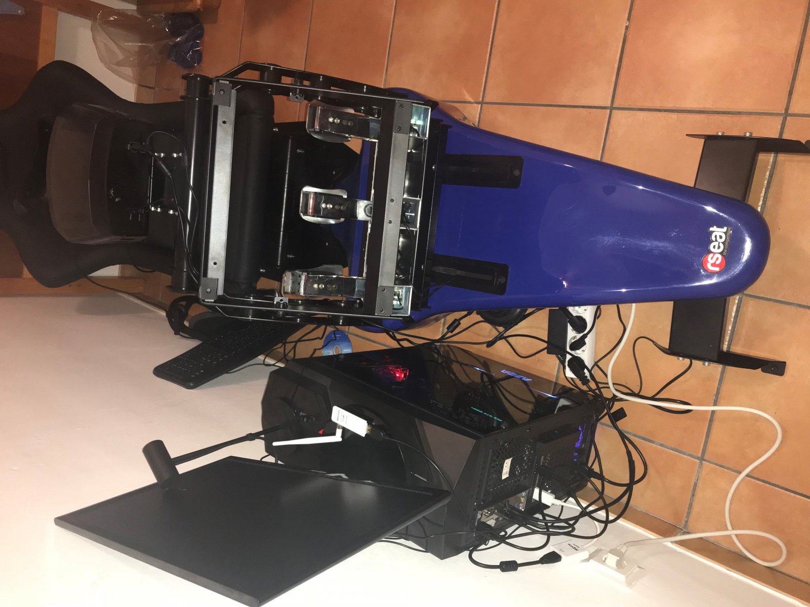

    In the meanwhile my new PC arrived.. With the oculus rift and i7 8700/ 1080Ti. So I should have enough power to run all the games I want..
    then ordered the base frame for the simulator at rseat.. and settled for the Formula V2 in Blue .. I hope this will be delivered somewhere next week (it is on transport since today) .. It still is a big challenge to have my parts shipped to my temporary location in Spain..

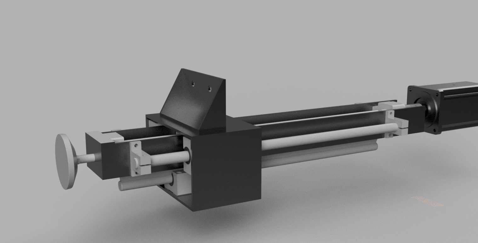

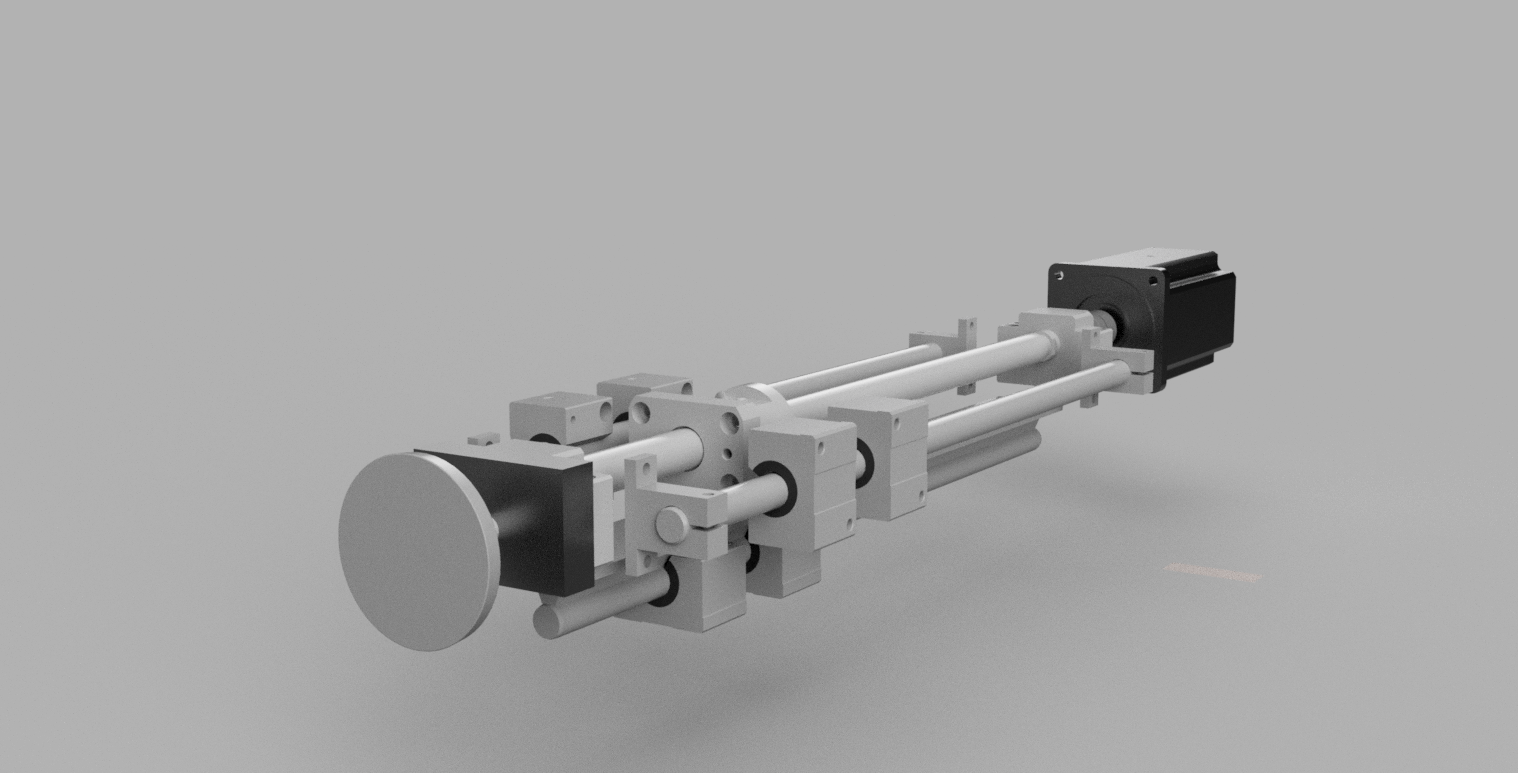

    I will change the base with the foot to have it on a half sphere, with a rubbery texture.. so that I have less friction while it is operating.. because all 4 corners will be firmly connected to a base frame and that means that the actuators will be able to swivel left and right..
    The design of the frame will be based on the base frame I have bought from RSeat.. So I will measure and design as soon as the rig has arrived at my doorstep and is set up ..

    As a rule of thumb, take the half of the current that is printed on the stepper for your transformator. Example: 8A stepper -> 4A PSU
    A stepper always needs a stepper driver. I never saw types with 60 V AC. Normally they are up to 40 V, 80V, 130V, but allways DC. But there are some types which run on a normal AC line (230 V).

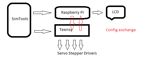

    I am going through with the route of Simtools -> raspberry for config and visual display -> Teensy for driving the servo's based on the calculations of the raspberry.
    Another route I am thinking of is as follow.
    Here the config is set by the raspberry and the code in the teensy should calculate based on the variable values created by the Raspberry.
    this would give me the ability to have a visual output on the raspberry LCD.. But this is not in concrete but an idea if I want to have the display on with a visual representation of the motion..
    As all the variable values are also stored in the EEPROM of the Arduino that way I can use the Arduino standalone and only connect the raspberry if I need to retune or recalibrate..
    But with a button on the teensy I can also enable the calibration routine..
    Communication between the Raspberry and Arduino as a bit of a problem.. Using SPI and I2C were giving me a headache.. But now with an inverter for 5-3.3V I am able communicate over the
    RX/TX ports.. So between the raspberry and Arduino the communication is plain Serial data..
    The reason for the second route is that I can remove the raspberry all and only need it for configuring the variables .. like length of the actuator, speed of rotation, steps, calibration init..
    Against this second route is that I can make the motion more variable and have the raspberry calculate the distance and speed.. with this I can play around by having short vibrating moves moving faster while having long hard moves smooth out a bit by reducing speed.. making it a bit more comfortable in large hard moves like moves from 127 to 255 being on a different frequency then moves between 100 -150 which would be on a slightly higher frequency..
    But perhaps that is something simtools already has in it's filtering options..

    The images included are a bit dark but it is late in the evening here.. and yep .. the floortiling is typically Spanish :)
    The power lead.. 16A fuse used as switch to a softstarter.. to the toroidal transformer..powering the driver and motor
    As you can see it is way too big.. but for testing it will do.. will use 250mm ballscrew instead of the current 600mm

    The actual rig it will be attached to. The frame will rest on a H frame (like ||--|| ) with the actuators on the corner with the seating as Center of gravity..
    Apologies for the sideways pictures ..
