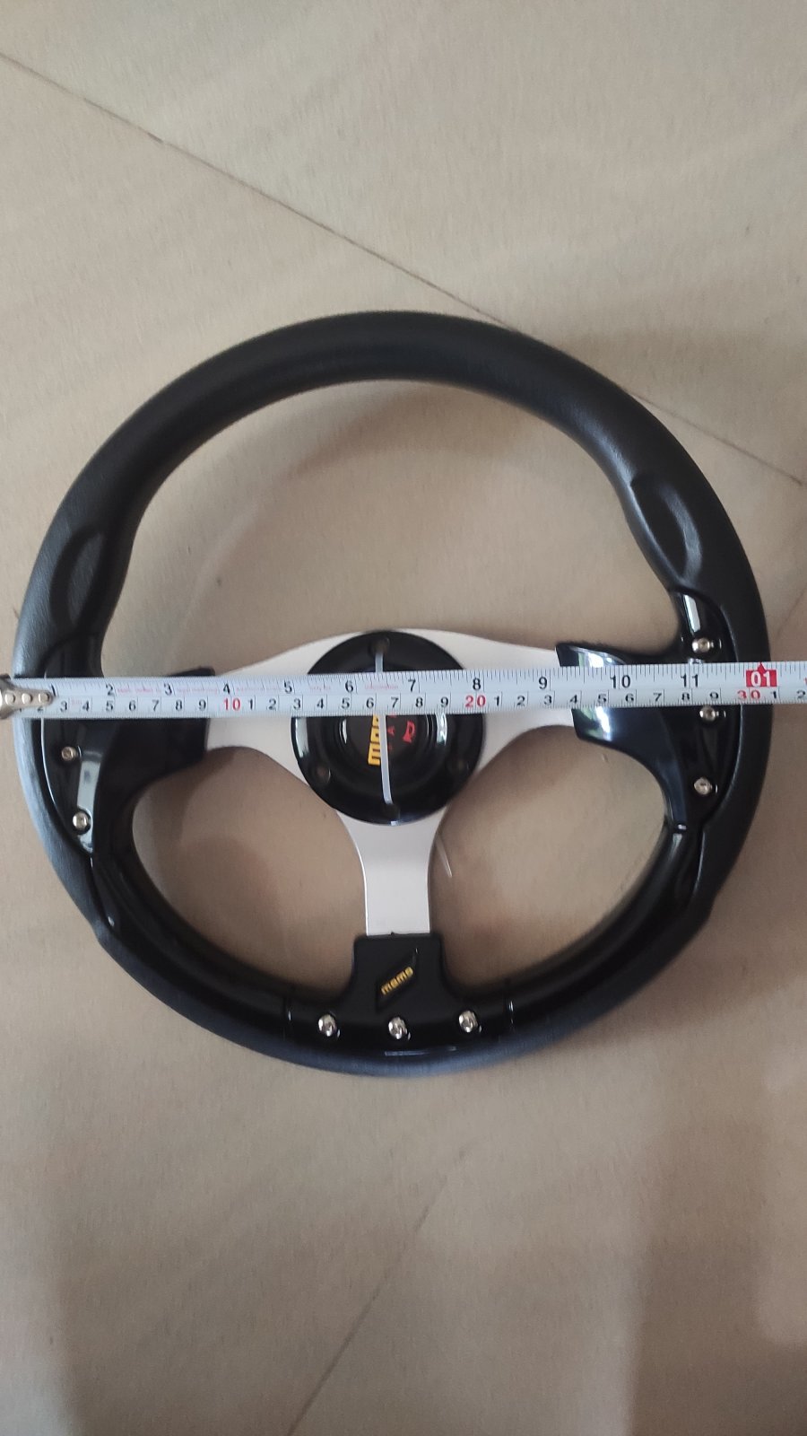

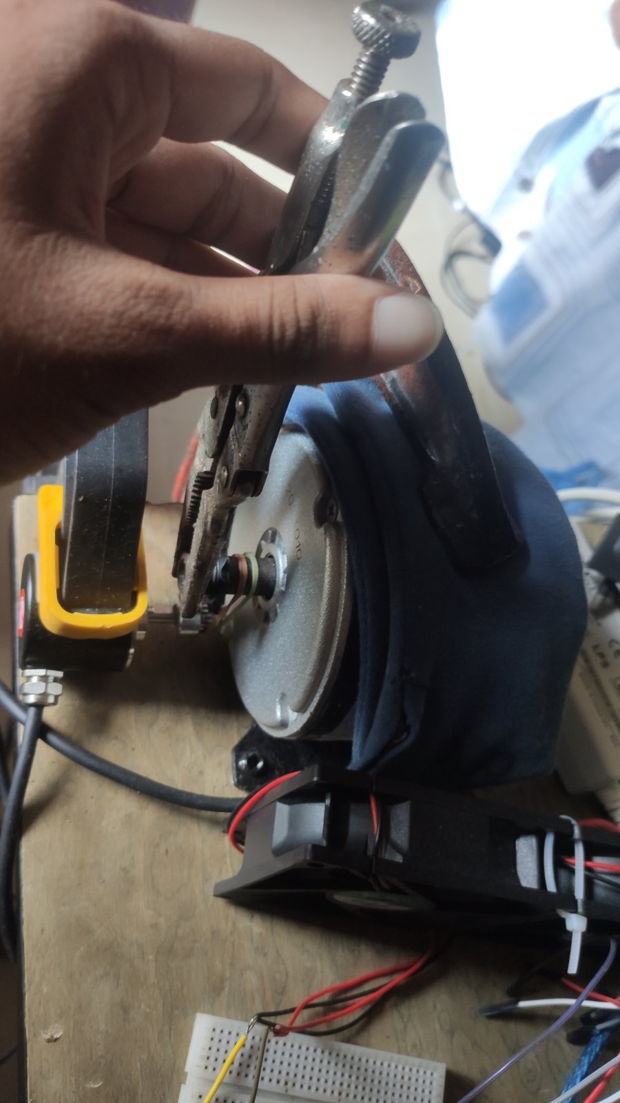

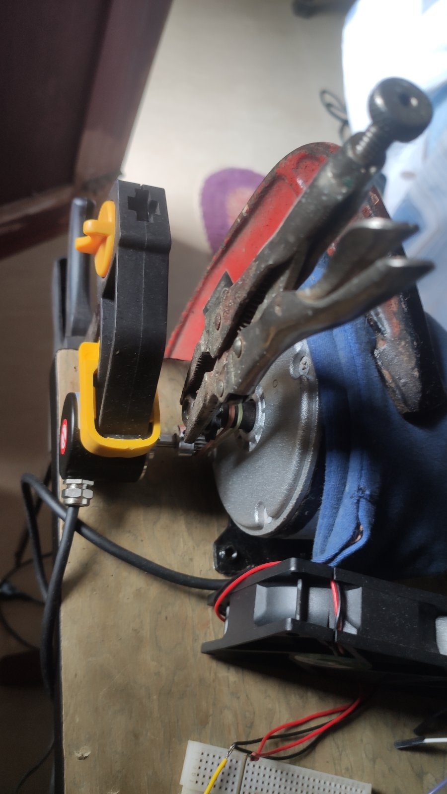

    This is my steering wheel if any is curious I know it bad but will have to do
    And this is how I tested the motor:
    Without using the steering wheel so make shift DD wheel kinda I guess

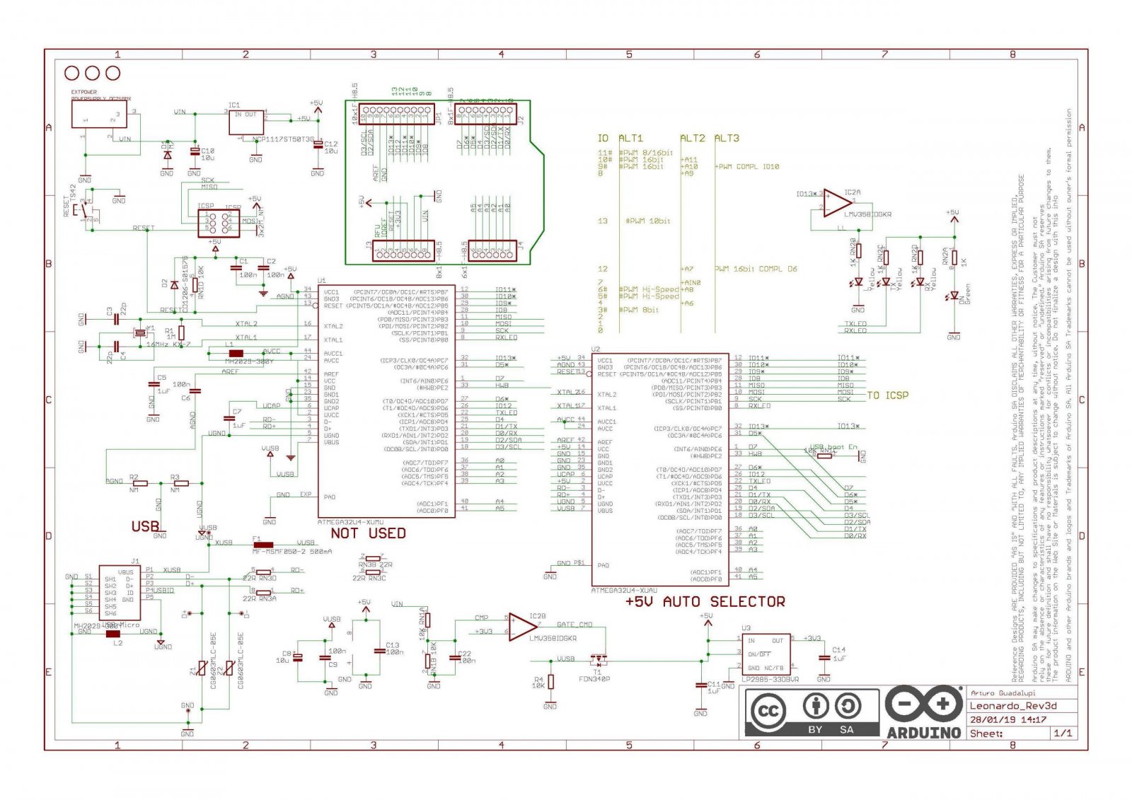

    is this what you wanted am very bad with these schematics cant understand shit :mad:

    That was the schematic of the leonardo board. I meant the overall schematic how everything is connected. But never mind. I've looked up the data sheet for the BTS7960 driver. It claims to have overcurrent and overtemperature protection. If it failed in spite of this there must have gone wrong something else.
    I think this is overkill for a FFB wheel. Other people run their motion rigs on theese motors and don't have problems. I doubt that the problem is back EMF or "too little power". My guess is that it's "too much power" instead. Consider this: The BTS driver has no current feedback. So the software has to guess the speed of the motor and the BEMF voltage and apply a little more or less voltage to regulate the current which it can't measure directly. For this to qwork it depends heavily on the motor parameters like voltage constant and winding resistance to be tuned correctly. If you use a larger motors a mismatch of theese parameters is likely to cause overshoot and oscillations.
    A capacitor can store energy. It is charged when current flows into it while the voltage rises. It can give back the energy when current flows in the opposite direction while the voltage decreases. No heat is generated unless you exceed the voltage limit. Think of it as tensioning and relaxing a spring. It can break if you overstress it.

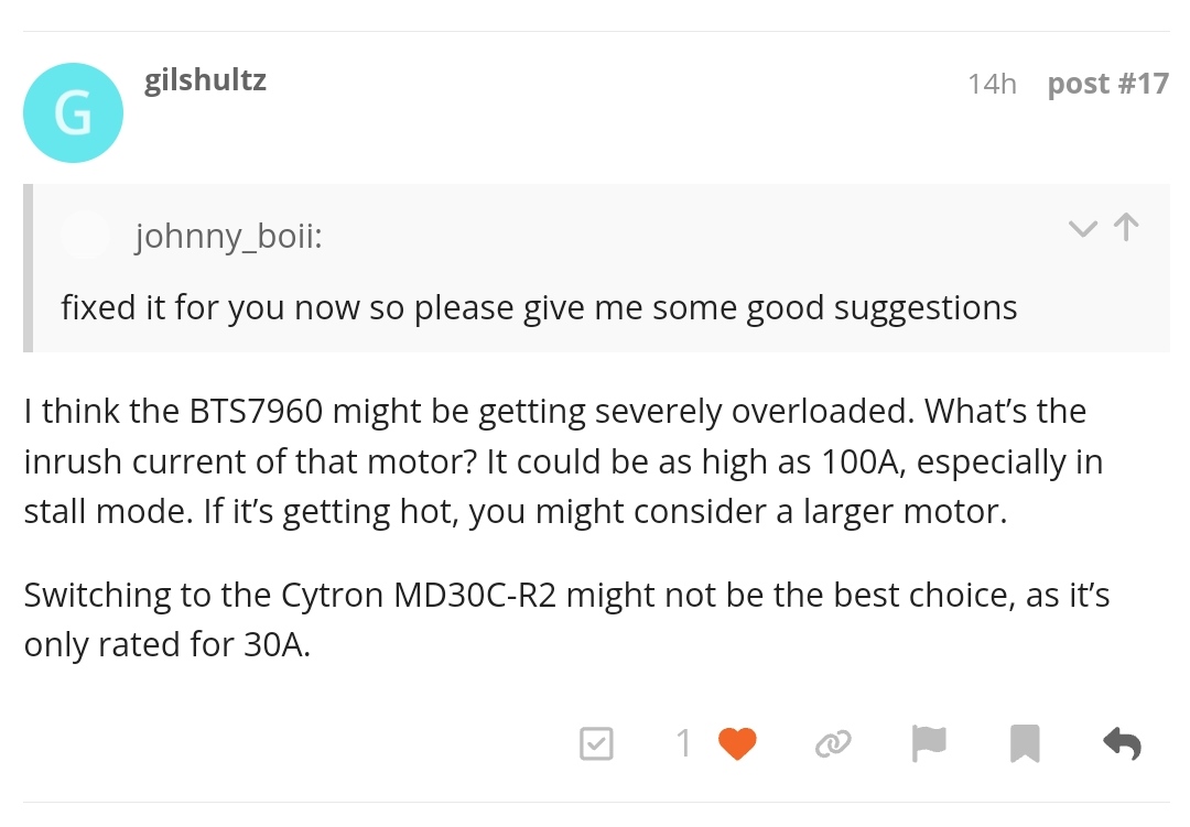

    This is what one guy said said in my Arduino post (am not sure about 100A part)ps got to get a multimeter just incase

    I think I'll stick with the cytron MD30C-R2 cuz it wouldn't heat as much compared to the bts
