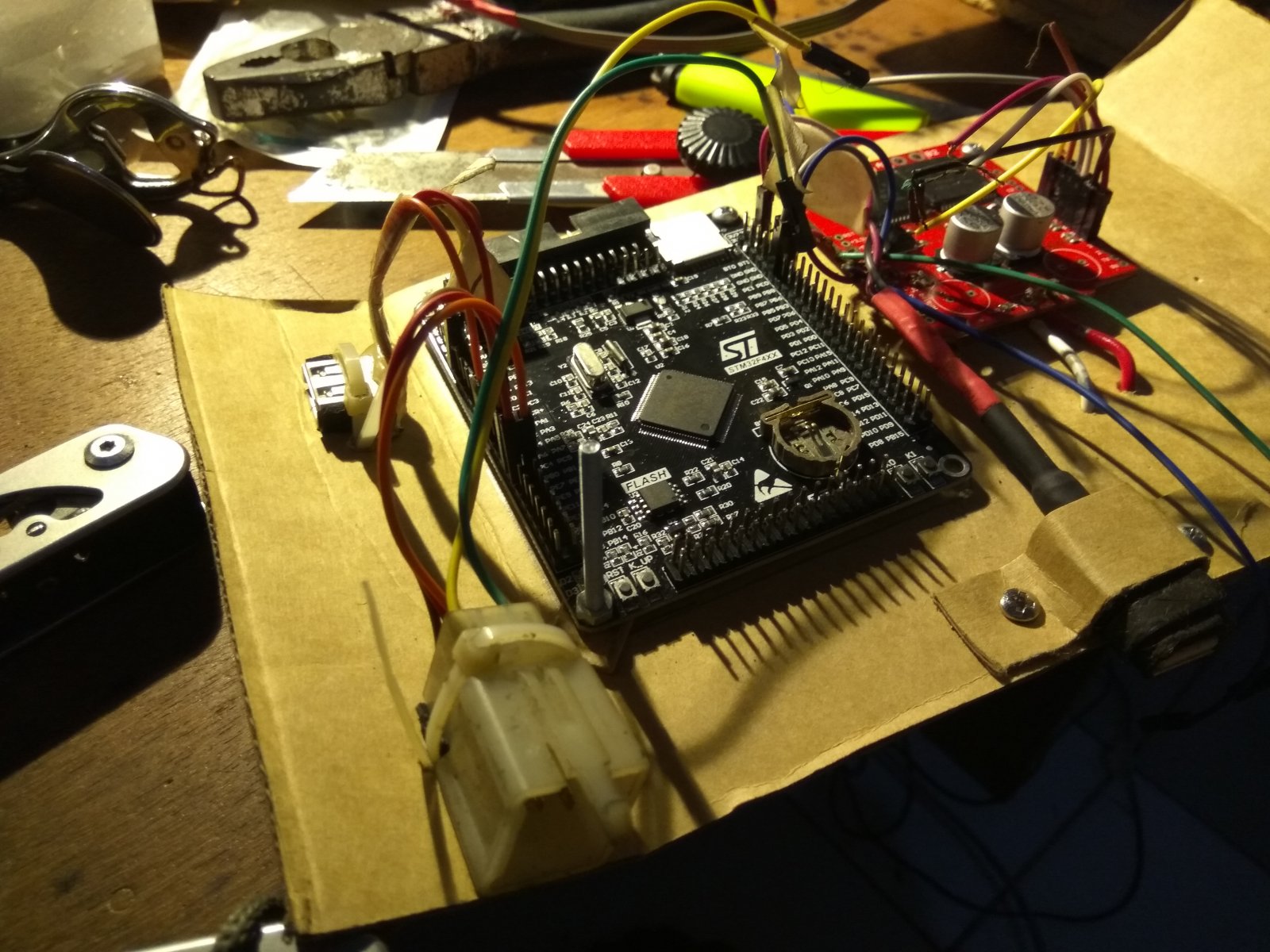

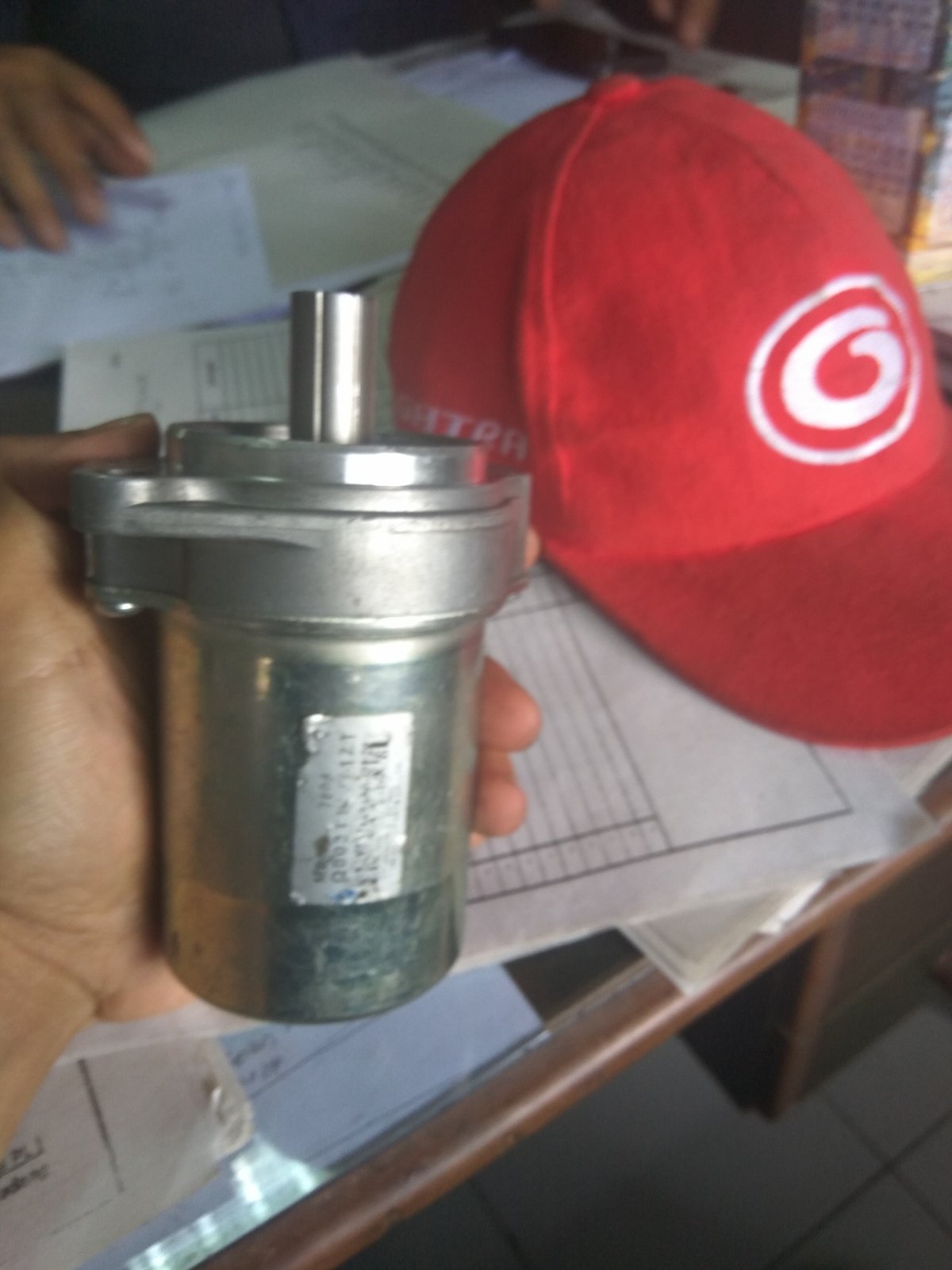

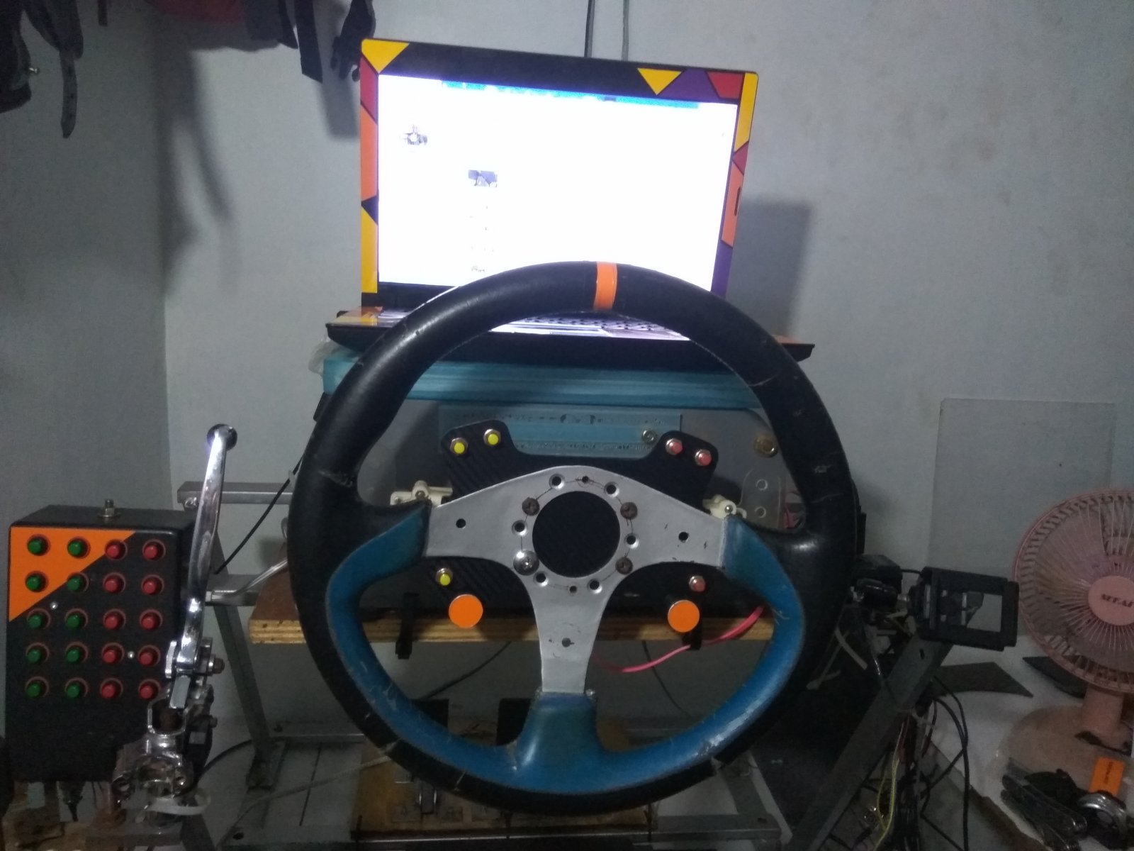

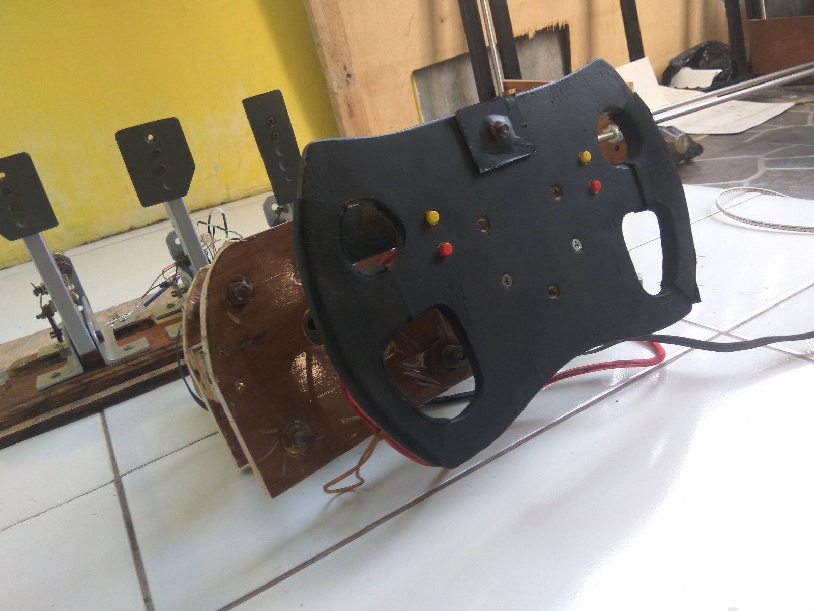

    after reading, lerning, and much searcing on google and youtube, i decided to build my own force feedback steering wheel based on MMOS as cheap as possible but maybe strong enough to play with.
    its actually my very long project more than a year ago, start trial and error using stuff around me, and decided to buy second hand motor ex electronic power steering.

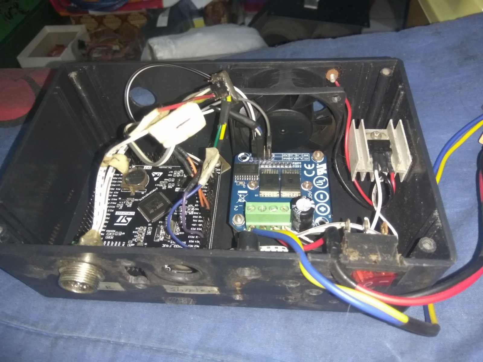

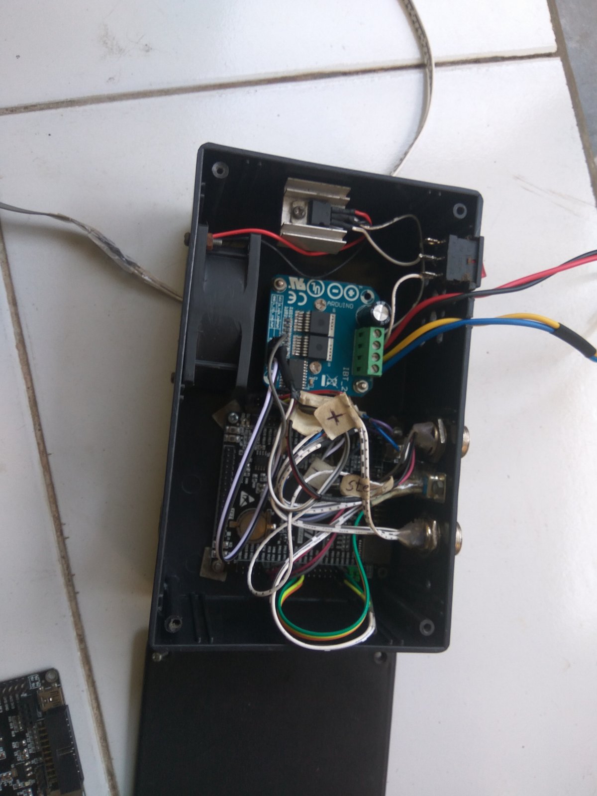

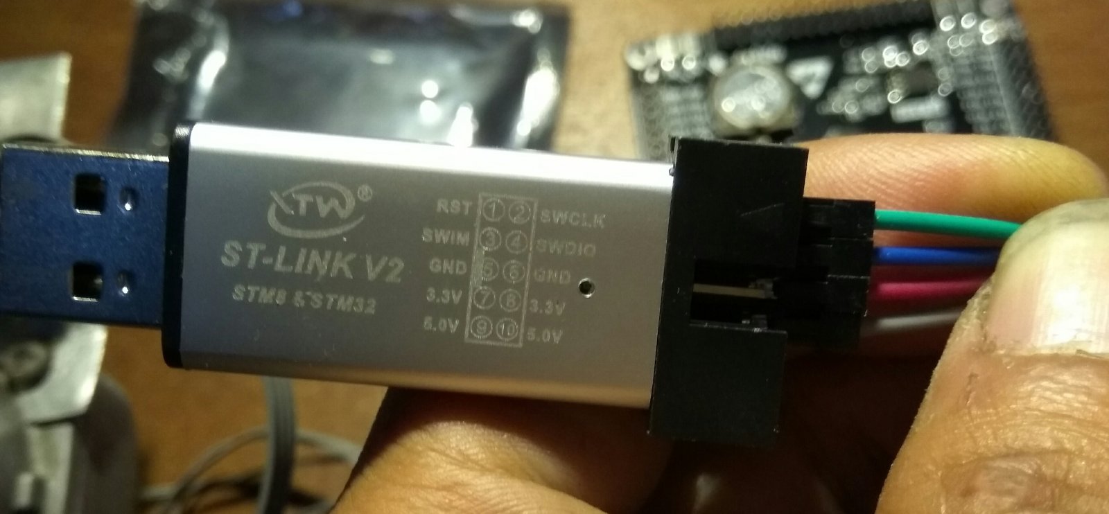

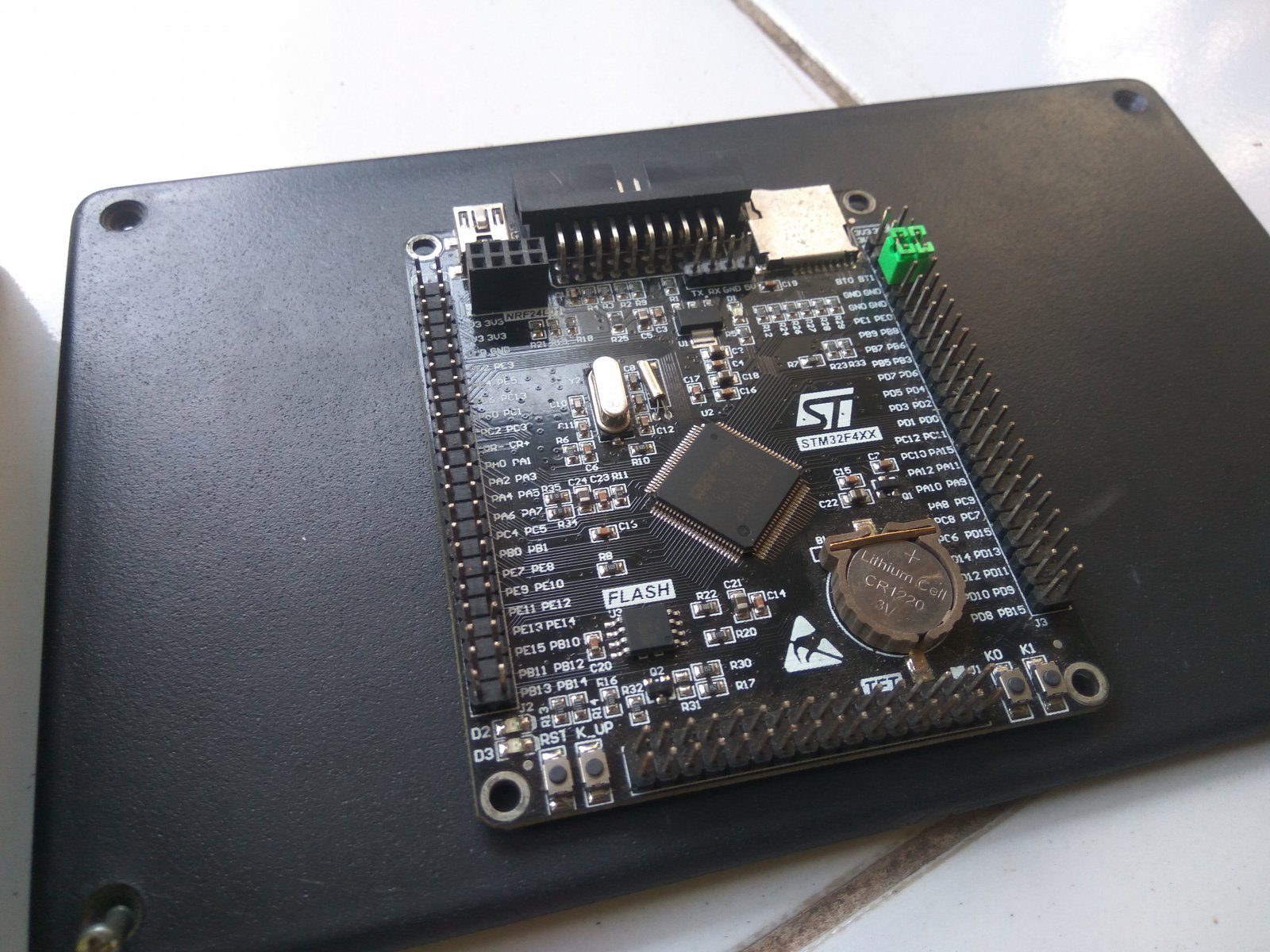

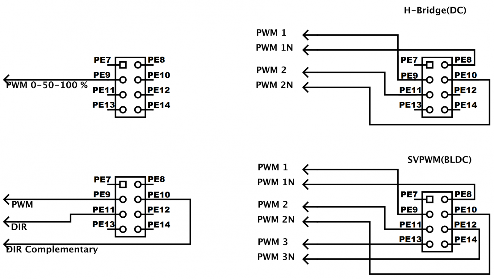

    for driver, i m using STM32F407VET6 and using st link v2 for flashing the MMOS firmware.
    to drive the motor, using BTS7960 and 24V 20A switching power suplly.
    IMG_20170719_235126.jpg IMG_20170719_235157.jpg IMG_20170811_000600.jpg IMG_20170811_000836.jpg IMG_20170719_222434.jpg IMG_20170719_224835.jpg

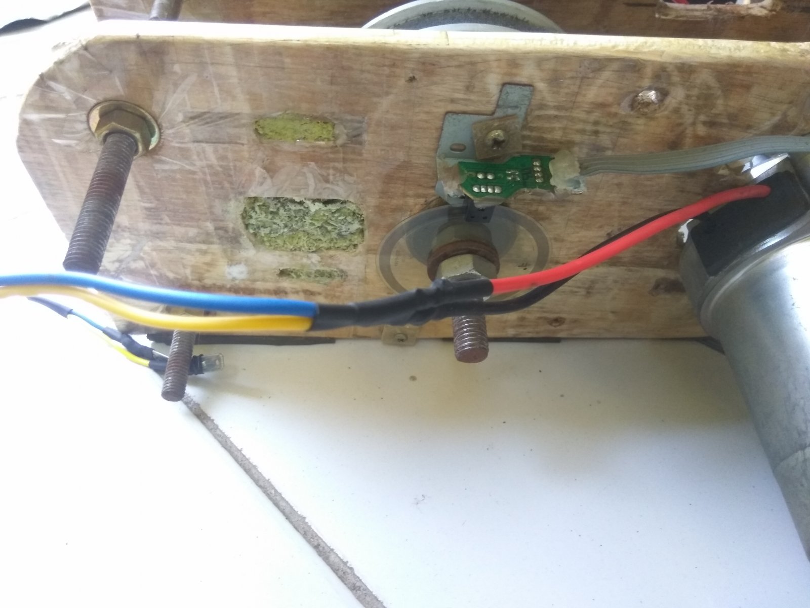

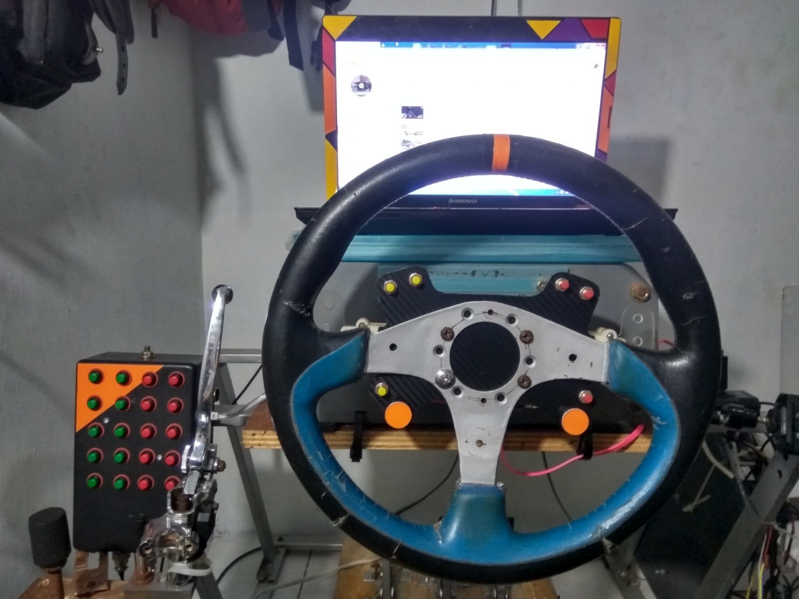

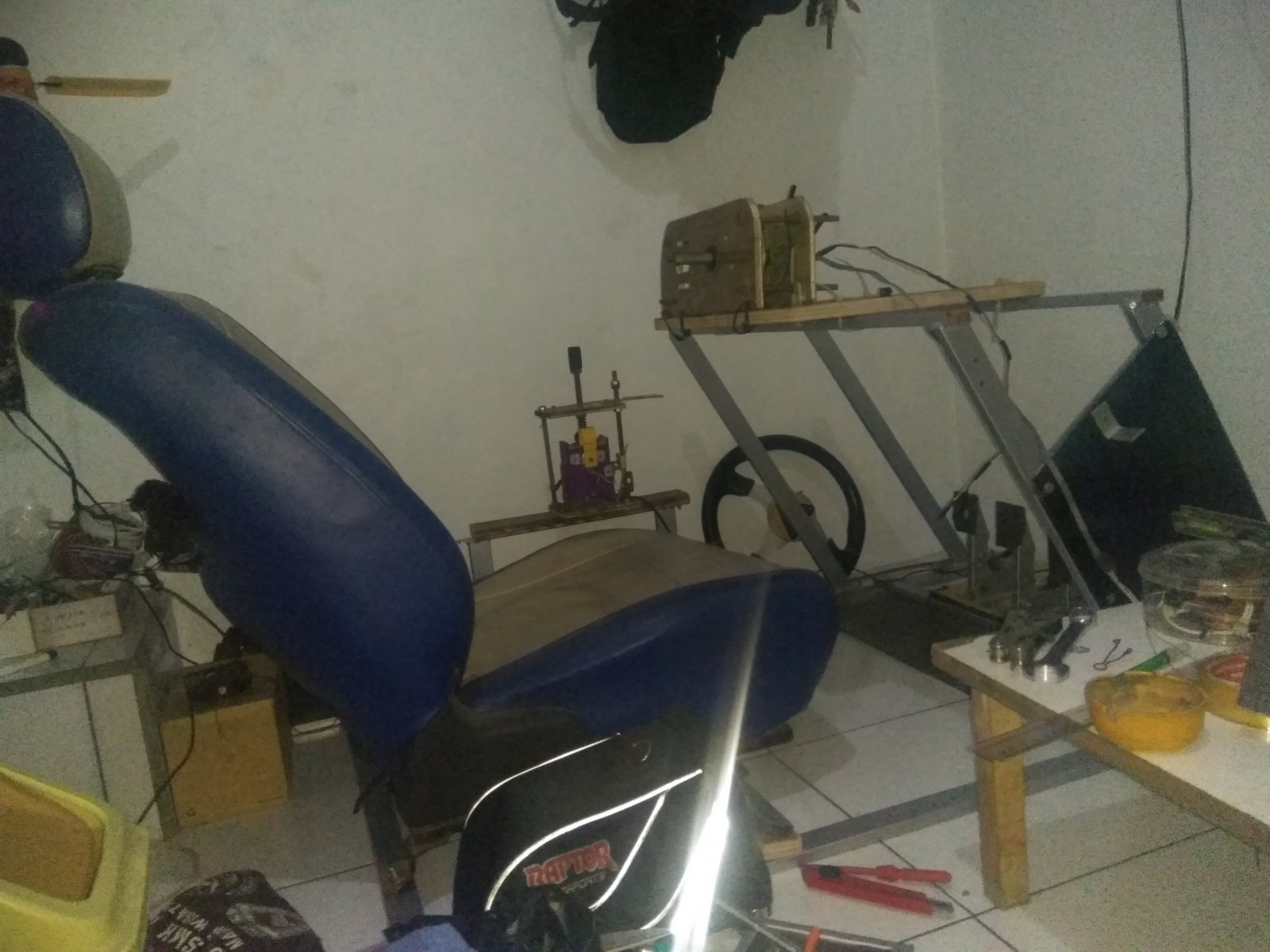

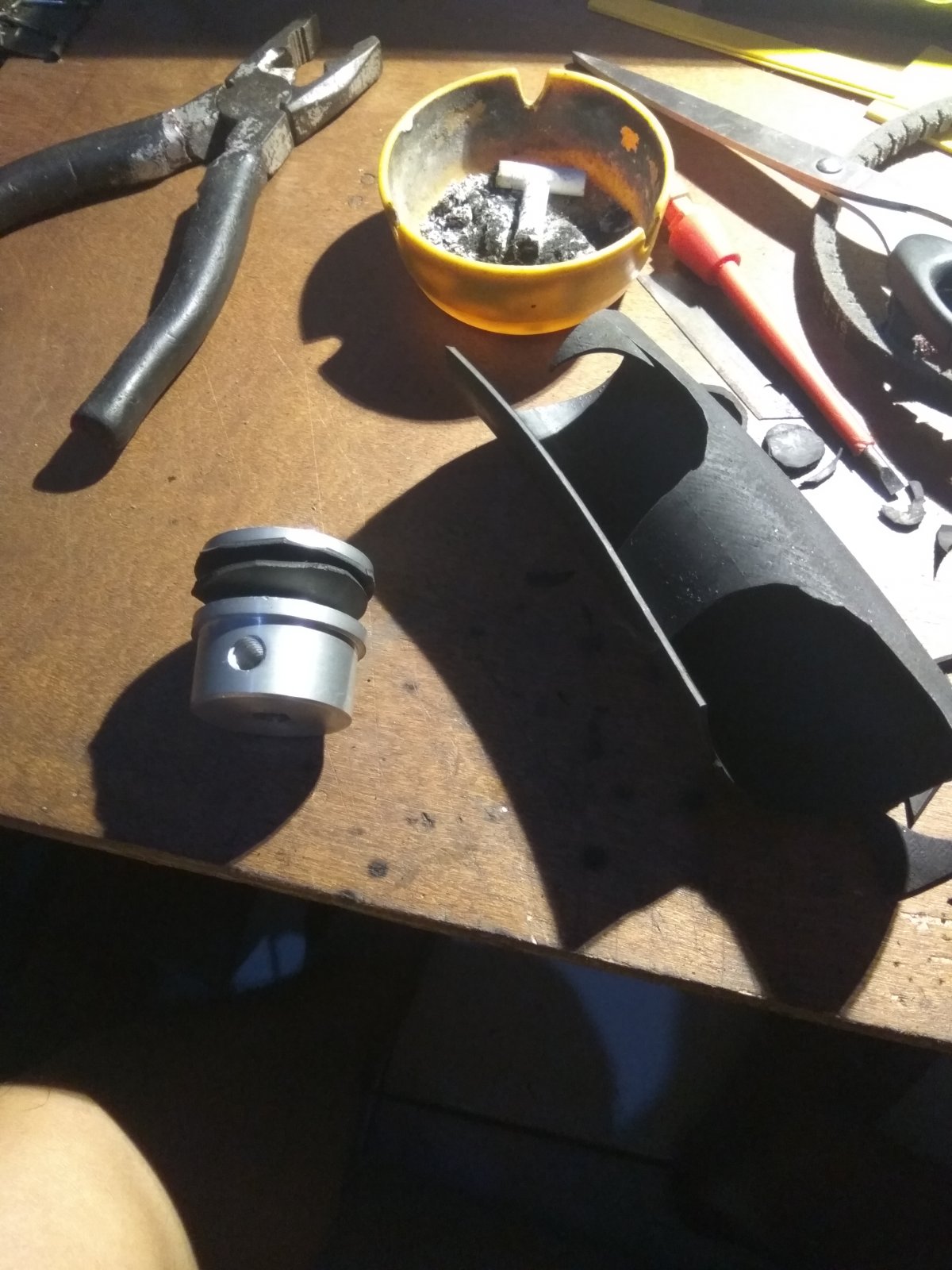

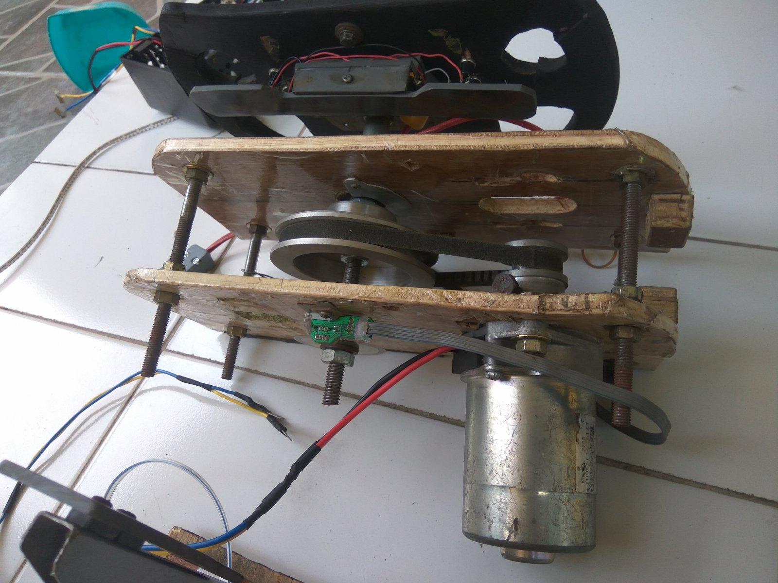

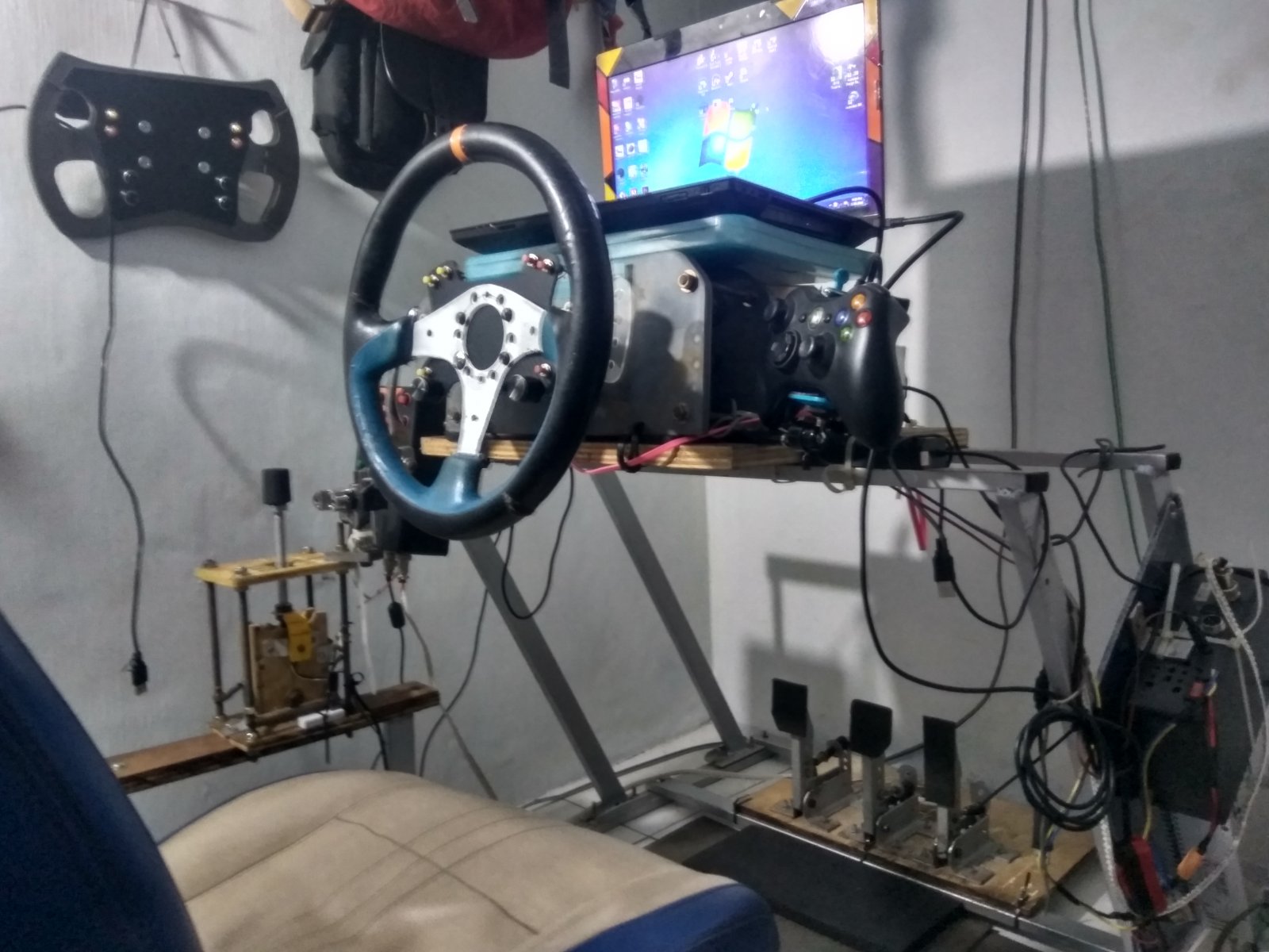

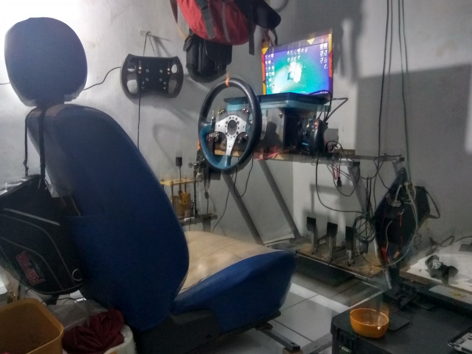

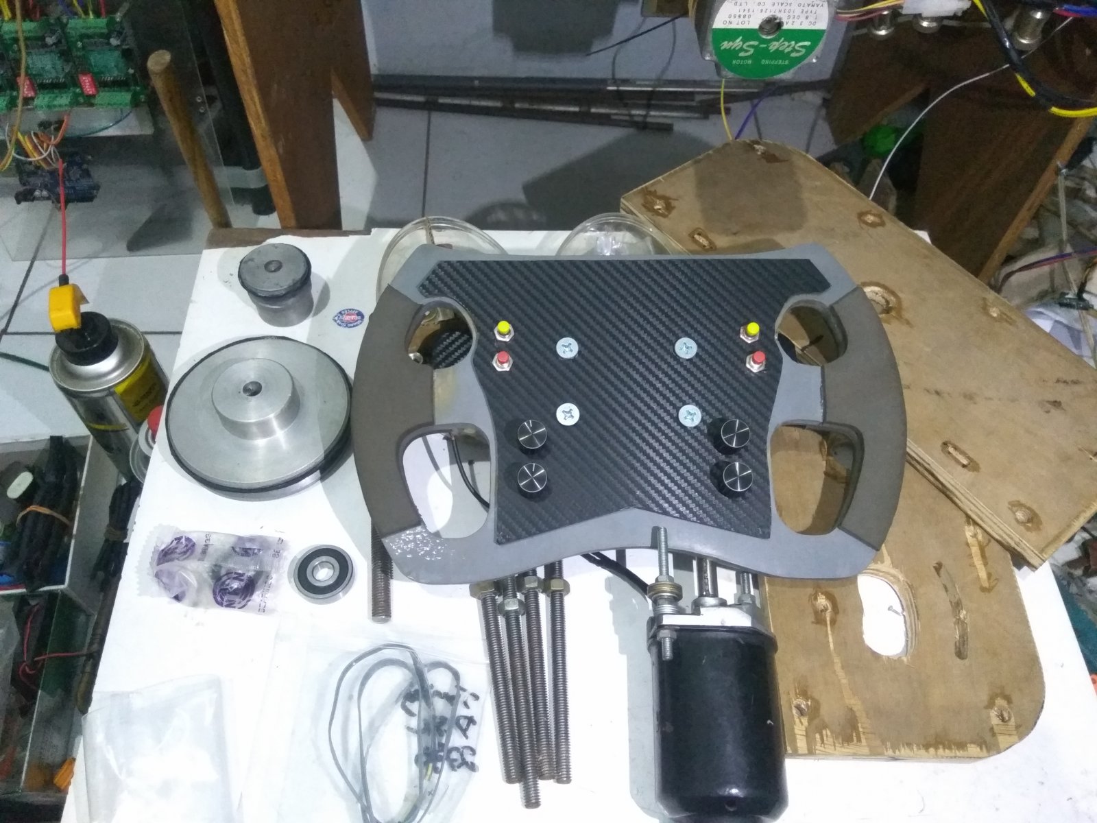

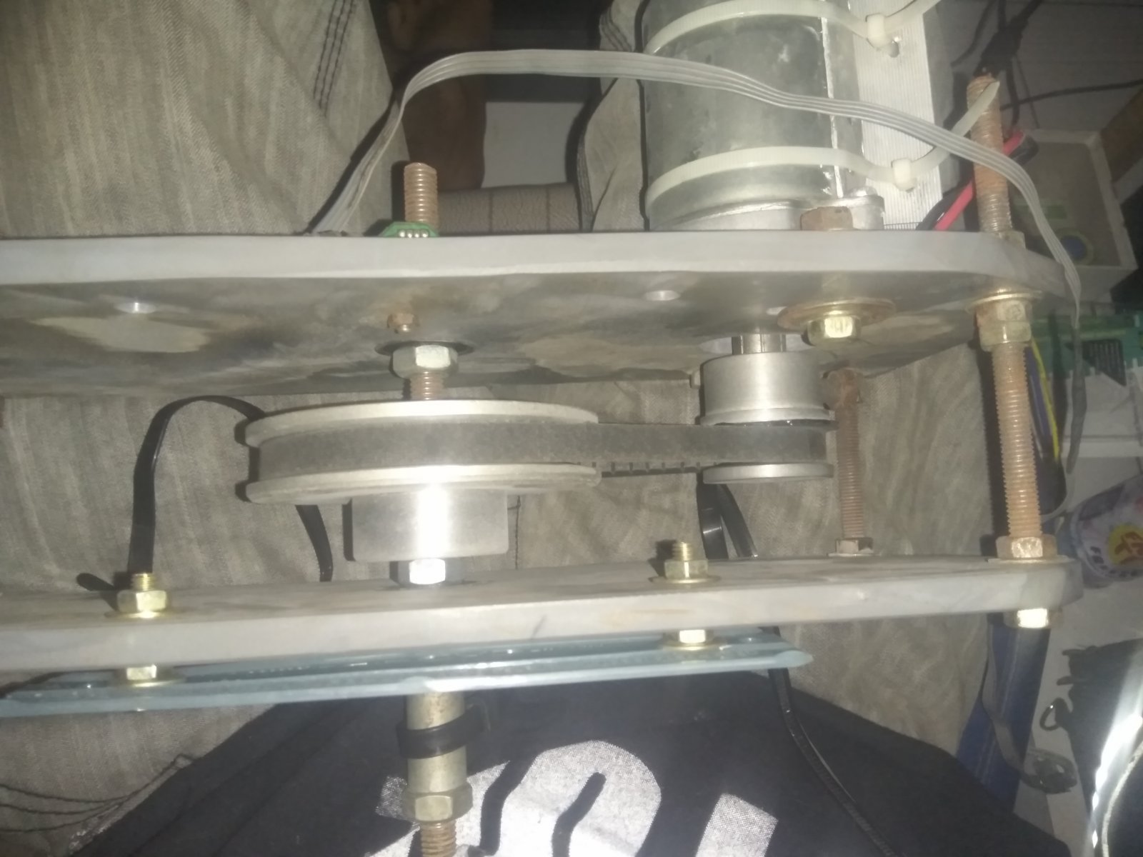

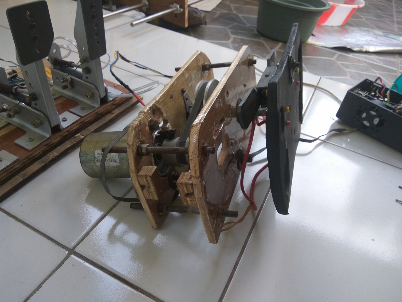

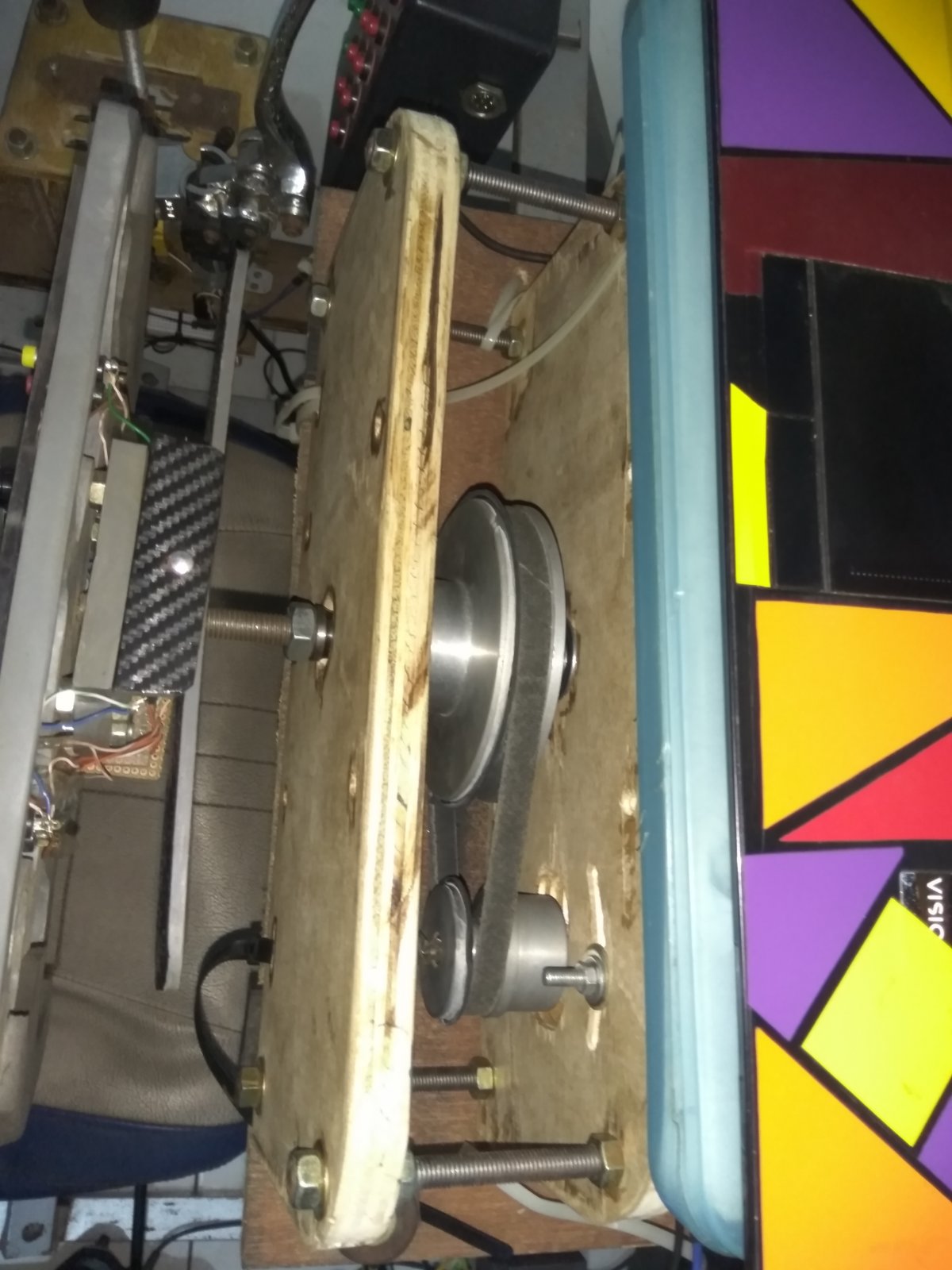

    for begining i m just using scrap wood to be a base for steering whell and motor mounting, and using 1.5" : 4" V type pulley for increasing the torque to steering wheel from motor.

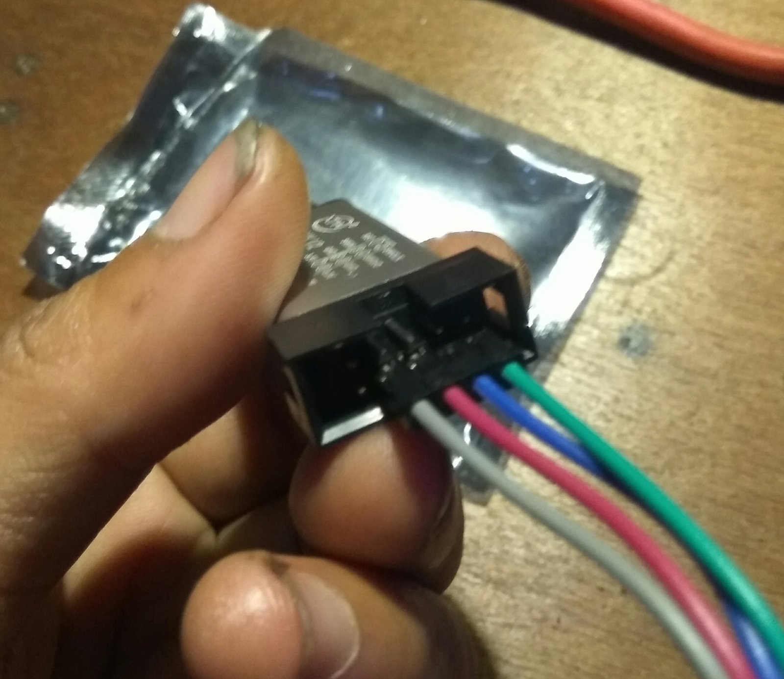

    for rotation sensor, i m using photoelectrick sensor from printer.

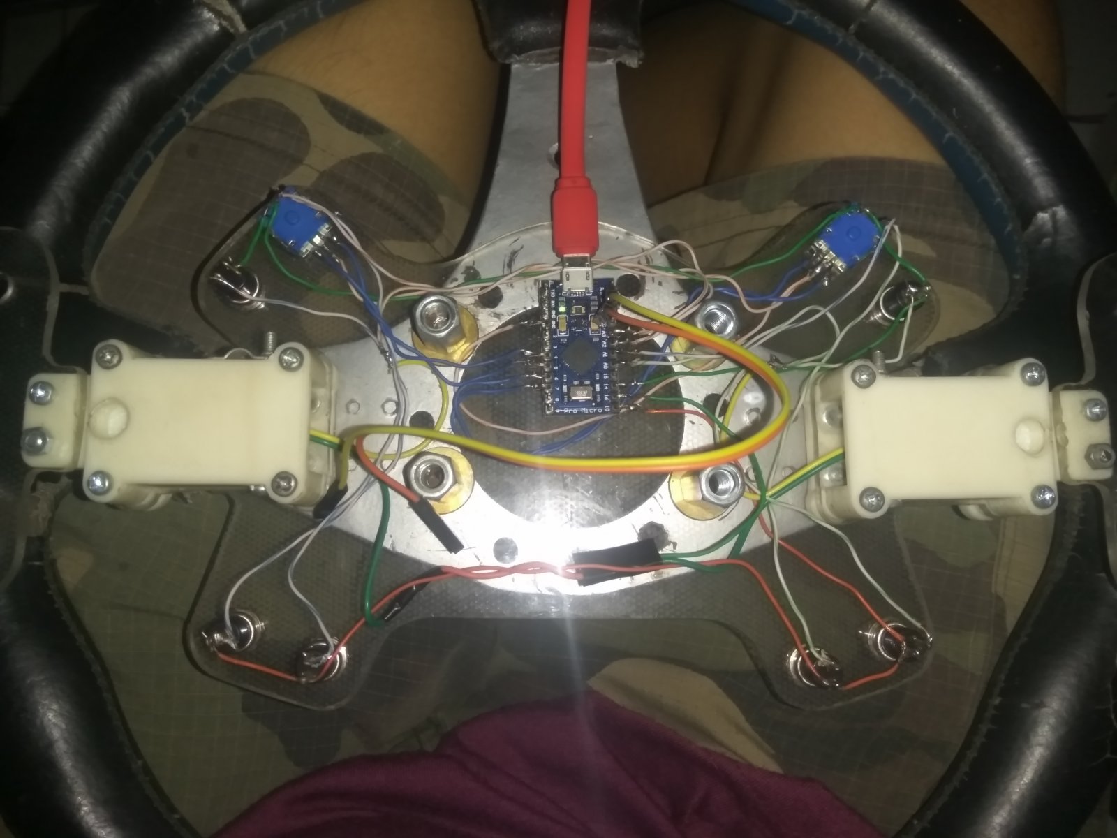

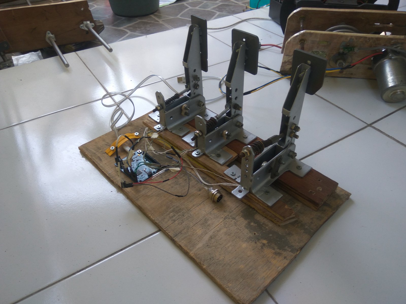

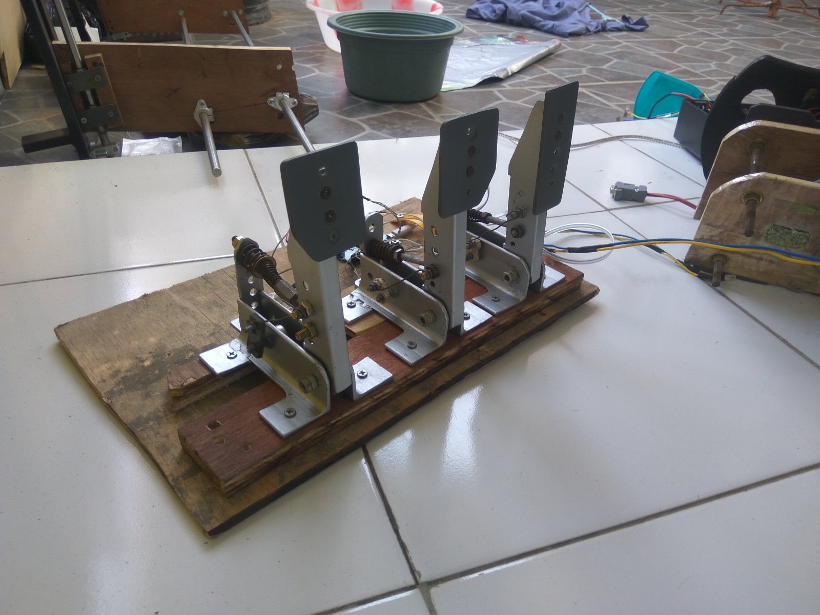

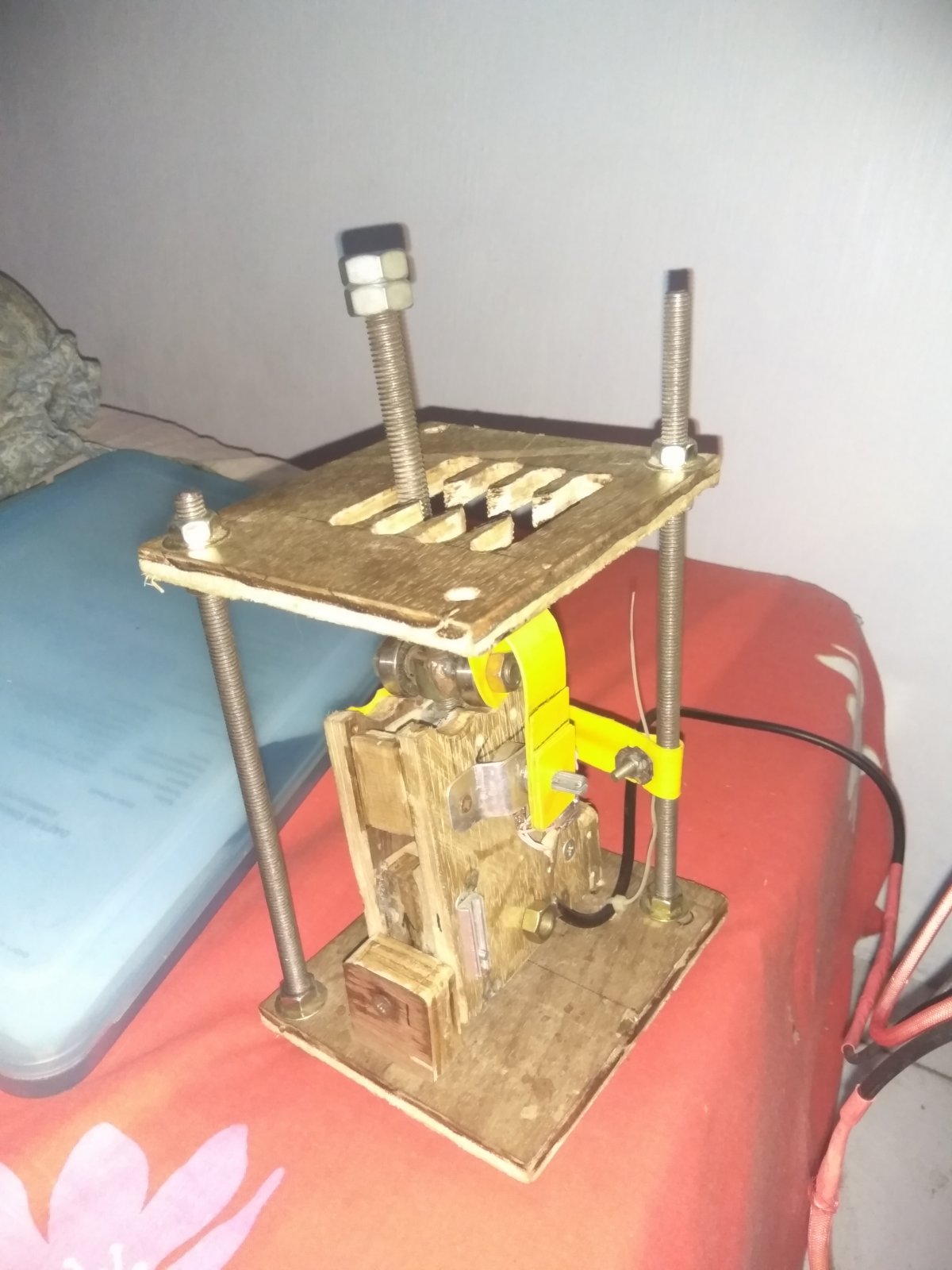

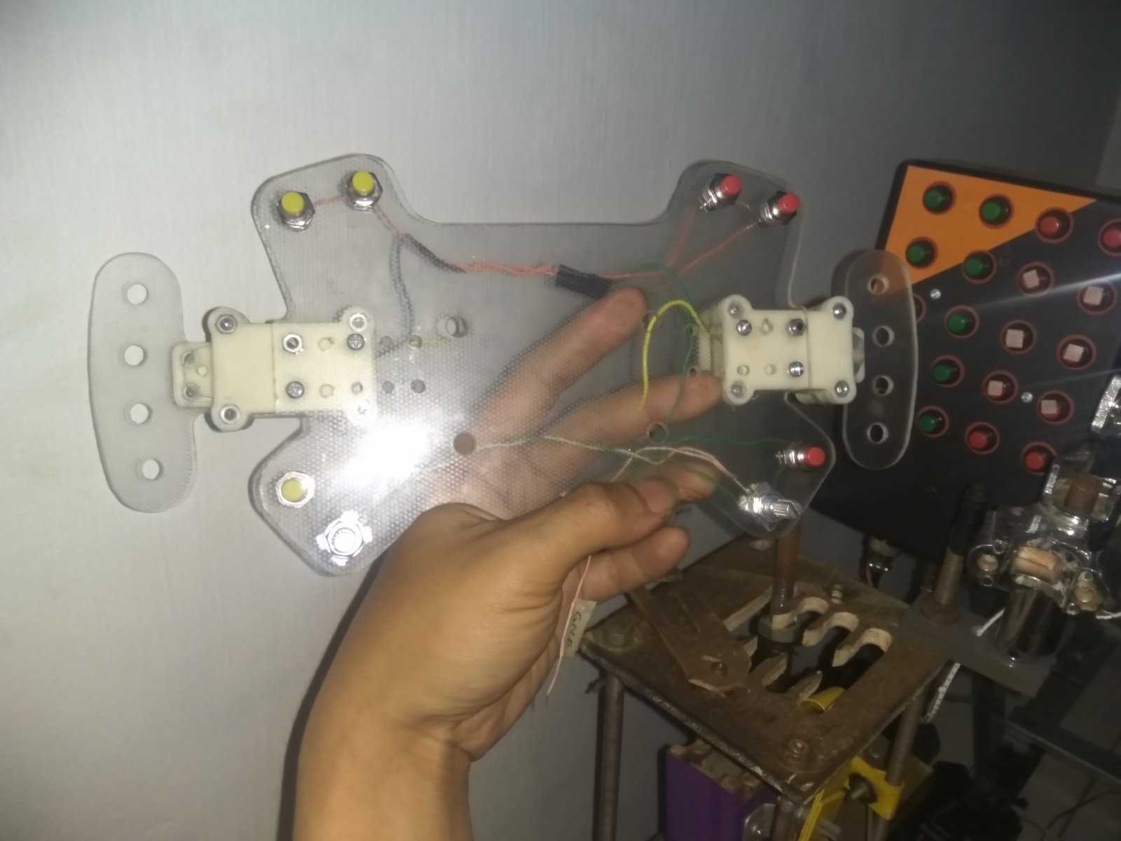

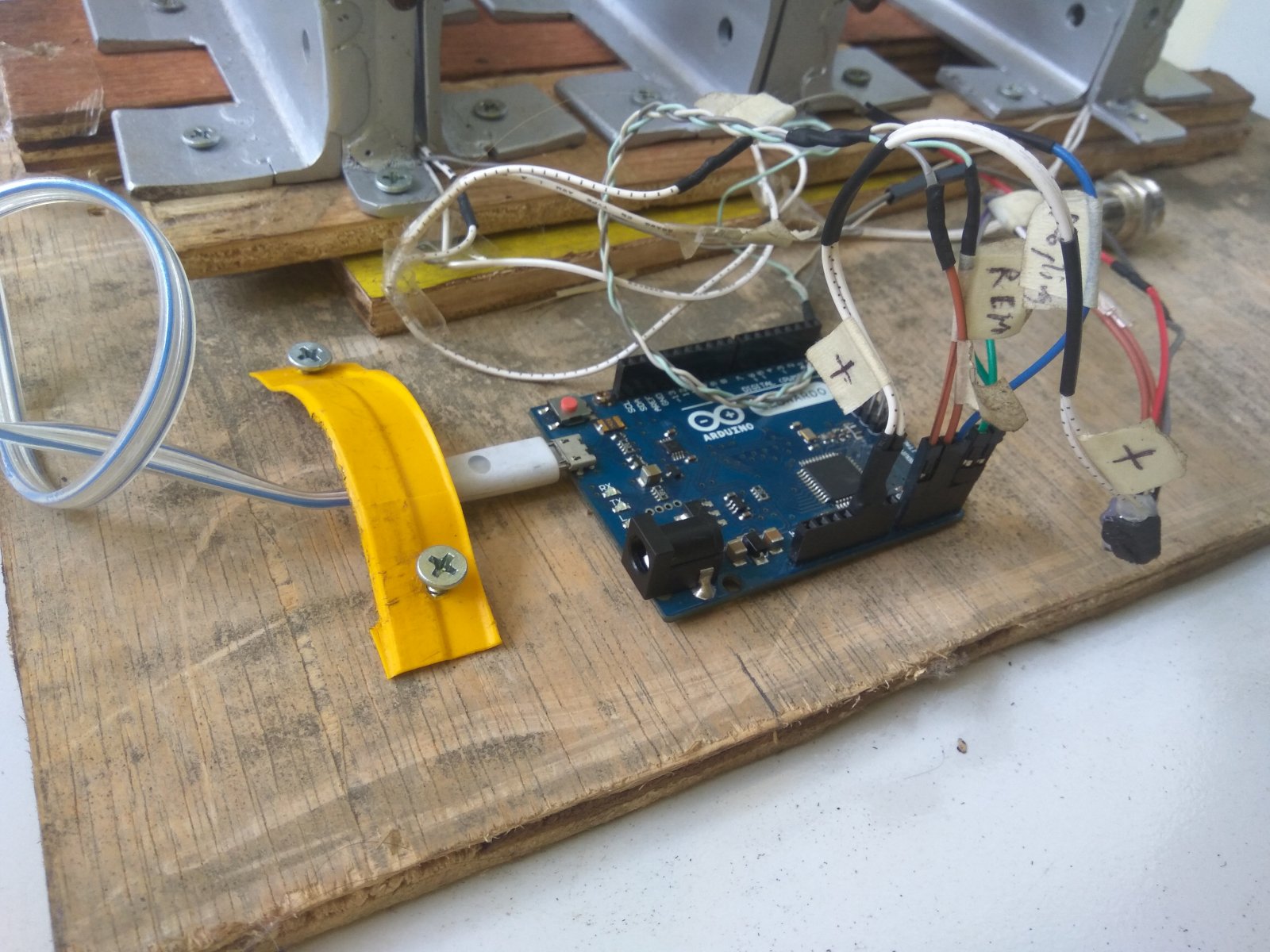

    for pedal i m using EMC V0.9 for arduino leonardo

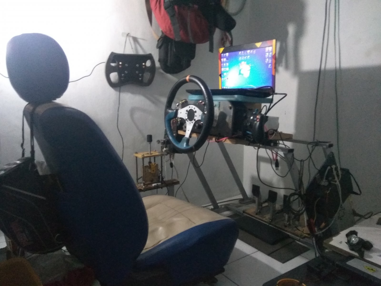

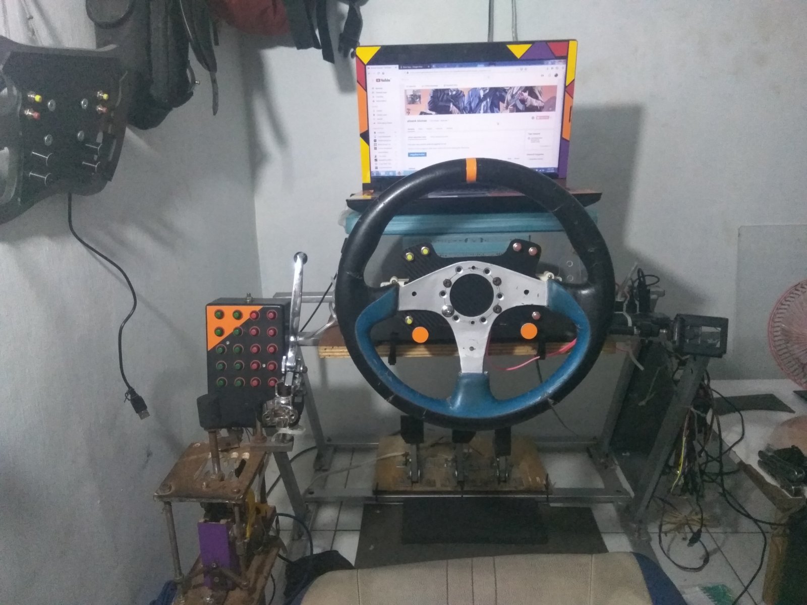

    it's little bit messy but it works well for me...
    and here is power consumsion test using AC power meter

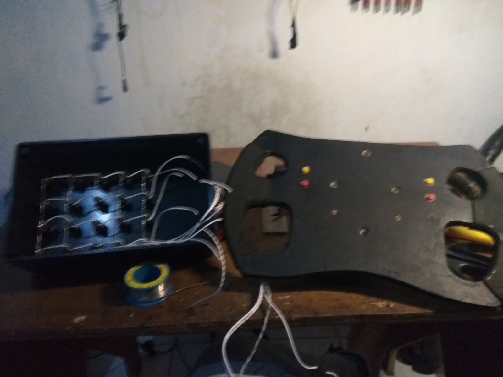

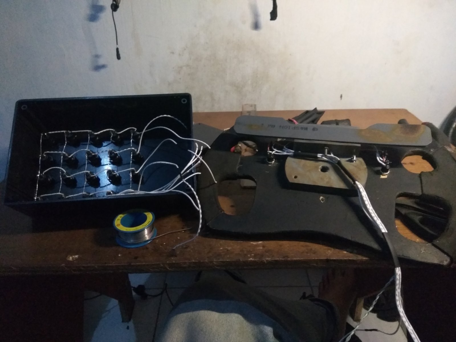

    and this is some more DIY part...
    IMG_20181101_223553.jpg IMG_20181116_234924.jpg IMG_20180829_183727.jpg IMG_20180829_160946.jpg

    Great project - clearly a lot of thought has gone into the design. May I ask what type of car the power steering motor is from?
  3. ahoenksiluman
    ahoenksiluman Member
    Nov 13, 2017
    91
    indonesia
    89Coins
    +47 / 0 / -0
    i dont know...i just straight buy it from local online shop...i think they all almost the same, the different only from shaft lengh, diameter, and inner spline...
    the speed and torque almost the same...but if you wanna more torque, you can make bigger ratio...

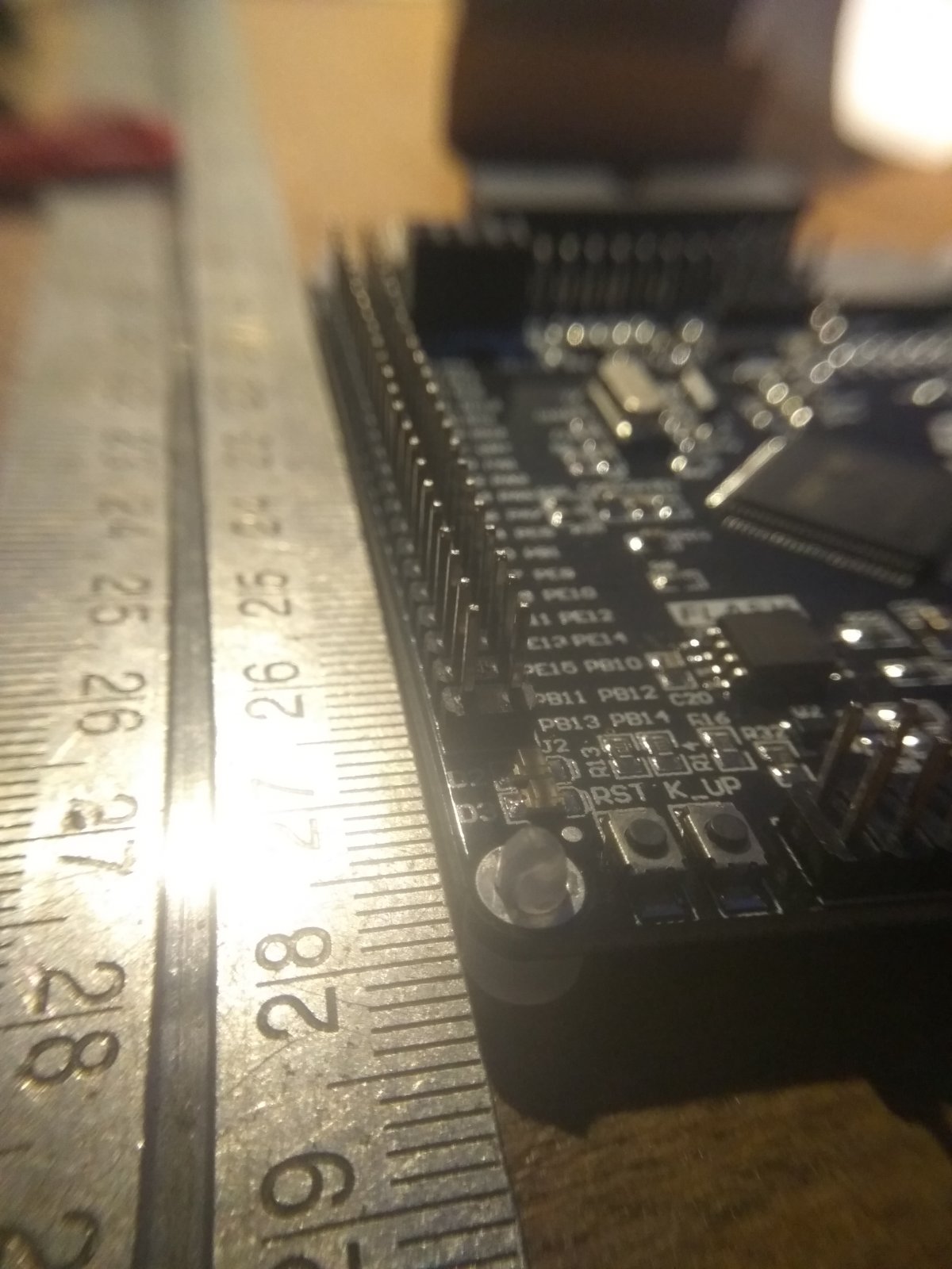

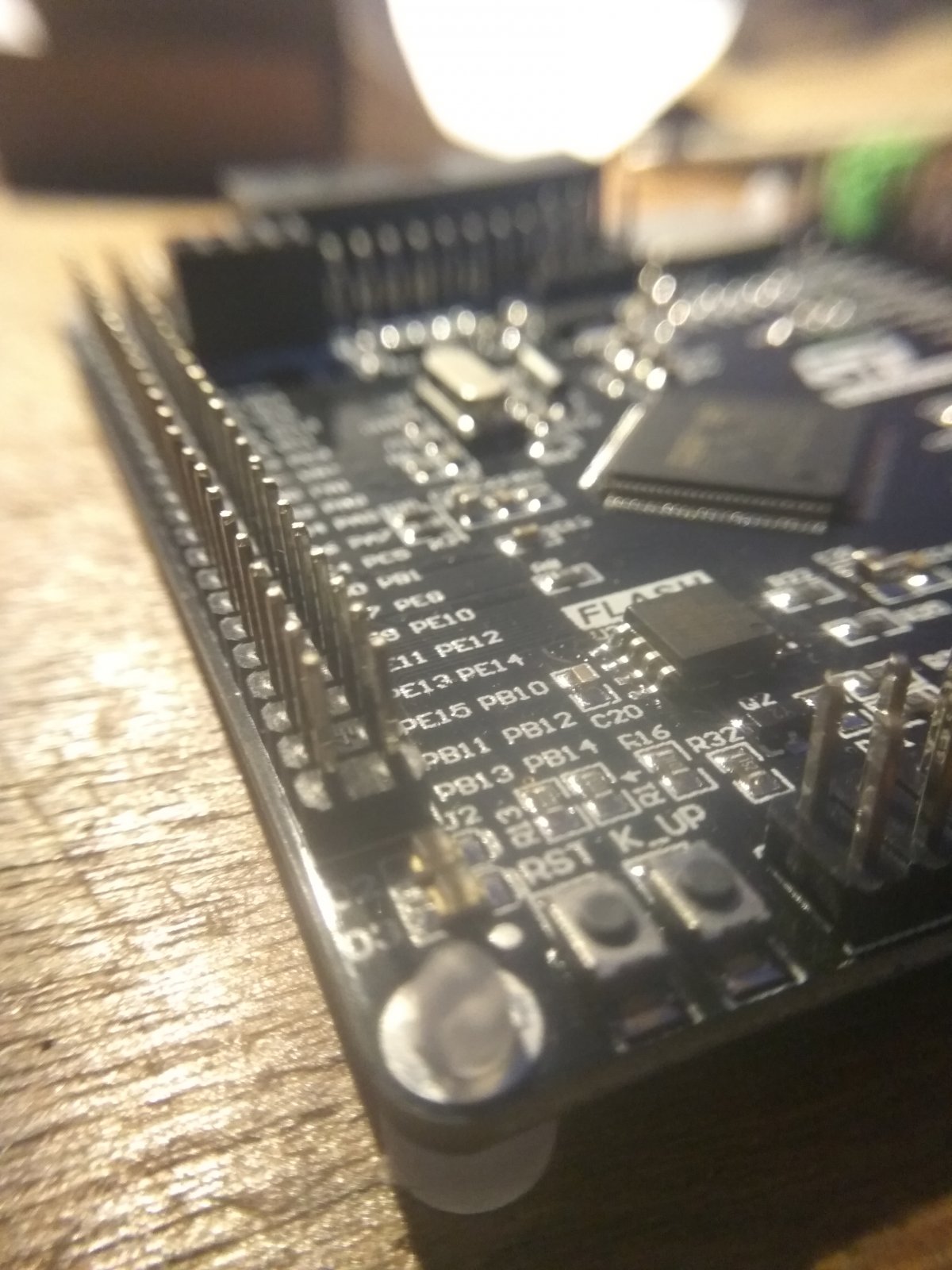

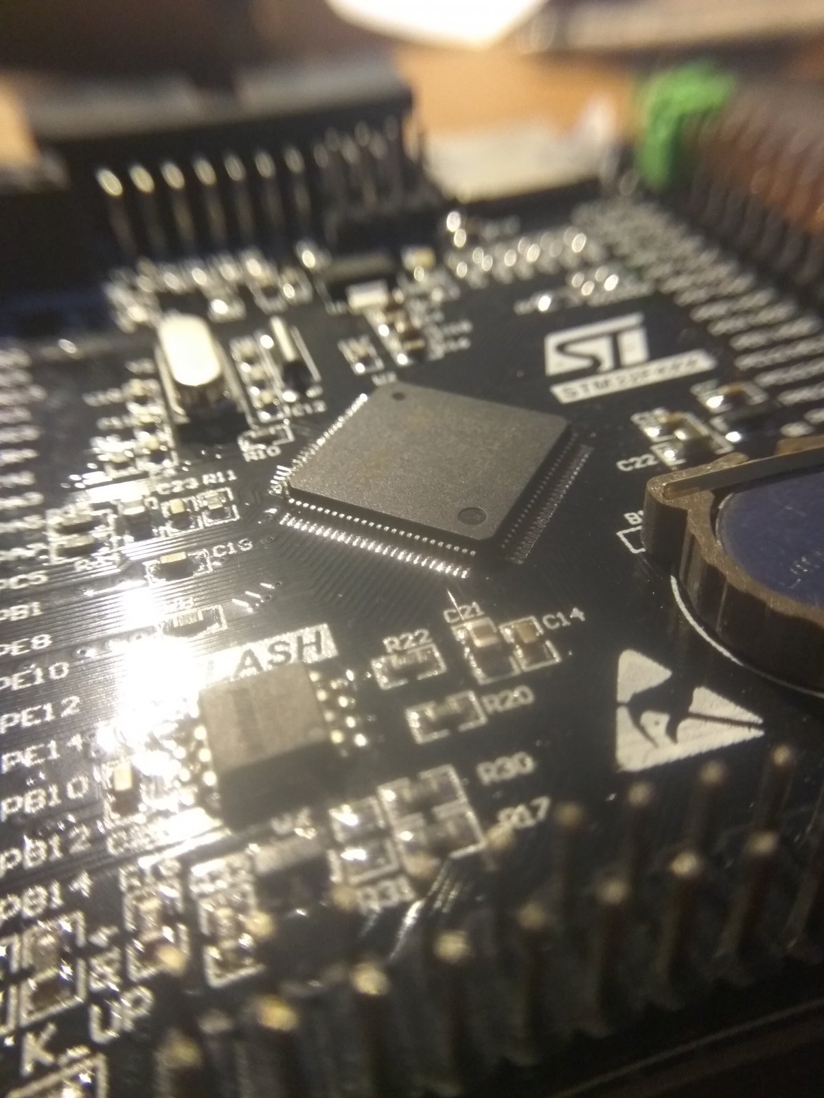

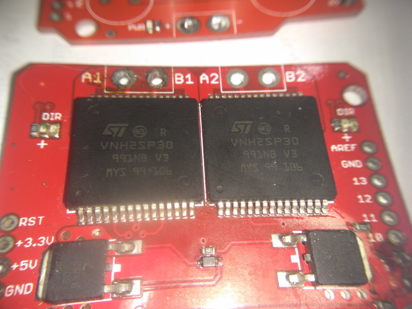

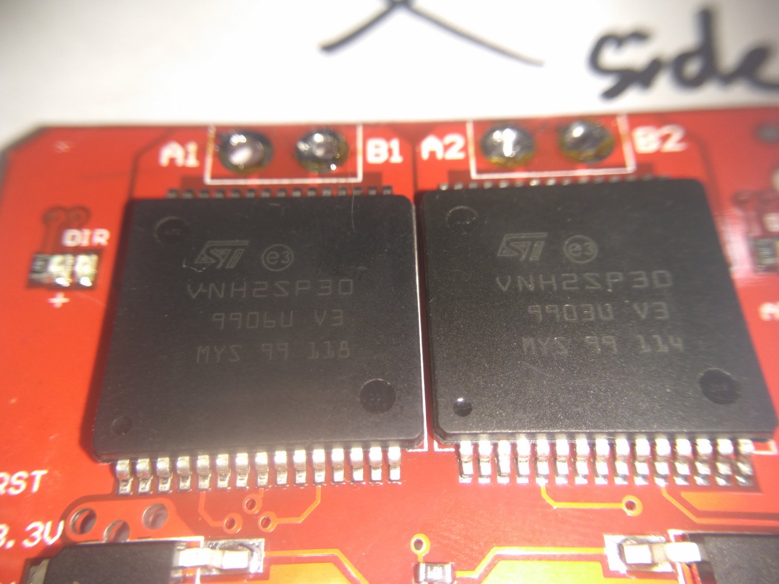

    more update:
    more photo:

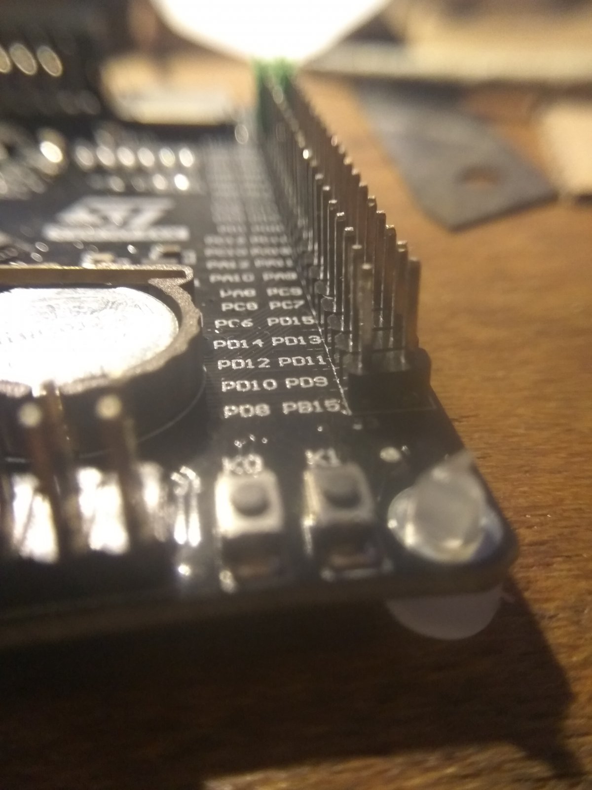

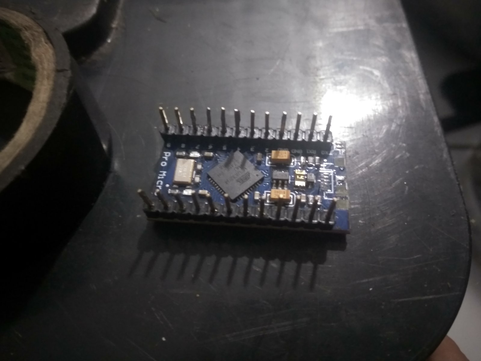

    avoid this type of board with this chip code if u buy very cheap clone board...its useless for me
    this one work fine for me till now, and it run over 500 watt with no problem
    heat is big enemy for electronic stuff, cheap thermal paste will help (dont use liquid metal)
    and small cooling fan will be great

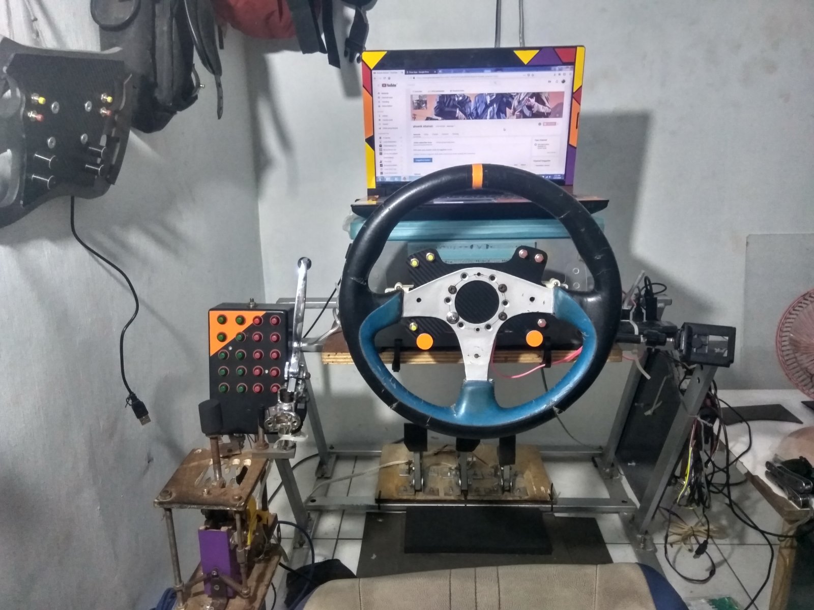

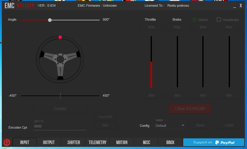

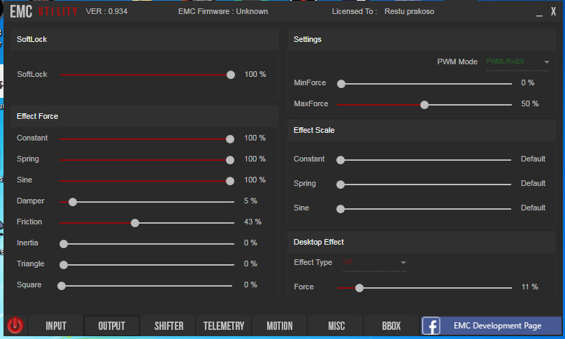

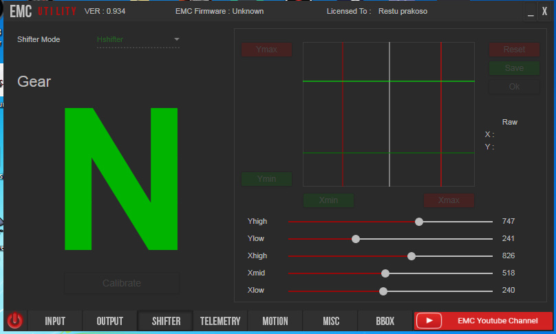

    another DIY force feedback steering wheel software and firmware alternative for arduino leonardo.
    the software called EMC utility created by EBOLZMAGY. if you interested go straight check em out in ebolzmagy youtube channel https://www.youtube.com/user/ebolzzable
    last time i tested it and it works great, very suitable for small torque DC motor, it will give you small detail from the game.
    bandicam 2019-03-22 00-50-33-287.jpg bandicam 2019-03-22 00-50-33-287.jpg bandicam 2019-03-24 21-08-32-733.jpg
    when i first time look at the UI setting, it looks complicated if compared with MMOS, but actually thats the pros. you can set the detail of FFB you want depend on your hardware and your comfort, gain setting based on type of signal wave/signal type. if you want detailed on damper rather than wheel binding, you can set the damper up and constant down, or whatever you want.
    and it's when i tested it

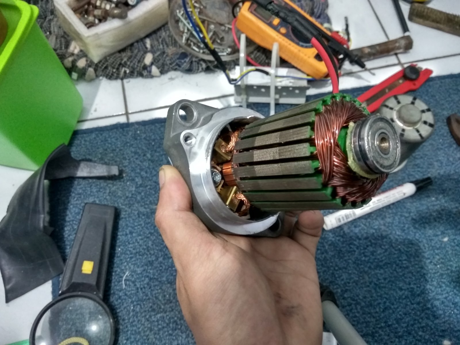

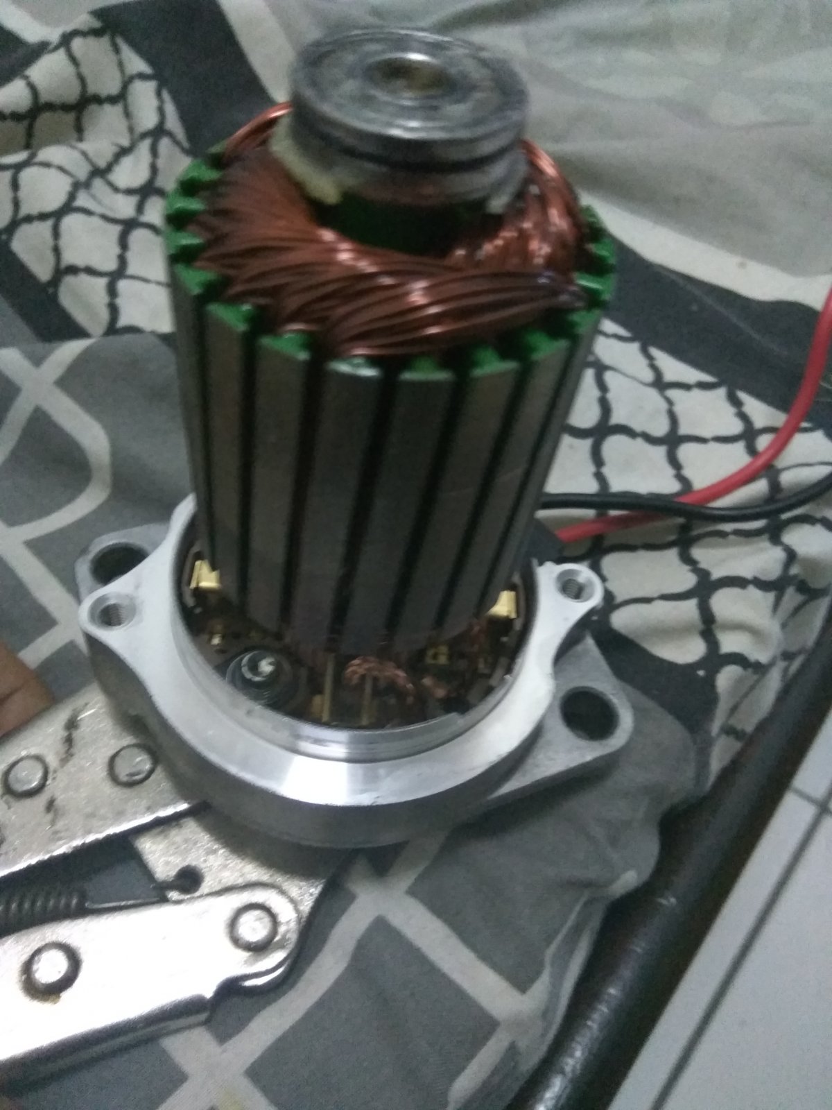

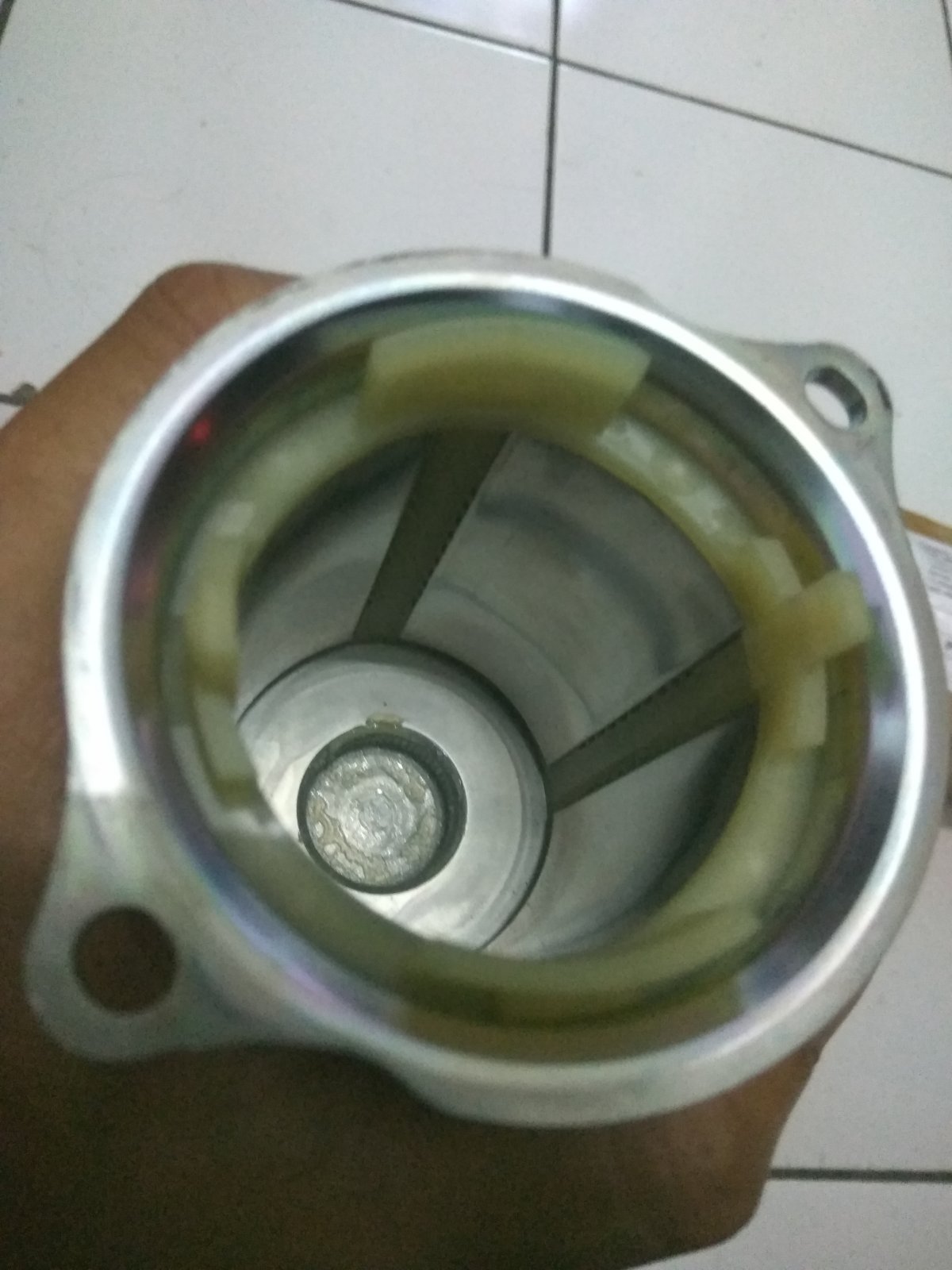

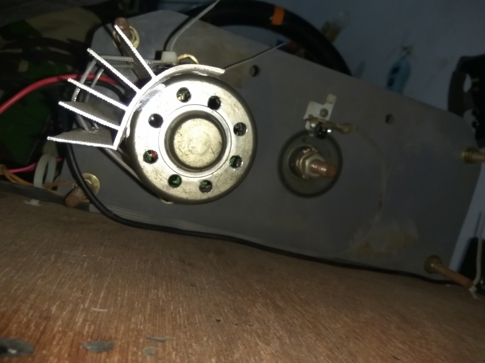

    maintenance time...and some mods....
    take the motor appart and drill the housing for better cooling...
    housing after drilled...

    @ahoenksiluman Nice work and testing. Did you switch to arduino/EMC? Or are you still using stm32/MMOS? I do like the look of those options in EMC.
  9. ahoenksiluman
    Nov 13, 2017
    91
    indonesia
    89Coins
    +47 / 0 / -0

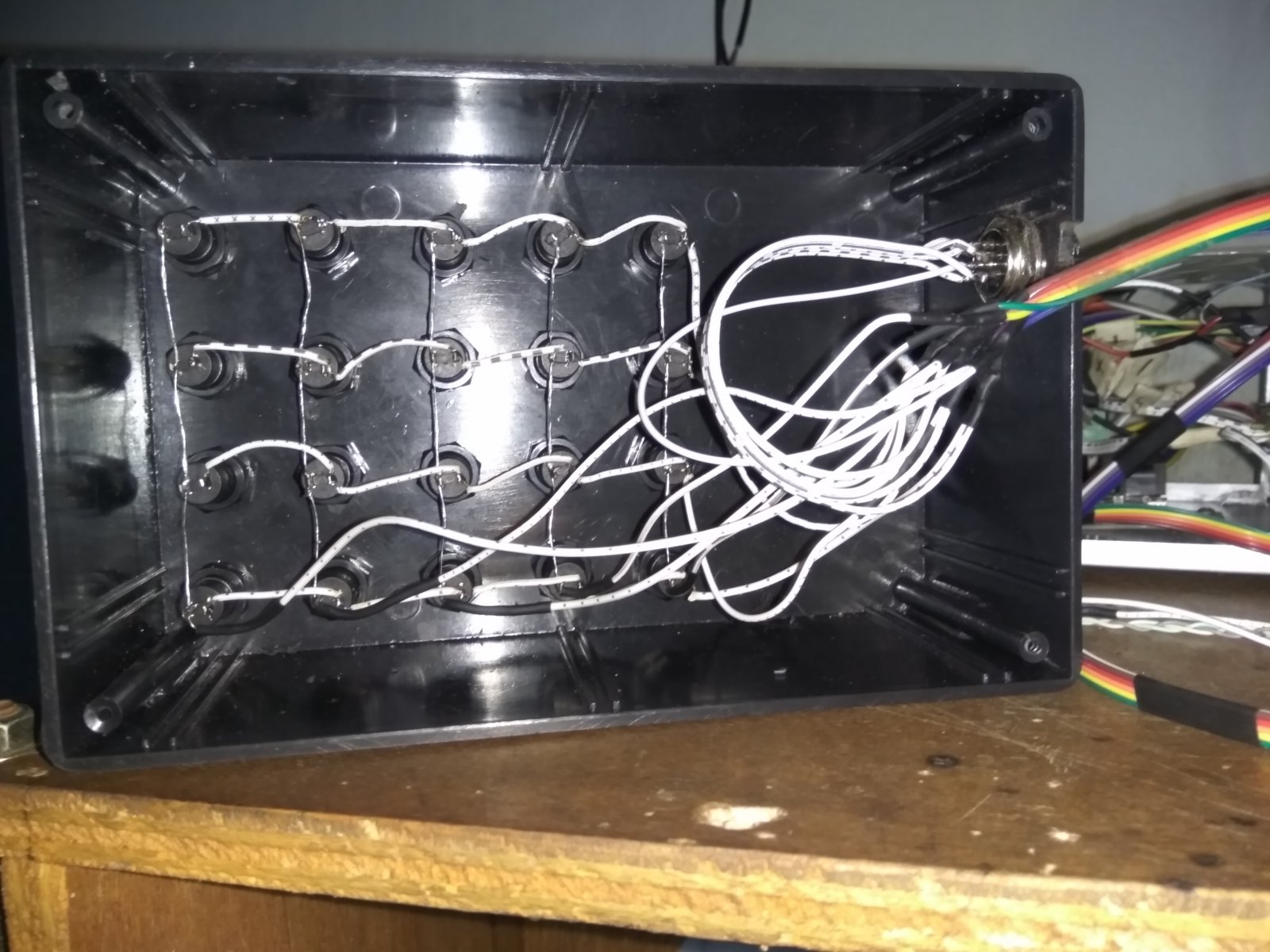

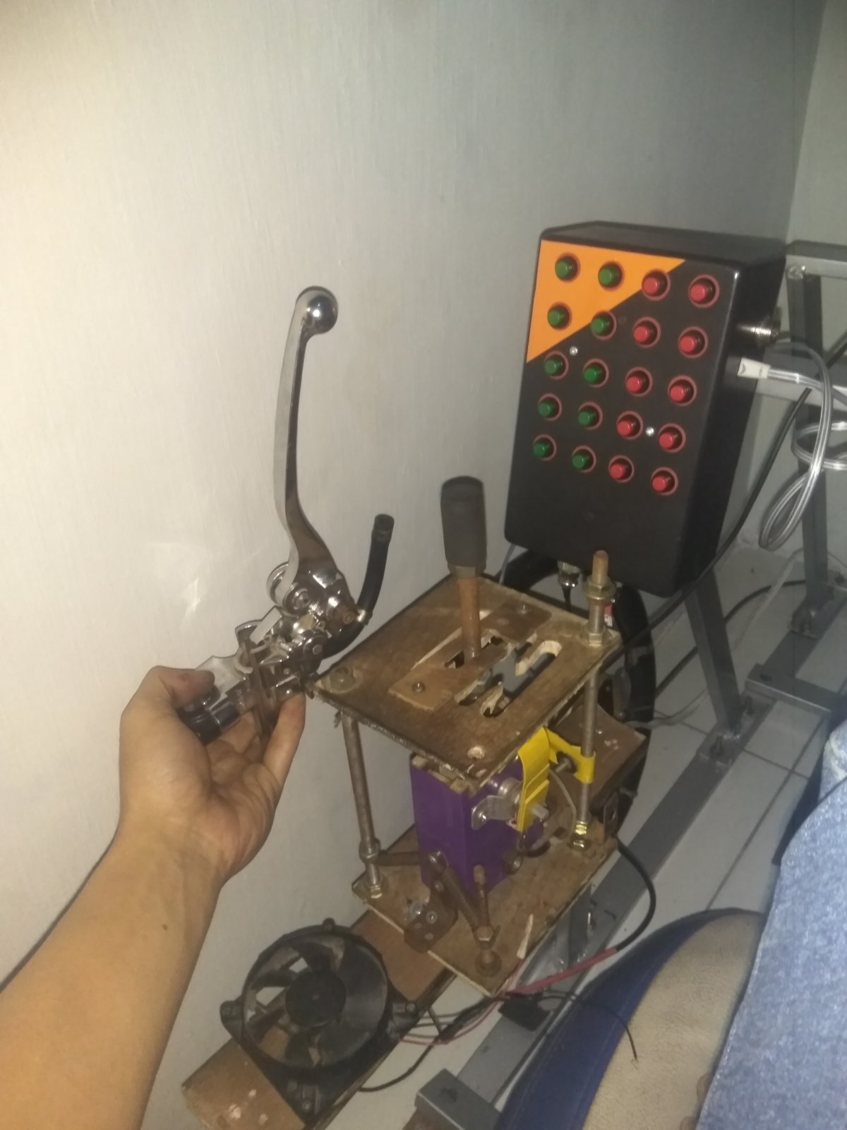

    for now i'm still using MMOS for wheel and FFB, and EMC for pedal, shifter and button...
  10. ahoenksiluman
    Nov 13, 2017
    91
    indonesia
    89Coins
    +47 / 0 / -0
    some update and improvement...
    make better cooling for DC motor...
    small hole does't hurt for motor, and it will make better cooling for rotor in the inside...

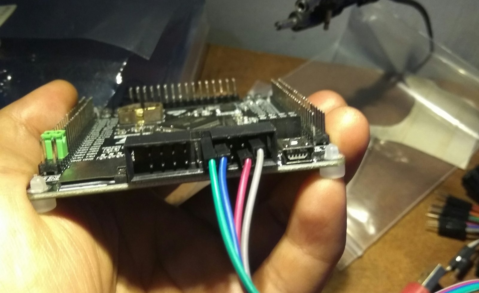

    just build another driver controller box with different microcontroller board, i'm using STM32F407VGT6 and its work perfectly just like STM32F407VET6 or discovery board...
    and this is how i build that...

  16. wannabeaflyer2
    Jun 12, 2015
    724
    london uk
    8,299Coins
    +953 / 7 / -0
    Hi @Sieben just wondered if you knew why toothed belts are not used in stead of vee Pulley 's am sourcing the last bits for Both DD projects This type and Hoverboard Brushless motor options . so wondered about belt / Pulley choice Cheers is it Noise , Vibration , Cost etc Thanks
  17. Sieben
    Sieben Active Member
    Nov 6, 2018
    395
    2,241Coins
    +115 / 2 / -0
    wannabeaflyer2, Belts must be not a noizy thingies. They are used, guess depends on the type of the belts/manufacture, don't know. Although for someone there were some "steps" reports on operation. V's as I get it, can do some slipps, and safe a motor, for someone. Don't know. I recon both of'em are used with great success. )
    And chains also :D
  18. wannabeaflyer2
    Jun 12, 2015
    724
    london uk
    8,299Coins
    +953 / 7 / -0
    Hi @Sieben really appreciate the response , im ok with mechanical stuff but electronics take a while LOL always learning there always shifting the goal posts LOL :) i'll chance the toothed belt option on my FFB hybrid and let you guys know how it goes , Not started a post yet as im still taking photos of the Both builds but once I get to Electronic assembly then i'll start putting the post together ..

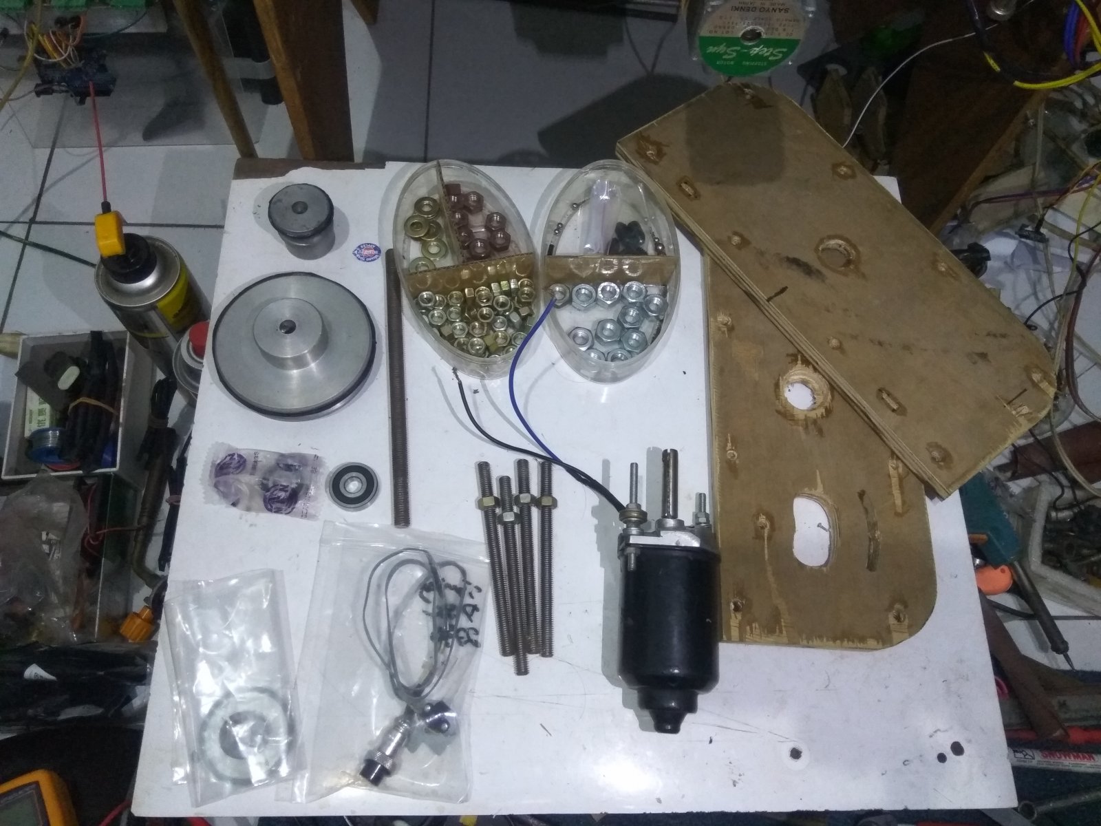

    another day another build...
    try to making steering wheel base using small motor from scrap car wiper motor, works great but need more ratio to increase torque...

    Hello ahoenksiluman.
    Is the SVPWM(BLDC) option actually working in MMOS?
    I read in another thread it is indeed unimplemented
