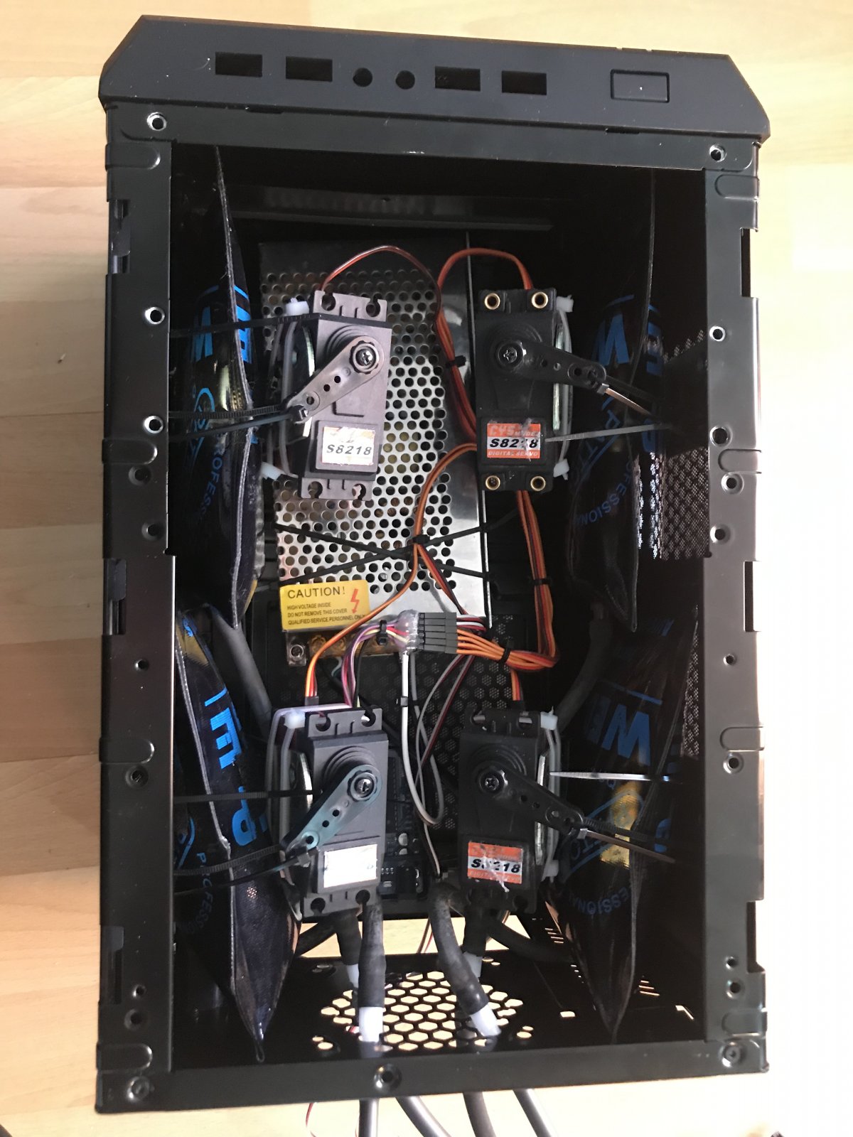

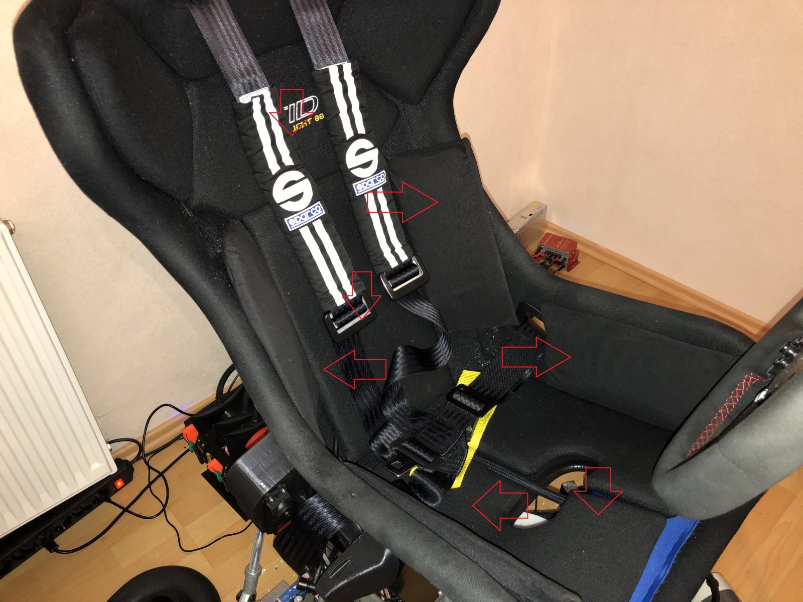

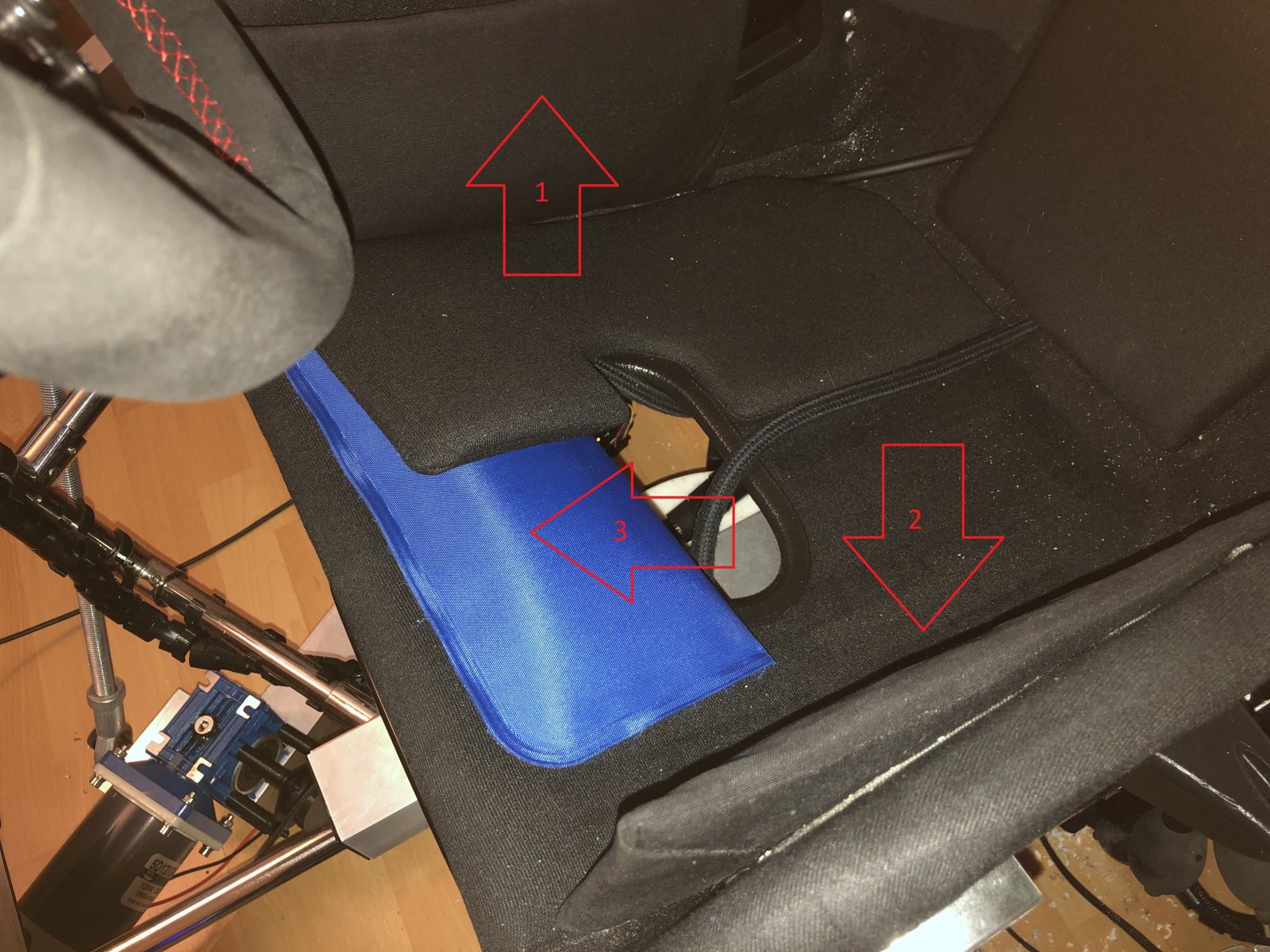

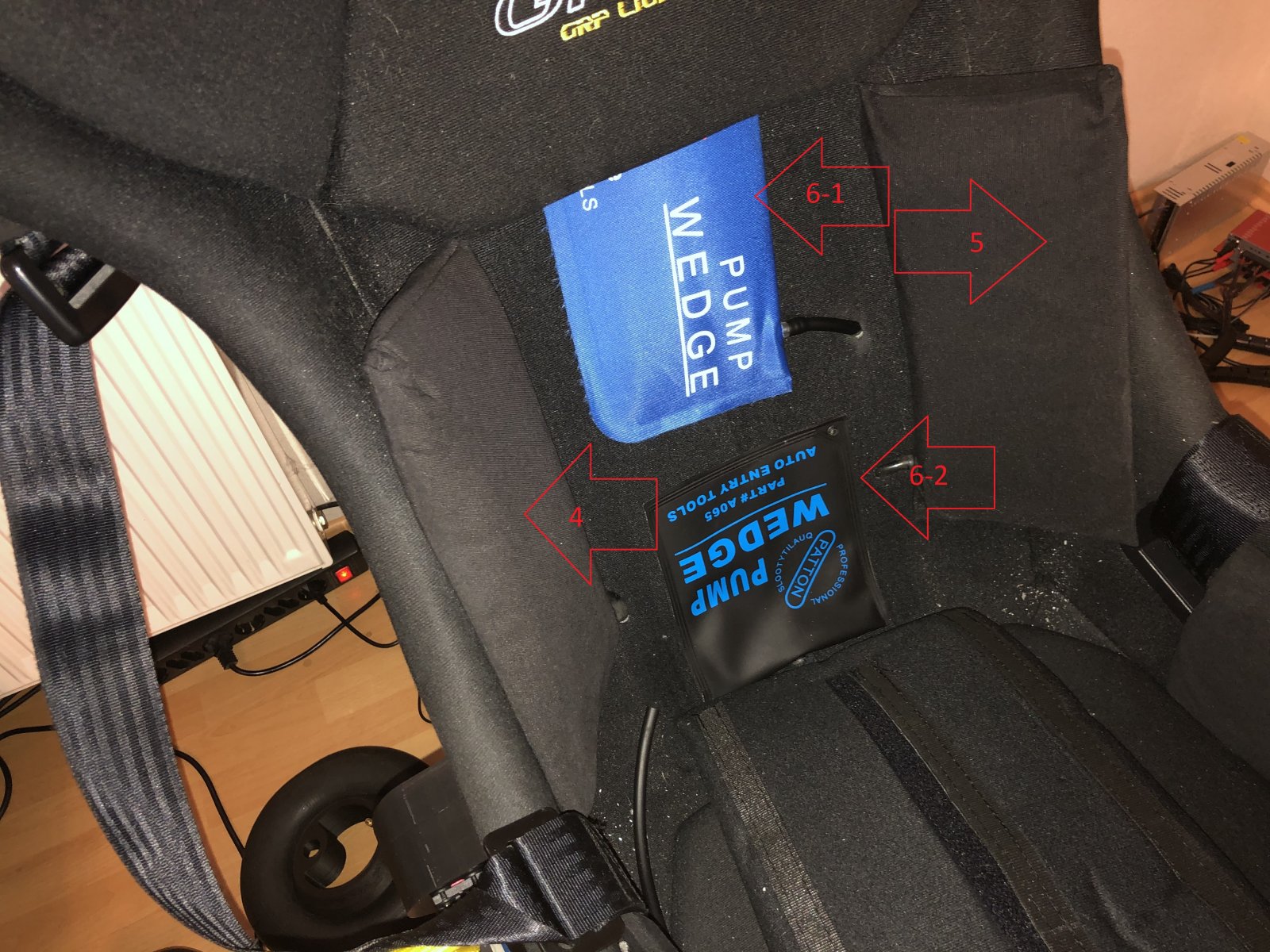

  9. Banfy
    Banfy FR/AU
    Jun 11, 2020
    131
    Australia
    299Coins
    +55 / 1 / -0
    DC motor, Arduino
    Hi @volker metzger
    I am planning to upgrade my racing Gseat to Flight sim G-Seat, already...
    Unless I missed it, i haven't seen how you positioned the air wedges on the seat in your videos.
    I currently have 4:
    -2 at the back right and left,
    -2 for the legs.
    I guess you have at least 2 more positioned in your seat
    Can you share more details about this please?
    thank you

  11. xxpelle
    xxpelle Discord "TPMax#9574" Gold Contributor
    Dec 24, 2017
    120
    614Coins
    +150 / 0 / -0
    Sway = 1 - 2 - 4 - 5
    Surge = 3 - 4 - 5 - 6.1 - 6.2
    Heave = 3 - 6.1 - 6.2

  13. xxpelle
    Dec 24, 2017
    120
    614Coins
    +150 / 0 / -0

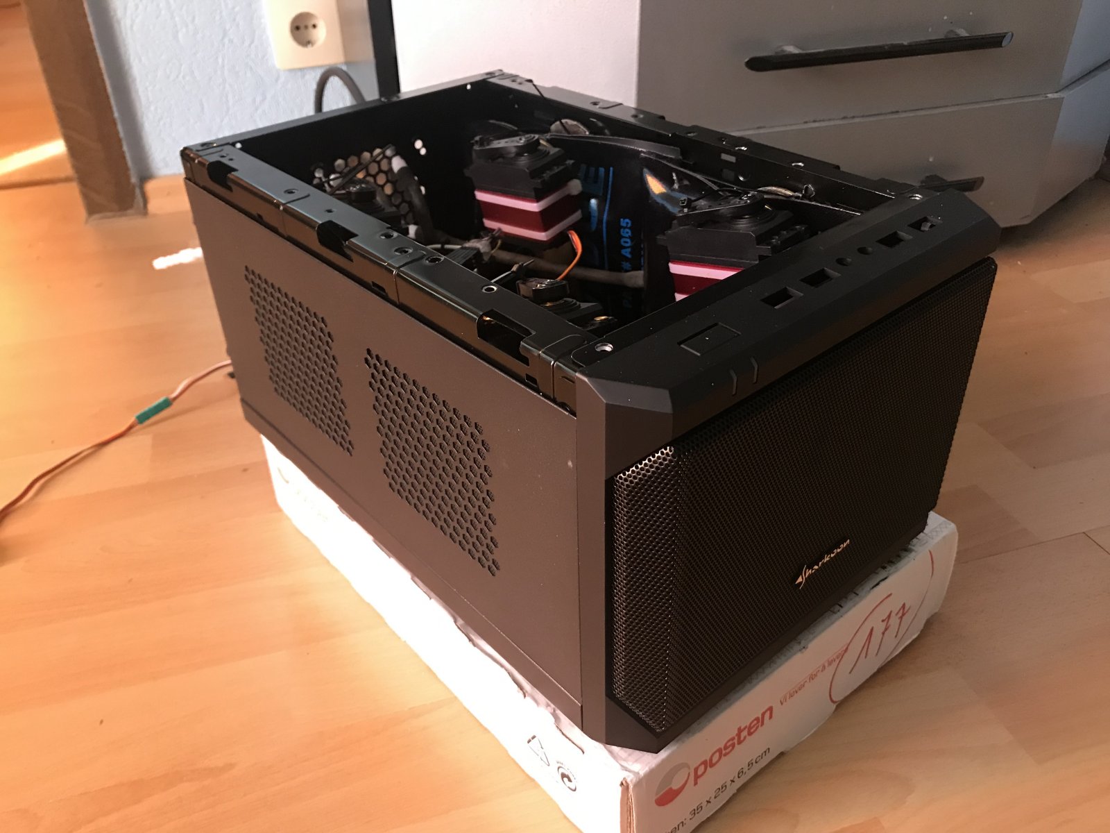

    They kind of fit to the body properly

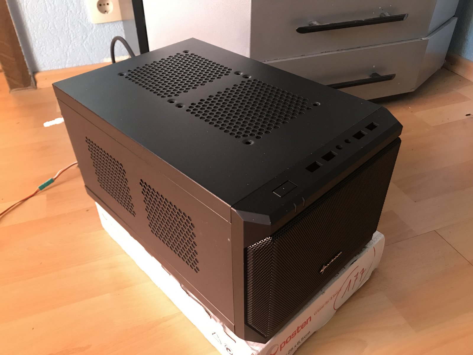

  15. noorbeast
    21,155
    148,616Coins
    +10,909 / 54 / -2
    Nice job, very compact and efficient :thumbs
    Do you have some build details for the servo/pneumatic bag assembly?

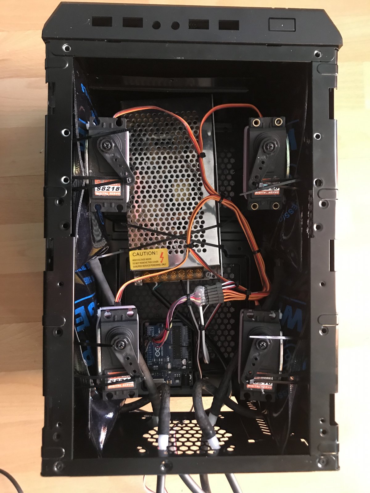

  16. Banfy
    Banfy FR/AU
    Jun 11, 2020
    131
    Australia
    299Coins
    +55 / 1 / -0
    DC motor, Arduino
    Thanks Torsten
    This is very helpful.

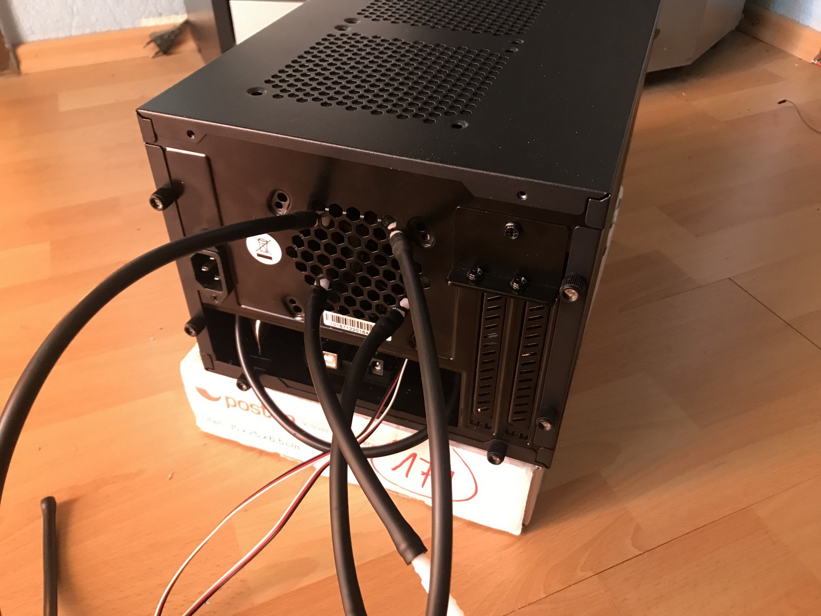

    A bucket seat is obviously best for the sway than my deck seat. Should be the same for Volker's playseat.
    Your 3D printed case can accomodate 4 servos as I can see, do you really only use 4 servos to drive all this?
    Or maybe you have 2 cases?
    cheers

  18. xxpelle
    Dec 24, 2017
    120
    614Coins
    +150 / 0 / -0
    I have 2 copressor units with 4 pressure pads and 2 extra servo connections for the seat belts per unit
  19. xxpelle
    Dec 24, 2017
    120
    614Coins
    +150 / 0 / -0
    A hard seat is definitely better than a soft seat because it only directs the power to the pilot
