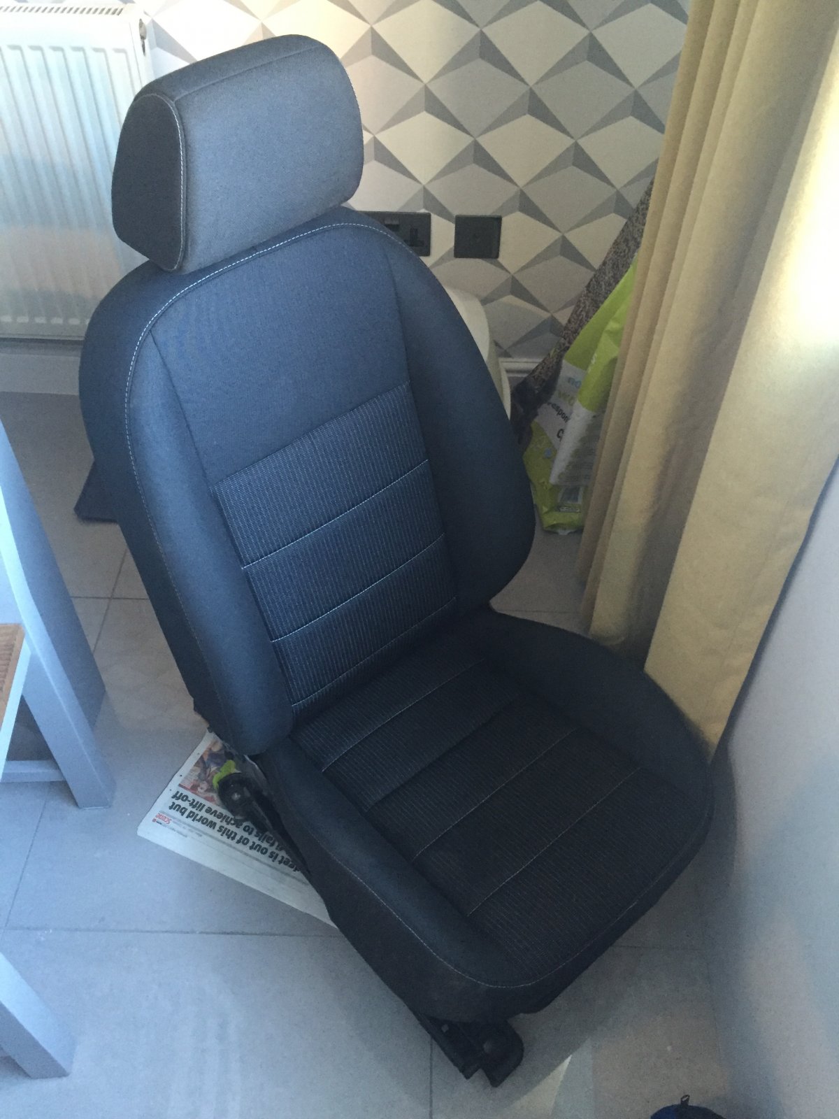

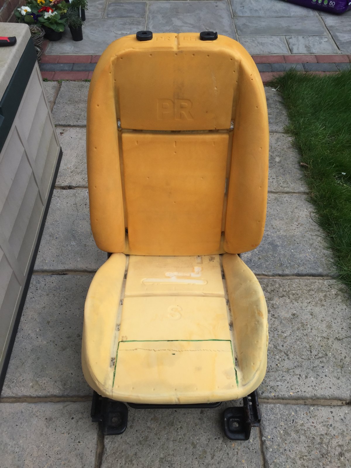

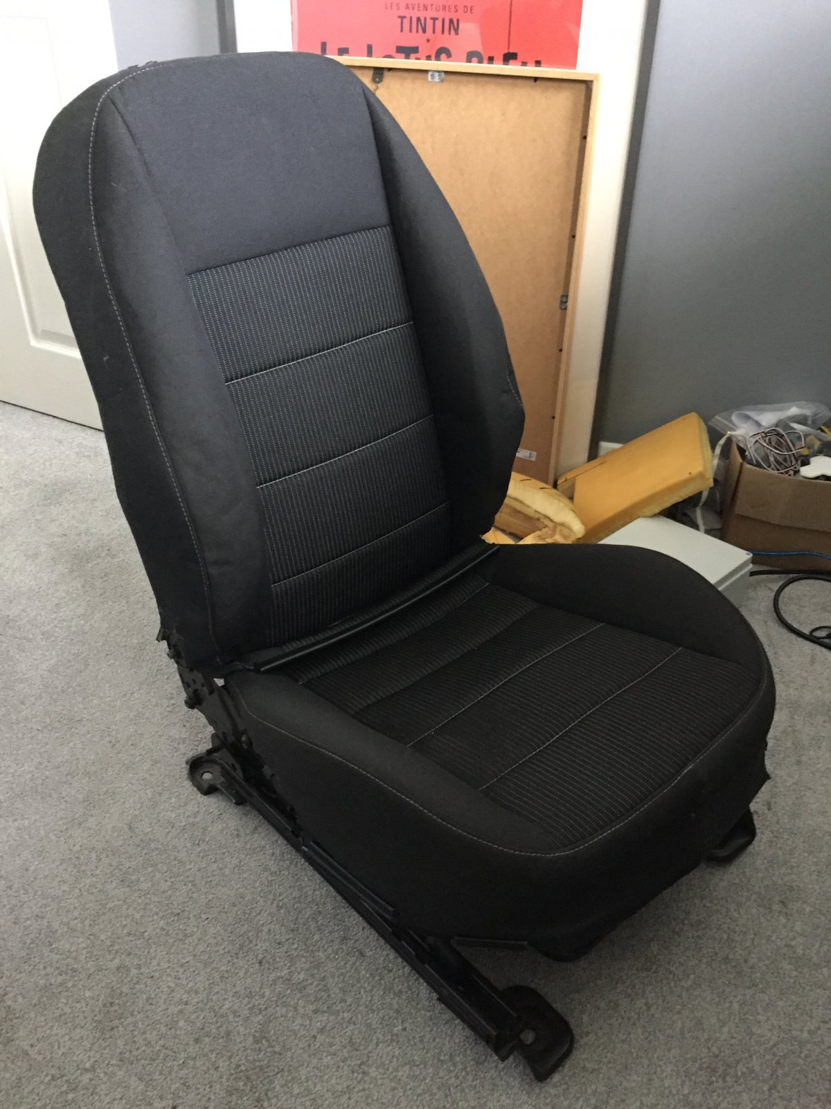

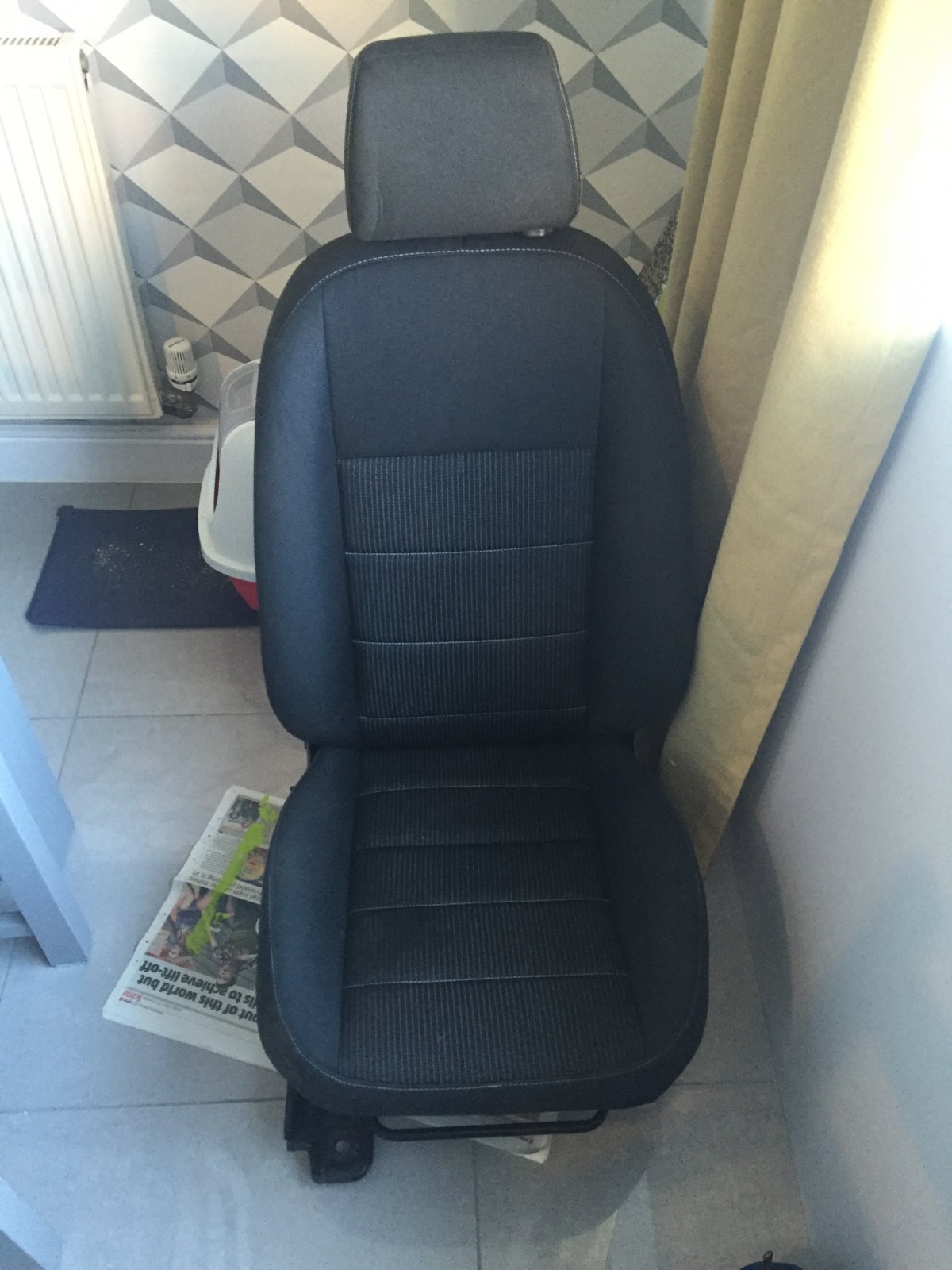

    First challenge was to source a seat. It had to cheap while quite sporty, providing the side supports that is crucial for my design. A few weeks of searching and I found a 2009 Ford Focus seat at a scrappy - £40

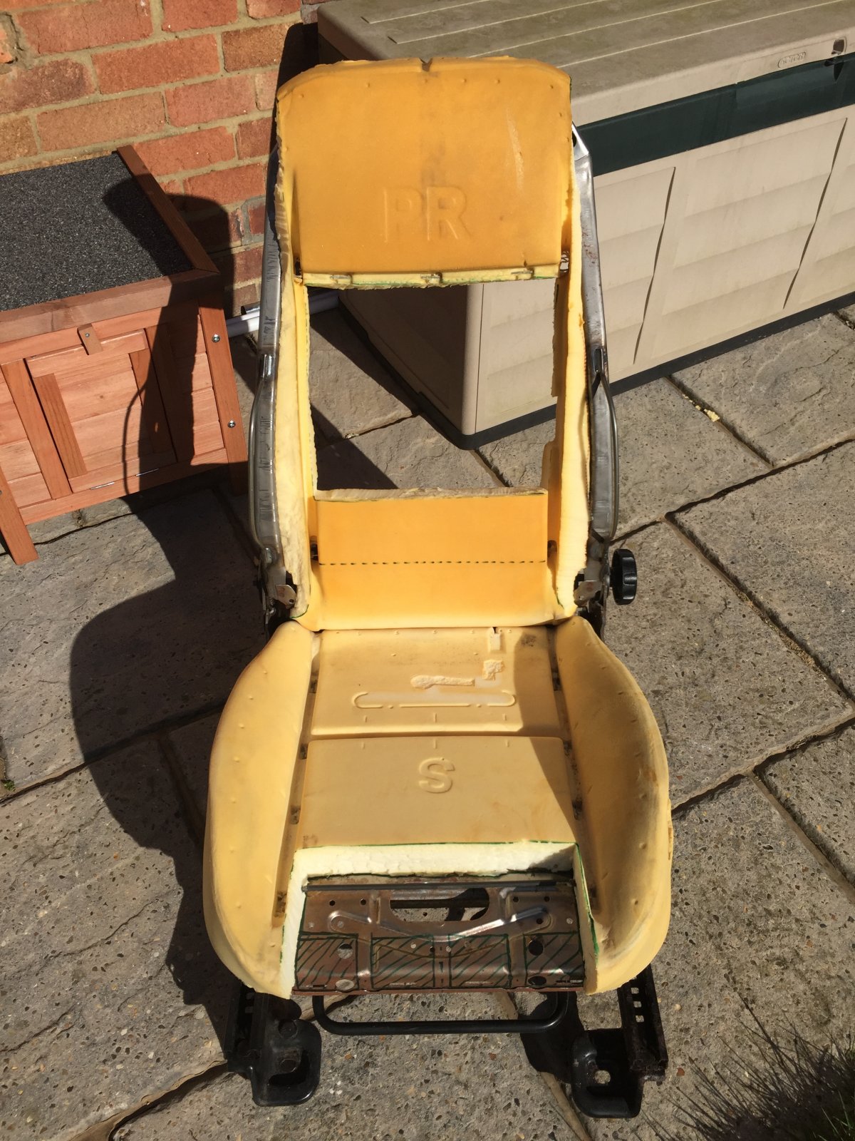

    Then to dismantling. Not as easy as thought. First thing was to buy a T50 torx head as this was the bolt type holding the back to the base.
    Covers came off relatively easy around the sides but are held in the grooves by an annoying metal hoop system. Not too difficult to unhook just time consuming.

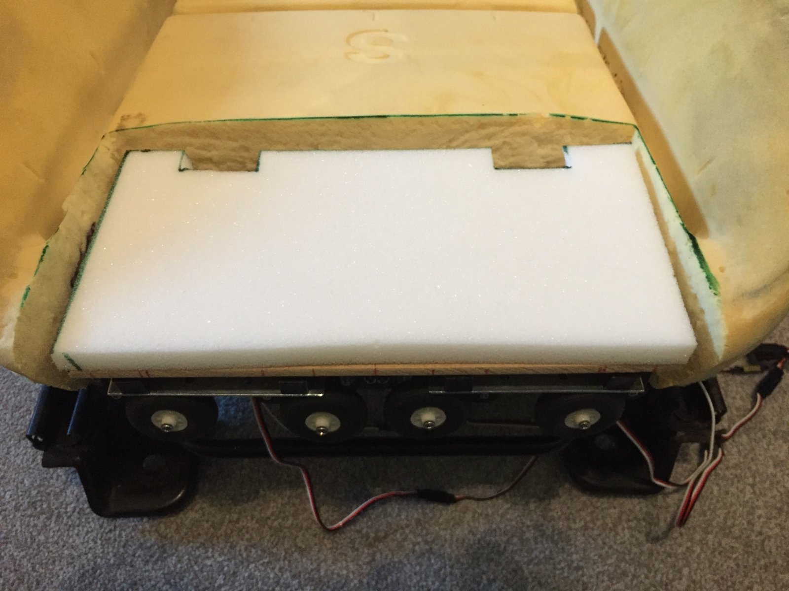

    Brake paddle area marked out and foam cut away
    There's a metal bar support built into the foam, but it sits lower than the paddle position so will leave it be.

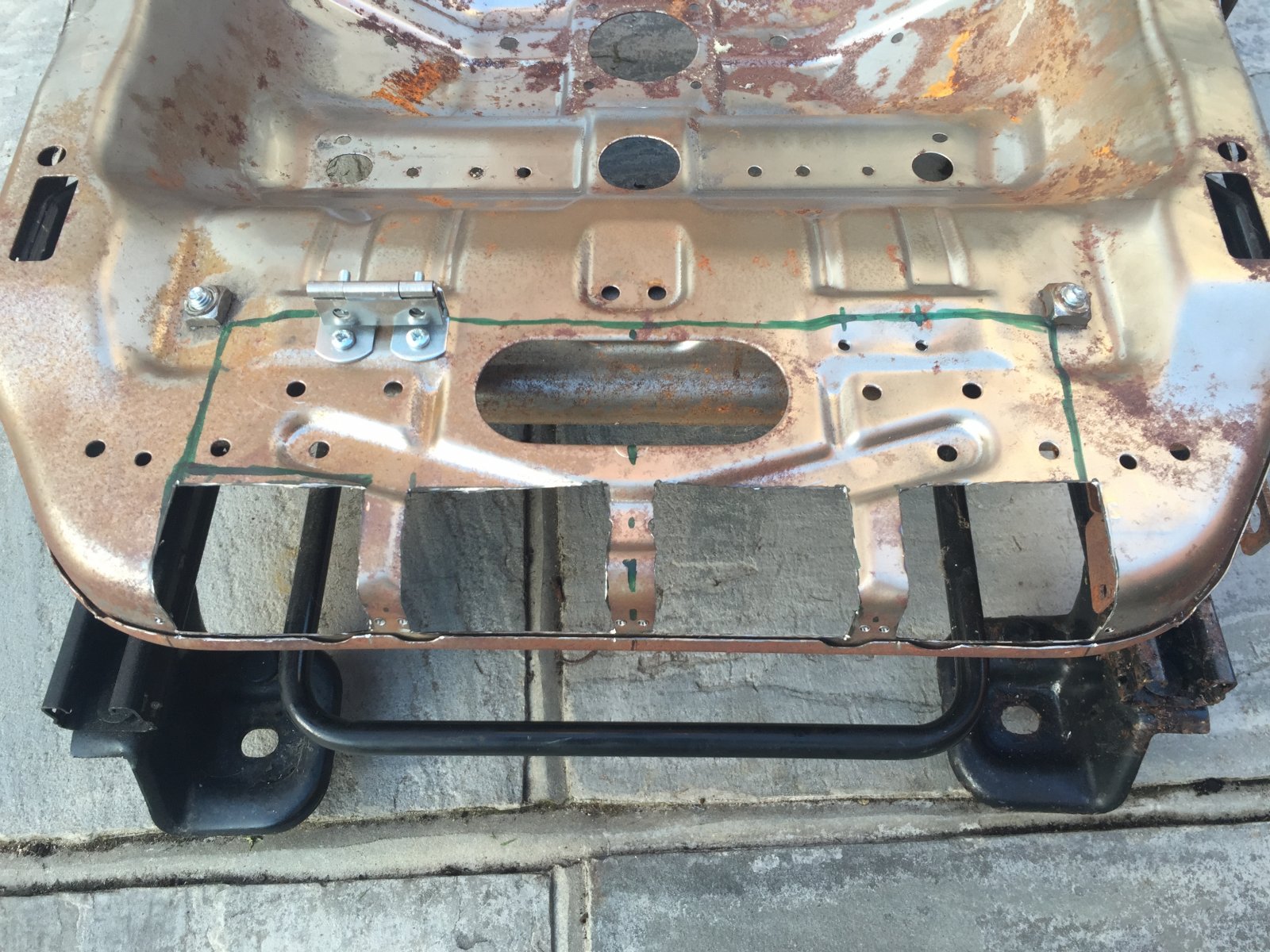

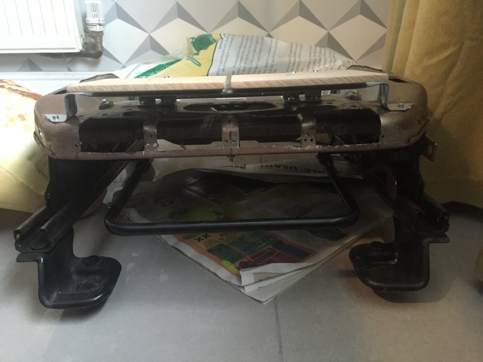

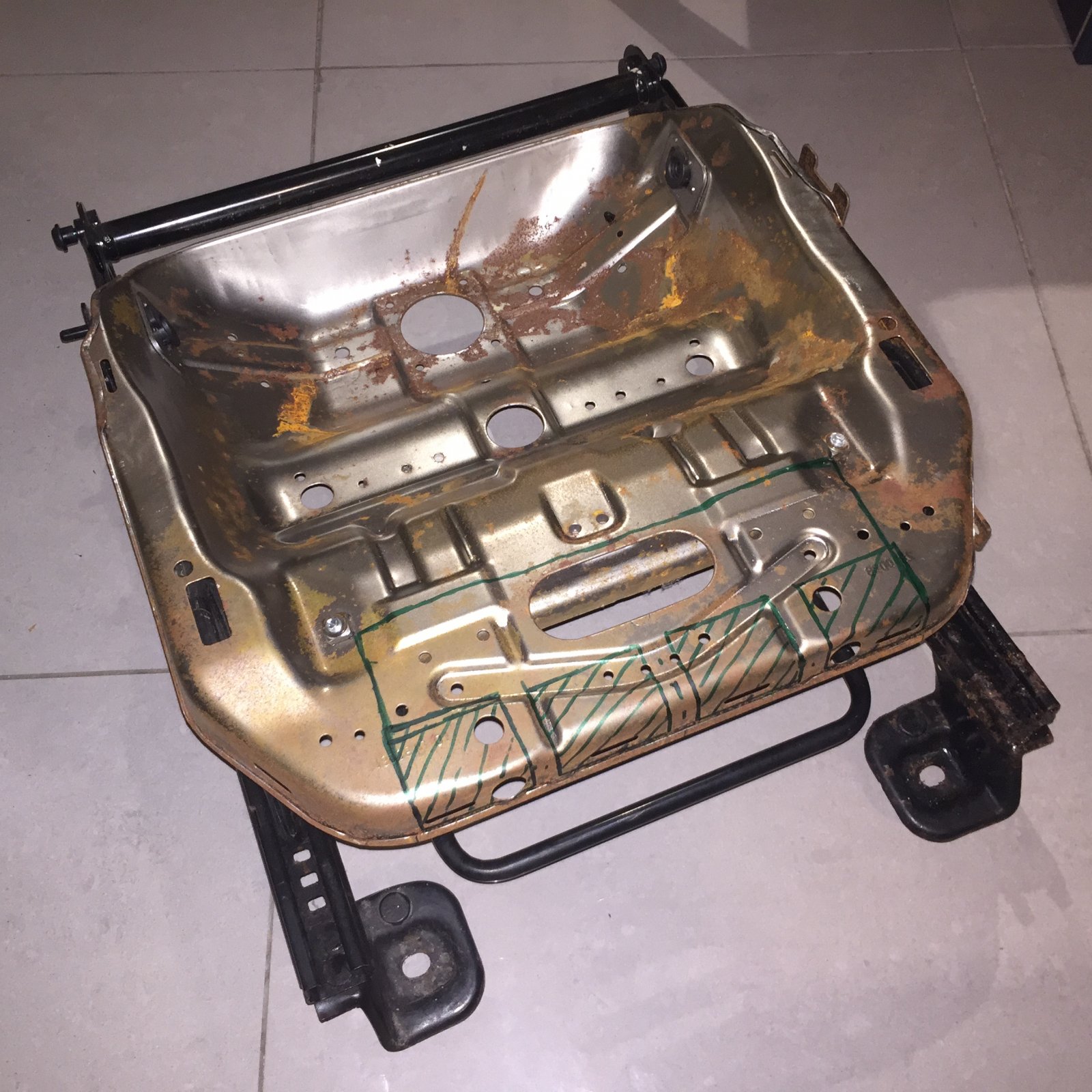

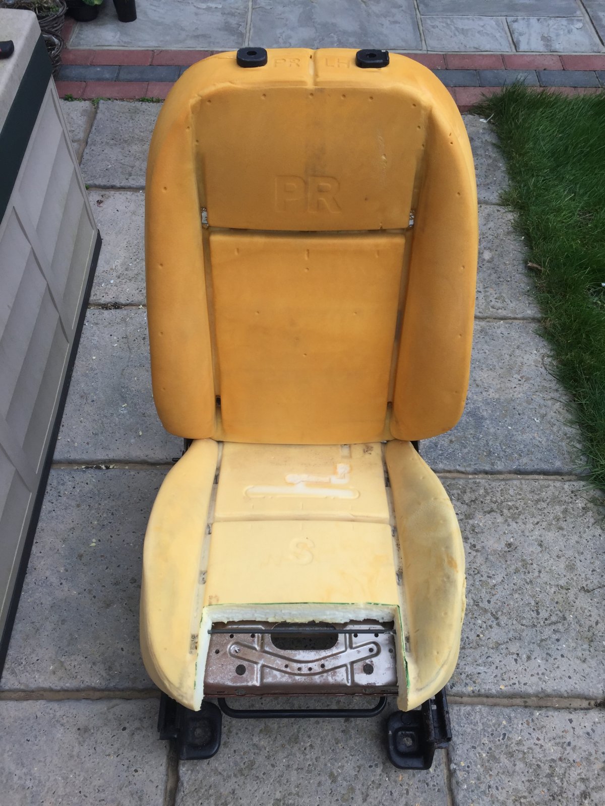

    Bottom padding removed showing subframe. Actually not much room but can squeeze the servos in along the front edge which will fix directly to the frame. Rotary cutting tool on order to cut away hatched green areas

    Butchered the rear padding this morning. Sides cut away for sway paddles and middle section for surge paddles

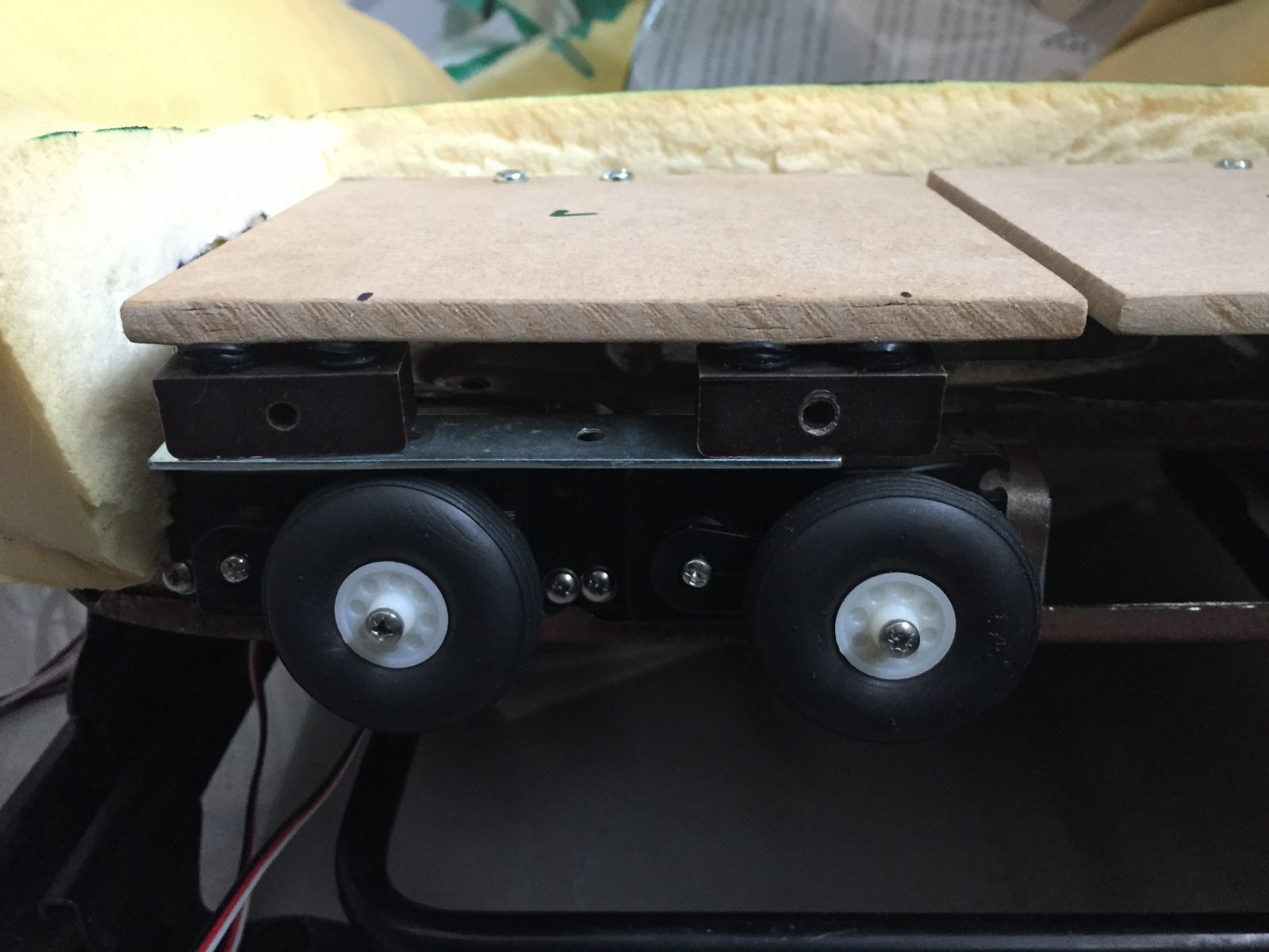

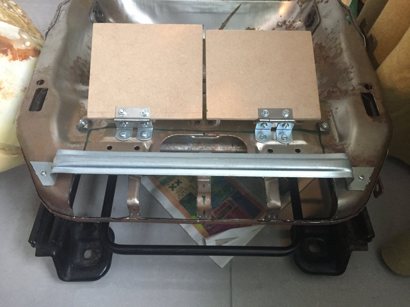

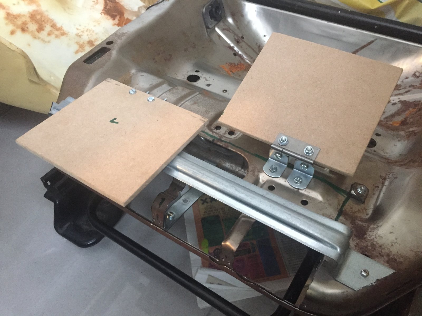

    Bit more progress this weekend. Fitted the braking paddles and the support bar which they will rest on
    Getting some flex in the metal frame when weight applied on the servos due to cutting away a lot of material, so fashioned a brace to stop it.
    As the paddles have a limited movement the servos can not be directly linked to the paddles using track rods, so have used an idea initally seen mentioned by @Spit40 which uses small RC rubber wheels mounted to the servo horn
    Will come up with a better solution for the wheel runners but wanted to test it out.
    Initial testing:
    Seems to work well. Poor quality hinges to blame for lateral movement.
    After this initial test I have now decided to change from 2 paddles to a single paddle as this will only be dealing with the braking force.
    Should have ordered more wheels as they're now out of stock. Once back in the base is pretty much done.
    • Like Like x 6

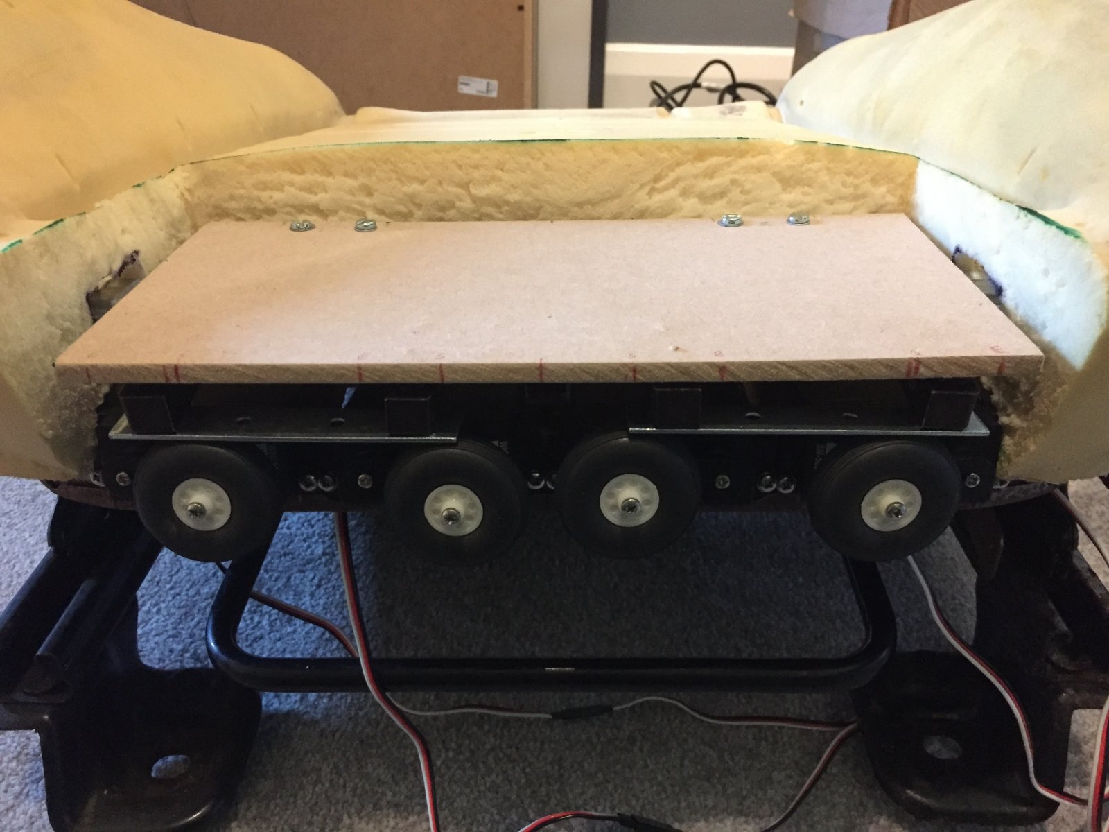

    Bit more progress on the base
    Swapped out the 2 paddle setup for a single paddle. Finished the right side by adding the servos and wheel runners (made these adjustable by placing rubber grommets in between)
    Ans added some upholstery foam
    After some initial testing on LFS it seems to work very well. Servos have no issue applying force. CTC is currently 30mm.

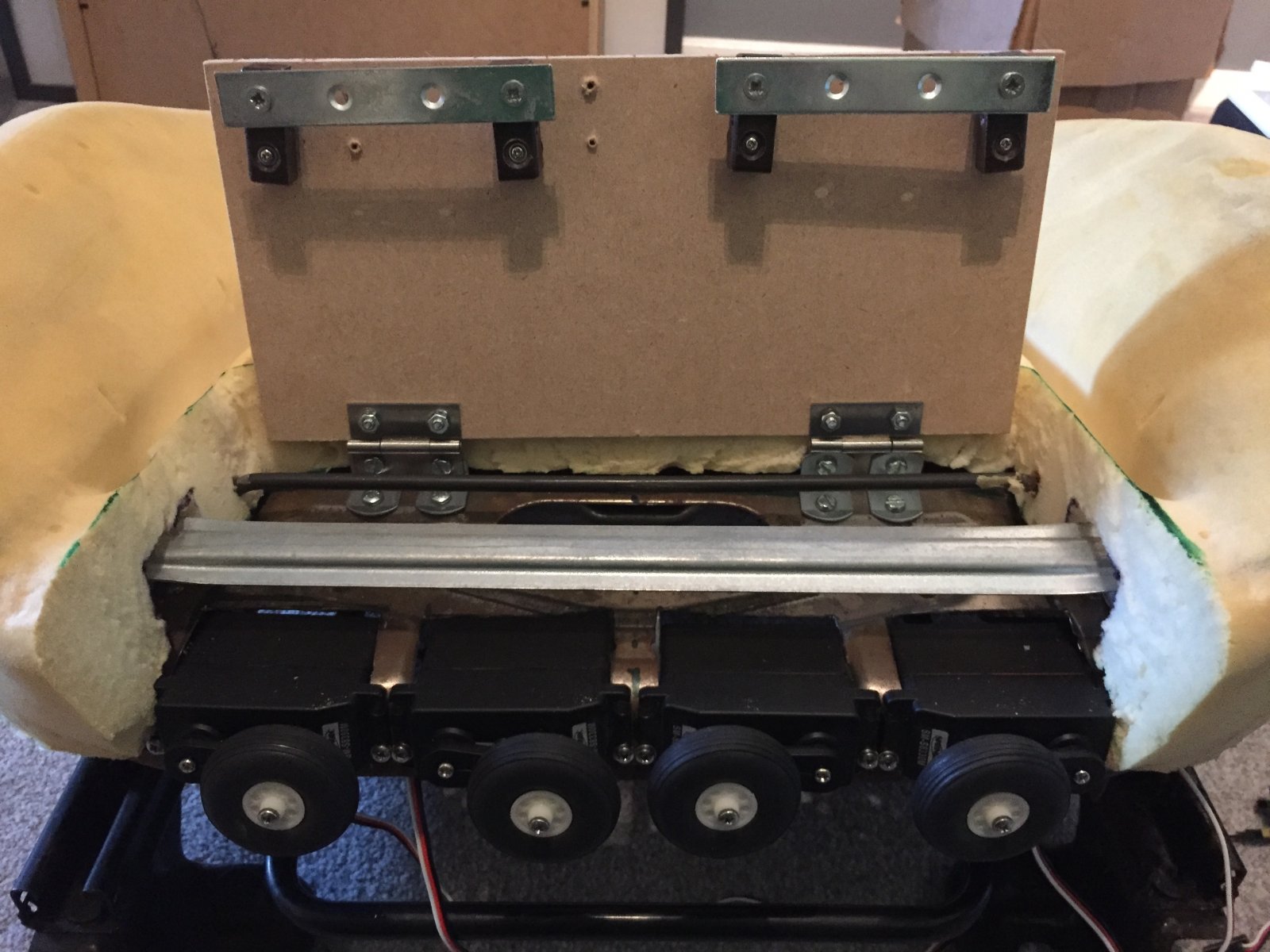

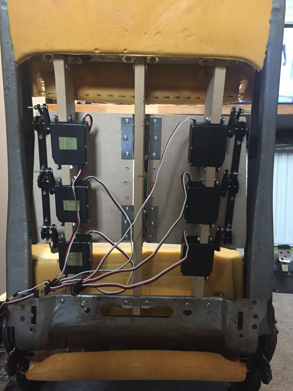

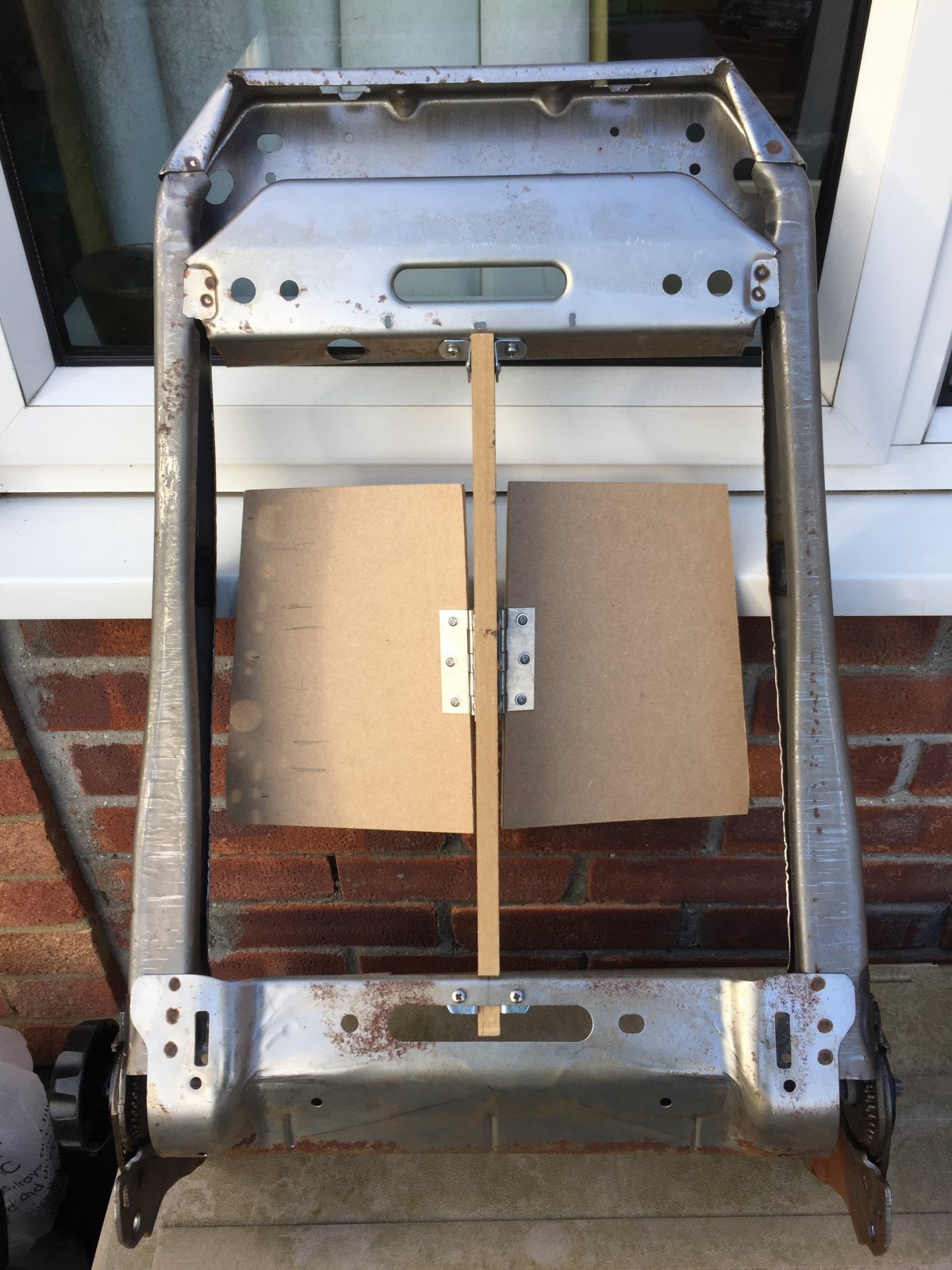

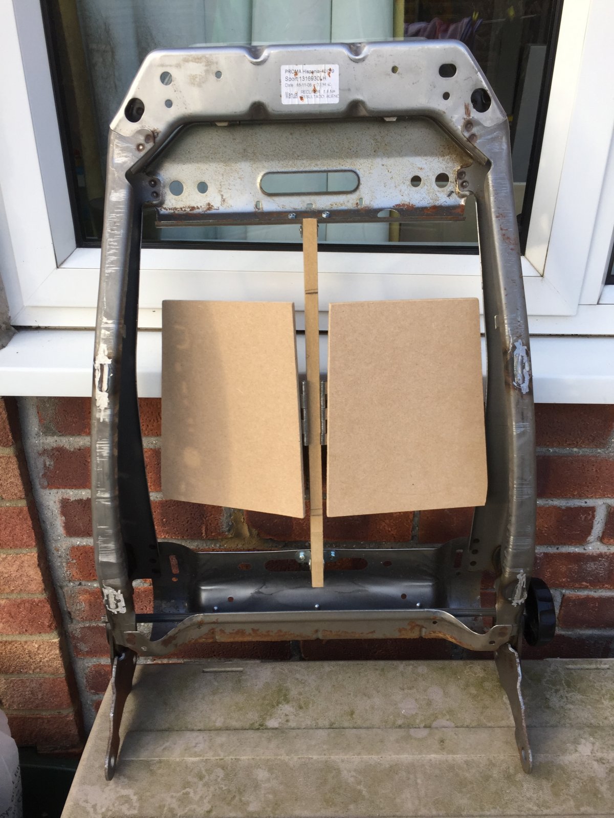

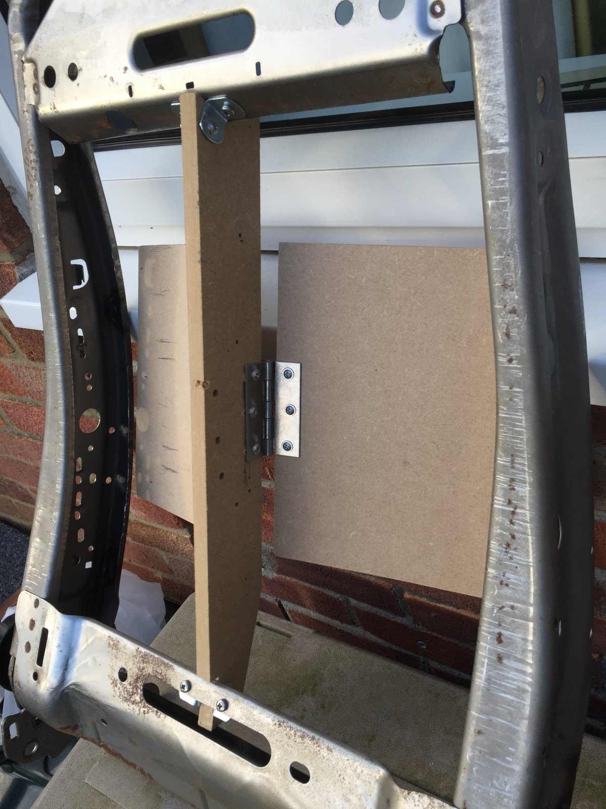

    The back is going to be trickier than the base and will take some investigation work into how best to make it work.
    Have started with adding the surge paddles. Once aligned I can take a look at servo placement.
  14. early_m
    early_m Active Member
    Jul 28, 2016
    328
    Chelmsford
    865Coins
    +350 / 4 / -0

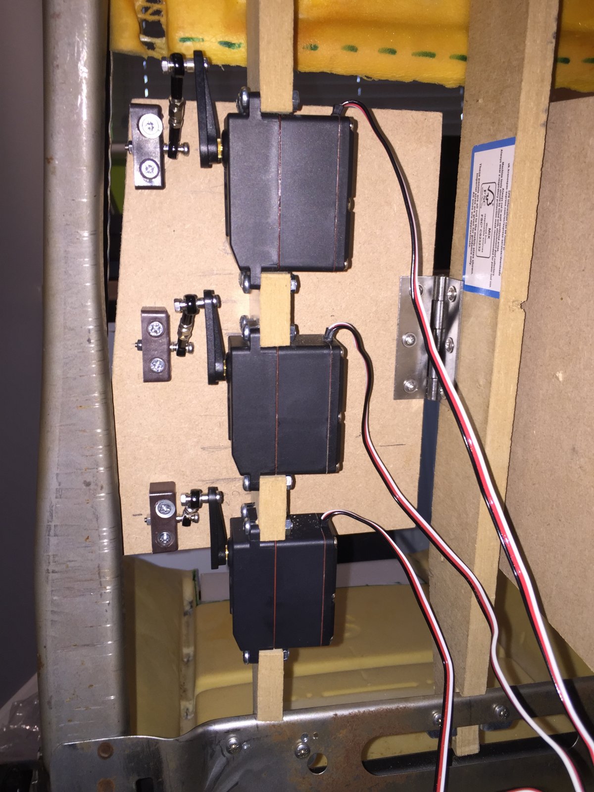

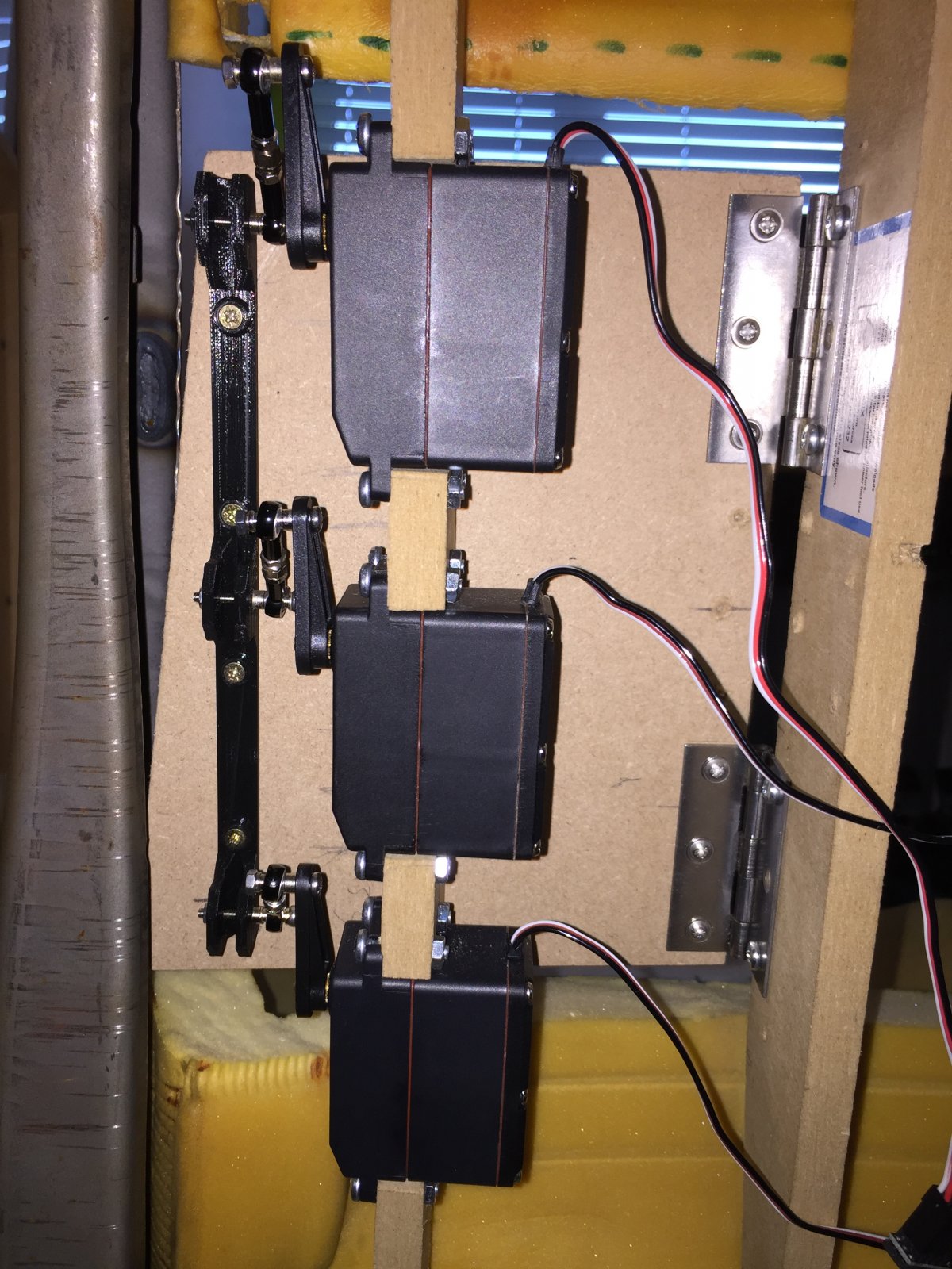

    Servo motors in place and connected to the paddle with joint blocks. Did some testing and a one hinge setup just doesn't work as it allows the paddle to flex, placing too much force on the top/bottom servos.
    Swapped to 2 hinges and also 3D printed a bracket to connect the rods to the paddle. This now works very well and intial tests with LFS are promising
    • Like Like x 5

    Both sides now assembled

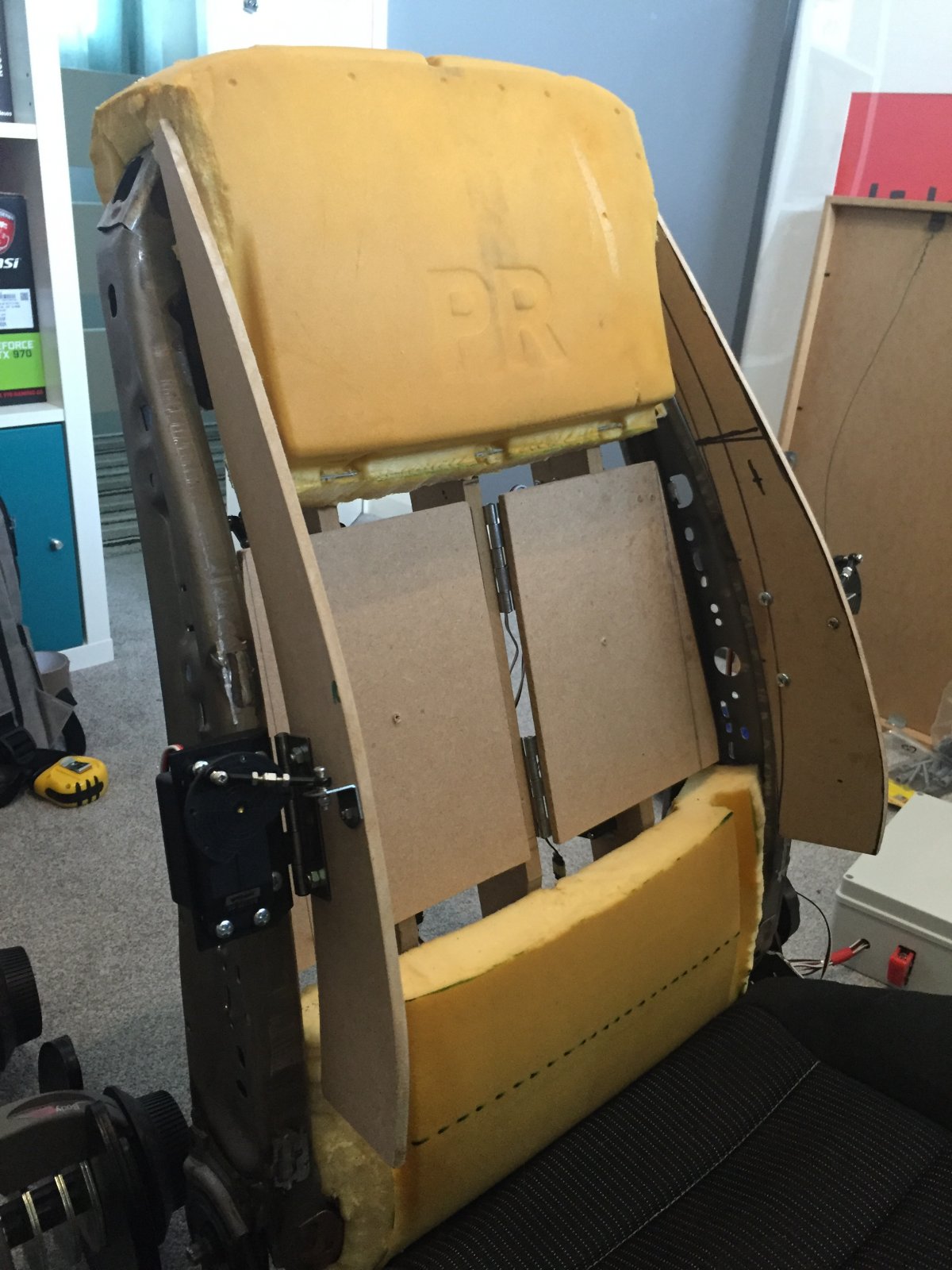

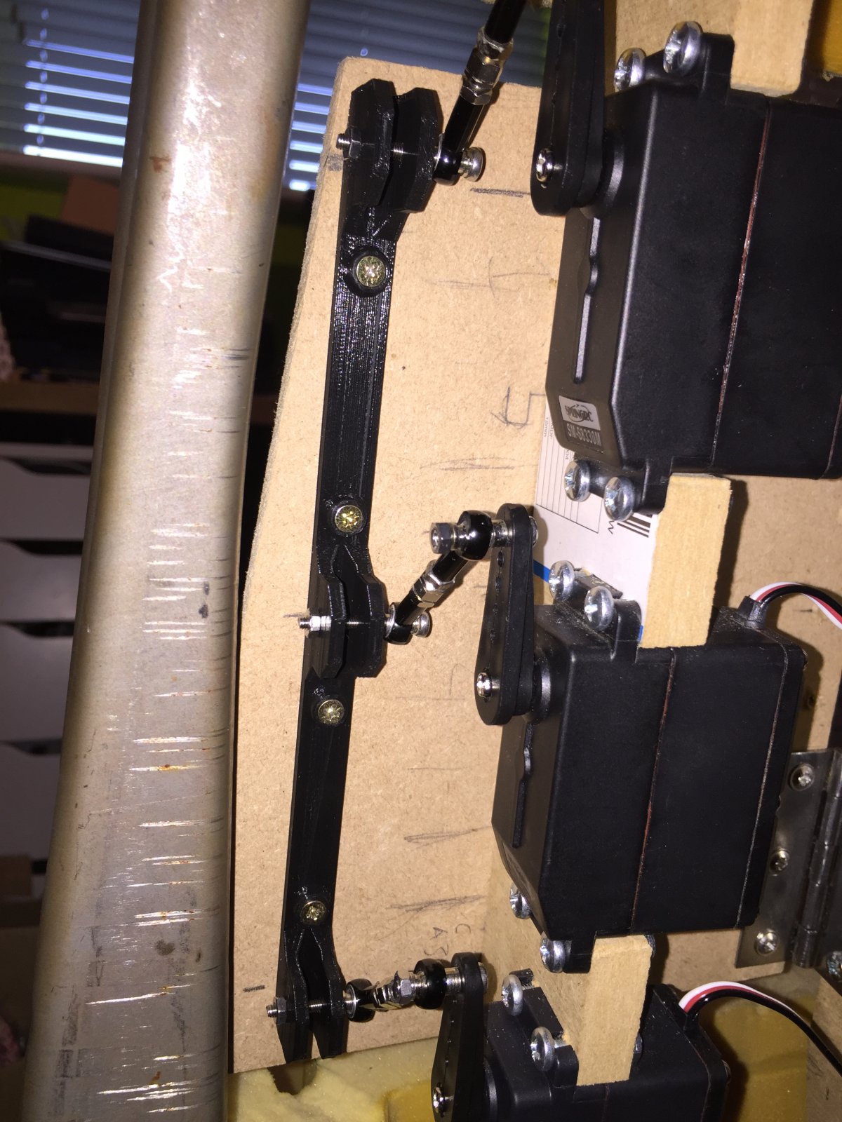

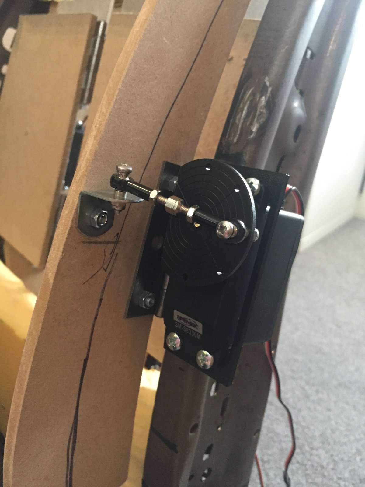

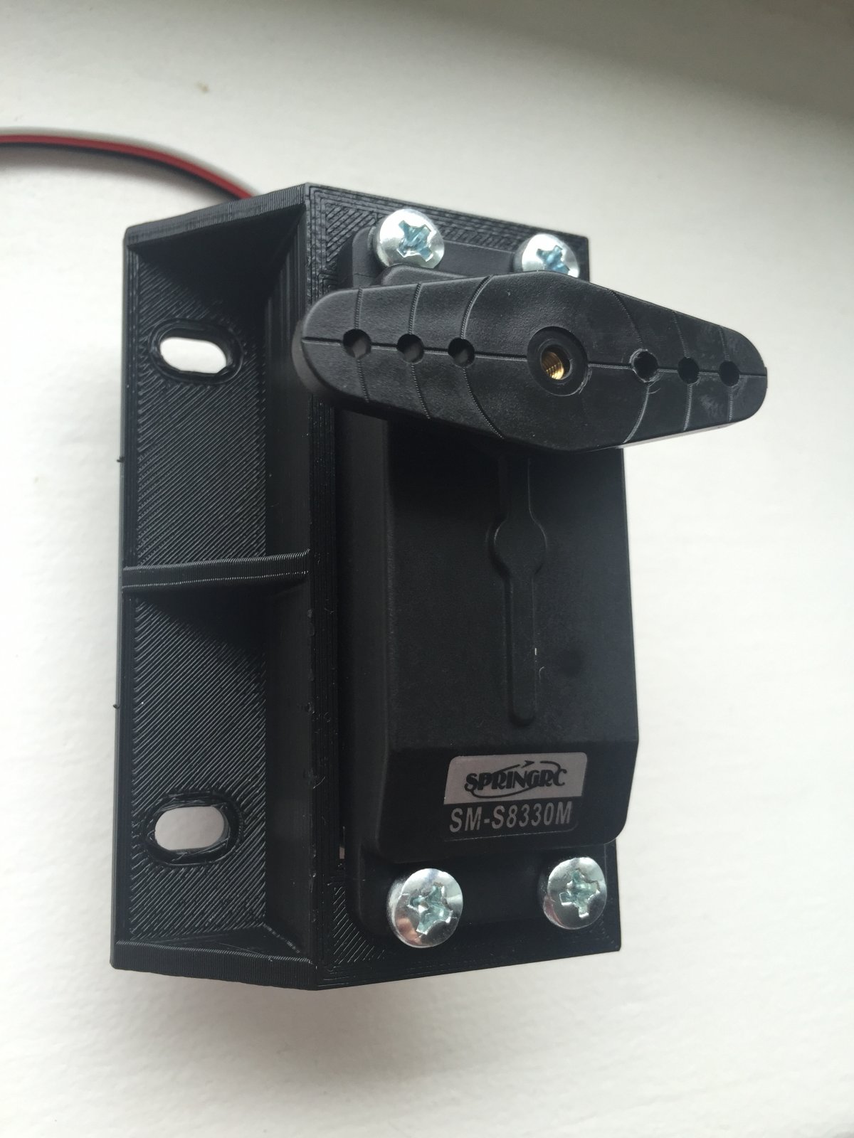

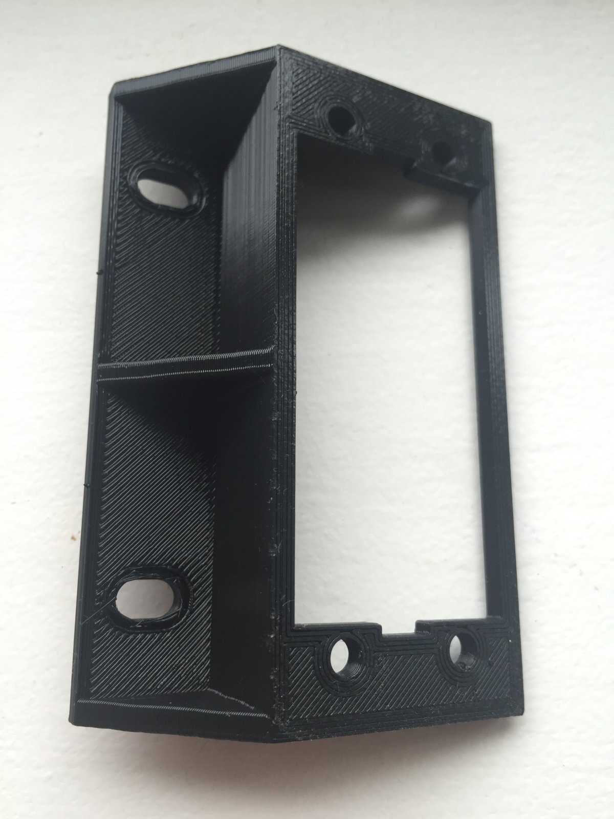

    Turned my attention to the side paddles which will simulate the sway g forces down the side of the body.
    I discovered that I had enough room down the side of the frame to mount a servo so this really helped simplify the design.
    Designed and printed a bracket to mount the servo
    Mounts onto the bolts for the paddle hinge and connected to the flap with an RC track Rod
    Both sides complete
    Initial tests with LFS are fantastic. The side paddles are a step up from what only the rear paddles can offer in terms of cornering g's.
    Next step is to add some foam padding and get it dialled in.
    Will upload a video of it in action soon.

    Here is a video of all the seat components working together. A lap of LFS in the BMW
    The seat is now pretty much done. Need to finish off some padding and tidying of the cables. I've now decided to put this into a dedicated frame housing the seat, wheel and peddles and will place all the electronics within the frame.
    Here is a pic of the seat with all covers off
