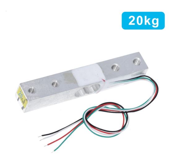

    We need a load cell like this one (20Kg is enough)

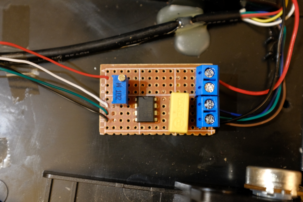

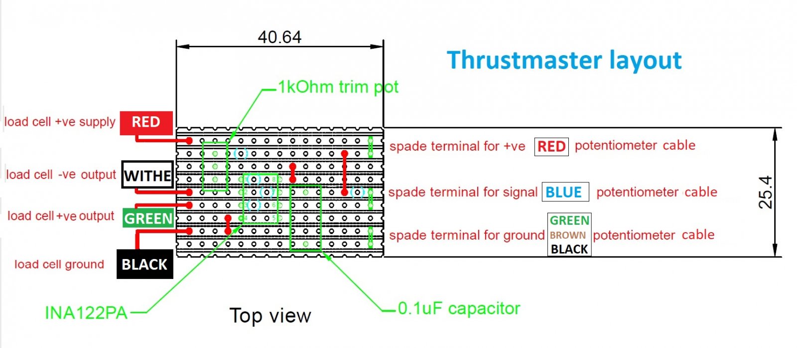

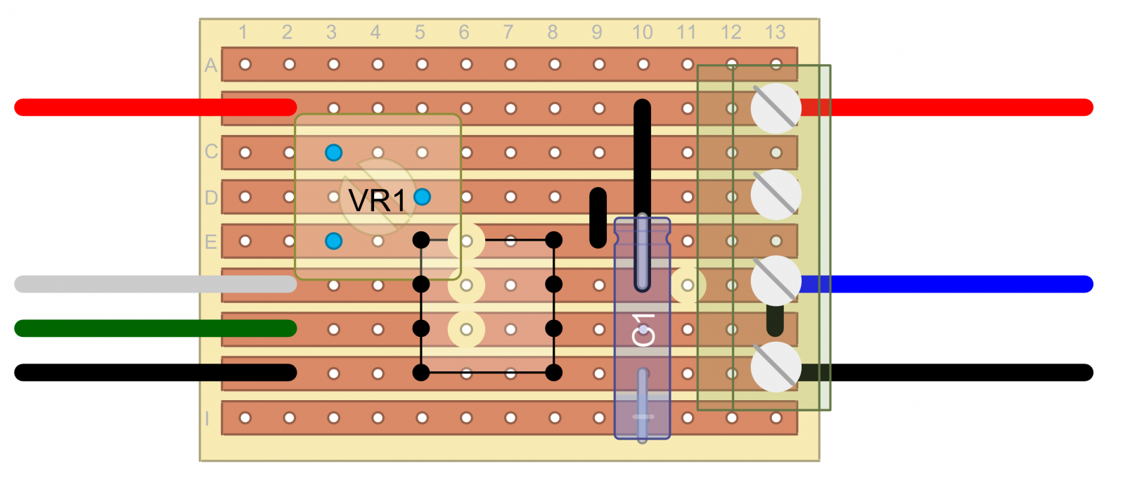

    Electronic components needed:
    • INA122P amplifier
    • 1 kilo-ohm potentiometer
    • 0.1 microfarad capacitor

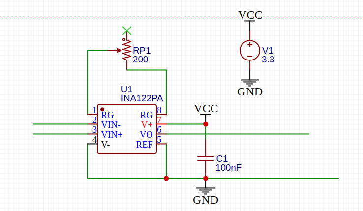

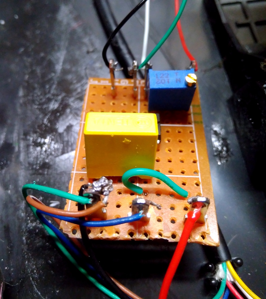

    With these components we have to assemble an electronic board following this diagram:

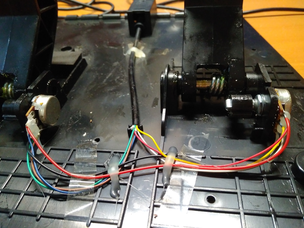

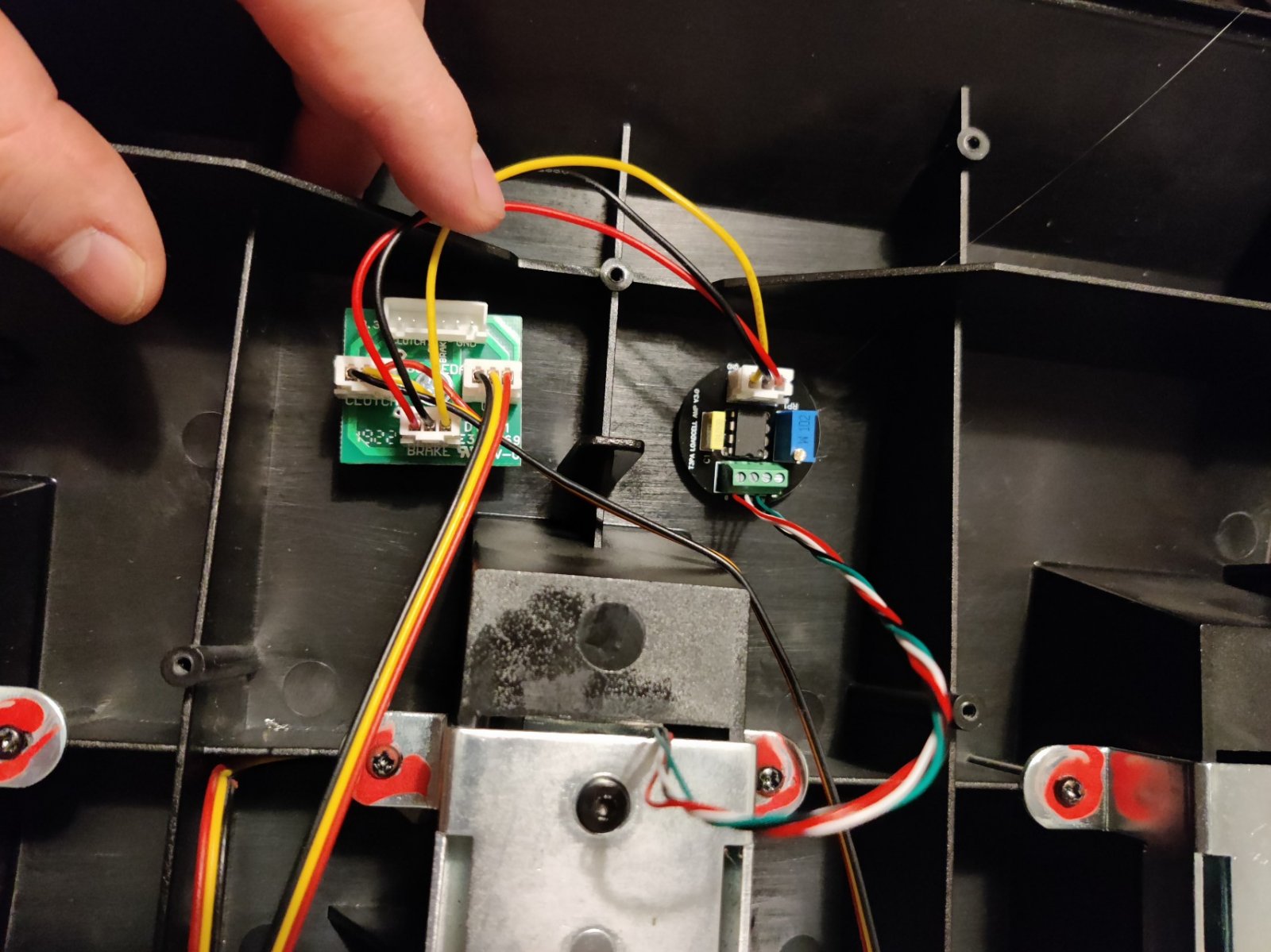

    Cut the cables that go to the brake potentiometer, and solder them to the PCB that we made according to the previous diagram. Also solder the 4 cables that come out from the loadcell to the board. This way, the steering wheel is not aware that the signal that reaches it comes fom the load cell instead of the brake pot.

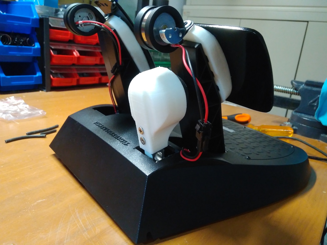

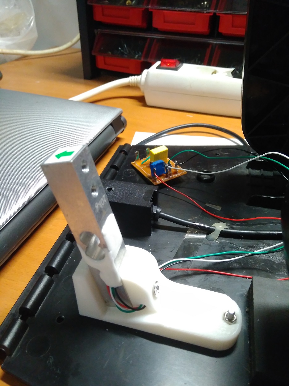

    I made a support with the 3D printer to hold the loadcell, and another for the pedal / loadcell linking, which is based on a squash ball to give some elastic feeling to the brake. I had to use a dremel to open a hole in the pedalboard cover in order to allow the loadcell popping out there.

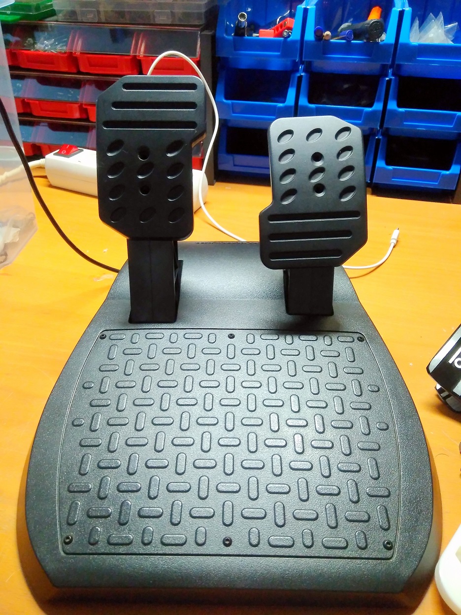

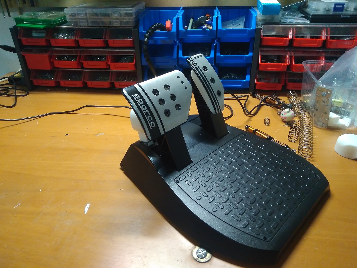

    I also did supports with the 3D to adapt metal pedals to have fancier look
    And finally I put two Xbox gamepad motors to add vibration in wheel locks (braking) and throtteling slipping . This is by means of an Arduino board following a tutorial from other forum.
    And this is the final look.

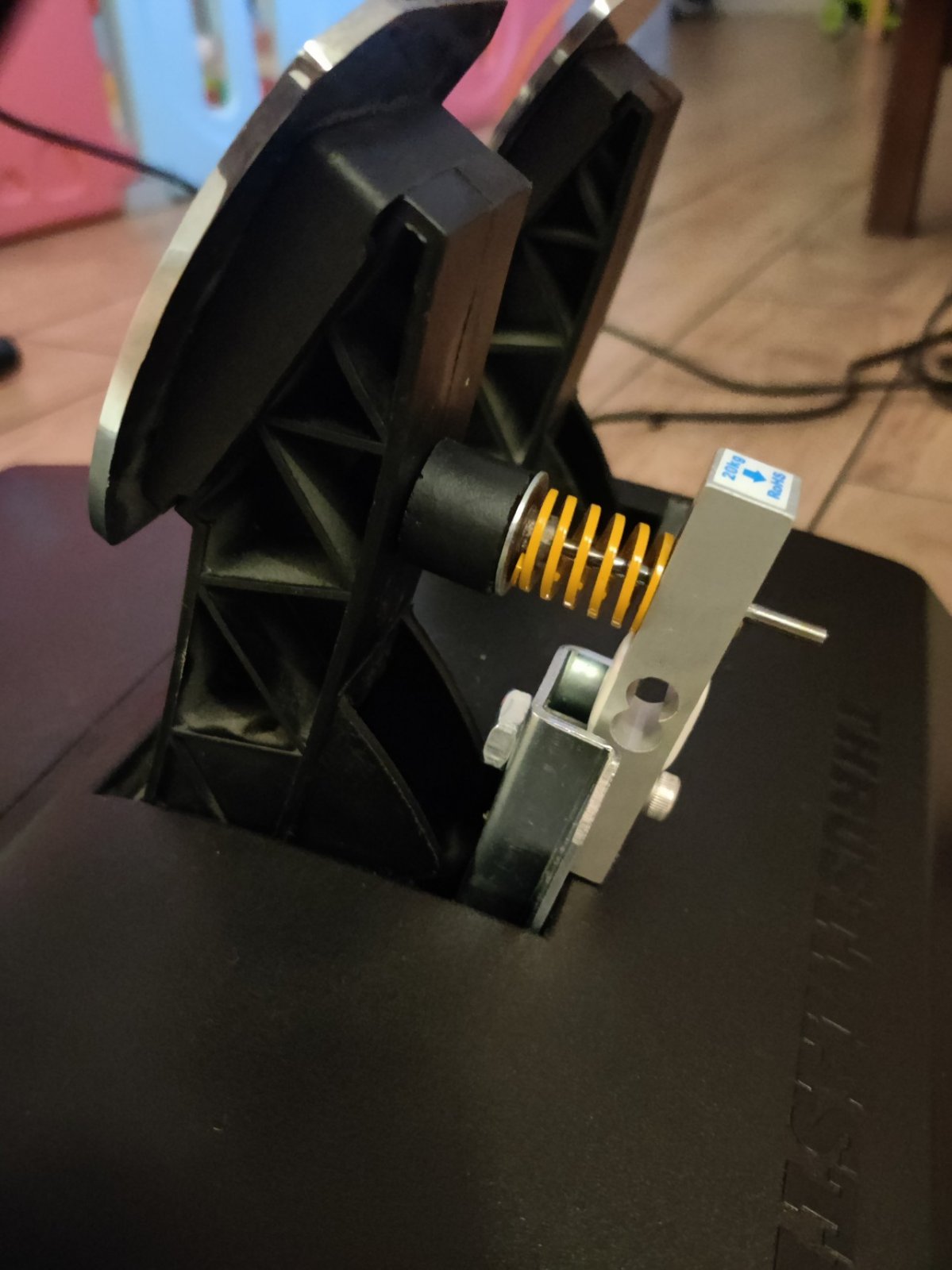

    PS: I added a pair of torsion springs to the accelerator from an old device to give the pedal more stiffness, because it was too soft for me.

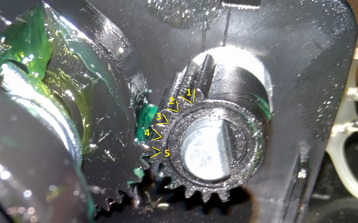

    Another important detail with the throttle is being sure that the potentiometer gear links with the pedal in the proper place. In the picture below you can see that the first tooth of the pedal engages in the fifth "valley" of the potentiometer gear. This is how I originally had it. That way the accelerator was not working well. The first section of the stroke (about halfway through) did nothing. So I tried different positions, until I found the right one. In my case it is the third "valley". On this position the accelerator works progressively throughout the pedal whole stroke.

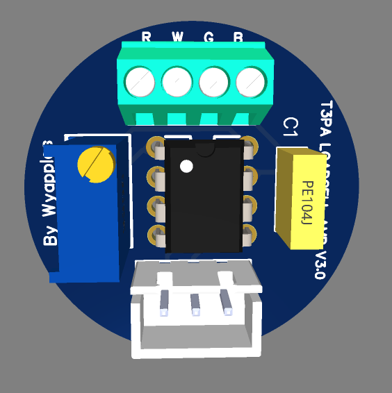

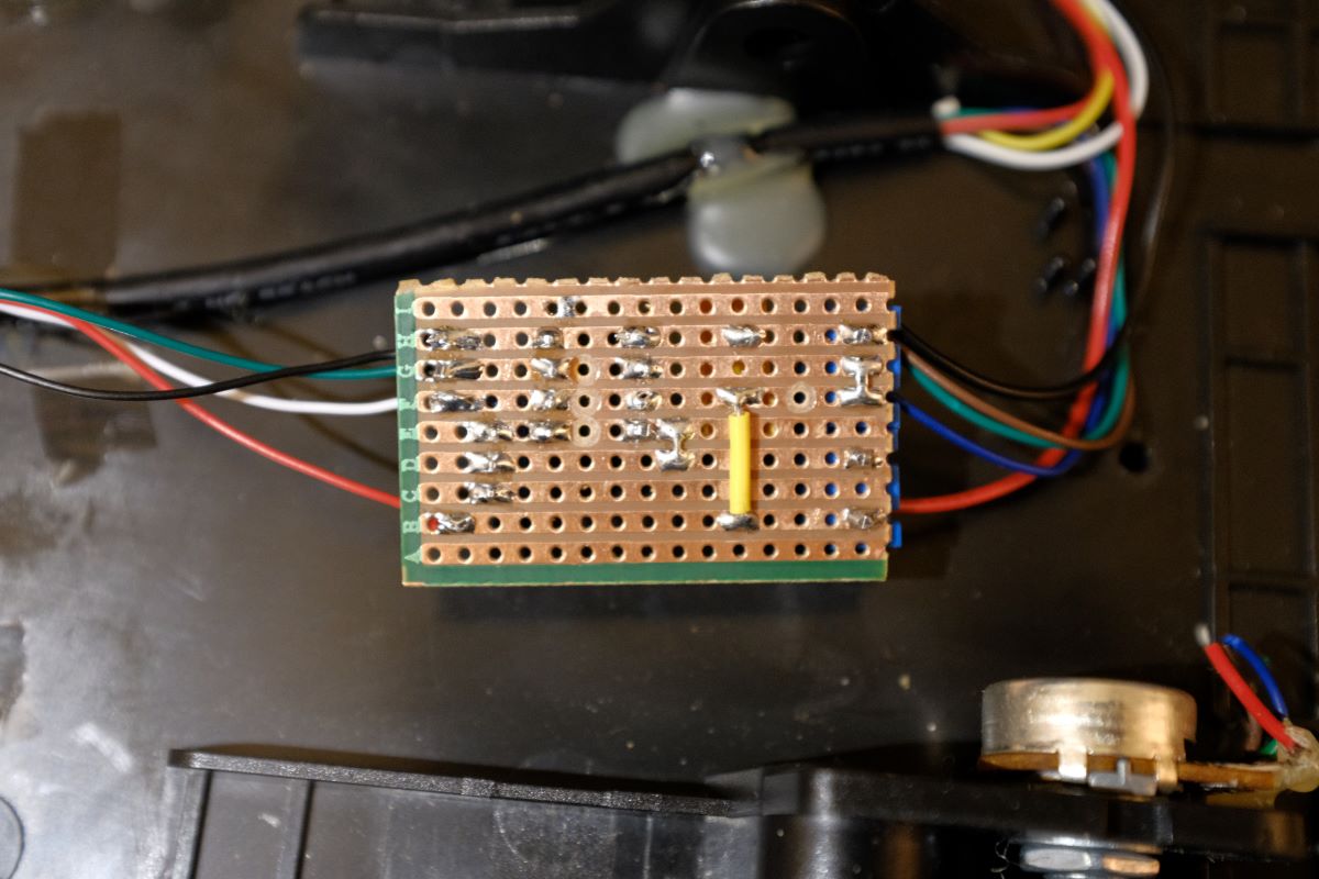

    Hi, do you have more your pcb pictures? Top and bottom view? Diagram is not clear for me, i am confused with those blue (brackets) in scheme. I assume "brackets" means that i need break(separate) the line? Hard to explain what i do not understand :D

    截图_选择区域_20230321112104.png 截图_选择区域_20230321112008.png 截图_选择区域_20230321111954.png IMG_20220228_234006.jpg IMG_20220308_230547.jpg

    I tried implementing this mod for my TX 458 pedals but seemed to be unsuccessful. I get no output from pushing on the load cell even after adjusting through the full range of the trim pot. I used a slightly modified wiring diagram with help from another user on thingiverse, but still has the same connections to the INA122P amplifier as far as I can tell. On the original potentiometer cable side, I measured the voltage between the blue signal cable & ground is measuring 2.8 V and the voltage between the red +VE cable & ground is measuring 3.3 V. On the load cell side, the voltage between the red & ground is 3.3 V, the voltage between both white & ground and green & ground are each 1.65 V. I'm not sure what other connections to test as I'm not super well-versed in electronics. Does anyone have any suggestions? Thanks!
  12. TimmBo
    TimmBo New Member
    May 5, 2023
    7Coins
    could it be that you still have to separate the conductor track "C" after your resistance?!
    my english is not the best i hope you understand me
    Greetings
  13. neoxal
    neoxal New Member
    Apr 20, 2023
    34Coins
    Track C isn't connected to anything else so I don't think so? I am not sure. The resistance that I am using the set the gain of the amplifier is between E3 and D5. It seemed other people have been having issues with the INA122pA chips from Aliexpress. I ordered 2 chips and both have the same issue with constant output voltage even when there is a voltage differential (~5 mV) between the +/- load cell signal cable. I ordered an AD623ANZ from Mouser USA to see if switching out the amplifier solves the problem and am waiting for that to arrive.
  14. neoxal
    neoxal New Member
    Apr 20, 2023
    34Coins
    I received the AD623ANZ and it worked flawlessly with the original circuit. The gain calculation is a bit different between the two amplifiers but the 1k ohm trim pot is sufficient for the AD623ANZ.
