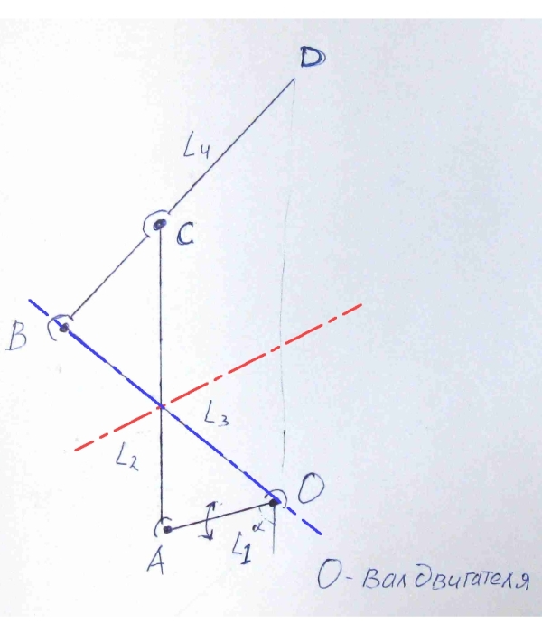

    Hello!
    Found on the website http://www.simprojects.nl/diy_motion_platform_iv.htm interesting project, DIY Motion Platform IV, I would like to repeat. Having problems with calculation construction, could you help with the calculation of the function of motion endpoint of the output element, depending on the angle of rotation of the motor?
    motion video with a real platform
    http://www.youtube.com/watch?v=OS3gkMHAgEQ
    scheme of the mechanism [img600px]http://cam350.ru/temp/chema.jpg[/img600px]

    I don’t now about math in these cases, but I assume, this is some principles of mirrors. Look at the axis.
