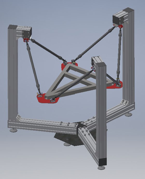

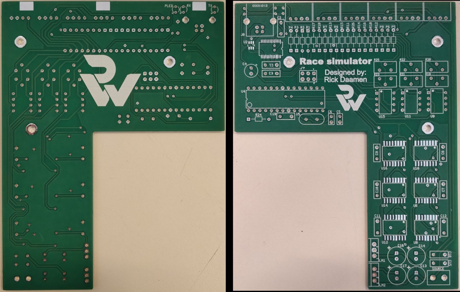

    The frame design has finaly been designed and aproved by my teacher. The materials are ordered and we hope it does arive this wednesday.
    We're pretty close to the completion date so we hope to have this frame assambled as soon as possible.
    Also the PCB has been delivered so it's time to assamble it now.
    I'll post a update again if some progress is made

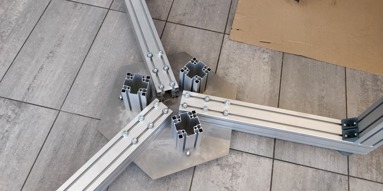

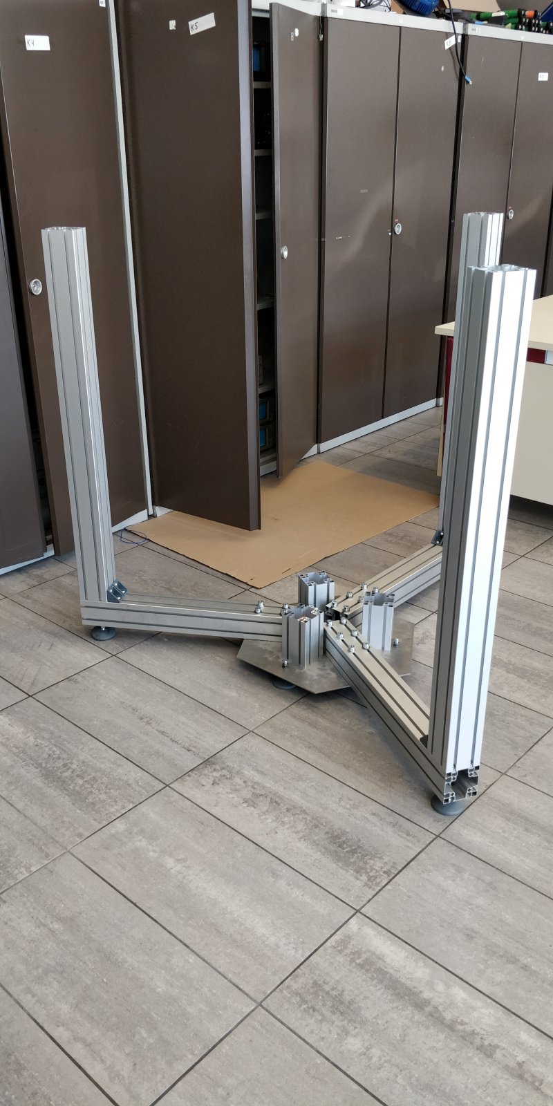

  11. Rick Daamen
    Rick Daamen New Member
    Nov 16, 2017
    11
    Netherlands
    78Coins
    Arduino, 6DOF
    The frame is being assambled. End of this week i hope i can callibrate it!

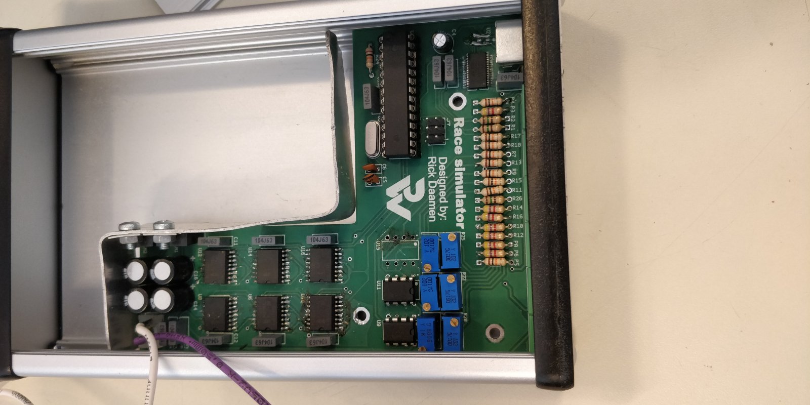

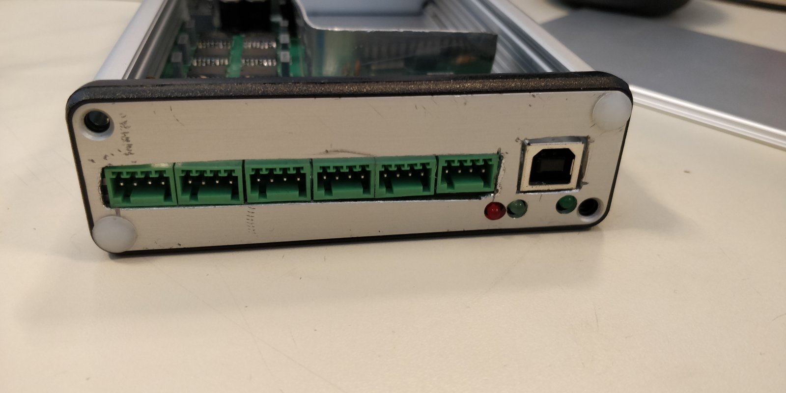

  12. Rick Daamen
    Nov 16, 2017
    11
    Netherlands
    78Coins
    Arduino, 6DOF
    Forgot to post this, my print is fully assambled and tested. Only 2 errors were occouring while testing. I couldn't get a response from the processor so i connected an external Arduino Uno to the pins to test it again. Seems i've looked wrong at the RX and TX pins while designing couse those were swapped. I swapped those again by cutting the existing trace and made a new connection with some wires. Now i get a respond from the processor. The second issue i have is that the Op-Amps are not working yet. (that place where a chip is missing on the second picture) I'm going to replace those now and double check the schematic and connections to be shure those will work. I'll update again if i can get this working or if i have any more issues.
