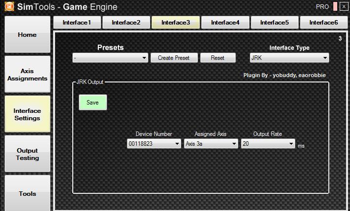

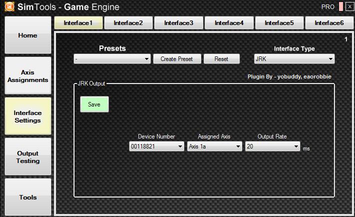

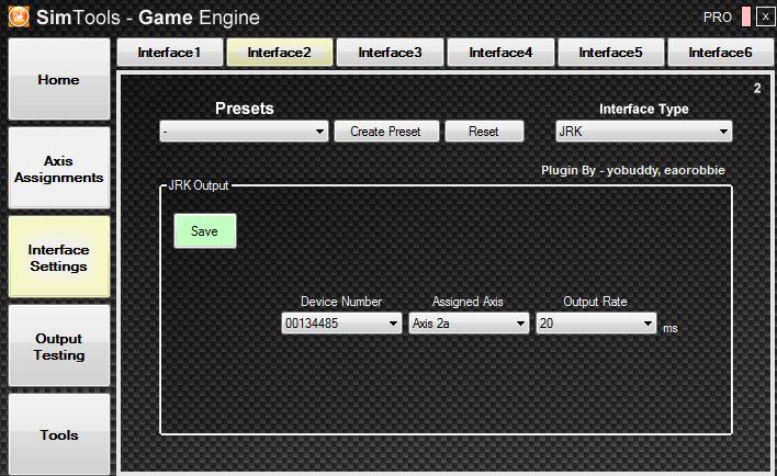

    Yes, using 3 JRK's. COM ports used (as shown in Windows 7 Device Manager) are 5, 7 & 9. No COM ports are specified in Simtools - Game Engine as I am using the Interface Type of JRK, which only asks for the Device #, Assigned Axis (Axis 1a, 2a & 3a) and Output Rate (20ms, which matches the PID period applied to the JRK's).

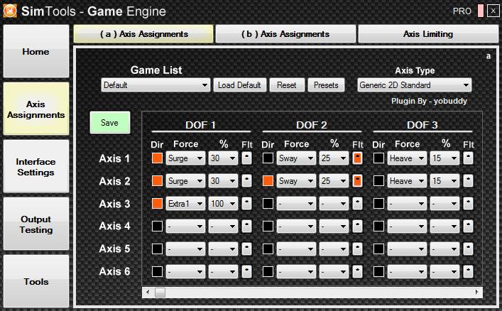

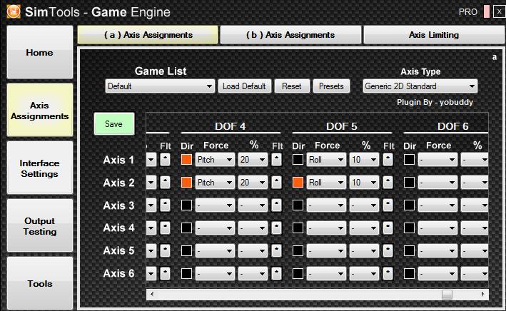

    It would really help if you posted pictures of all of your settings.
  9. VRS1
    VRS1 New Member
    Feb 14, 2017
    12
    Tyabb
    520Coins
    3DOF, JRK
    Doubt it adds anything extra, but here are screenshots.
