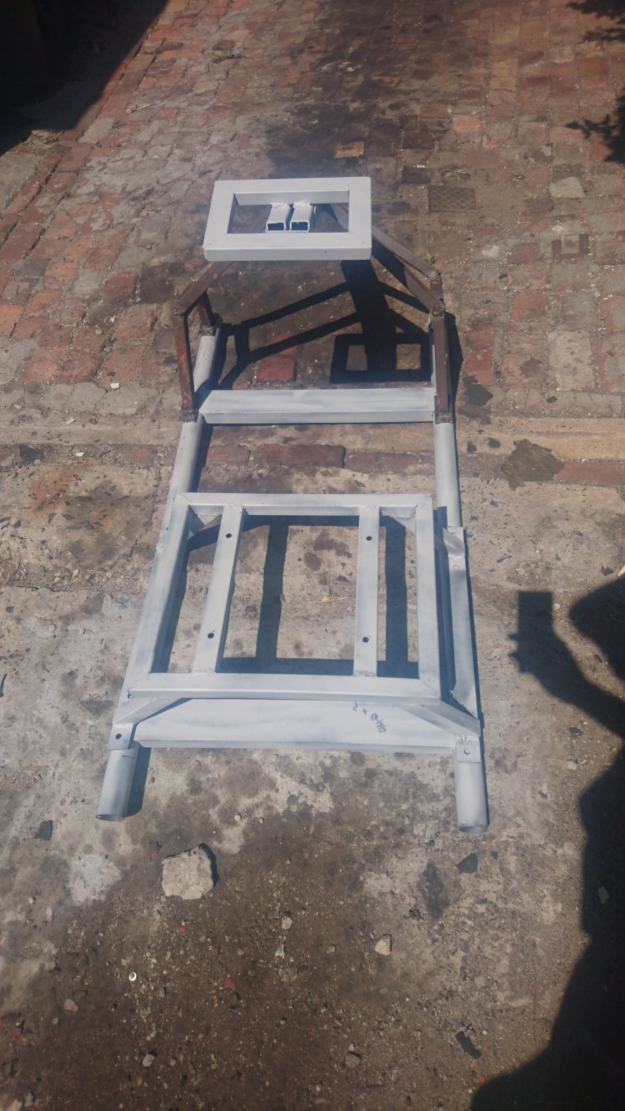

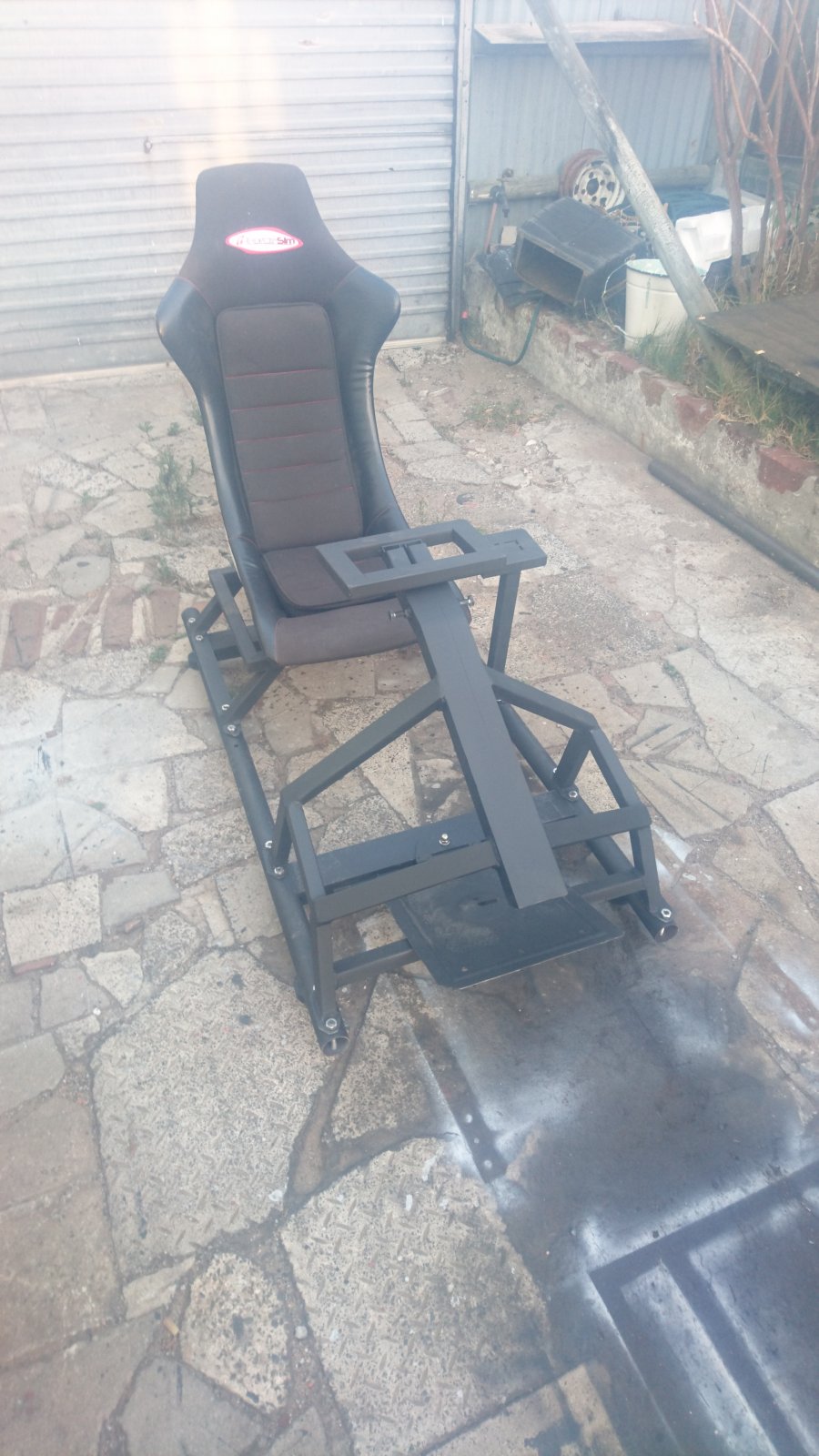

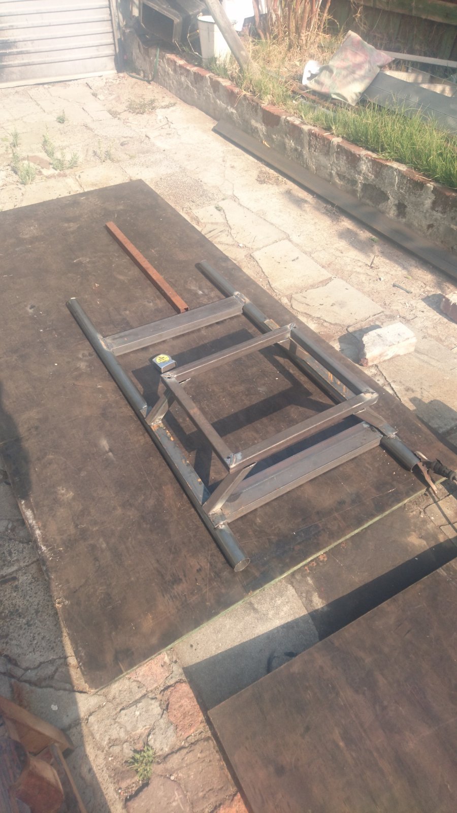

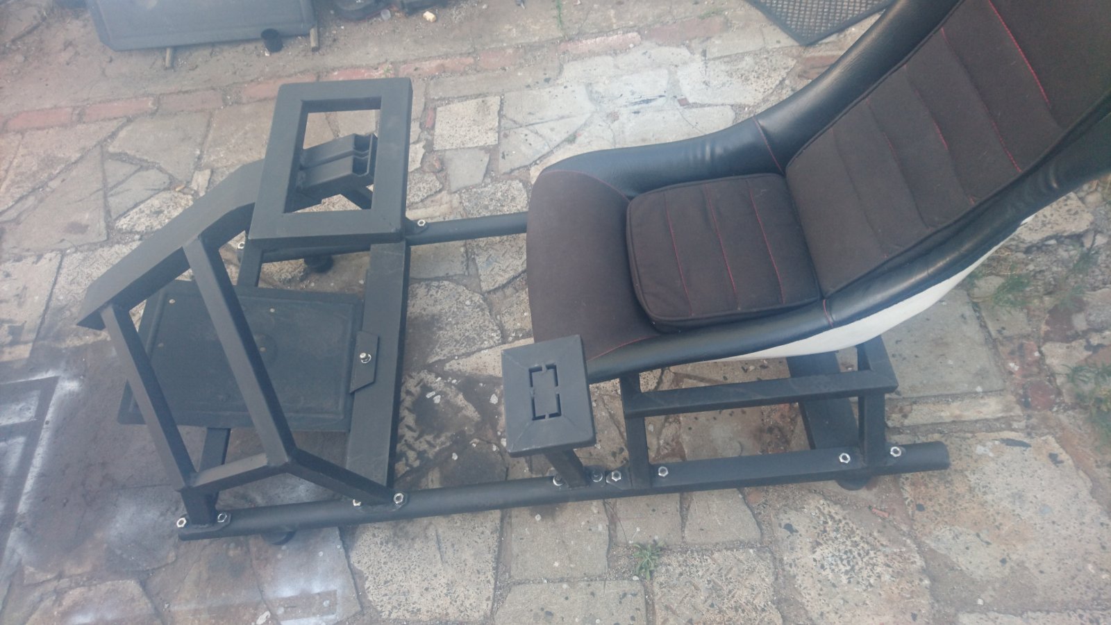

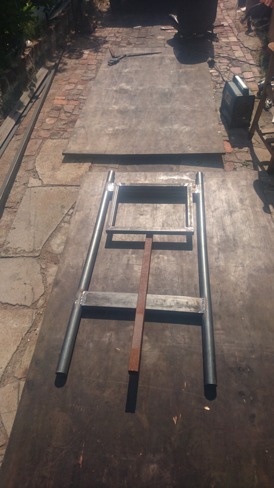

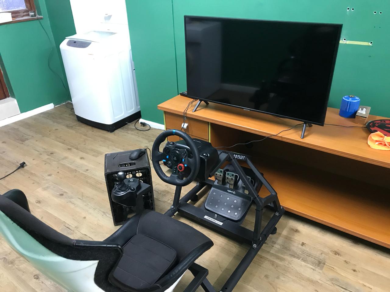

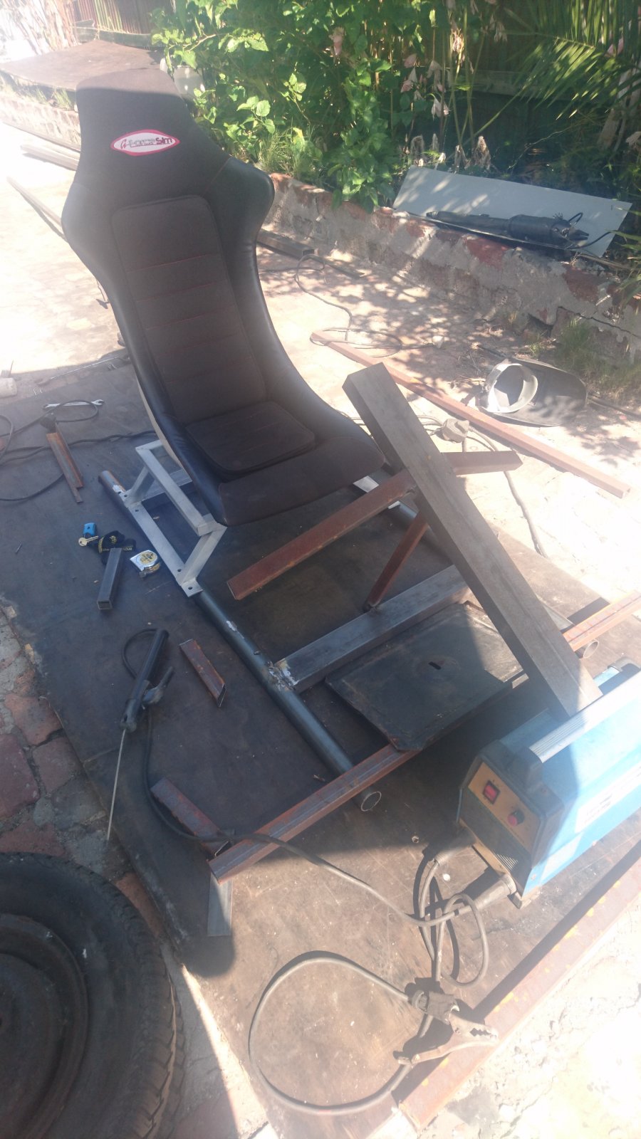

    This was my first design I made, this will be a static rig that will be upgraded to the 2dof gate motor system. The seat base will be interchangeable with regards building another base with the motors integrated under the seat.

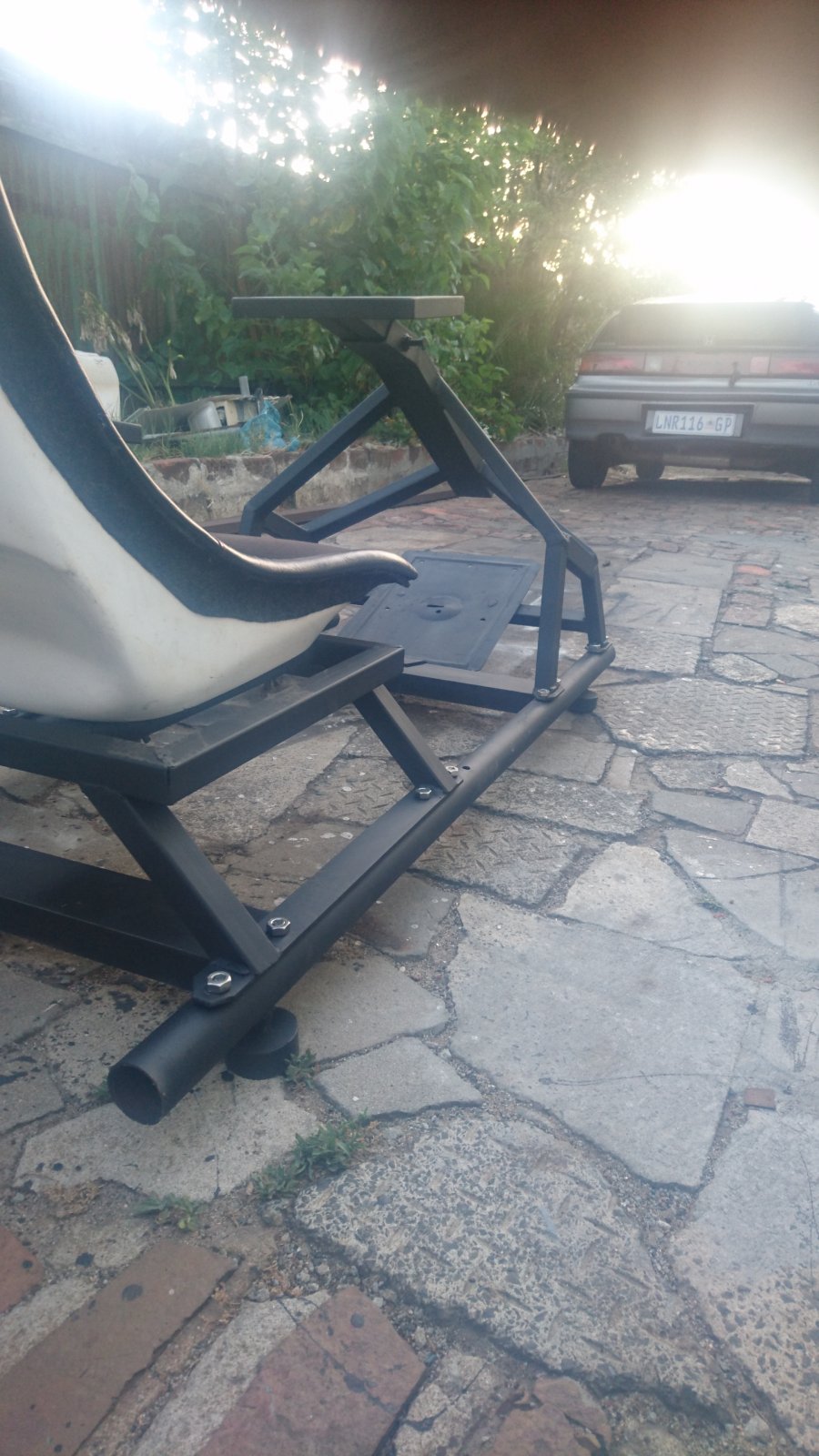

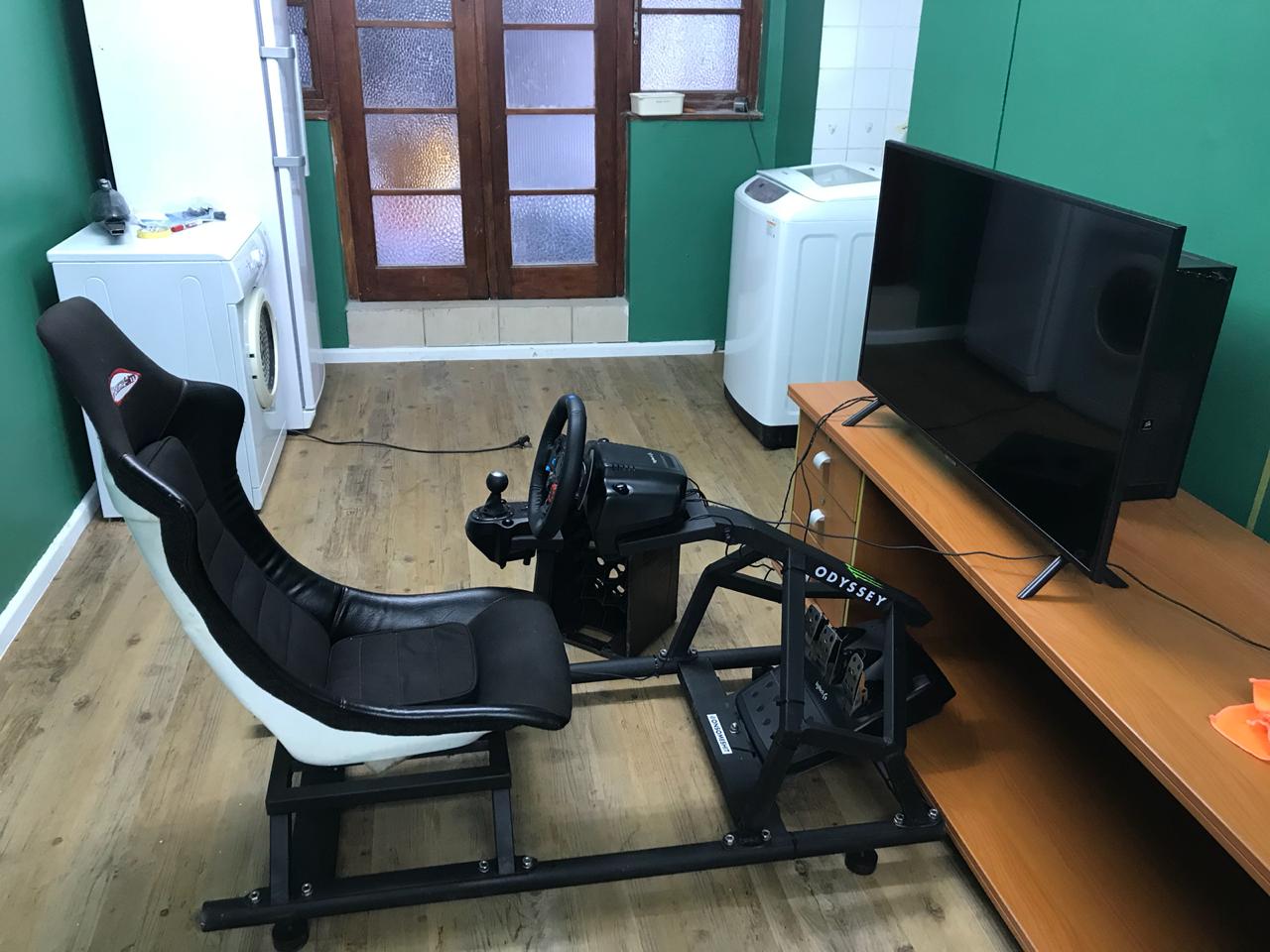

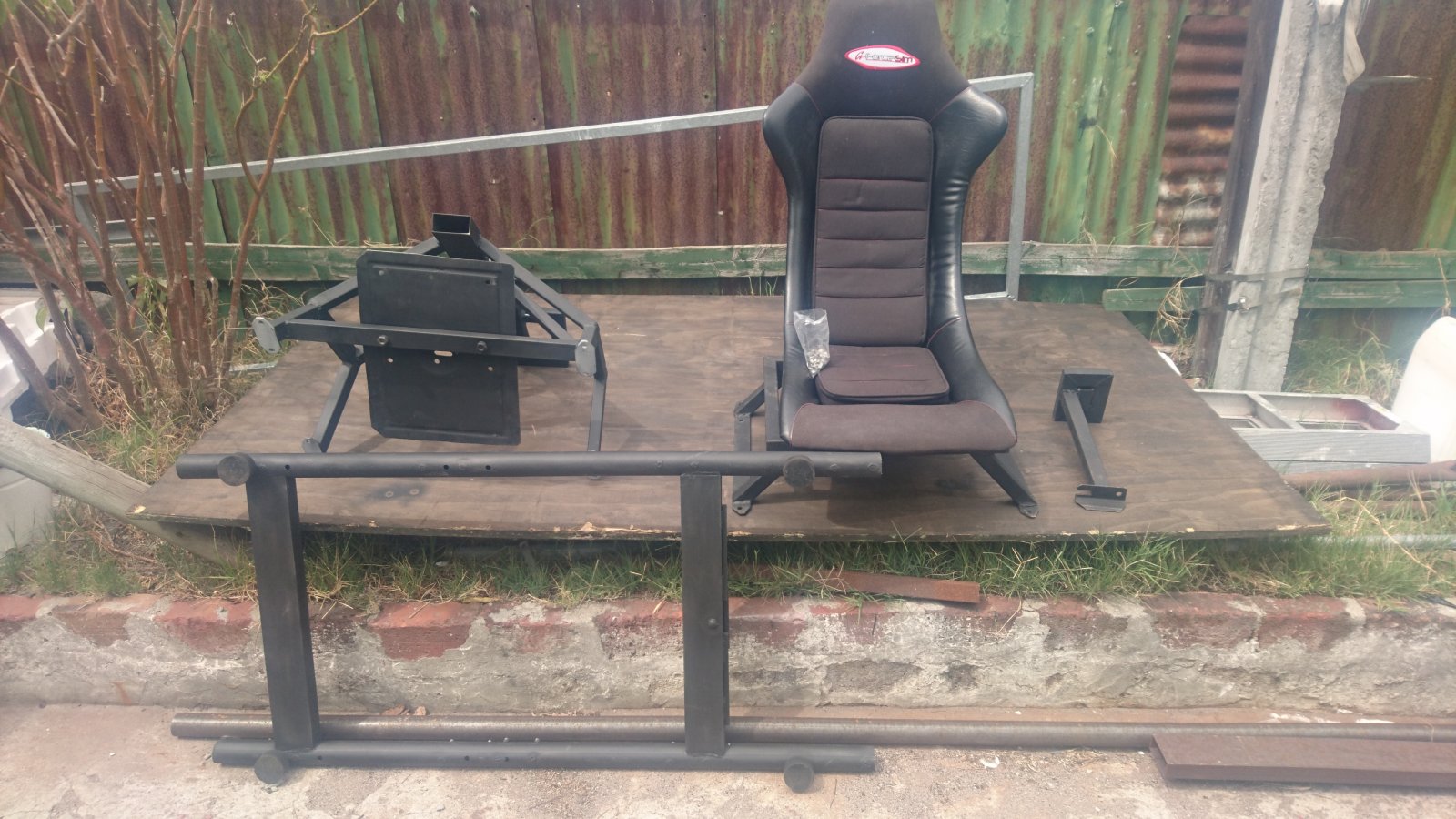

    Fully setup, with a pc system spec i5 4560k 16gig ram with R9 390x
    The feel of positioning feels perfect just need to relocate my shifter and make a cup holder. :thumbs

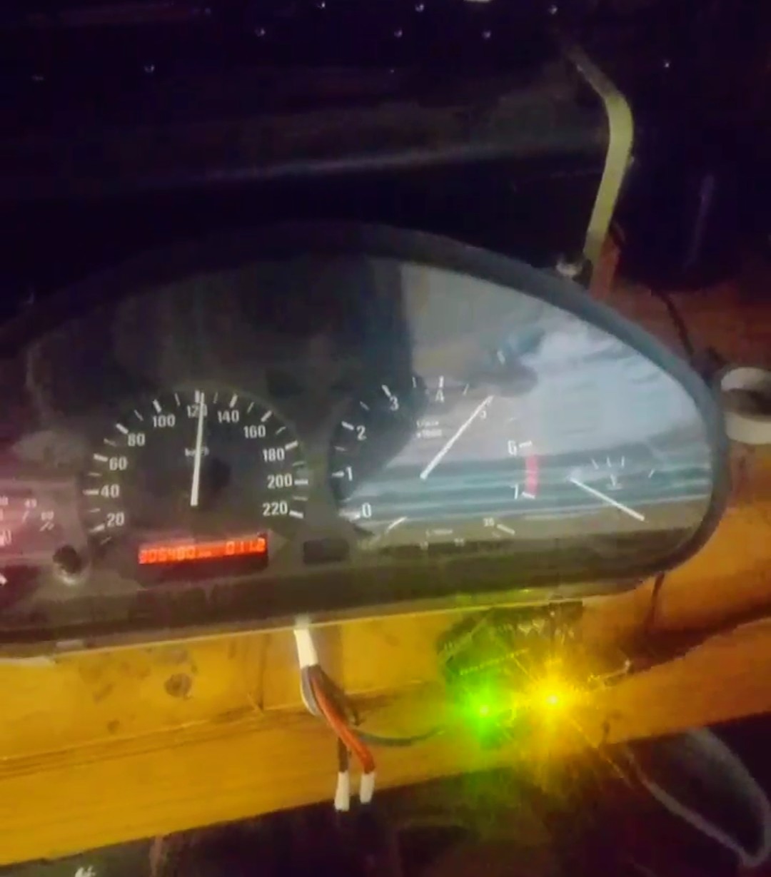

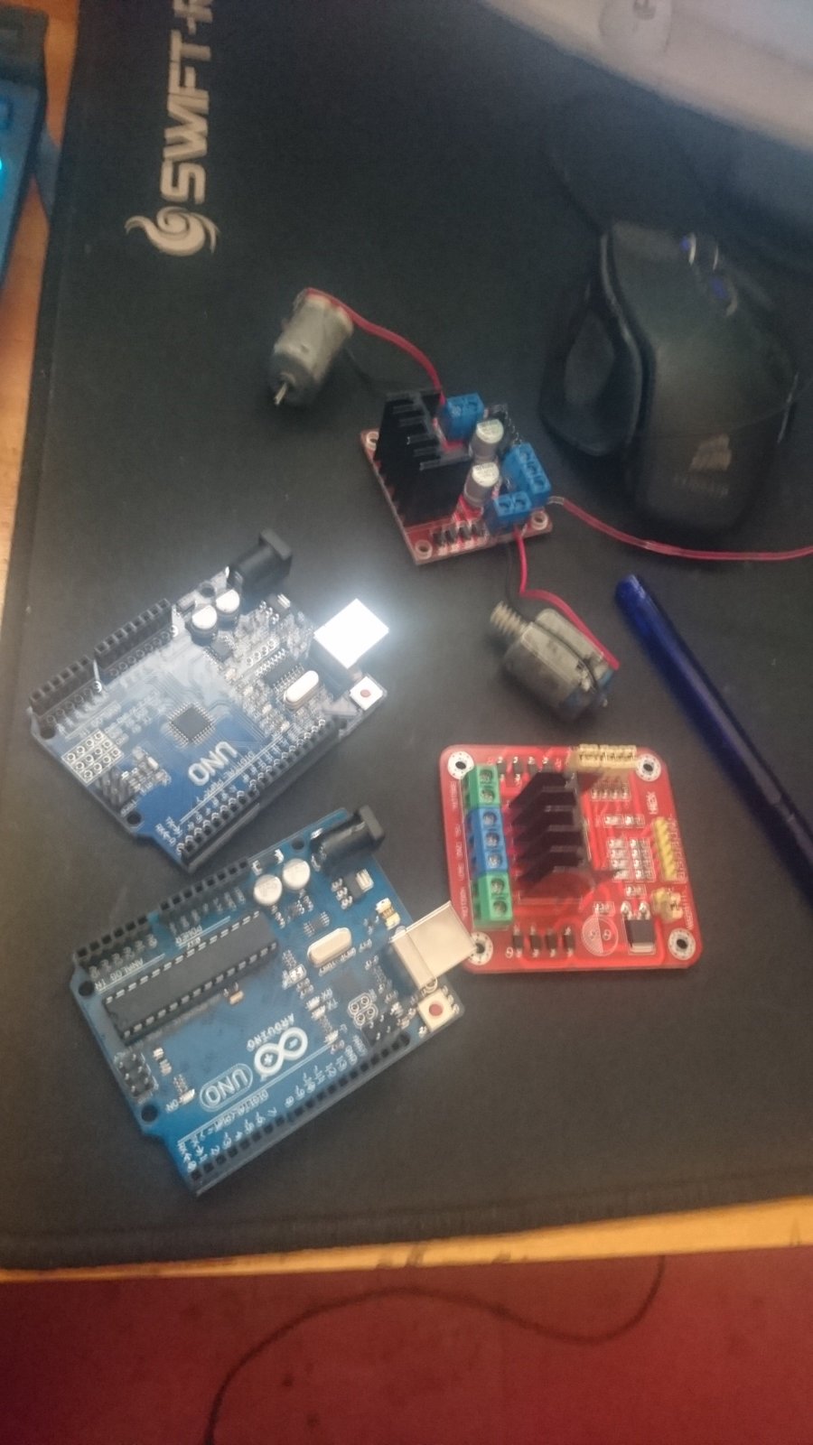

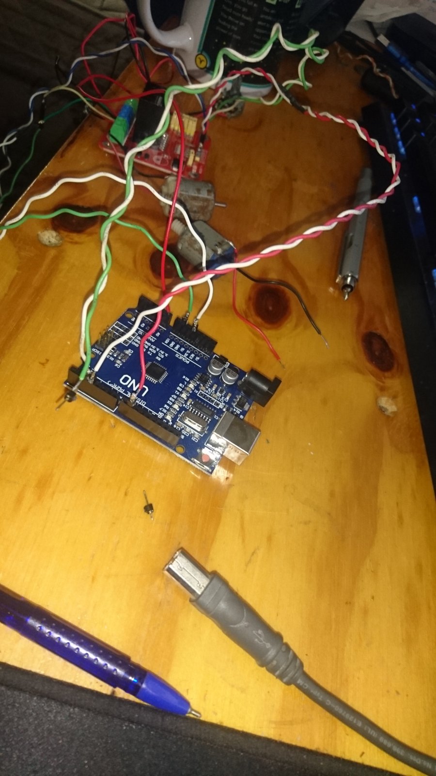

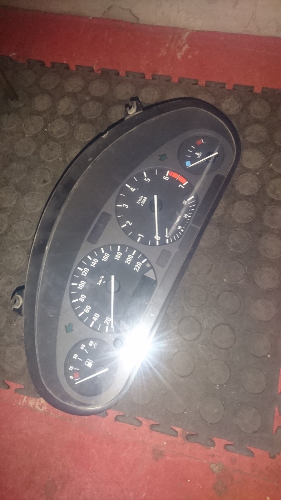

    Arduino and motor driver testing, before starting that gave motor .manage to pick up this e36 cluster for next to nothing. Will get a basic understanding of arduino before motor setup

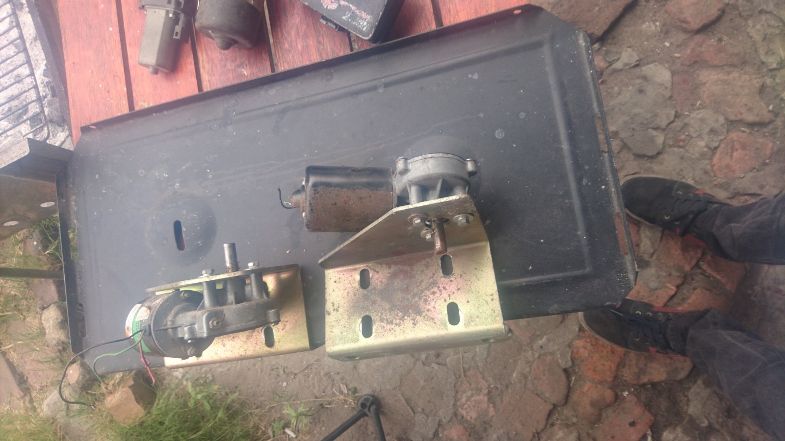

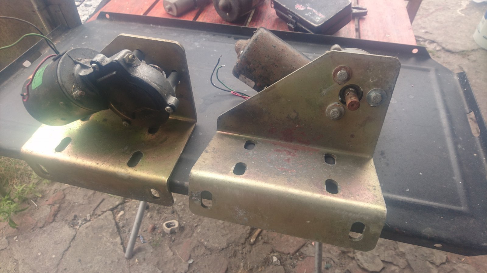

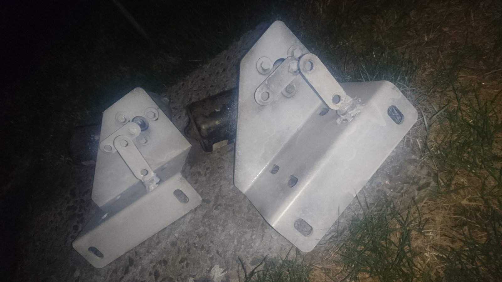

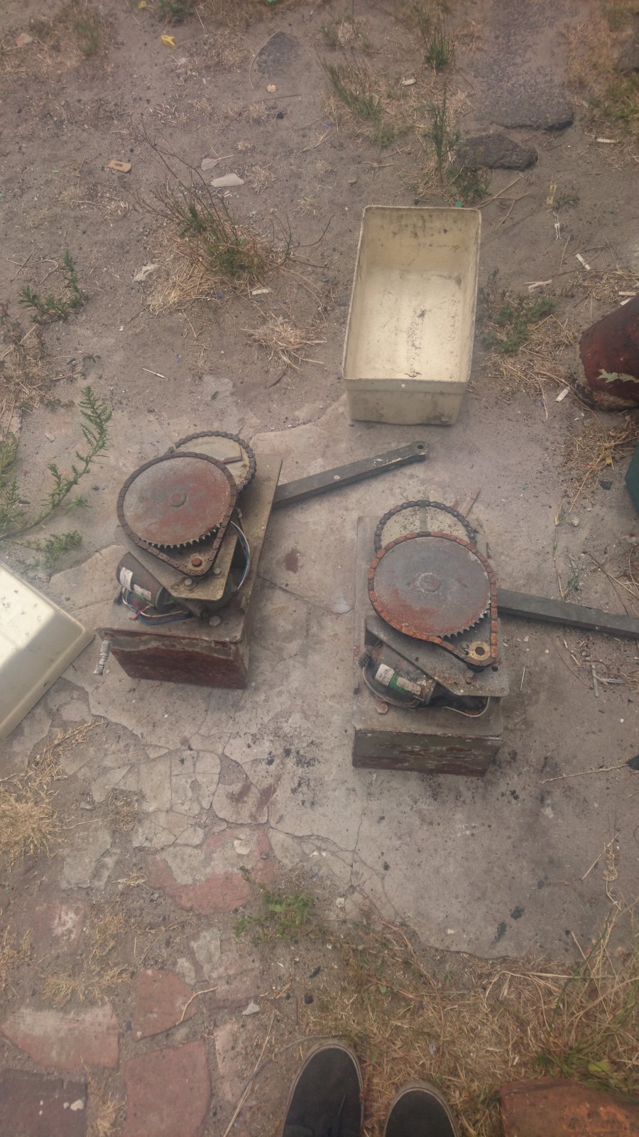

    The gate motors tear down to the motor heads and bracket.
    Finally managed to get the bmw cluster and arduino board to sync with pcars2

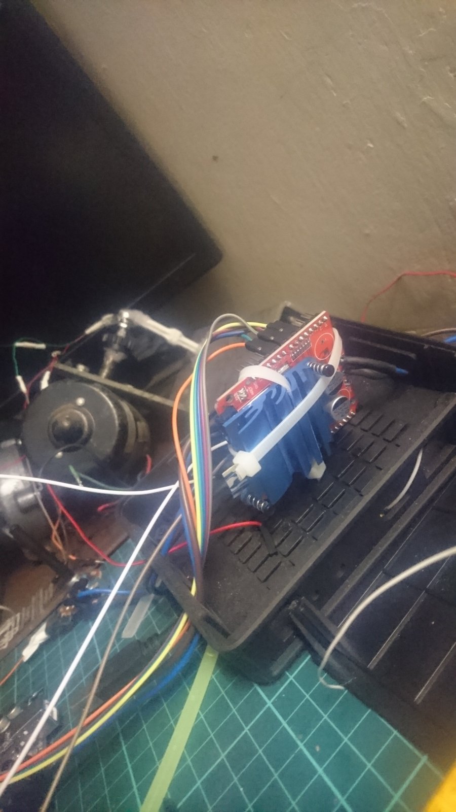

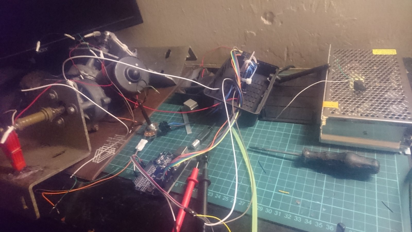

    Recently setup the arduino with monster motor driver, with the two motors.
    I couldn't get any voltage higher than 2.6-3.3v on this unit.
    Then I went back to the drawing board, to find another motor driver unit instead of this monster motor unit. Thinking it can carry 30A operation

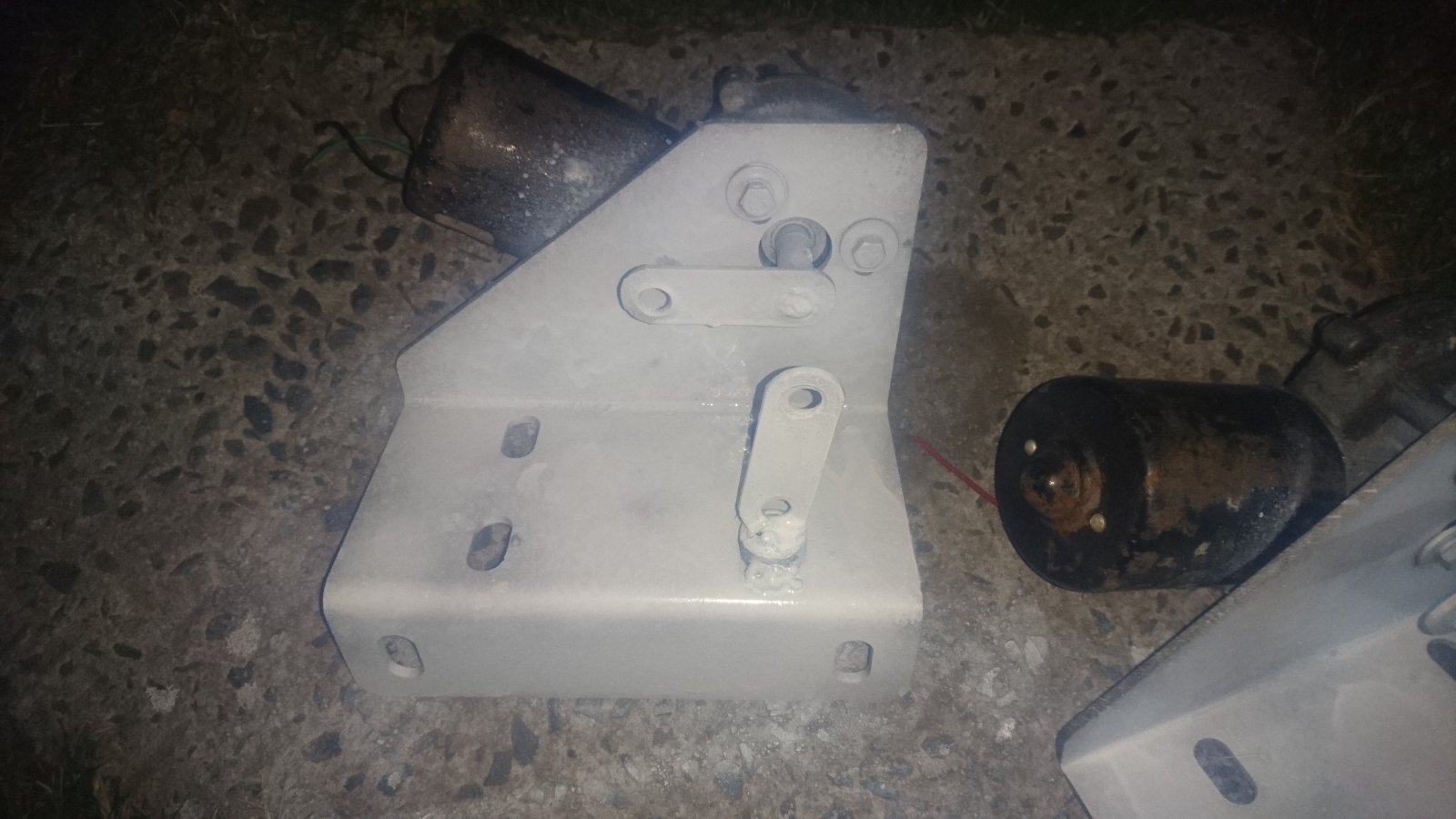

    Some mods done to the gate motor brackets, by welding supports for the pots. Door hedge plates welded on to a nut.
    Working with what I have laying around at home.

    Link to the Bmw E36 cluster that linked to arduino and synced with project cars 2 using simhub

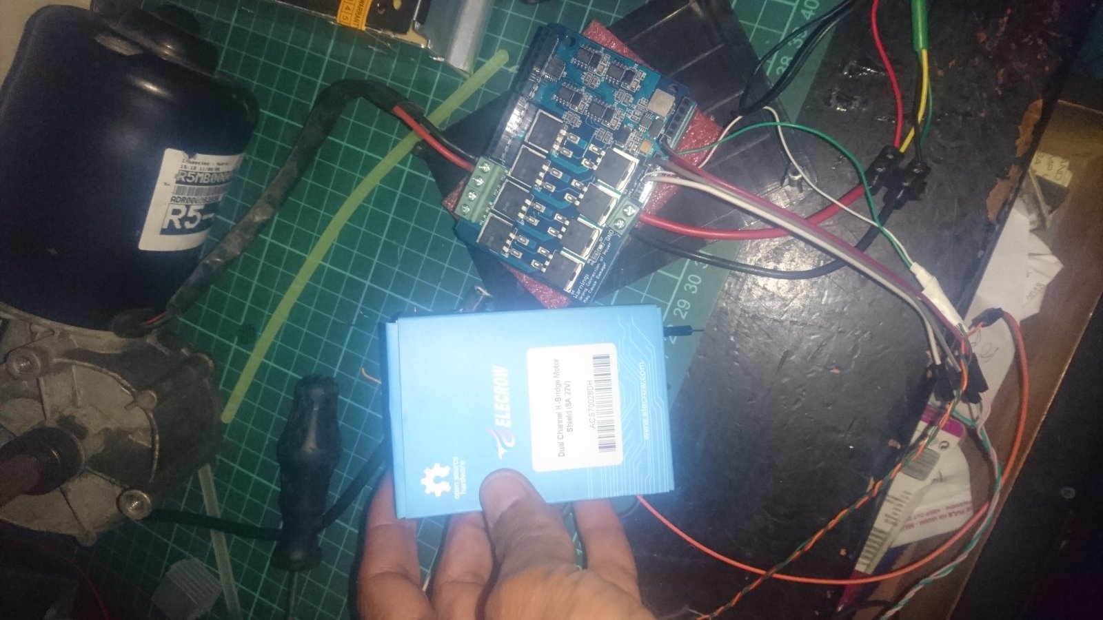

    I recently pop the caps on the monster motor driver, me a idiot wired the power wrong causing the caps to pop.

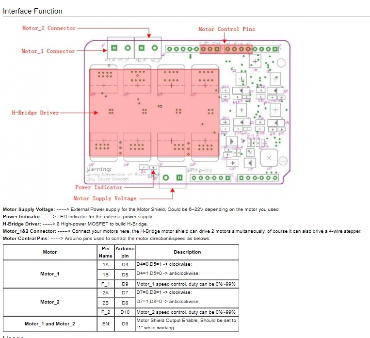

    I went to purchase AZL Dual motor shield 8a 22v, got its setup and worked right away. The problem Im having is the one motor changes direction, but the obtain the motor doesn't it's just turns in one direction
    In Smc utili motor 1 changes direction, motor 2 run one direction. clueless to what could be the problem

    HI everyone
    Here is the link of the setup
    I've managed to get the SMC3utils software to run the motors, I see the one motor turns in different directions but the other motor continues in the same direction.
    Could anyone tell me what could be wrong or is it right the way it's setup.

    Dual Channel H-Bridge Motor Shield
    https://www.elecrow.com/wiki/index....ld_But_Not_Driver_IC_Solution_Such_As_L298.3F
    I noticed the pin config of smc3 and XPID code differs.
    SMC3
    Arduino UNO Pinouts Used
    // 9 - Motor 1 PWM
    // 10 - Motor 2 PWM
    // 11 - Motor 3 PWM
    // 2 - Motor 1 H-Bridge ENA
    // 3 - Motor 1 H-Bridge ENB
    // 4 - Motor 2 H-Bridge ENA
    // 5 - Motor 2 H-Bridge ENB
    // 6 - Motor 3 H-Bridge ENA
    // 7 - Motor 3 H-Bridge ENB
    // A0 - Motor 1 Feedback
    // A1 - Motor 2 Feedback
    // A2 - Motor 3 Feedback
    // A5 - Motion scaler pot input
    XPID
    Pin out of arduino for H-Bridge
    Pin 10 - PWM1 - Speed for Motor 1.
    Pin 9 - PWM2 - Speed for Motor 2.
    Pin 2 - INA1 - motor 1 turn
    Pin 3 - INB1 - motor 1 turn
    Pin 4 - INB1 - motor 2 turn
    Pin 5 - INB2 - motor 2 turn
    Analog Pins
    Pin A0 - input of feedback positioning from motor 1
    Pin A1 - input of feedback positioning from motor 2
    I havent tested the XPID code yet, as im sticking to Simtools but browsing thru the different codes i noticed pin6 on SMC3 is different on XPID being pin8.

    Has Anyone a link to understand the grounding of the motor as i figure why the one motor surges during calibration.

    @noorbeast Evens Grounded the motor i still get the same response the surge in the slave motor
