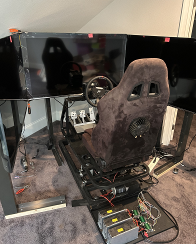

  5. Richard Ortengren
    Richard Ortengren Florida Racing Fan Gold Contributor
    May 14, 2022
    49
    Builder
    Florida
    282Coins
    +14 / 0 / -0
    Awesome! I just finished my 55" triple setup with a similar type homemade aluminum stand. Issue I'm trying to figure out is how to attach the monitors to each other to align the corners and close the very minimal bezel gap. Right now I'm using a long quick clamp and some duct tape on the back, but I would really like to find a more elegant solution. Thinking of maybe making a mold of the top and bottom where the monitors come together, scan it and 3D print something I can attach top and bottom and maybe connect the two pieces with an aluminum extrusion or something. How do you plan to deal with the gap?

    Sorry, here's the pic:

  11. Richard Ortengren
    May 14, 2022
    49
    Builder
    Florida
    282Coins
    +14 / 0 / -0
    So far I've never heard my psu's ever go above idle. I'm running (3) 60A 12V psu's, one to each of the motor controllers. I got them on Amazon for $27 ea.

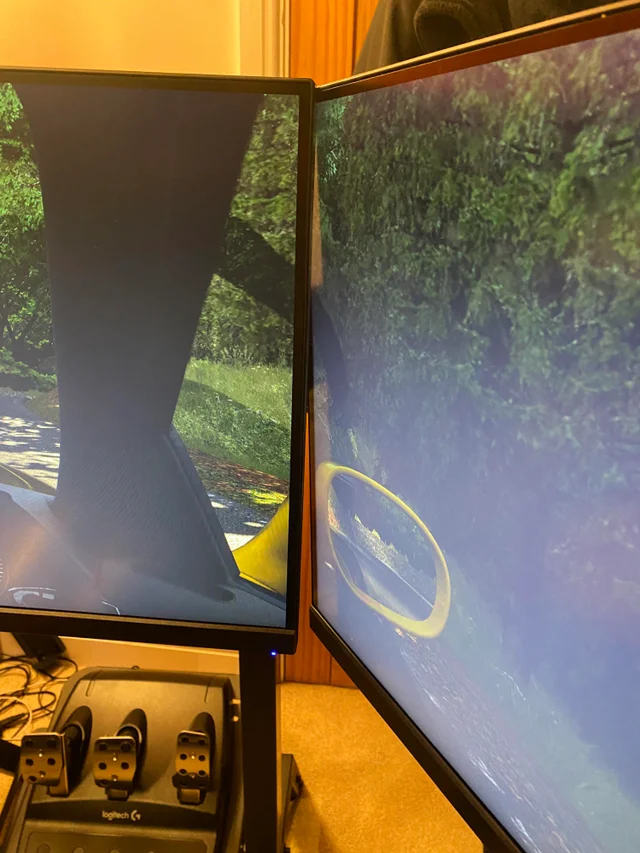

    As far as the bezel gap, it is a function of the size of my panels, they are 55". I have the tvs mounted to .125" vesa steel plates screwed to aluminum 2"X5" rectangle tube but there is still flex in the swing arm hinges and movement in the TV's as they weigh about 33 lbs each. So as a result the bezels look something like this (not mine but a good example)
    As I said, right now I have the clamps and duct tape. It works but not pretty. I thought I could just add shims under the outer arm supports and behind the vesa mounts until I get it exact. However, if I move the rig, it goes out of alignment again because the carpet/floor is not perfectly uniform either. I was just thinking it would be good to somehow affix the monitors to each other where they intersect to make the whole job of alignment easier with a triple setup.

    Ah ok, i see now you are already using Vesa mounts (ignore the suggestion in my other comment)
    Yeah the mounts are stong enough for my use because I only have 27inch screens. Your 3d printed idea is probably what I would do if I had access to one.
