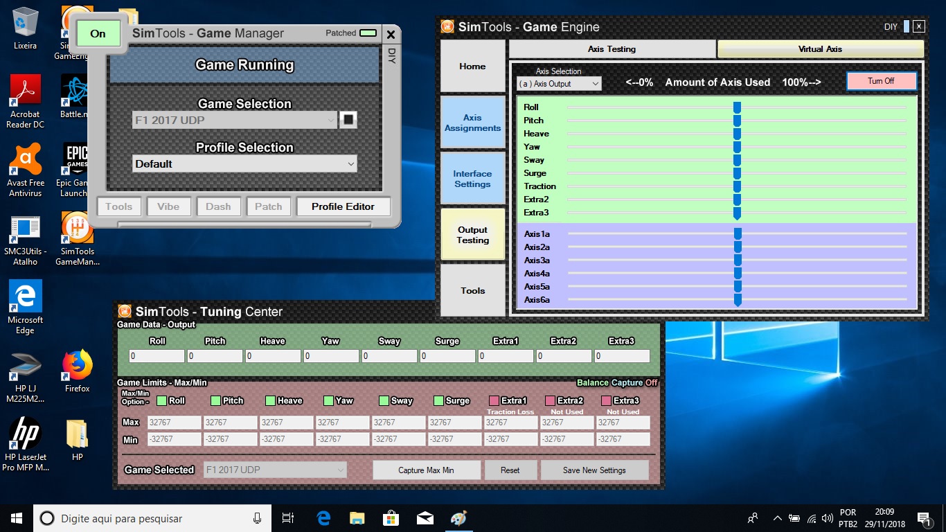

    Does this version work with XBOX ONE?

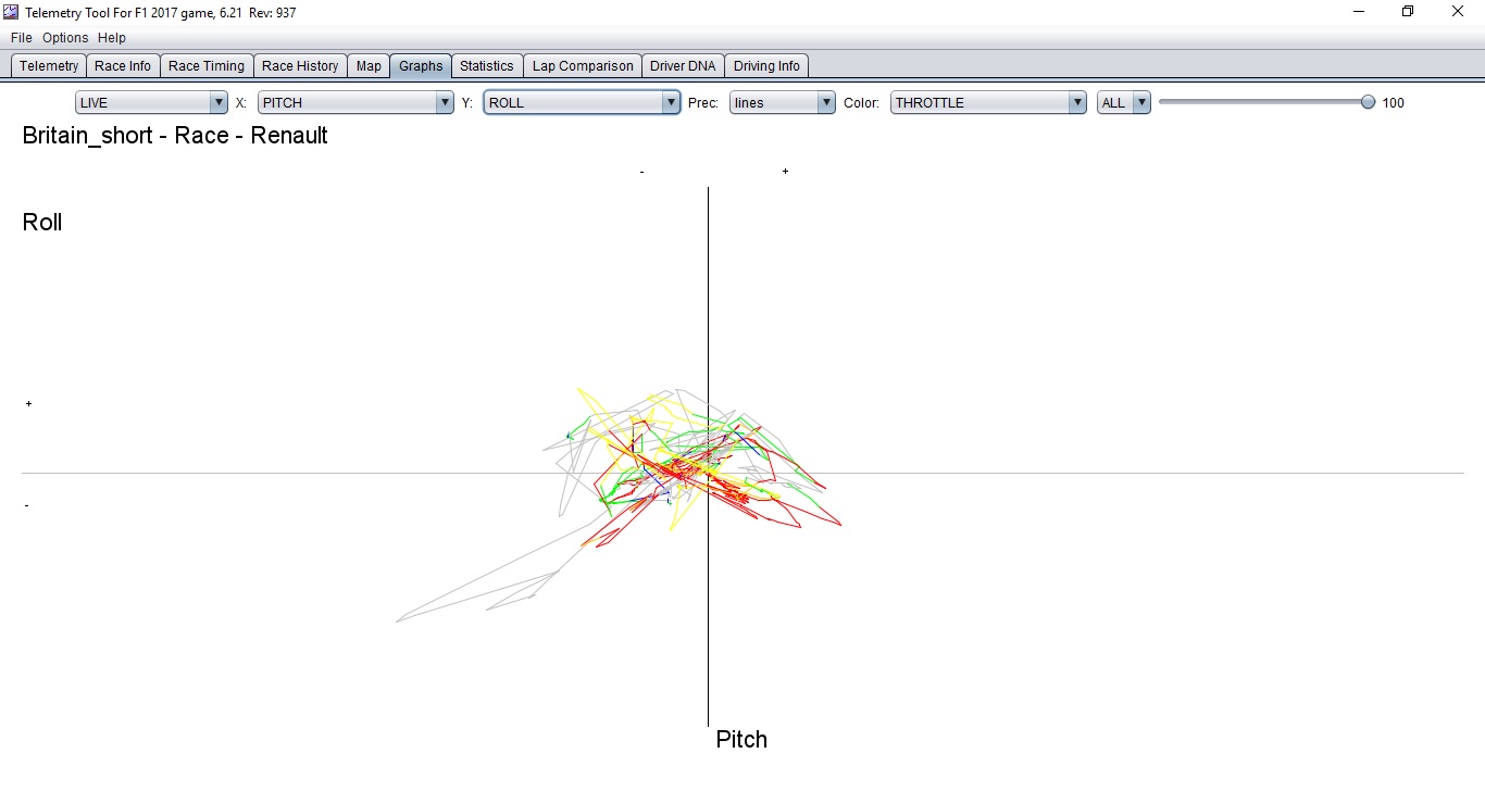

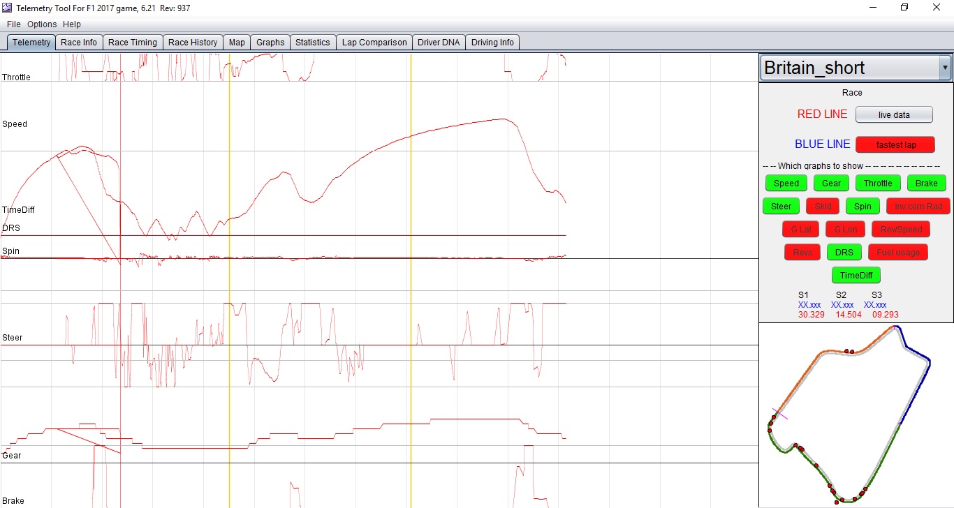

    Can I use the telemetry of the game in XBOX and through the notebook use the simulator?
    I configured my XBOX ONE to send telemetry to my notebook.
    I can read the telemetry: (this images is in notebook)
    When i use SimTools the game is connected, nothing happens neighter in the axis or in virtual axes.
    what is missing? Can someone give a tip?

    My guess is the port is wrong?
    Using port 5606?

    Hello !
    I´m using port 20777.
    tomorrow I'll change and try. Thanks for the tip !

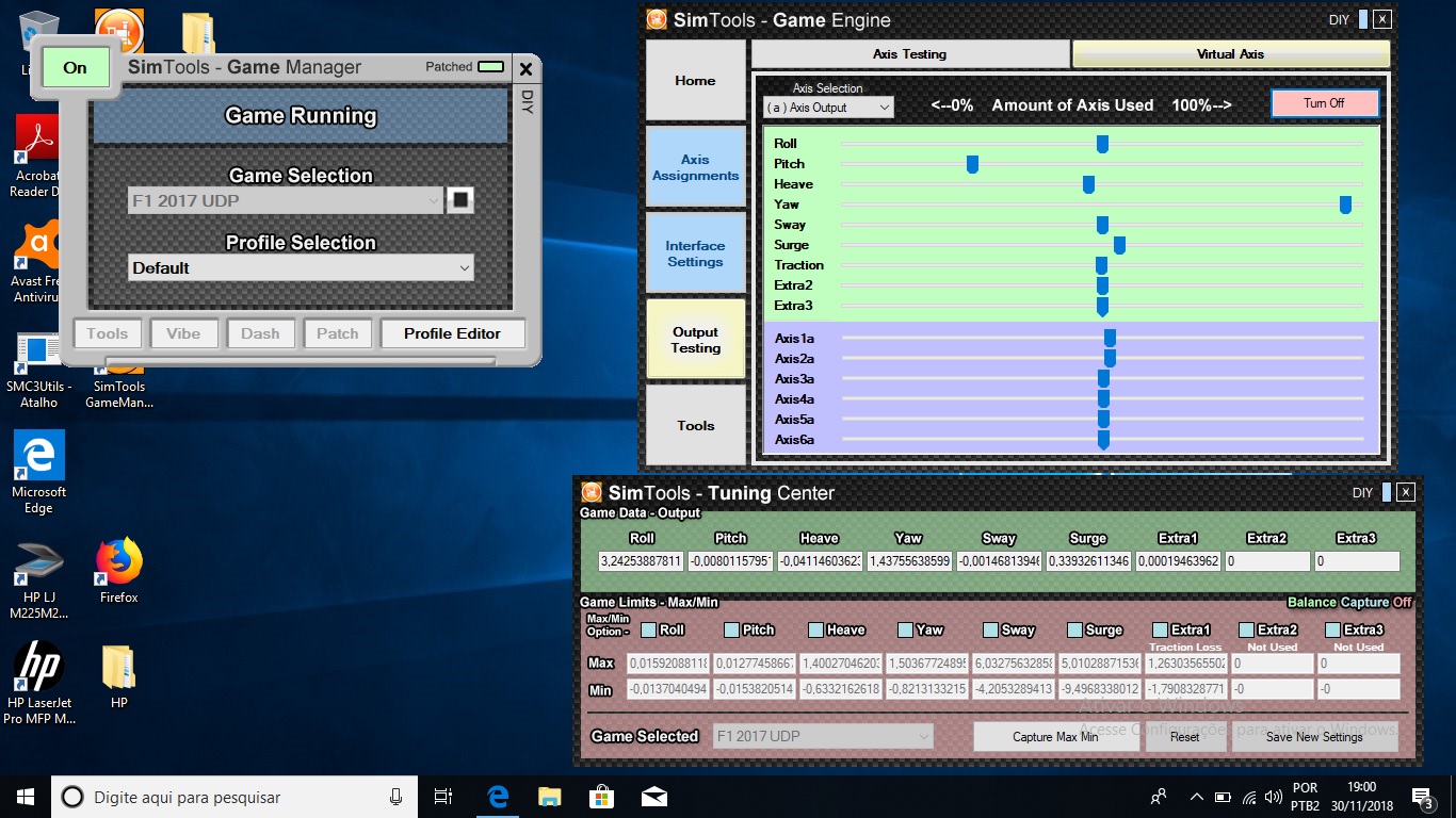

    Its working !
    Thank you @youbuddy !
