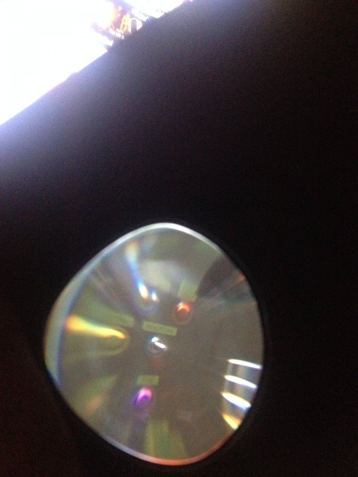

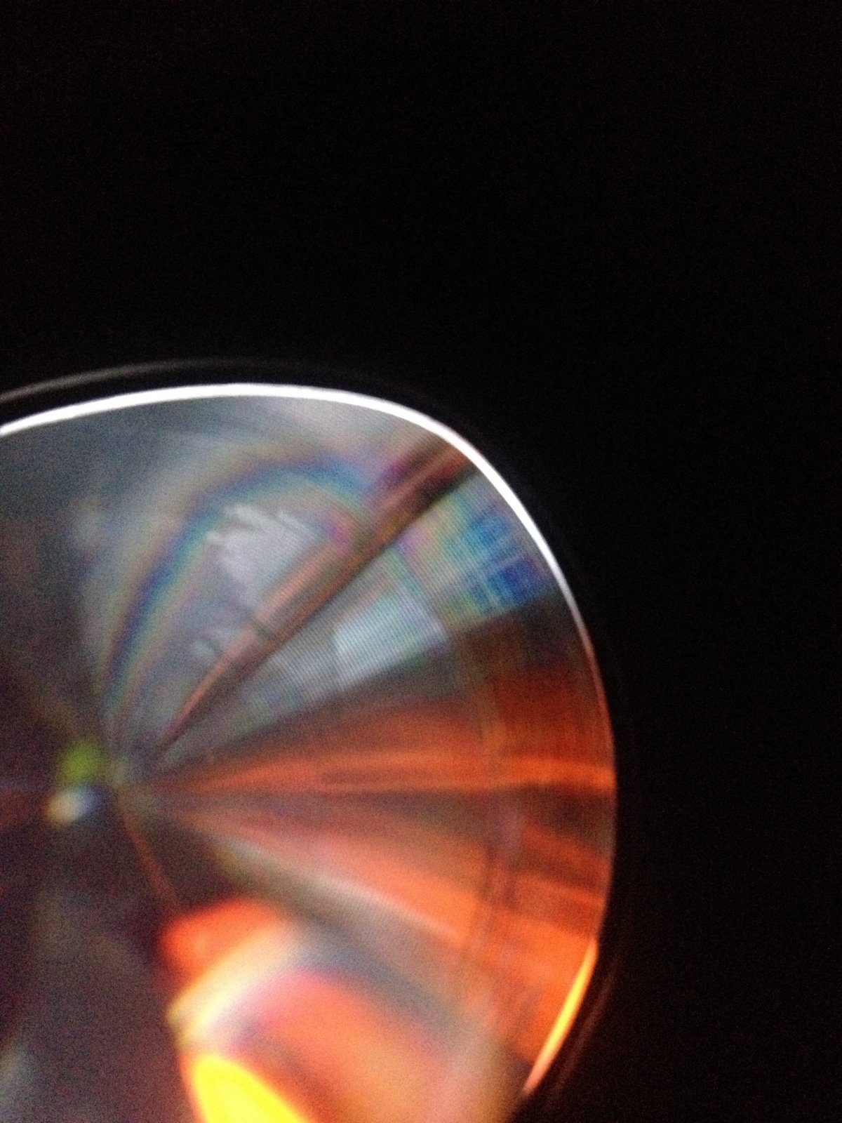

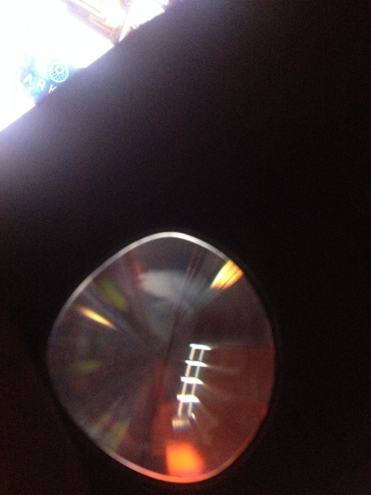

    lense issues tbh is my main problem.
    heres some pictures of it and its terrible i can not play the games its too distracting to me.
    where my dk2 as this dk3 is not right ! lol
    i also get the black screen with red bits that float n eve valkarie is terrible on the part where you select the male female.
    im going to my friedns as he recevied his aswell so will test out to see if its me or the head set or computer issues.
    i think the lenses are marked from maufacture but could be condensation but if that the case there nothing i can do i will prob go back to my trust dk2. nq9ms4nn8tvr.jpeg fxb07frku3r7.jpeg dtvv6odf4rib.jpeg

    so would you say my picks of the lenses are normal with in consistant groves which is causing wishywashy more as misty patches.
    20,959
    147,470Coins
    +10,865 / 54 / -2
    Photos are not great for optical diagnostics @f1iceman.
    The Fresnel grooves should be consistent. The actual perception of optics depends a lot on the adjustment, what is being viewed and physical individual characteristics of a persons head and eyes.
    With the Rift you can adjust the straps, the IPD and the tilt of the HMD. Even with perfect adjustment god rays will be evident, particularly with white text on a black background.
    You can minimise the effects of pupil swim by moving your whole head and not just your eyes.
    Oculus does have a testing tool and procedure, which I understand includes taking particular types of photos, but you will need to get directions from them.

    i think the first one shows it preety clear tbh the diffrent groove cuttings.
    and the rest of the pics the patchy look in exactly the same place but certainly looks to me a groove issue.

    To get rid of the god rays pull the headset further away from your eyes. Its not nearly as bad as your photo illustrates although it is there in certain titles. When you pull the headset away it adjust the focal length and should assist your eyes with god rays. Some additional foam will do this nicely. I have done it.
    another option is anti glare glass lenses like my prescription has. THis helps to eliminate this as well. Just like it does on a windshield at night with car lights.
