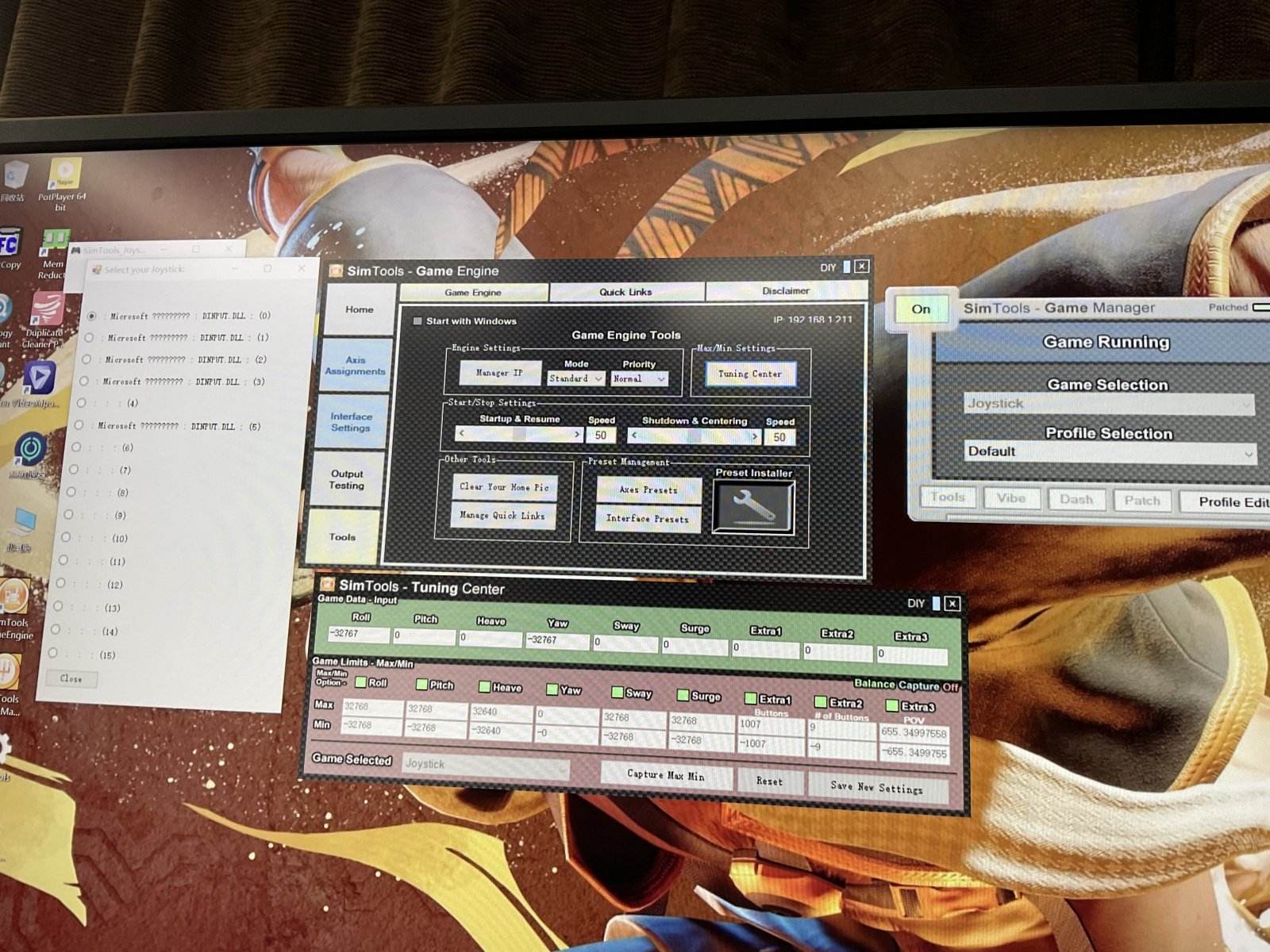

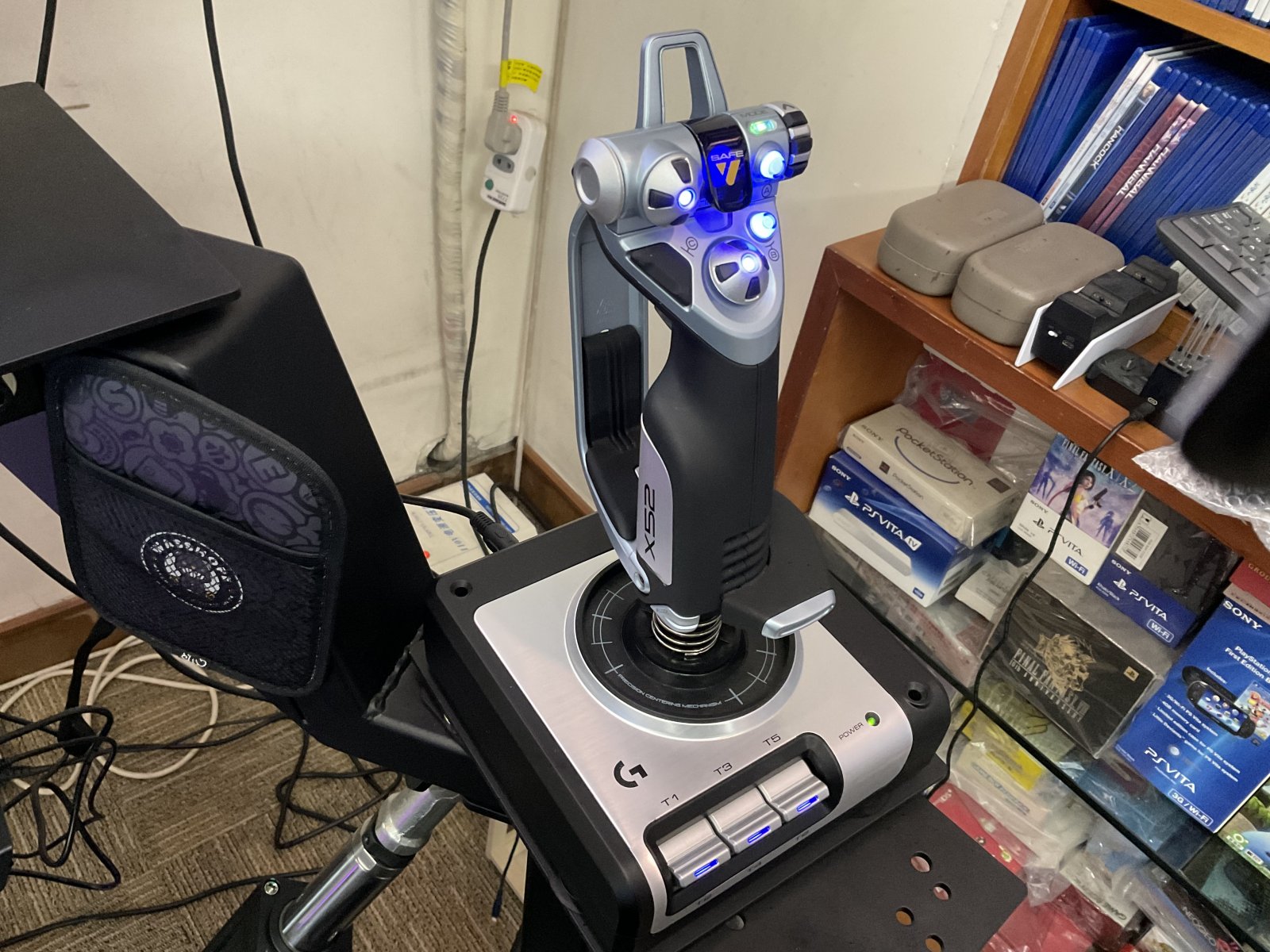

    my friend, I have bought the top rank membership and downloaded the joystick plugin. after installation and patch, but still failed to recognize the Logitech X52 (flight simulator joystick). Further, I have tried the Vjoy u recommend, still failed to recognize. Any further suggestions? Thank you very much!

    At what point following the instructions does it not work:
    How to use:
    Run GameManager in Admin mode.
    Select the "game" Joypad.
    Patch by selecting the installation directory of SimTools.
    The patch installs a program "SimTools_Joystick.exe" and "SimTools_Joystick_Recorder.exe". These programs do nothing than trigger SimTools to read the Joystick values.
    Run GameEngine & GameEngine.
    Run SimTools_Joystick.exe or – if you watn to record the data – run SimTools_Joystick_Recorder.exe.

    Are the values present in the TuningCenter? Can you please post a picture.

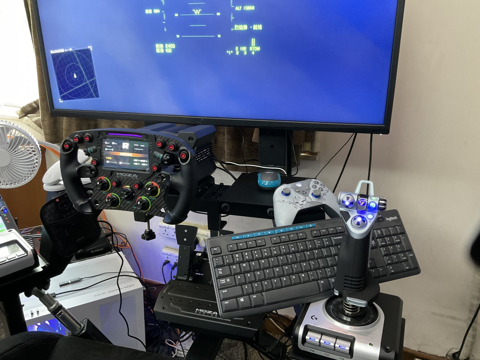

    Thx for the prompt respond. Attached please find the photos for ur reference. There is only one value of Roll and Yaw present in the turning center. And the value only present at opening joystick plugin, but afterwards the value fix as shown in gaming no matter how I try. Mouse game pad and X52 function properly but only 6DOF (Chair) no respond at all. Thx!

    @yobuddy do you have further insight as to why only Roll and Yaw values are present with the Joystick plugin?

    I have never seen the plugin only get partial values.
    Seems like a conflict of some kind?
    What happens when you use the 360 gamepad?

    ah…we don’t have 360 gamepad but xbox one gamepad. I can use gamepad to play the game but the 6DOF Chair has no respond at all. No idea why….Thx
