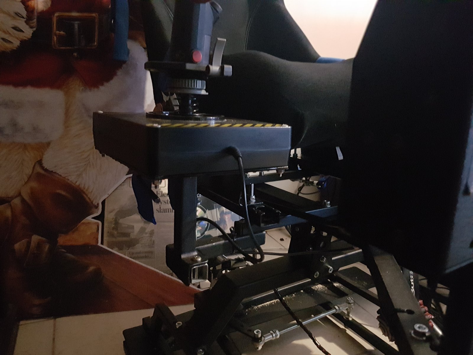

    So, my P3 arrived and it was a very smooth assembly. I'm looking to mount all or my controllers (for racing & flight), but having an issue. I can mount the steering wheel, shifter and the thruster controllers on the mounts provided. For the flight stick (I have a Warthog HOTAS), appears that the only place to mount is in front of the seat? The bracket with the flight stick interferes with the steering wheel. So, my question is, can all the controllers be mounted at once or are we supposed to swap around?

    Have a look at my rig i have custom mount the flight stick as there was only one hotas bracket supplied.

    The mounts for the HOTAS were provided. The problem I'm having is that the stick is mounted under the steering wheel and there's not much wiggle room to adjust.

    That's what I was looking for to mount the stick on the opposite side of the thrusters. Any chance you could share the design of the custom mount?

    Its very basic just a L bracket with a plate the saame size as my flight stick mounted from the bottom of the seat base bracket.

    I also modded it by changing the bracket so the supplied bracket fitted inside the L bracket so i can remove or adjust it so i can get in the sim rig.

    Let me know if you need more pics as i can remove it to show you what i have done.
