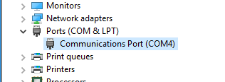

    I just received my DOF Reality P3, put it together and works great.
    I have little experience with it, but I was able to set it up with Assetto Corsa and RF2, tuning it to my liking for each of those 2 sims, it is amazing.
    So first thing first: The Device Manager on your PC ( BTW the rig does not do any initial jerking when you plug it in).
    Before anything, you must see the following under your Ports (COM & LPT) (it could be a different COM#, does not matter):
    If you don't see that, then you have a problem and need to contact DOF Reality.
    Before we go any further, let me know if you see that on your PC.

    I'll reach out to them. I've tried so many things and there's no detection and no output. I do see the COM port on device manager (and I've already uninstalled/reinstalled it). Doesn't refresh or change when I plug in the rig.
    Forgot to mention I've also tried the SMC util and set it to COM4 and the program couldn't establish a connection as expected

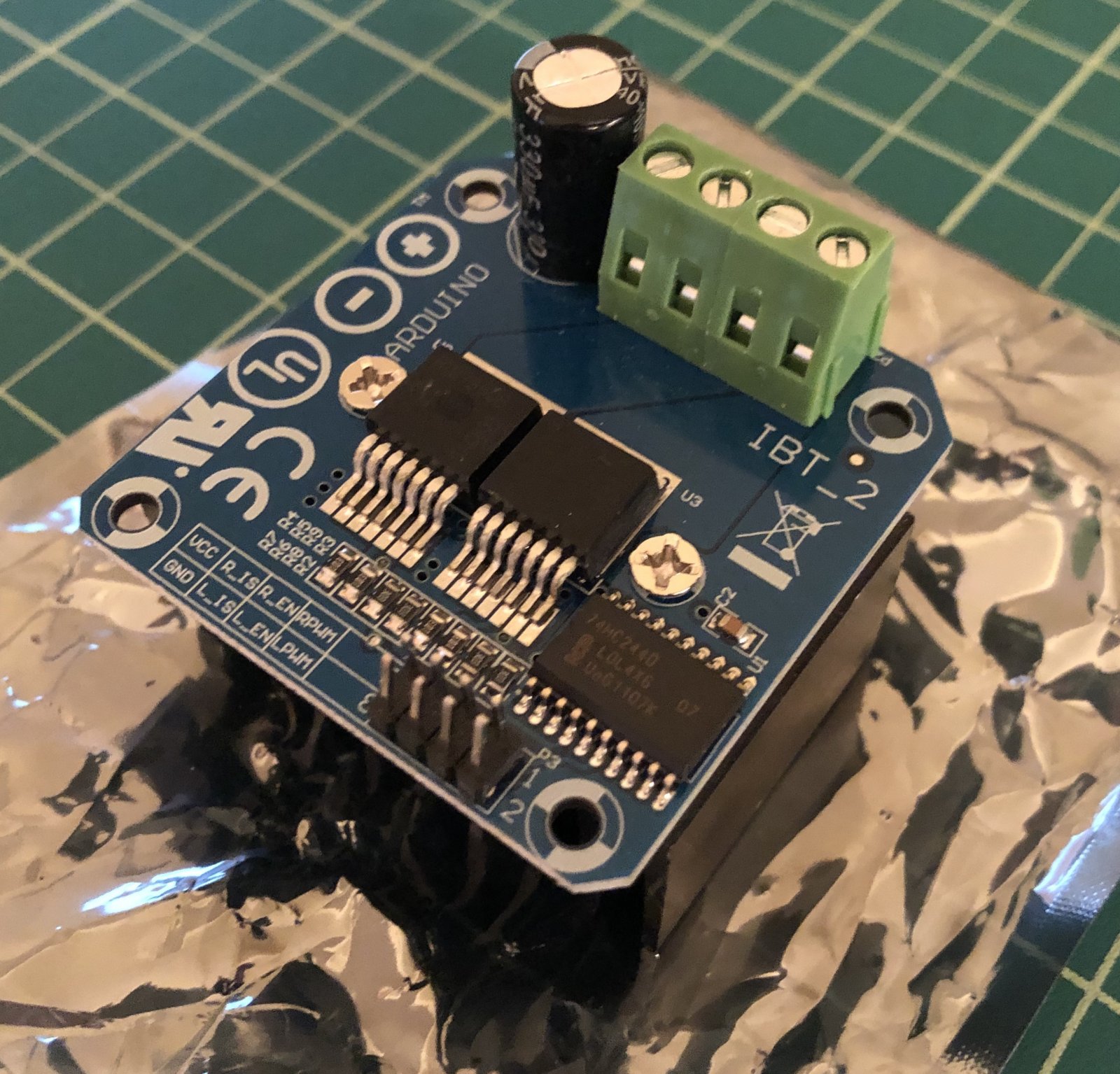

    Ended up opening the box and checking the wiring... Found out the Arduino was only turning on when the power supply wasn't plugged in. Only when the USB was connected to the Arduino and the power supply was unplugged would the Arduino turn on. Which meant something was stopping the Arduino from getting the power from the power supply when it was plugged in. Long story short, it had to do with grounding: I loosened the screw holding the arduino to a metal board and finally worked. There was a bit of excess soldering around there and I scratched it off which I believe was causing the grounding issues and finally the COM device for the rig was detected on my PC. No USB power hub needed.

    With the help of customer support, I did end up figuring it out. The whole process ended up frying a $7 part of the 3rd motor though, but they're send me a new one free of charge since it likely happened due to the other issues I had. Now on to developing for the rig with the Unity game engine!
