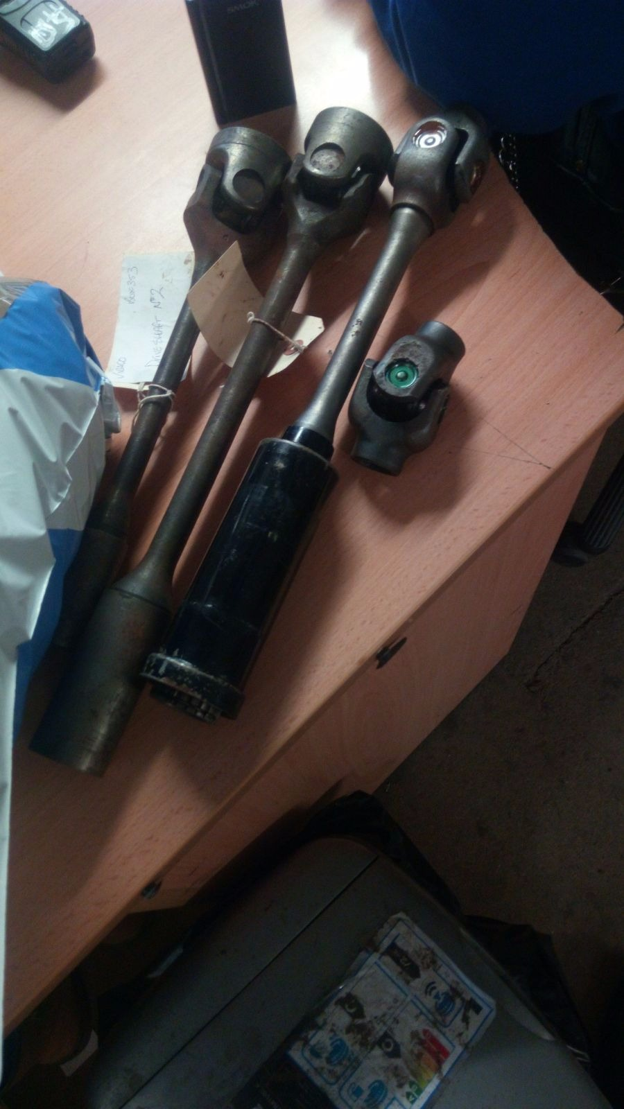

    So far i have
    2x --jrk 12x12
    2x 200watt 50:1 motors actually have 6 of them lol
    psu 12v 500watt 40amp
    Shafts are from a Yamaha Virago and I believe a Honda NT500
    Going to build 2 different 2dof 1 seat mover and 1 chassis mover
    Links are simple motorsport adjustable light weight links
    Have larger ones for seat mover
    Just waiting on Aluminum Proile to show up for the base of the chassis mover.
    Been talking to the grand master eaorobbie To get this project going and Finally should be done middle of next week..
    So get ready for loads of How do i do this and how do i wire up that

  3. SilentChill
    2,643
    20,562Coins
    +3,489 / 34 / -0
    good start :) however that UJ looks very thin ?? :eek:
  4. exiledslinky
    exiledslinky Member
    Feb 1, 2017
    33
    Edinburgh
    334Coins
    +29 / 1 / -0
    2DOF, DC motor, JRK, Motion platform
    I assure you they are up to the task.. :p
