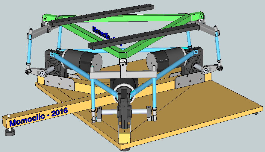

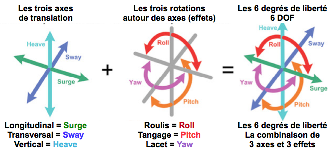

    Carry an automobile driving simulator, airplane, etc. 3DOF kind of manager swell (vertical translation). It is useable with interfaced PC games for this.
    The degrees of freedom driven by electro-mechanical:
    • Roll (effect "roll")
    • Pitch (effect "pitch")
    • Swell (axis "heave")
    Other degrees of freedom will be produced, simulated by artifices managed by the software. These movements will be added, or not, to the axes or effects of the simulator to try to feel what the machine can not do by design.
    Degrees of freedom (DOF) axes and effects

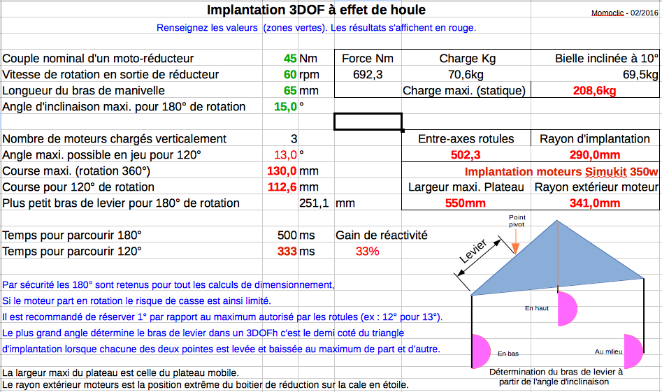

    One of the most effective ways to manage the degrees of freedom is to motorize using cylinders. The form of energy easier to implement for the amateur is electricity. There are electric cylinders but these are expensive or difficult to achieve. For these reasons, we will use for this building the SimuKit 3DOF 350w with 70mm crank arm length. The electric motors will replace the cylinders using a connecting rod-crank system. This system has the advantage of being economic to the drawback of not providing a constant speed of vertical movement of the connecting rod. However, experience has already demonstrated the effectiveness of the mechanism.

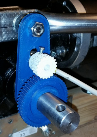

    In the kit we have, among others, three gear motors that rotate at 60rpm and provide 45Nm consuming 350 watts each.
    To animate our games and our simulator we recommend the use of SimTools. This software runs on the same computer as your games and pilot the simulator via a single USB cable. You will find this program and explanations about " www.xsimulator.net ".
    About our stops at the design and implementation of the mobile platform of the simulator and its engine. This means that anything that is likely to be installed and attached to this plateau is to imagine and design by you. We just make a few comments and recommendations thereon.
    The main features of 3DOF simulator that we retain for this achievement:

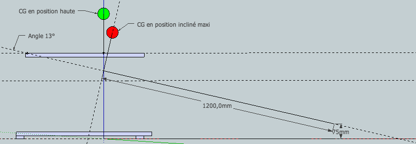

    • Tilt angles involved: + 10 ° (20 °)
    • Rotation angle of the cranks in game: 120 °
    • Cranks with 70mm arm length
    Note: For security reasons, to avoid any breakages, cranks have the ability to rotate 360 °.

    The maximum angle that can hang this 3DOF is determined by the inclination of the seat plate. The movements of this plateau here exclusively vertical, is provided by three connecting rods-crank teams. Each of these rods calipers is driven by a gear motor with worm and both directions of rotation. In a sense, you go up the other goes down. The high ball three rods form an equilateral triangle. The rotation of the motor raises or lowers the rods independently of each other. Each connecting rod is linked to one of the triangle points and according to its movements inclines more or less the tray. If all three engines up or down together we obtain the vertical effect. The combination of movements of these three axes allows us to simulate, in part, the behavior of a vehicle.
    The electronic and computer part:
    The movements of the simulator are calculated using information provided by the game running on the computer and communicated to management software simulator (SimTools). The latter, through the USB port, information map controllers. The controller card (Arduino) drives the gear motors "in position" using the power cards (Sabertooth). The potentiometers inform the controller board on the position of each motor. During the course of an action, according to information received from the game and those received from the potentiometers sending a controller board position correction signal to each of the motors concerned.

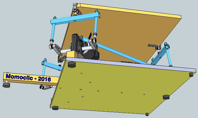

    The axis with 3DOF heave:

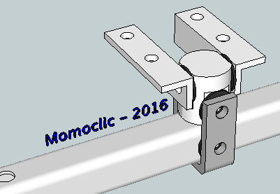

    In this concept, the levitation of the movable part of the simulator is provided, the kinematic point of view, for an equilateral triangle. At each of the points of this triangle there is a mechanism, over a limited travel, of lowering or raising the platform.
    • If the three mechanisms working together, as the case, the movable portion rises or descends. We run here, and the axis "swell".
    • If both mechanisms are stationary and the other one is, then the platform tilts and generates, according to the activated tip of the triangle, an effect of "roll" and "pitch".
    • If a mechanism is motionless while the other can move independently from each other upwardly or downwardly, we thus have another means to cause angles taken. In this case too, the effects of "roll" and "pitch" are activated.
    Notes that with this system we are able to take a same inclination angle of the 360 ° of a circle on the horizontal plane

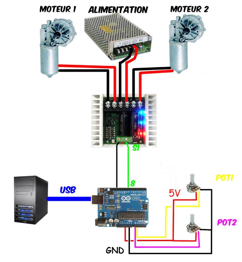

    Composition of SimuKit 3DOF 350w ( Kit developments might you find here )
    • 3 Geared worm 350W
    • 2 Cards "H bridge" Sabertooth 2 x 32 amps (which leaves the possibility of adding, for example, another motor for the yaw effect!)
    • 1 Power 24 Volts 42 Amps
    • 3 Potentiometers FCP22E
    • 9 female heads M10
    • 1 micro-power controller Arduino UNO R3
    • 1 USB 2.0 cable 2.5m
    • 3 sprockets 50 teeth
    • 3 gears 20 teeth
    • 2 AC Power Cords
    • 10 son Arduino connection
    • 1m shielded cable

    • Cranks 6-pitch 70mm

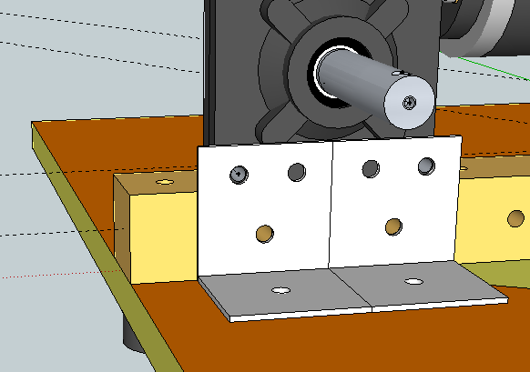

    • Battens 40mm x 45mm x 440mm: Engine Support-wedge (x3 + 1 = 2m)
    • Sheet 2.5mm 55mm x 160mm: Support-motor (x 6)

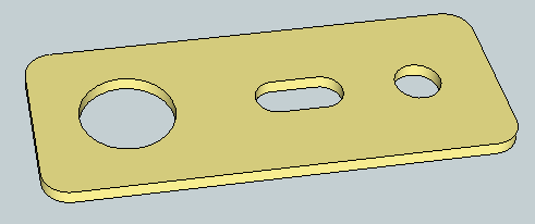

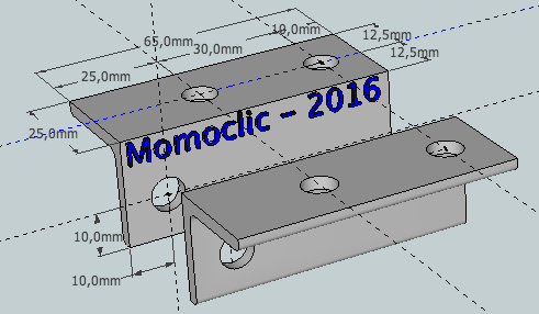

    • 20 x 5mm flat iron cross anchor: Support engine (2x3 = 0,400m)

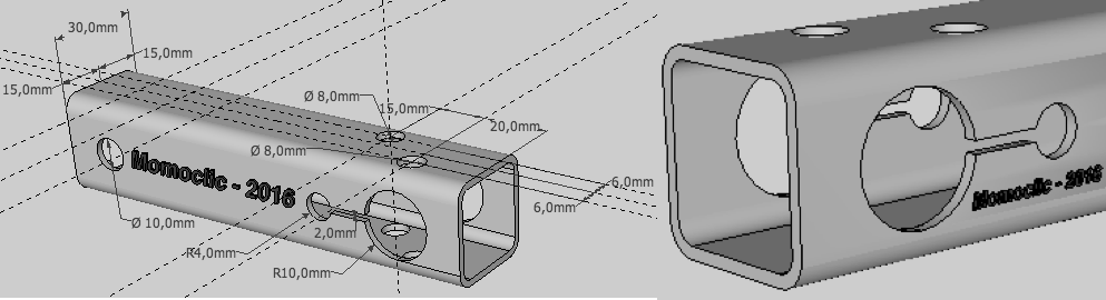

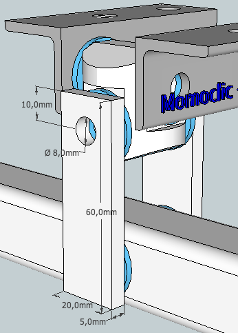

    • Square tube 25x25x2 (minimum): Rod (x3 = 0,800m)
    • threaded rod Ø 10mm 200mm: Rod (x6 = 1,200m)

    • Support potentiometers (x3) (to manufacture an insulating material preferably)

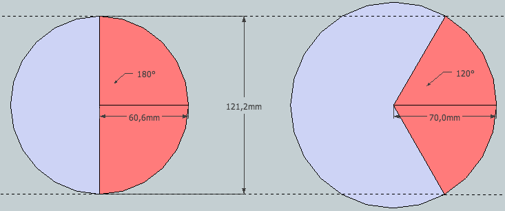

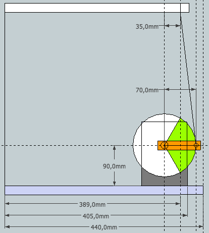

    Why 70mm cranks?
    We have engines with a torque of 45 Nm. To turn a couple power to consider the distance in meters from the center of rotation of the weight lifting
    • 45 Nm / 0.07 m = 642.9 Newtons
    To convert Newtons to kilograms we take into account the gravity (the gravity)
    • 642.9 / 9.80665 = 65.55 kg
    This means that only one gear motor when its crank is horizontal, is able to lift more than 65 kg. These calculations call has a static, while our simulator is at the opposite of this notion, our machine is dynamic. The dynamics takes into account the inertia and acceleration of masses in motion. We have the best role we do not know what constitutes the mobile part (steering wheel, screen (s), etc.) or their distance from your building's center of gravity. So there we is not possible to make these calculations [​IMG] and it's good, these calculations are quite complex, so you will spend like all of us. [​IMG]
    Experience shows that an approach on static bases gives acceptable results from the time or are exploited that 2/3 to 3/4 of the calculated maximum load. More motors, by the operation of a simulation, are not constantly fully charged even if sometimes peak, they pass overload.
    Vertical displacement obtained with 70mm crank arms
    • 180 ° (twice 90 °) twice the crank = (2 sin (90 °) x 70mm = 140mm
    • 120 ° (twice 60 °) it is as simple = (2 sin (60 °) = 121.2 mm x 70mm
    In this example you notice that for the same race, simply lengthen the crank 60 to 70mm when going from 180 ° to 120 ° of rotation.
    Differences between 180 ° and 120 °
    Choosing between 120 ° and 180 ° rotation of the cranks
    - Perhaps you notice the undeveloped part, between 120 ° and 180 °, in the rotation we lost relatively few stroke (14%).
    - A 60rpm time to travel a half rotation (180 °) is done in half a second.
    At the same speed, the 120 °, the third tower is carried out in 1/3 second. Either 1/3 time less that 180 °. That is, with this angle of rotation, and the appropriate length of the crank, the same stroke will be covered in substantially less time.
    This time saving motivates us to adopt this option, and we will have a much more efficient and responsive simulator. However please note that it is only possible to the extent that it has sufficient torque, as we have seen above.
    Either two arguments to operate without regret this angle of 120 °.

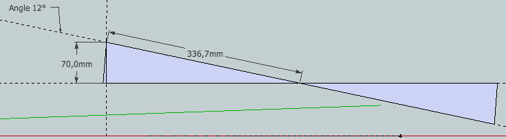

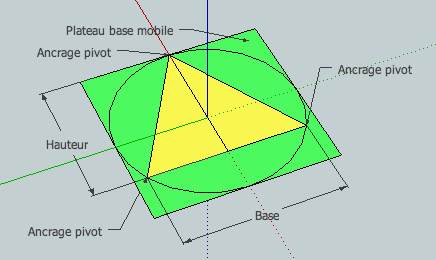

    Angle calculating inclination of the movable platen
    mobile tray settings

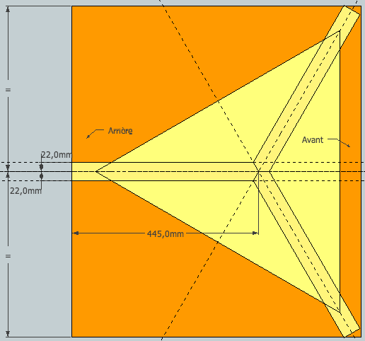

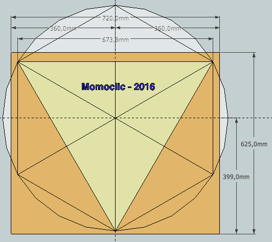

    If one drives a single motor up on the triangle formed by the three upper rods anchors (tray-seat) tilts the axis of the geometric height of the triangle by using the two pivots as axis of rotation.
    Rather one can keep a single fixed point and operate two engines. There are two possibilities then:
    - Two engines are going in the same direction which amounts to almost the same as the previous case.
    - Two motors rotate in opposite directions, the movement is on the half side of the triangle, shorter than the height and the same amplitude which increases the inclination angle with respect to the first case.

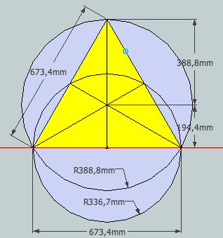

    The most important angle is the one generated for the same race by the shorter lever arm. We retain the latter for our calculations. The ball we have does not accept more than 13 ° inclination from their central axis. For security reasons we will only use 12 ° to deviate slightly from the limit and offset some still possible execution errors.
    The two elements at our disposal, and are part of our objectives are the 70mm stroke and angle of 12 ° whose sine is 0.208. Calculate the hypotenuse that results.
    • 70 / 0.208 = 336,7mm

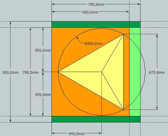

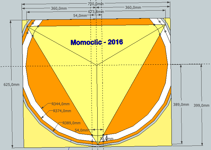

    Calculate the side of the triangular platform
    This rating represents the half-way between two balls of axes. This is also the next half of our equilateral triangle, which makes us a triangle whose side measurement 673,4mm.
    Calculate the height of the triangle using the tangent 30 ° = 0.577.
    • 336.7 / 0.577 = 583,5mm
    Triangle lift
    And the position of the center of the circle circumscribed to the triangle meets the middle and mediating, located at two-thirds the height of the equilateral triangle.
    • 583.5 x 2/3 = 389mm is the implantation of the mobile platform radius.
    Calculation of the base implant

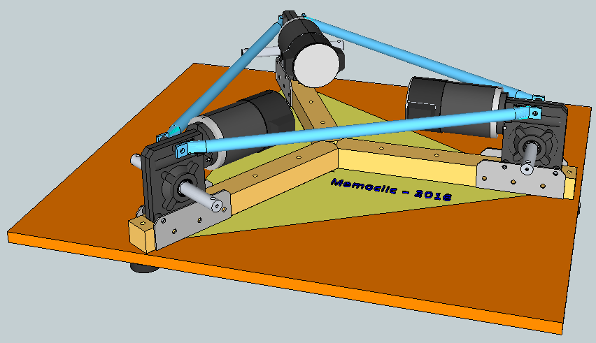

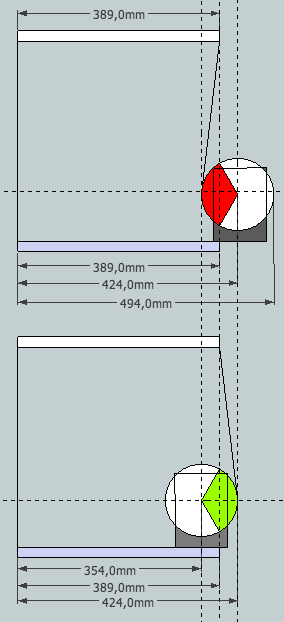

    Before embarking on the final implementation plan two possible positions for each of the engines. We take as a rule of mounting the crank-connecting rod system which guarantee symmetry of movement on 180 °, it is in survival hinges here.
    Engine position
    The case for reducing motors, side view, appears briefly as follows:
    Gearbox output shaft position
    Note the 51mm dimension, the end of the gearmotor, it will be helpful to draw the circle site on the support base.
    As you can see, the second mounting image "Motor Position" allows us to gain 70mm on the swing radius of our simulator.
    So we can draw a circle implantation simulator of the base using the information from the two previous drawings.
    • 389 -35 + 51 = 405 mm distance from the center of the circle outside the discount boxes of our engines.

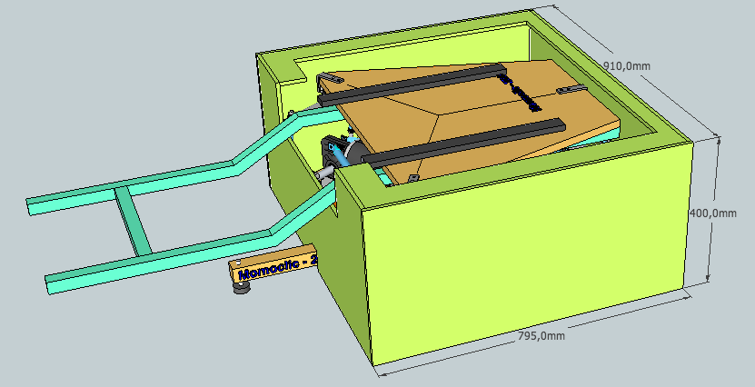

    - 5 - Installation
    We chose a location of radial engines, each branch is located at 120 ° from each other. In this configuration it is necessary to determine the front and back of the simulator. A simulator says "all mobile" square wheel, pedals, various levers or screen (s) on the front of the machine. These elements are relatively distant from the center of gravity and induce thereby significant inertia. To fight against the inertia we are going to cooperate together a pair of three engines at our disposal.
    All these reasons that guide us to place a single engine at the rear and two forwards.
    To carry out the layout we need essentially a single value: the radius of the circle positioning of the upper ball joints: 389mm.
    This value is extrapolated others including that of 405mm extreme position of the gearbox on the star of the stand.
    The height of the engines on the star is determined by the length of the cranks.

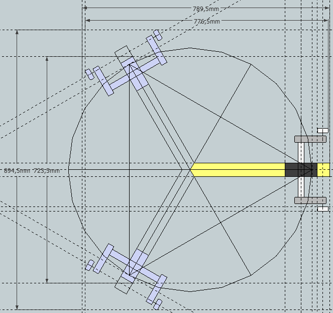

    Another important dimension to be checked imperatively conditioned by the circle, the distance between the axes of the upper ball joint 673,4mm the side of the triangle.
    All these values determine the position of the elements, but not the space outside.
    Unit dimensions
    To consider exceeded cranks and hinges outward and the spacing of the rod bracket.
    Unit dimensions
    The pairs of cranks, 198mm apart to-center, equipped with two ball joints protrude outward on the axis of the limb of the star. They also overflowing laterally to this axis, all this determines the outer boundary dimensions.
    Dimensions top view

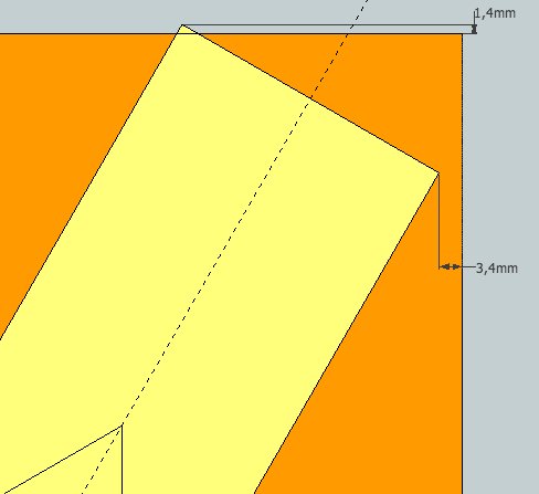

    Result of this analysis, the base must always be at least 0,690mx 0,790m. This size does not account for a possible background, it ensures the construction and stability of the system.
    To dress the unit must, for example, add to this format cleats to protect rods and cranks. These cleats should cover the same area as the large format.
    The large tray that allows external protection directly attached, must measure 0,900mx 0,790m. Amounts panels are placed and bolted to the outside edges.
    In summary, the final dimensions of your project will be one of the largest panel to which you add the thickness of the side panels.

    • Prefer the plywood to the medium, especially for the mobile plate and apply yourself to stiffen the maximum every room.
    • Consider the material sections as minimum, in general there will be no problem to use a slightly higher dimension.
    • Wood trays are advantageously stiffened firmly bolting reinforcements (the seat slide rails, for example) and by placing large washers against the wood.
    • It is possible to stiffen the set screws with a tubular casing for added strength.
    • Tighten the fasteners and assemblies, firmly and without excesses, against nuts or lock nuts are sometimes indispensable.

    Base route
    The route must be made directly on the 20mm panel. Minimum size is 690mm x 790mm in orange colored images.
    If you make a metal tube construction, use cardboard to make this layout.
    The goal is to draw a triangle whose points allow to position the gear motors.
    The simplest way to draw a triangle in a circle, first draw a hexagon.
    Your memories of geometry are too far? Then try the web is full of examples and videos.
    If you do not have enough large compass, take a tip you will sink slightly at the location of the center.
    Attach a pencil to a piece of string, then the other end, loop the right length and hook the loop at the tip.
    It'll just draw.
    Plot simulator base
    Draw the triangle with rules and medians mediating since we are in an equilateral triangle.
    In fact, you can use a larger pan, for against the important things are to respect the position and route of the triangle.
    Note: The orange area represents the minimum size of the plate. The light-green part can be useful to place the power supply and electronics, it can be increased without inconvenience. Sidebands, dark-green, delimit the space for a full lining that protects the movement of cranks.
    Now we will plot the location of the three engine mounts. Arranged in a star on the center median.
    Draw to 22mm, from both sides, two middle parallel.
    Draw outside of the triangle points in a straight line parallel to the opposite side, the center distance of 445mm. At the back it's easier since we are on the edge of the plate.
    Layout of motor carriers
    The media gearmotors
    Each of the branches of the support star is composed of a wooden parts, and two sheet steel 2.5 or 3mm.
    Shims
    At the center distance of 70mm must be added at the end of the crank 10mm material and safety we keep ten millimeters reserve. This places the output axis of the gear to 90mm above the base. The output shaft is 50mm from its base: 90 - 50 = 40mm thick to remember for wedges that allow cranks browse through 360 °.

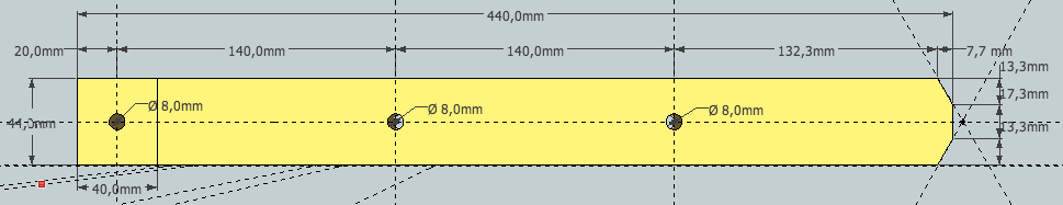

    The three necessary pieces of timber have the dimension of 45mm x 40mm to 440mm long, they serve both to raise and fix the engines.
    Note the line on these parts "engine placement Bookmark", 40mm of the outer end that serves as a positioning gear motors.
    All holes have a diameter of 8mm.
    [​IMG] Above a wedge engine mounts
    Note: Remember to identify the position of the end reduction boxes to 40mm from the tip of the branch of the star. The exact width reduction case is 44mm. There will be no problem to use a piece of wood of 45mm that has all the chances of crashing when tightening between the two metal plates. The height of 40mm may be modulated according to the length of the cranks used.

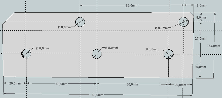

    The side decks are made of sheet steel minimum 2 to 3mm thick. By engine, so each branch, it takes two. What makes us six sheets of 55mm x 160mm.
    At the center distance of 70mm must be added at the end of the crank 10mm material and safety we keep ten millimeters reserve. This places the output axis of the gear to 90mm above the base. The output shaft is 50mm from its base: 90 - 50 = 40mm thick to remember for shims.
    [​IMG] Engine mounting plate
    Note: Holes reduction housings fixings are drilled home to 6.5mm. For several reasons we recommend boring, using a drill three 8mm holes. The case is aluminum this does not pose any particular difficulties. You can opt for galvanized brackets, well sized, trade. Plan well the appropriate mounting holes and think that all must ensure excellent longitudinal and transverse rigidity.
    Description of attachment

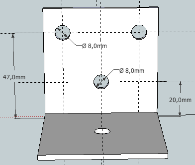

    It is possible to use galvanized angle bracket found in hardware stores. The dimensions are very variable, hold only that they must have a go from a minimum of 60mm. Prefer a model sheet of 2.5mm. Feel free to ask some wood screws into the holes available in addition to M8 and their large washers. Below an example that score that important heights, other dimensions depend on the characteristics of the design found.
    [​IMG][​IMG]
    Fixings brackets

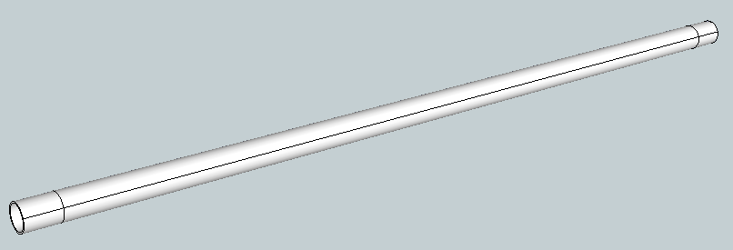

    The tubular reinforcements
    To lute against the transverse effects, and other jolts vibrations, it is prudent to ensure system stability. The links that we will establish must be perfectly rigid. For these reasons we must spread the flat iron that is not appropriate. For simplicity of implementation we chose to use the minimum 20mm diameter tubing. An angle could have been suitable but requires access to the weld.
    To manufacture these reinforcements you need three tubes of 615mm. Using a pen and a ruler, draw a line on the side of the tube. This feature allows you to align the two ends to flatten. To locate or pinch the ends draw a circle around the tube to twenty millimeters from each end.
    Drawing a reinforcement
    Pinching an end of the vertical tube in a vise. Place the contour marking flush upper jaw and the vertical line you have drawn equidistant from both jaws. Then tighten the noose being careful that the tube does not rise. If so, squeeze, eg 30 mm instead of 25. In summary go gradually to crush the maximum. Proceed the same way on the other end of the tube, making sure that both ends of the dishes are on the same plane, the vertical line is there to help you.
    Note: - Before pinch the tubes permanently, it is recommended to test a drop tube to see how the tube will behave. - If the quality or thickness of the tube you use causes its slot when you crush it, you can insert a piece of flat iron in the entrances of the tube. Few centimeters will suffice and remain in place. Warning, it will fold and this may require to provide a little longer screw when assembling the gearboxes.
    When both ends are flat in a pinch to 20mm tip ensuring that the tube is perfectly vertical and pull it toward you until a 120 ° angle between the flat part and the tube axis. Do this only from one end and drill a 8mm hole diameter to 10mm from the edge.
    In this present progress up the tube through an M8 screw in the body of the gearbox. So check your work and possibly correct it before it is too late. This operation is called a "white mount".
    If this is correct, cintrez the second end and rebuilt a new white mount. When the tube is in place, the bolt of the other motor squeezing the tube, using a felt locate the drilling axis of the second hole of the reinforcement. Disassemble and drill the second hole, checked, you just completed a brace.
    At their establishment consider putting large washers to properly apply the flattened surface reinforcements against the case.

    The moving plate is the part that will ask for great accuracy. These are the plots of the base triangle and the moving plate that define the kinematics of your simulator. The dimensions you see have a direct influence on the range of movement and symmetry. Risks increase for non compliance ratings, then bring it very carefully.
    The route must be made directly on the cons-plated 20mm to 625mm x 720mm. Start your tracing the long side of the panel which will be the back of the simulator.If you opt for a different mount that will describe below, adjust the panel accordingly.Repeat the technique used above for the base. Caution here, the circle center is not the center of shelf.
    As previously are the points of the triangle that must be perfectly positioned. Before starting we must make small calculations dependent on our way of fixing ball joints.
    Calculating positioning ray tracing universal joints
    The universal joints, in our assembly, are placed in outer boundary of the moving plate. Their three vertical axes should form an equilateral triangle to meet the defined kinematics.Calculation of drilling ray ball fastenersFor holes we use, as always, the Implementation of Radius (389mm), the Ray Exterior Limit (RLE = RI + 10) and the ratings of our mounting brackets.
    • Distance outer screws = Dve = 25mm
    • Distance inner screws = Dvi = 55mm
    • Outer piercing ray = RLE - Dve = 399 - 25 = 374mm
    • Inner bore radius = RLE - Dvi = 399 - 55 = 344mm
    Route of the mobile plate
    Plot shelf mobile support
    To meet the geometry defined above, we must ensure that the balls are perfectly at 120 ° to each other. Draw the triangle and drill hoops calculated above.
    Plot fasteners ball joints
    Note: Remember to identify the center of the triangle formed by the ball is in the vertical axis that must be placed the center of gravity of the mobile assembly.

    If technically make the cranks presents no difficulty out of reach of the amateur, the problem is to have a way to drill a Ø 20mm.
    Fortunately Thom Concept (Rider63) in designed for you the cranks of your needs and you can acquire them near SimuKit.
    If you have the proper drilling means, here are the achievement scores of these cranks using 30x30x2mm square tube. Please note that the positioning of the two 8 mm holes on the same face is important. In effect the output shaft of the geared motors is crossed by a 8 mm hole placed at 9 mm from the end. In bad hole square tube would not shake the tree. The second screw ensures, with the vis-a-vis slot, the necessary clamping the other side of the square.
    To saw the gap between the two holes of 20mm and 8mm is done simply by removing the Frame saw blade and up the through hole.It takes place a very large washer in the shaft to prevent the square tube slide while tightening and under the brutal operation efforts of the simulator.

    Braces universal joints

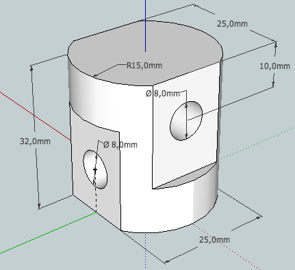

    Ten centimeters of acetal sufficient Ø 30mm, cut the piece in three parts of about 32mm each.
    Trace on each of the ends, using a cardboard template, a square of 25 mm side, taking care to locate an axis on the side. For this draw a vertical line on one side of the acetal round and an index on the cardboard square.Cut, using a hacksaw, the excess material by thinking about the thickness of the saw blade and keep the two parallel sides. And ensure that the cuts of both ends are well perpendicular.
    Then draw and drill the 8mm holes.
    Warning axes through acetal should be smooth. Pick your 6 M8 x 45mm which are not threaded along their entire length.

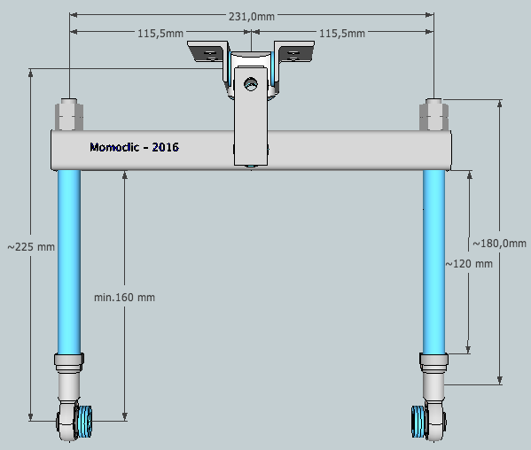

    The connecting rods
    The dimensions given on the drawing are indicative. Both are very important, one is the center distance between the two rods and the other the minimum "bridge" height 160mm, it is what allows this mobile hitch pass over the housing reduction. These two rods must be perfectly vertical, spacing is determined by the cranks and three washers 2mm thicknesses necessary for the passage of spherical caps.The rods consist of two threaded rods of about 180 mm wrapped in a steel tube of 14 mm of about 120mm. They are capped by the bridge square tube of 2mm thick and 25mm side. Laying against nuts or brake nuts is essential.On the bridge is built the cross from universal joint. To achieve using the flat iron 20x5mm Ø 8mm drilled holes.
    [​IMG][​IMG]
    Rod bridge
    If you can weld two flat drilled a hole each, otherwise a flat U-bolt will do. Do not drill holes through the dishes once in place. To allow a better sliding of both sides of the cross inserting a large washer. We must therefore take account of this thickness and add washers between the flat bar and square tube during welding or assembly.The space under the crosspiece is important to allow the lateral angle socket without interfering with the threaded rod.You have chosen the second solution U, then think about the extra thickness under the bridge. It may require you to lengthen the threaded rods and tubing.
    [​IMG] Size of a connecting rod

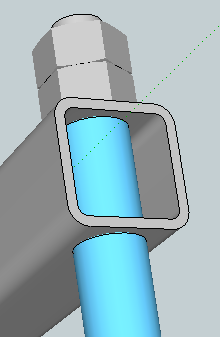

    Note the assembly of round tubes in the square tube:
    Detail rod assembly
    On either side of the square tube holes are different. The top hole is 10 mm to allow the passage of the threaded rod. The lower hole, he is reamed to the outer diameter of the cladding tube reinforcement.In summary tightening is only between the end of the round tube (blue) and the upper side of the square tube (gray) is a few millimeters thick.This is important for two reasons:
    • Prevent overwriting of square tube during tightening so that over time.
    • Ensure greater lateral stiffness to the rod.
    This type of assembly is to apply even if you weld the tubes to prevent crushing of the square tube.
    Here on the 10 mm rods are sheathed in 12/14 mm tube, it can be more if you have the time it enters the square tube. In this case it will be based on a robust ring against the ball tip.
    This assembly is particularly important in ensuring the lateral rigidity of the system. The threaded rods risking to flex easily in the jolts repeated simulation. If you have the ability to weld the tubes, 10 mm holes suffice.
    Note: If you do not use the cranks or kneecaps kit, consider correct dimensions in the specific features of your hardware. Similarly if you use a larger diameter tube for reinforcements, this may affect the minimum height of the rods.
    Assembling your simulator
    The angles are simply fixed to the plate by 35mm M8 and a large washer is applied next timber. Remember to put too side nut, lock washer or range to prevent loosening.
    [​IMG] Your future simulator
    • Different heights of the plateau above the ground:
      Simulation:
      - Top 430mm
      - Down 310mm
      Extreme:
      - 440mm High
      - Down 300mm

    Support points
    An example of what it can do, the more tight, like protection with panels 10mm thick. Probably there-was-there enough space on either side of the rear motor to place the electronics and power supplies.Note also the example of tubular structure primer. Enjoy the space under the tray to lower the center of gravity by bolting the same time structure that slides here in black and possibly remove unnecessary angles of said plate. You have to figure the mobile structure that suits you. The rules being to make rigid, light and concentrate the masses as close to the center of gravity ...
    [​IMG] The closed 3DOF

    Variations
    The project we have just described is only one example. Many opportunities are available to you, all depends on the goals you set for yourself. However kinematics and physics have their intransgressible laws.
    One of the selected constraints is that induced by the choice of the hinges which limit the angle taken by more or less 13 °. Know that there are ball joints that permit up to 16 °. But their nominal diameter of 14mm does not use to everyone.There is a solution which is to use "angle enlargers" with the usual ball:
    The interest can exceed 13 ° and possibly reduce the crank is to decrease the size of the simulator. Thus it becomes possible to pass through a standard building our door. For this we limit the angles at 15 ° for mechanical safety and also reduce some piercing crank 65mm. By choosing this option it is necessary to review the implementation by referring to the base circle that goes from 389mm to 313mm. Some simple calculations will be necessary to achieve your goals, why you just follow step by step example of this guide and adapt. The implantation beam can not, must not go below 290mm.
    Attention involved, the angles of inclination may be significant and will likely be limited in SimTools. The relative narrowness of the simulator will need to attach struts on the sides and back, they will eventually be folded, just like what we have done to the front of our simulator.
    Cranks calculations 65mm and 15 ° angle
    Télécharger la feuille de calcul (.ods, logiciels gratuits) qui vous permettra de penser et optimiser votre 3DOF à effet de houle.
    Download the spreadsheet (.ods, free software) that allows you to optimize your thinking and swell effect 3DOF.
    Télécharger la feuille de calcul (.xls, Microsoft) qui vous permettra de penser et optimiser votre 3DOF à effet de houle.
    Download the spreadsheet (.xls, Microsoft) that lets you maximize your thinking and swell effect 3DOF.
    Note: In summary, unless you want amplitude of movement, more congestion increases and vice versa.

    The position sensor (potentiometer)
    The electric motors we use to position the nickname car is our simulator. They must quickly reach the position requested by the game and our controls: steering wheels, pedals, etc. For this we use the type of cards "H-bridge" to reverse the direction of rotation of DC motors, themselves are managed by the Arduino microcontroller. To work the microcontroller needs to be constantly aware of the position of the cranks (relative elevation rods). To this end we use pots that tell the system to the placement of the platform. The only potentiometers to retain should have 360 ° of rotation, in other cases it is the insured case ... However despite being able to do many laps this potentiometer has an active range on 300 ° 340 °.
    Note: The potentiometers 360 (without stop) were chosen rather than any other sensor (Hall effect or other) for their excellent quality / price and implementation simplicity.
    As you know we want to exploit the rotation of the cranks on 120 °. Turn the potentiometer shaft end of the gear motor will make us lose a lot of precision, which generate parasitic oscillations. The solution is to use gear that role will be to travel 300 ° when the potentiometer 120 ° will be driven by the crank.
    We must therefore determine the transmission ratio required for our example:
    Gear ratio: 300/120 = 2.5
    Starting from the assumption that we have a sprocket 50 teeth to the motor calculate the required number of tooth the potentiometer:
    Number of teeth to the potentiometer: 50 / 2.5 = 20 teeth
    With a 50 sprocket 20 teeth torque and thus we fulfill perfectly the specifications for motor rotation of 120 ° and 300 ° using the potentiometer.

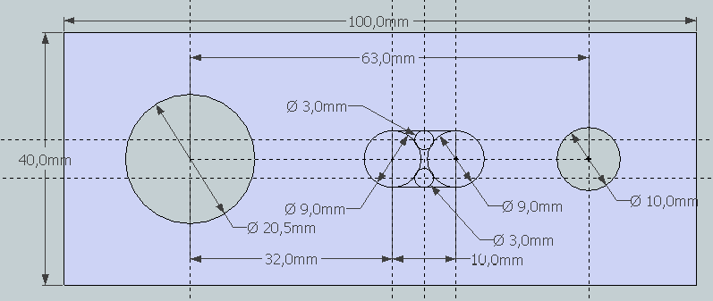

    The potentiometer support
    Here it is very simple to make, choose an insulating material a few millimeters thick and 100mm long by 30 to 40mm wide.
    Supporting a position sensor
    Note the few tricks of the assembly, first the diameters of the holes are to accommodate you component.The tree 350w motor is 20mm in diameter. The hole is slightly higher not to force on the shaft. The top hole is 10mm but here the original gear motor casing is drilled 6mm we recommend 8mm boring with a drill. The remaining game odds allow small errors while facilitating assembly, but the wafer to be clamped between washers.
    For realized the oblong hole to start with drill two 3mm holes and two 9mm and finish with a small flat file.
    But in fact, why a slot?
    Well, for at least two good reasons:
    - To allow precise adjustment gears
    - Allow a "release" position sensor in the development phase.
    Remember to put a washer under the nut of potentiometer so that it is well maintained and does not slip over time.

    The wiringHome, home, electrical outlets accept a maximum current of 16 Amps. To carry this current section is the son of 2.5mm². A simple division allows us to calculate the density mm²:
    16 / 2.5 = 5.77 Amps / mm²
    350w engines are supplied with 24 volts which requires intensity:
    350/24 = 14.6 amps
    As a result of 2.5mm² wire will be perfect for powering an engine. But CAUTION a Sabertooth card supplies two engines!
    This will require between diet and each of the Sabertooth 6mm² wire (or failing double the 2.5 mm²).
    Note: For security reasons, follow them carefully son sections to prevent overheating and loss of performance.
    Cable schematics
    Provisional: two engines
    Wanegain recommend taking the 5 volts potentiometers on Ardiuno rather than Sabertooth. Indeed, in case of malfunction or power failure 24v potentiometers are always powered. So that when restarting there will be consistency in the positions of the values since they have been stored by the Arduino.
    The power board (or Sabertooth Moto-Monster)
    It is this electronic card that supplies DC motors (DC). It is directly connected to the low voltage supply and sending according to the instructions received from the micro-controllers the rotation orders in one direction or the other.This type of card replaces the relay since no contact. The H-bridge used to perform two functions to reverse the direction of motor rotation by reversing the current to the motor terminal and the variation of the engine speed by modulating the voltage across the motor. In addition, it allows a magnetic braking if it is able to dissipate the generated power. Indeed an engine such as those we use is called "universal" because it works in both engine dynamo.
    Note: In these last remarks we can deduce that the resistors supplied with this type of card may not be necessary.
