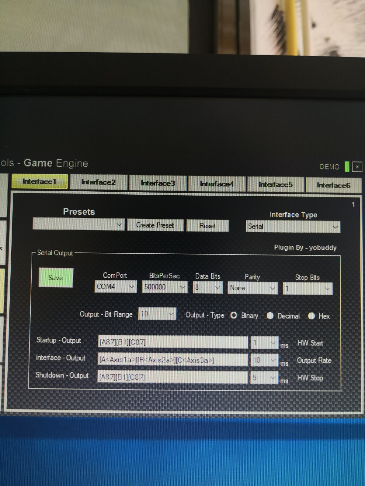

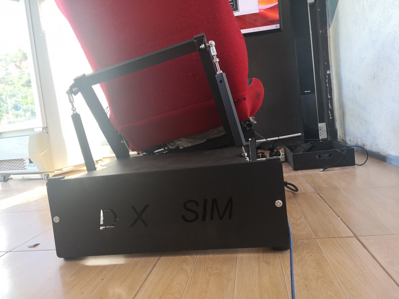

    ฉันใช้I'm using V.2.5 and the chair can't be straightened. And I can't play the game, tried it, by this chair I bought from China, dx sim brand.

    I am guessing it may be using the SMC3 code, do you know if that is correct and can you please advise what information DX Sim gave regarding configuring their rig for SimTools?
    If it is SMC3 used with an Arduino then change the DataBits to 10 and for now leave the Startup and Shutdown lines blank.
    The Demo version of SimTools will only work with Live For Speed: https://www.lfs.net/downloads
    Be aware LFS must be run before patching it for motion: https://www.xsimulator.net/communit...run-in-first-person-mode-before-patching.365/
    To use other plugins you will need to have DX Sim supply or purchase a Pro License: https://simtools.us/professional/

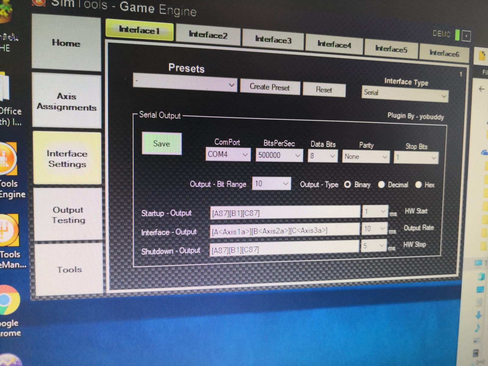

    Original V1.3 [A<Axia1>][B<Axis2>]
    V.2.5.1 = [A<Axia1a>][B<Axis2a>]It can move, but tilt when turning on (1.3 fine, normal). I got out of test mode and it still skewed.

    Can I please confirm that when SimTools 2 was installed you took the option to remove everything from v1.3, is that correct, as it is necessary and required that you start with a clean slate for a v2 install?
    I also want to check that the computer is set to English Local, to rule out that being a issue: https://www.xsimulator.net/community/faq/simtools-language-setting-bug-change-to-english-local.233/
    Did you try changing the DataBits to 10 in the Interface Settings?
    And what have the manufacturers given you in terms of information about setting your rig up with SimTools?
