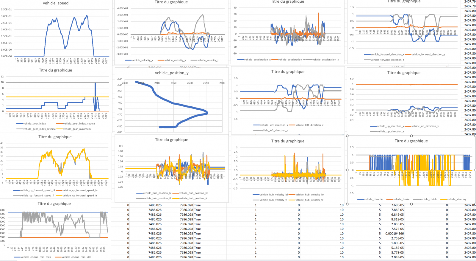

    Well, UDP is now released but only for PC :( . As you know, I'm console oriented and I'd be happy if UDP comes to the console too !
    In order to anticipate the good news (I hope), could someone post/send me the UDP stucture as it gets generated when the game launches ? Looks like config.json file has those details.
    Even better, a UDP capture would be amazing, using UDPReceive.py from the git repo https://github.com/vthinsel/Python_UDP_Receiver
    Thanks !

    So here are some things......... I don't know what Im doing, I just followed come basic instructions on the github.
    Hopefully it helps but as I don't understand what Im doing/seeing I simply cant judge.
    The capture is from the first 20 seconds or so of a time trial on the first monte carlo track.

    Amazing ! Exactly what I needed. Maybe I will have something ready by tomorrow even without having the game :)
    Some more files would be interesting if possible : everything in /readme/ folder

    All UDP values are decoded and look fine :
    Now the goal is to turn all this in what simtools is expecting : roll/pitch/yaw heave/sway/surge
    Will check if codemaster plugin can help as I'm a bit lost here. I widh I had been more carefull with my math courses when I was young ....
