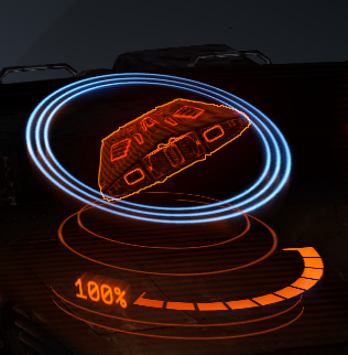

    For these, who want to have some fun already with the Combat Training Demo 1.00, here a plugin.
    Currently it only supports roll speed and pitch speed, mimicing the little gyro thingy on the dashboard
